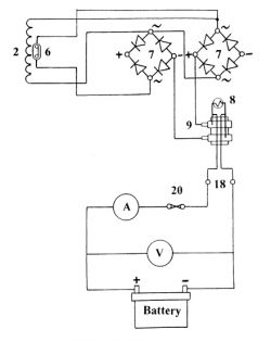

    According to the datasheet for this turbine, the power should be greater than these few watts, so there is something wrong. Either a damaged generator (maybe the diodes because it is a three-phase generator) or your converter does not load this generator sufficiently. Have you been looking with an oscilloscope what is the shape of the outgoing voltage?
    Graph showing charge current versus windspeed for the Rutland FM910-4 wind turbine.
  • Oscilloscope test suggests generator or diode fault
    #11 19715828
    Alpha
    Level 26  
    Posts: 1060
    Help: 63
    Rate: 459
    Thanks @akajarz for your interest and this remark, I must admit that you sowed a seed of anxiety in me - I will have to climb up and check everything again.
    My version is mkII, installation diagram below:
    Generator wiring diagram with component labels
    It does not look like a three-phase generator to me, but maybe I am wrong.

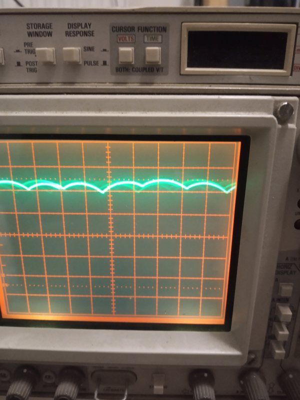

    Oscillogram from a generator loaded with a 100 ohm resistor, without filtering capacitors:
    Close-up of an oscilloscope display showing a sinusoidal wave and a measurement grid.
    It seems to me that with a damaged thermal fuse (which would probably be the most probable) and an open rectifier circuit, the voltage would be half-rectified and the oscillogram would look different.
    But it still cannot be ruled out that one of the diodes will be damaged ... I can only find out this by climbing the mountain with the meter.

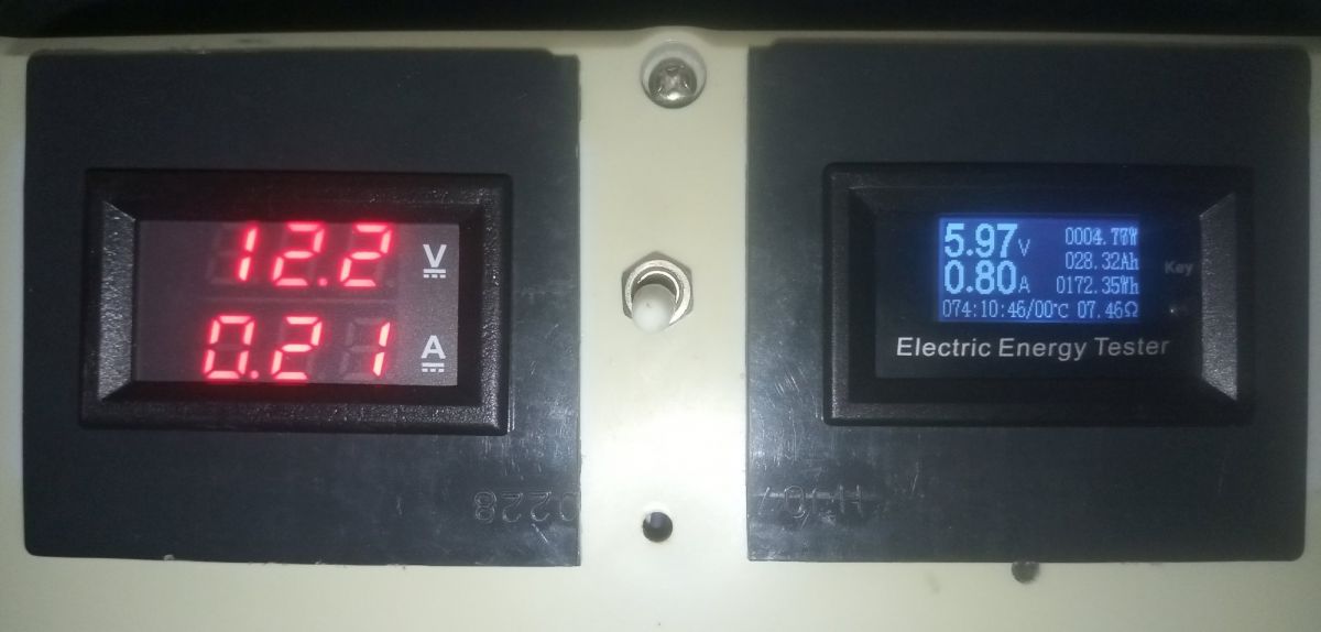

    Photo and video of the converter operation:
    Two digital meters displaying voltage, current, and other electrical parameters.
    [movie: 9e5cf5d6fe] https://filmy.elektroda.pl/17_1637235491.mp4 [/ movie: 9e5cf5d6fe]
    The projected wind speed today is 23 km / h (approx. 6 m / s). Performance as seen in the video.
