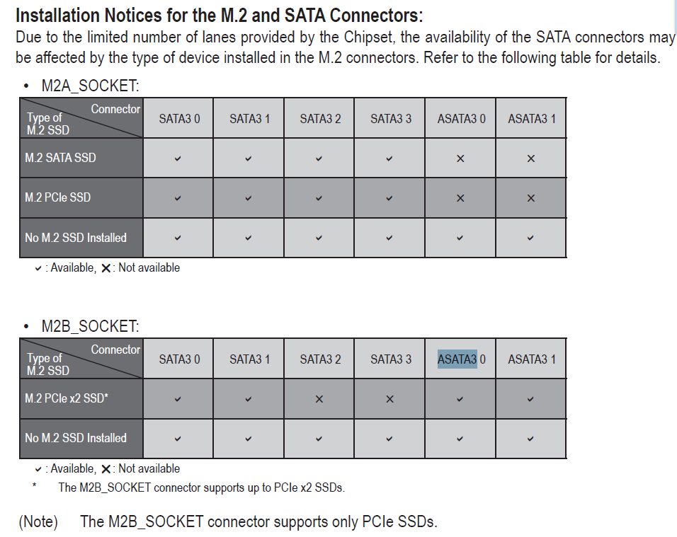

    As in the title, I have 4 normal SATA3 sockets to which I have disks connected and 2 ASATA3, I connected the disk to them, but the computer does not detect it. What are they for? The instructions don`t say anything specific either.

    W instrukcji wyraźnie napisane jest. "11/12) ASATA3 0/1, SATA3 0/1/2/3 (SATA 6Gb/s Connectors) The SATA connectors conform to SATA 6Gb/s standard and are compatible with SATA 3Gb/s and SATA 1.5Gb/s standard. Each SATA connector supports a single SATA device. The SATA connectors support RAID 0,RAID1,and RAID10. Refer to Chapter 3,"Configuring a RAID Set," for istructions on configuring a RAID array. APU SATA Port 0/1 (ASATA3 0,1 Connectors)

    Do I understand correctly - if I want to connect drives in RAID1, I have to connect one to a socket, e.g. SATA 1, and the other to ASATA1?

    It is clearly written, but what does it mean? Nothing for me, because my friend pasted one fragment from the manual, but I didn`t want to read the important part that answers the author`s question. And the important part is a bit further:
    Understanding ASATA3 Ports on Aorus B450 Pro: Usage and Device Detection Issues
    It clearly shows that if an SSD drive (SATA or PCIe, it doesn`t matter) is installed in the M2A slot, the ASATA ports will not work. The ASATA ports themselves have the same functionality as SATA ports and RAID can be performed on both.

    The manual on page 18 describes everything about how and when to connect disks to ASATA3 ports. There is even an option in the BIOS to set the drives to a RAID system and detect the APU SATA drive.

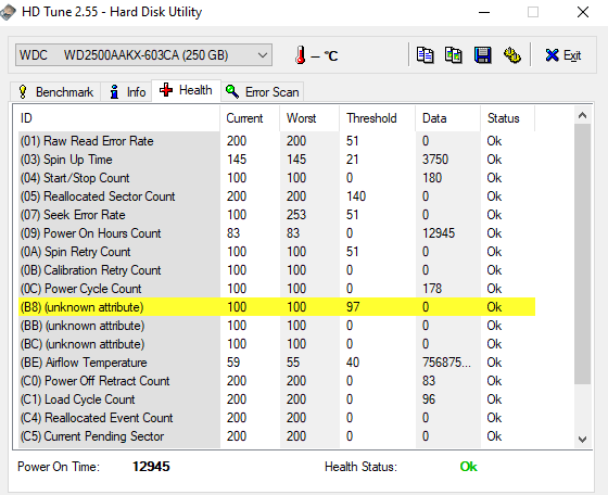

    I have a slightly different question. Understanding ASATA3 Ports on Aorus B450 Pro: Usage and Device Detection Issues
    Does this highlighted in yellow indicate any damage?

    NO. HDT misinterprets some parameters. This parameter means End-to-end error, the number of occurrences is stored as a RAW value and is zero - that is, the event did not occur even once. According to SMART, the drive is in quite good condition.
