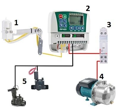

    Hello, everybody!
    I apologise at the outset if this is not the category. However, I know you know your stuff ;)

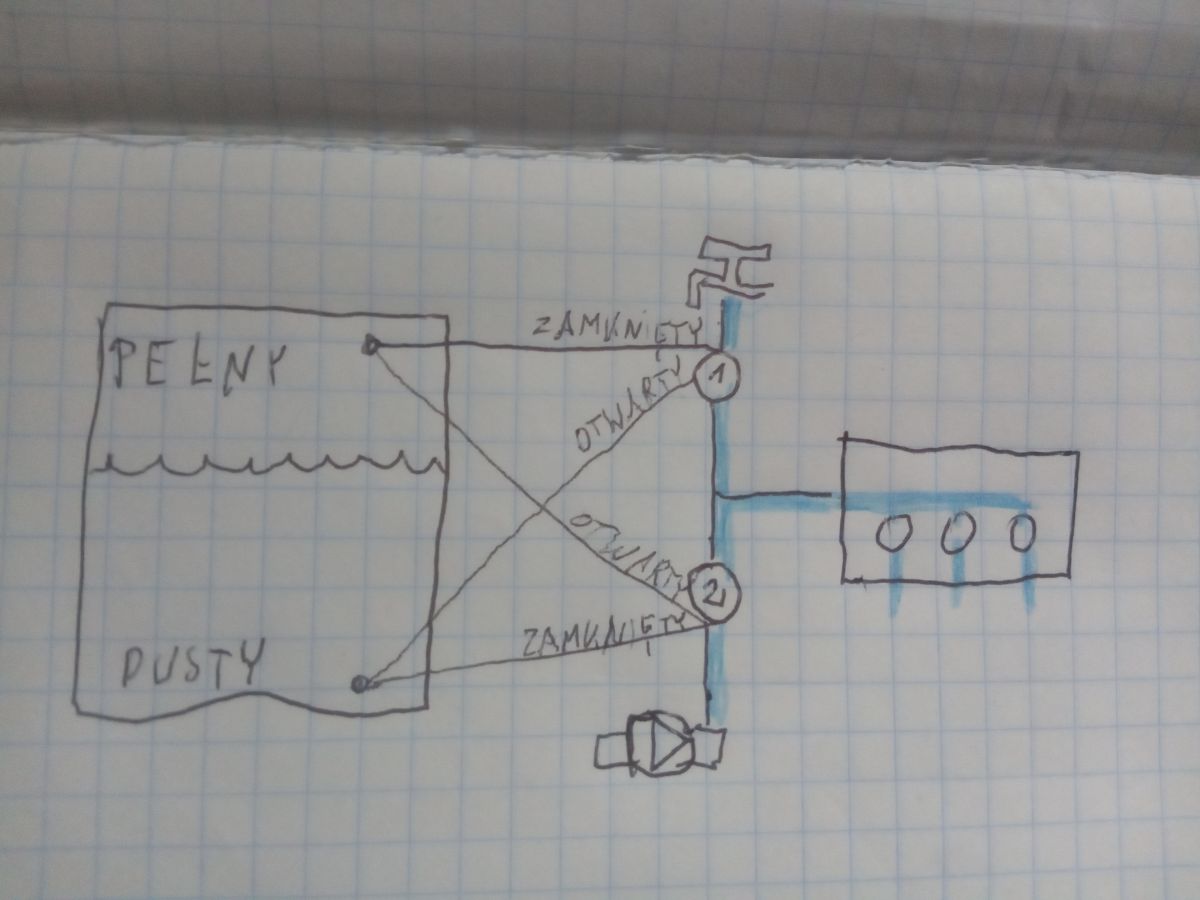

    Irrigation of the lawn - cooperation of the rainwater tank with the water supply system
    I am doing irrigation for the garden. I would like the default to use rainwater from the tank (via a pump).
    When the tank is emptied, the feed water would flow from the mains water supply. I thought of two solenoid valves.
    1 - from the water mains
    2 - from the tank (via a garden pump).
    There would be some water level sensors in the tank
    A) tank full - electro-valve 1 closed, electro-valve 2 open
    B) tank empty - electro-valve 1 open, electro-valve 2 closed.
    The pump would only start when there is water in the tank, and its activation and deactivation would be managed by the irrigation controller (rainBird RZX4) as of course the other irrigation sections. Please find attached drawings.
    How do I do this? Is this even possible? If so, please explain in "simple terms" the connections and the things I need to use.
    Best regards and best wishes.
    Ps. What is that under "3" in the picture below?
    [/url] Irrigation of the lawn - cooperation of the rainwater tank with the water supply system

    Hello .
    You can use a CP-2 liquid level sensor.
    Powered 230V , relay output without voltage , changeover contacts.
    For this, depending on the load (especially), the pump should be used an additional stronger relay, or a small contactor (for example DILEM -10).
    The relay output is not very powerful (relay up to 1A).
    You use three measuring probes SO-common to the levels.S1 minimum,S2 max.
    This is what it looks like Link

    You supply the sensor to terminals 4-(L) , 5-(N)
    -from terminal (4) you make a bridge with a wire to terminal (8)
    connect additional relays (their coils) to terminals (9)(10), the relays will control the solenoid valves and the modular contactor that runs the pump.
    Tomorrow I will draw you a sketch of how this should look.

    In your situation, one solenoid valve for filling the tank is sufficient.
    When the tank is full, the pump relay will allow the pump to be started by your controller at the appropriate time of day. When the tank is empty, even if the controller allows the pump to be started (current watering time), the pump will not start anyway until the tank is full.
    Relays of any 230V type R2M, R15 etc
    Through the contacts of both relays P1 you will supply the phase (you did not write what voltage the solenoid valves are for), under the output of the relay contacts connect the solenoid valve.
    Connect the operating contacts in series with the coil supply wire of the pump module contactor.You can use three or two courts for the tank.When there are two, S1 and S2 are connected together and it will be a full tank probe.

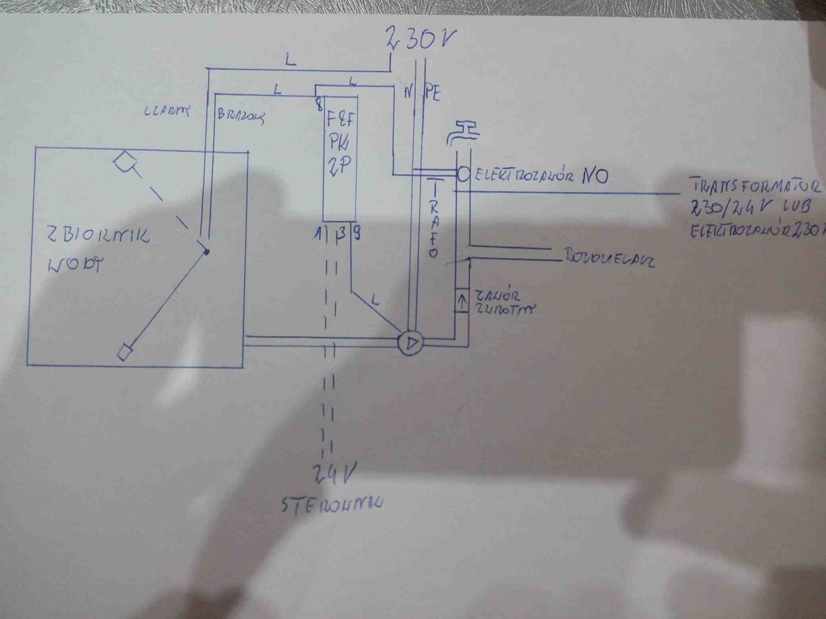

    Thank you for your help. My colleague EL-Szwed suggested a different and cheaper solution.
    I am adding a drawing if anyone else is interested in the subject.
    Greetings! Irrigation of the lawn - cooperation of the rainwater tank with the water supply system

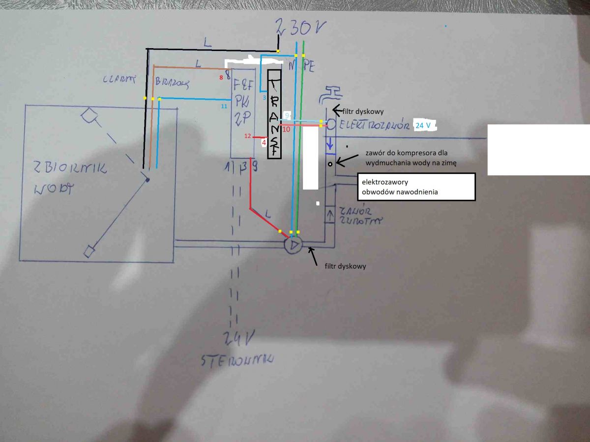

    For those interested, the final version modified with a 24V (irrigation) valve and F&F 230V/24V AC TR-24 transformer
    Operation:
    Direct control via a float switch in the tank.
    1. Tank full. Rain watering.
    At a set time for a set period, the controller starts the pump opens the individual irrigation circuits. Water supply solenoid valve closed.
    2. Tank empty. Watering with water from the water supply system.
    The controller opens the water supply solenoid valve and the individual irrigation circuits at a set time for a set period. When watering is complete, the water supply solenoid valve is closed.
    In this case, the pump is inactive.
    After filling the tank with rainwater, see point 1 etc.
    In connection with the "My Water" programme, I plan to add a second large tank to connect the other side of the roof and modify the installation additionally so that rainwater is also used if a tap is turned on outside.

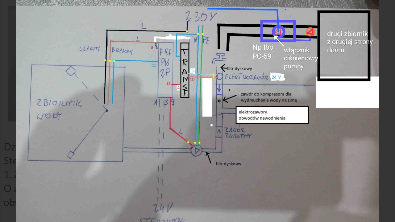

  • Irrigation controller should switch pump only during watering
    #15 21148421
    klosmariusz007
    There is another important piece to this puzzle. You need to buy an irrigation controller that operates a relay. I have an RC2 Rainbird, which has an output to control the main valve/relay. I control the relay, which only supplies current to the submersible pump in the rainwater tank when irrigation is in progress. The submersible pumps when they have current all the time run every so often to maintain pressure and readiness. Which is unnecessary if the irrigation only runs, for example, every 2 days. I had one pump go out this way, so I learned from my mistakes.

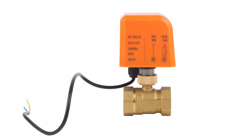

    I don't know if the author still remembers about this thread, but there are easily available solenoid valves that return to the "open" position after a voltage loss. I know because I have one myself, I was very surprised that it only has two wires and when 12V is applied it switches to "open" and when the voltage is removed it returns to the "closed" position. Of course, I wouldn't be myself if I didn't see how it's done, there's simply a supercapacitor in the housing that charges when the valve is open and powers the motor when the voltage is removed.
    It looks more or less like this:
    Brass valve with an orange electric actuator and a black cable on a white background

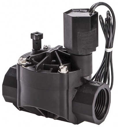

    >>21844744 >>21844744 At his place there is probably an ordinary one, one from irrigation and it returns to the closed state after a power failure:
    Black solenoid valve with coil, cable, and threaded ports on a white background
    It's a pity they don't make 2-3 way ones for 12-24 VAC (I've only seen on DC)
