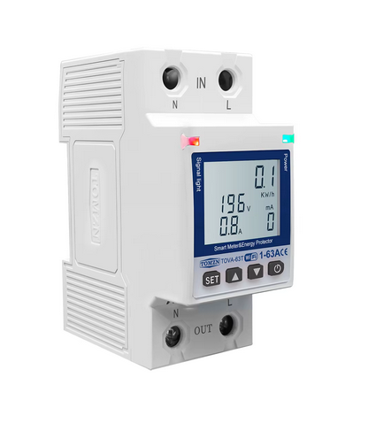

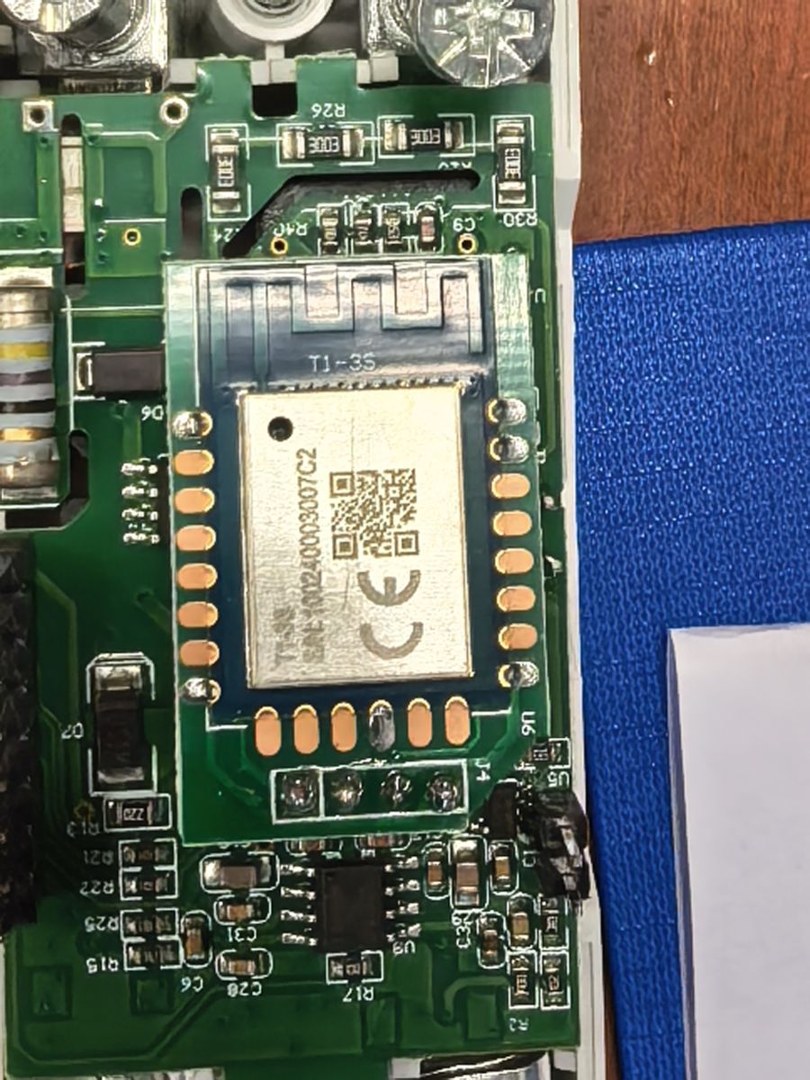

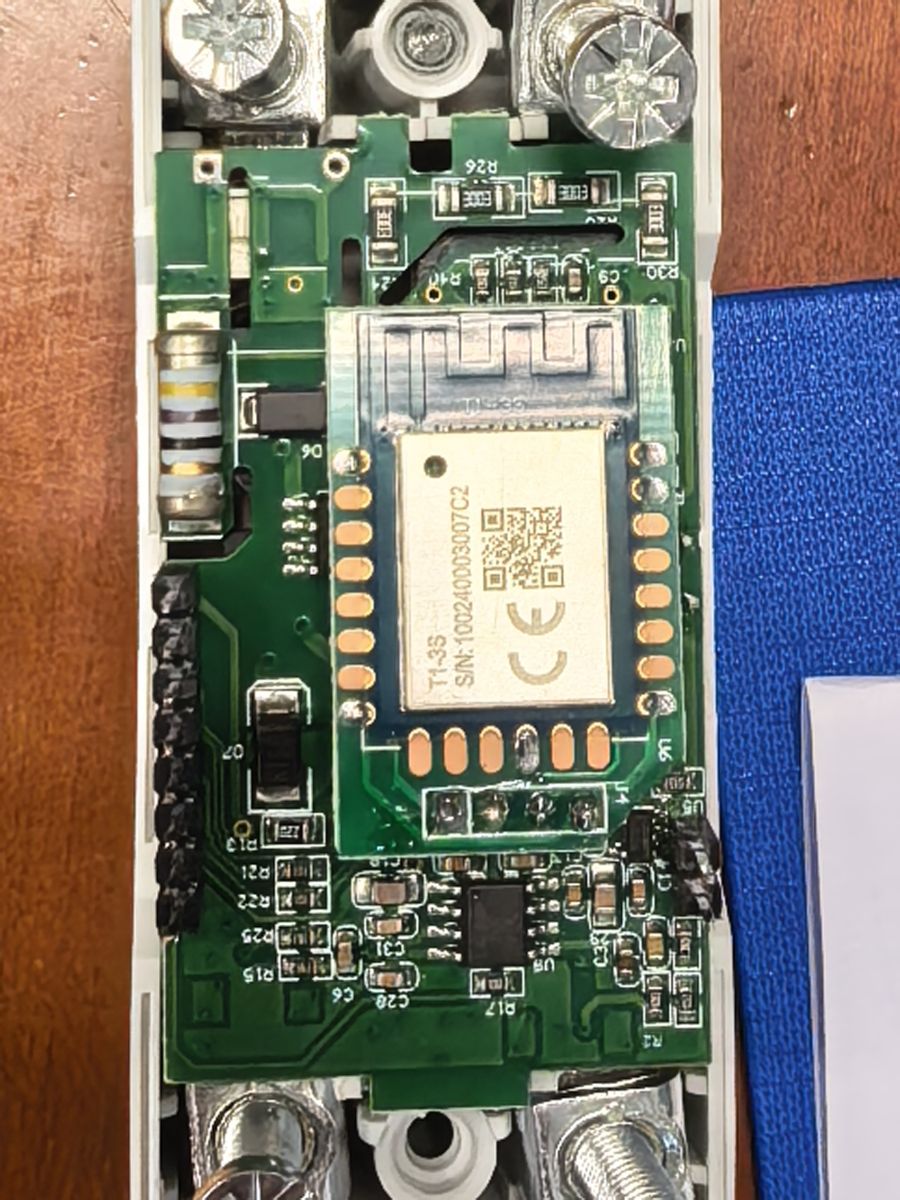

    Here are two differend one is T35 and one is T1-U-HL
    Can this AliExpress smart fuse be flashed with OpenBeken or Tasmota? Can this AliExpress smart fuse be flashed with OpenBeken or Tasmota? Close-up of a green PCB with a metal module labeled “T1-35” and a QR code
    T35 is with display
    White TOMZN DIN-rail energy meter with LCD display, IN/OUT terminals, and control buttons

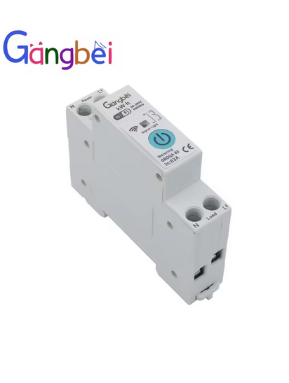

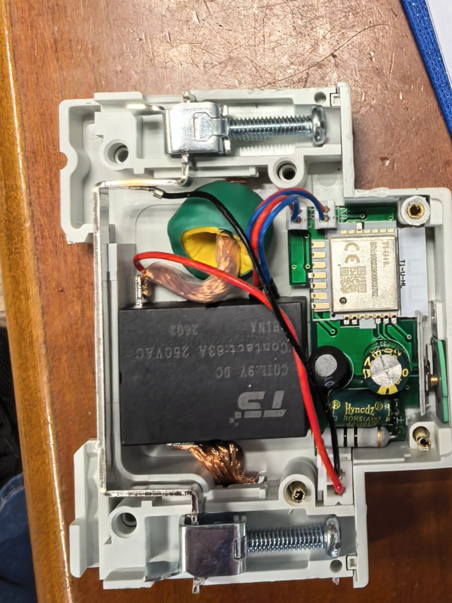

    T1-U-HL
    White DIN-rail electrical module with Gangbei logo and a blue power-button symbol on the casing
    when you open this one open it on the bottom not on the lid

The discussion concerns whether an AliExpress smart fuse can be flashed with OpenBeken or Tasmota. It is identified as likely being a TuyaMCU-based device, so OpenBeken should be possible, but the key step is determining the correct dpIDs. After the device is received and opened, two variants are reported: T35 with display and T1-U-HL. The enclosure is welded and should be opened from the bottom. The suggested procedure is to first make a 2 MB backup of each flash chip, then follow the TuyaMCU flashing and configuration guide to map dpIDs for Home Assistant.
