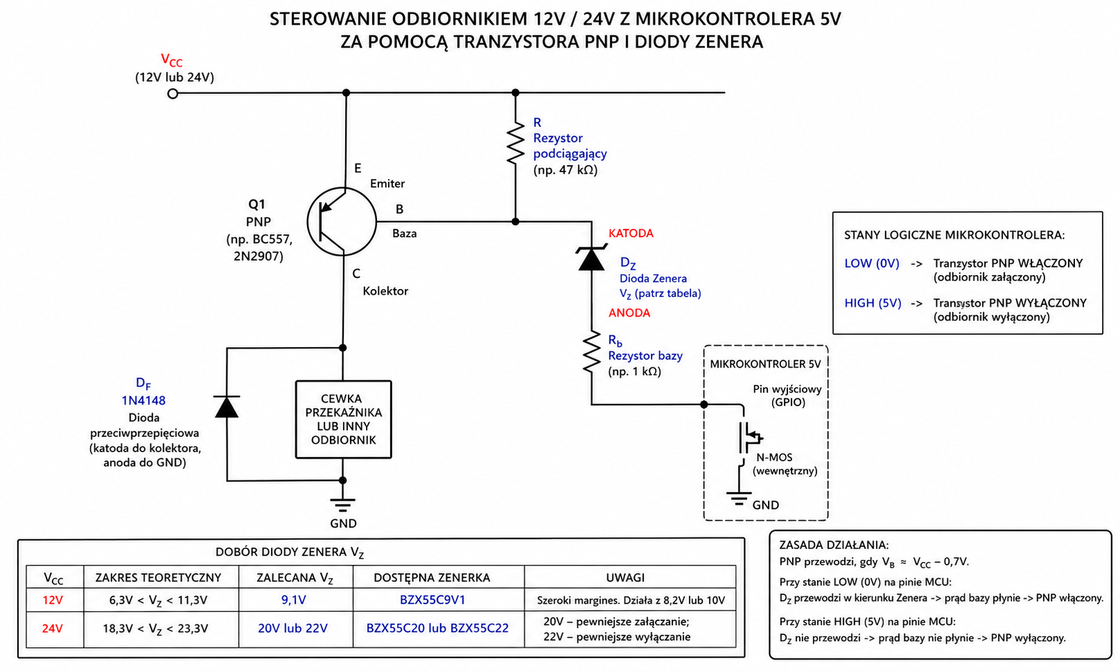

    Schematic diagram
                             V_CC (12V lub 24V)
                            ┌─┴─┐                    │    R  │ Rezystor podciągający przy braku przewodzenia diody zenera
                             Emiter                     │         │
                PNP          │                               |
            (np. BC557) │  Baza ───────┐
                                  │                        ┌─┴─┐ Katoda
                             Kolektor                 │  Dz  │
                                  │                        └─┬─┘ Anoda
                                  │                        │  Rb  │  rezystor bazy
                                  │                        │         │  (1kΩ)
                                  │                do pinu wyjściowego
                                  │                   mikrokontrolera
                            Cewka
                               GND

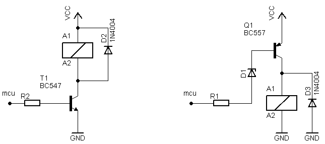

    You will forgive me, but in practice your colleague's solution contains one more element than the classic solution with the NPN transistor and is more susceptible to fluctuations in the supply voltage.Just a jump of a few V and all the relays will switch on.
    While with a 12V supply a few volts is quite a lot, with 24V (the voltage used in industry) it is no longer so rosy.
    Two relay driver schematics: NPN BC547 and PNP BC557 with 1N4004 diodes and base resistors

    The schematic is a bit off, I drew using the GPT Image 2 model
    Diagram: controlling a 12/24 V load from a 5 V MCU using a PNP transistor and Zener diode
    (I hope the model is not wrong)

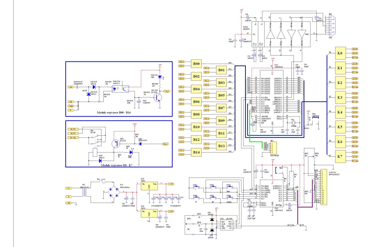

    Added after 5 [minutes]:
    aND here is one "quibble" to the value of the diode at 24V. because ideally you would give a 20.8V diode then you would have to assemble it from two 19V and a 1V8.... Also, it's not that the solution is better or worse..... just that I've come across many attempts to control with a PNP transistor and in all cases the authors gave up because they found it impossible.... and yet...
    Added after 1 [minute]:

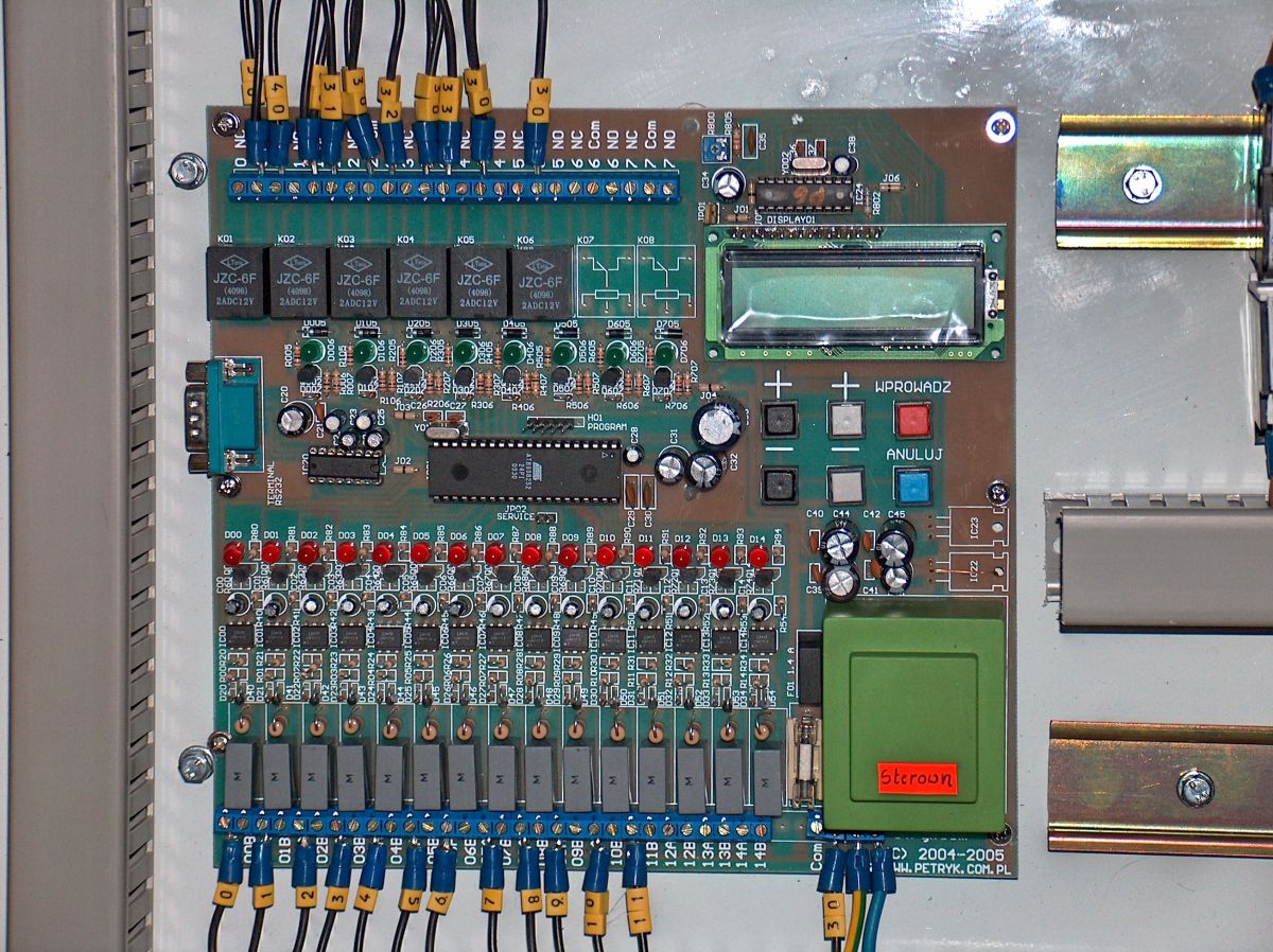

    e.g. AT89S8252, AT89C2051 etc, etc... i have dozens (if not hundreds) more of them backlogged.....
    Added after 6 [minutes]:
    and lest it be that it wasn't me or that it wasn't there :)
    Controlling a 12V relay directly from a 5V MCU using a Zener diode and a PNP transistor
    Added after 4 [minutes]:

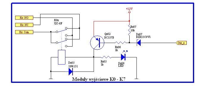

    i even managed to find a diagram of the whole thing which I attached....

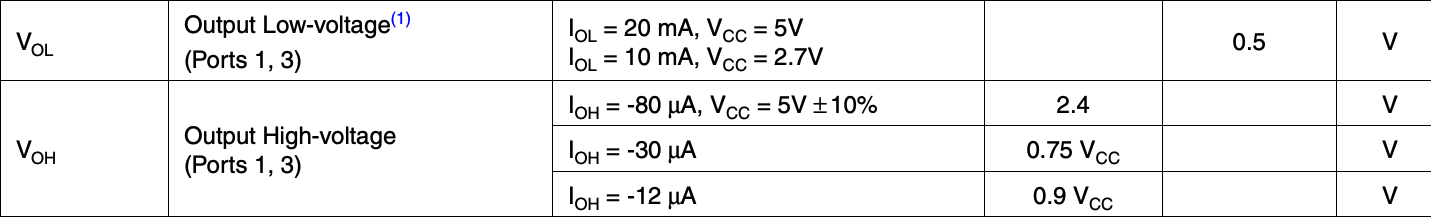

    In the case of the 8051, controlling the logical 'zero' in this way makes sense, because before the processor reset, in the circuit if the processor controlled the NPN transistor, all relays would switch on for a while.

    e.g. AT89S8252, AT89C2051 etc, etc.... i still have dozens (if not hundreds) of them backlogged.....
    Except they don't have a "1" on the output, which at start-up is the input. They have a pull-up. All you need is a 2.2k resistor to ground to bring this below the transistor trip threshold.

    kulmar wrote:
    Sam Sung wrote:
    OK, and then how to programmatically override the transistor trip threshold?
    Issue a logic one to the port.
    I thought it was obvious :) This extra resistor will load the output with 2mA - with mains power it doesn't matter.

    viayner wrote:
    I understand that this is a rhetorical question or rather the colleague did not look at the picture before inserting?
    I simulated it in LTspice and I have 11 volts on the output pin (GPIO), which is rather not the point.
    Informative: I just redrew the schematic knocked down in ASCII from the first post when testing the pictorial model, the task was not to analyse the schematic or simulate it or correct the symbols, it was to be redrawn ASCII.

    kulmar wrote:
    Issue a logical single to the port.
    I see it poorly with these parameters:
    These ports do not have complementary pairs at the output
    The author's solution is not very elegant but it works. I would use a stage with a common base, as suggested earlier. Or better still, I would make a hardware watchdog that applies power to the relays only when there is a square wave on a specific uC pin. This is implementable on several elements (common to all relays). You can then go back to controlling the relays by ground, which allows you to use one NPN transistor and a resistor. In sum, the circuit will be simpler than these zeners and resistors

    krzbor wrote:
    kulmar wrote:
    I thought it was obvious :) This extra resistor will load the output with 2mA current - with mains power it doesn't matter.
    This is what I was worried about. I don't think you are aware of how the GPIO on the AT89CX051 works. Well, the logic single exposed to the port is no different from the high state during reset, which is the recommended pull-down:
    krzbor wrote:
    2.2k to ground
    .... nullifies transistor switching not only during reset :(

    Sam Sung wrote:
    will nullify transistor switching not only during reset
    Then what is the current output of the pin in OUT mode? 2mA?

    krzbor wrote:
    What is the current output of the pin in OUT mode? 2mA?
    About 0.1mA (100uA)

    krzbor wrote:
    That is, what is the current output of the pin in OUT mode? 2mA?
    There is no such thing as "OUT mode"; there is only a weak one or a strong zero.

    The proposed solution is of 'amateur-partisan class'. It is suitable for a specific case. Apart from the fact that there is nothing revealing about it, it is electronically inelegant, unprofessional and just plain wrong. There is absolutely nothing to admire, let alone praise, in the context of using a Zener diode as a level shifter. And even this circuit itself could have been done better if the author had had a better idea of the components and circuits.
    If the task is: use at most one transistor by force, then the author gets half a point. He would get a whole point if he did not use a transistor at all, but used a relay that can be driven directly from 5V using the available current capacity of the processor output in the low state.
    On the other hand, if the task was: drive any relay low state, it should be done decently with two transistors. Two transistors and one resistor would suffice, resulting in fewer components and being absolutely reliable and independent of the supply voltage. Because the requirement (in principle) to stabilise the power supply to the relay coil is a sick assumption - what's the saving?
    It should also be noted that Zener diodes, can have unpleasantly high currents below the nominal voltage. Especially those diodes of slightly higher power. The result known in such a specifically poorly designed circuit.

    elukam wrote:
    The proposed solution is of 'amateur-partisan class'. It is suitable for a specific case. Apart from the fact that there is nothing revealing about it, it is electronically inelegant, unprofessional and just plain wrong. There is absolutely nothing to admire, let alone praise, in the context of using a Zener diode as a level shifter. And even this circuit itself could have been done better if the author had a better idea of the components and circuits.
    I disagree. Indeed, the approach is unusual and may create resistance to the unknown. Nevertheless, from an electronic point of view it is correct and works in an established, predictable way. From an economic point of view, the redundant use of unnecessary components is a non-technical approach, where the aim should be to fulfil the intended functions at the lowest possible cost.
    consent
    pawlik118 wrote:
    it may arouse resistance to the unknown
    And what is the unknown here? Unless the arrangement is unknown because it is unused because it is incorrect.
    The uC pin controls several components in series and there is a +12Vdc potential on the other side. In my opinion this is incorrect.
