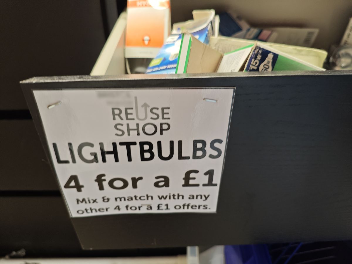

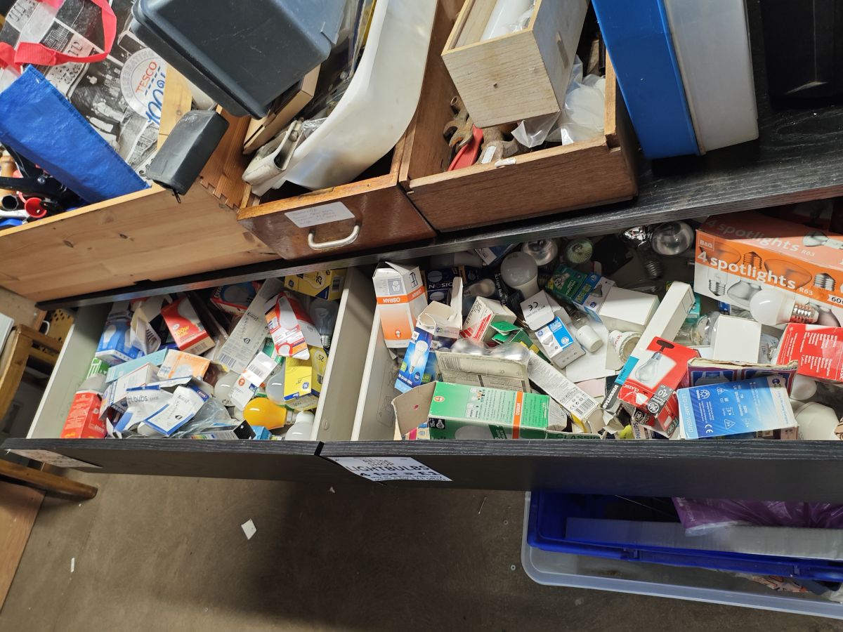

  • In the city where I live we have "Re-Use" shops alongside standard recycling centres (aka tips, dumps, household waste disposal facilities). These re-use centres are packed with donations and finds that would otherwise have gone into the general waste or recycled. Of course there's some stuff for sale that should probably have been binned, but a lot is fairly decent.
    This Re-Use centre in particular has 6 drawers of light bulbs.
    £1 Re-Use smart bulb finds: IKEA Tradfri LED2003G1, Ener-J SHA5262, unbranded PIR, Yichip YC1166 BT

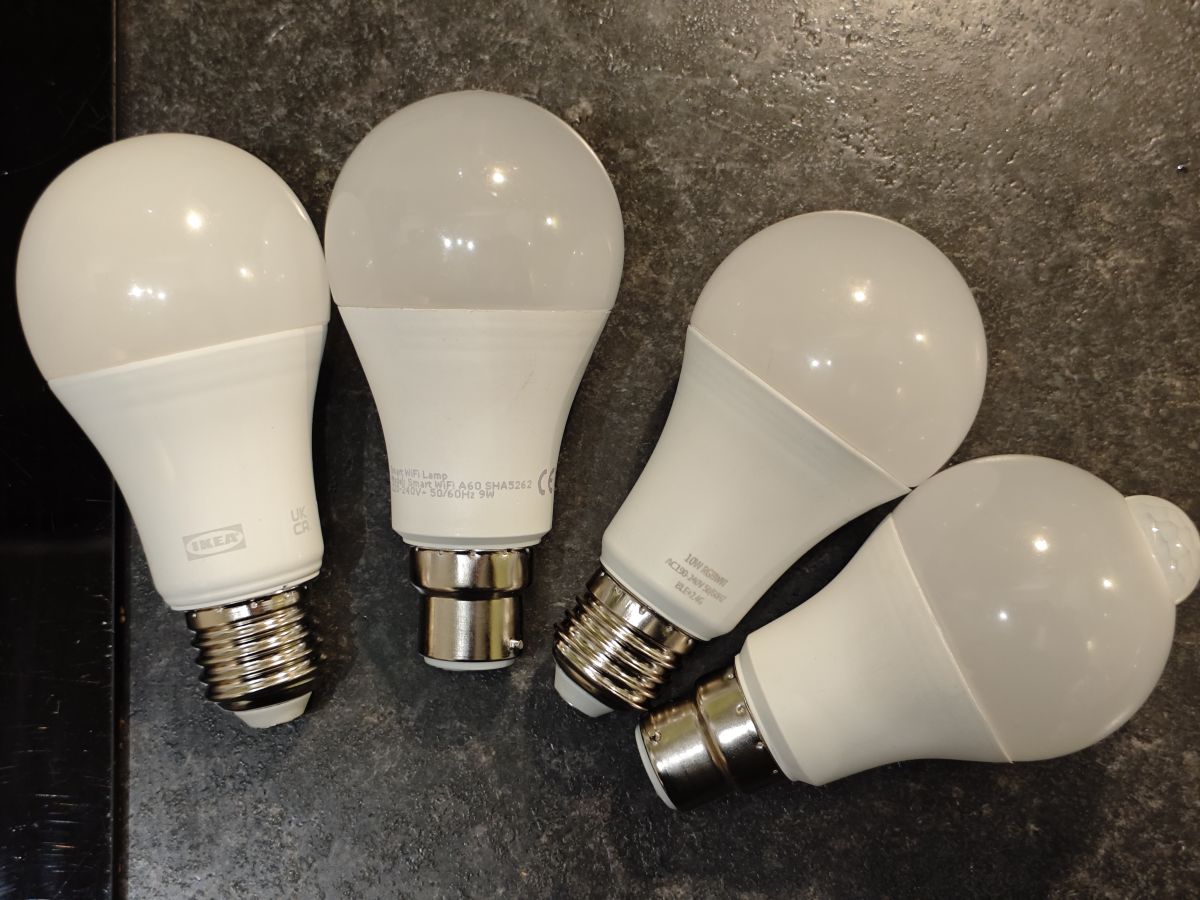

    and at £1 for 4 bulbs, £0.25p each, there's potential to find some interesting smart bulbs in amongst the boring fluorescent or incandescent mix for a bargain price
    I found my 4. There didn't appear to be any more worth having.

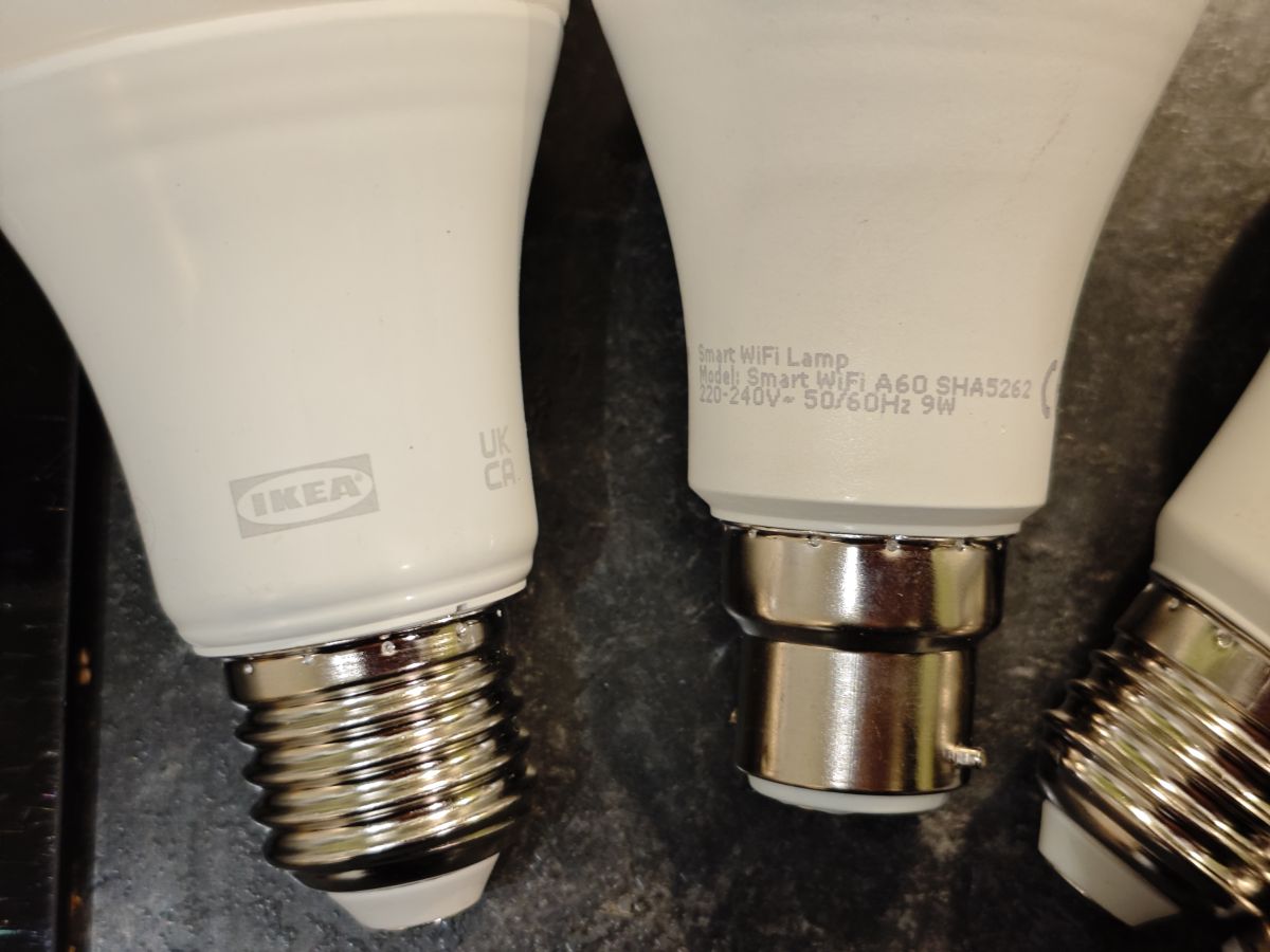

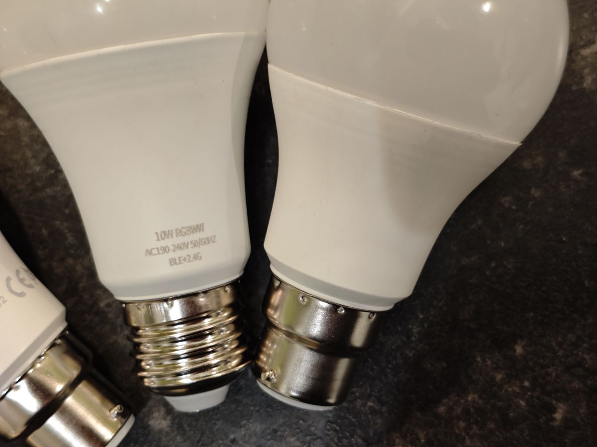

    1 Ikea Tradfri E27 LED2003G1
    1 Ener-J Smart WiFi A60 SHA5262 9w
    1 unmarked E27/A60 with PIR dome

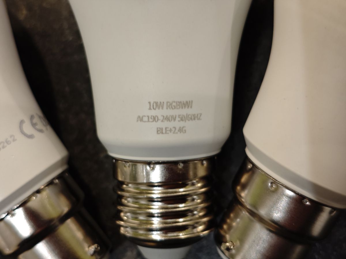

    1 unbranded 10w RGBWW BLE+2.4G
    £1 Re-Use smart bulb finds: IKEA Tradfri LED2003G1, Ener-J SHA5262, unbranded PIR, Yichip YC1166 BT£1 Re-Use smart bulb finds: IKEA Tradfri LED2003G1, Ener-J SHA5262, unbranded PIR, Yichip YC1166 BT£1 Re-Use smart bulb finds: IKEA Tradfri LED2003G1, Ener-J SHA5262, unbranded PIR, Yichip YC1166 BT£1 Re-Use smart bulb finds: IKEA Tradfri LED2003G1, Ener-J SHA5262, unbranded PIR, Yichip YC1166 BT£1 Re-Use smart bulb finds: IKEA Tradfri LED2003G1, Ener-J SHA5262, unbranded PIR, Yichip YC1166 BT

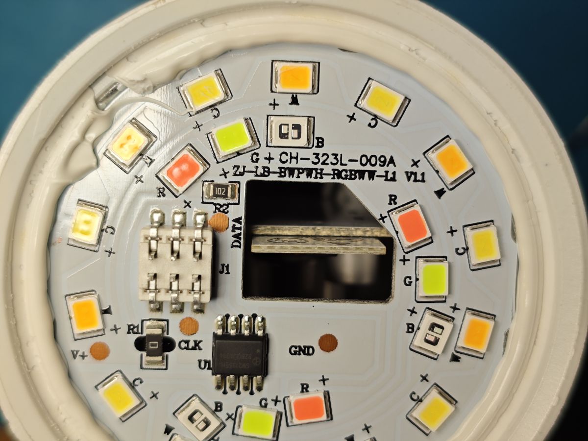

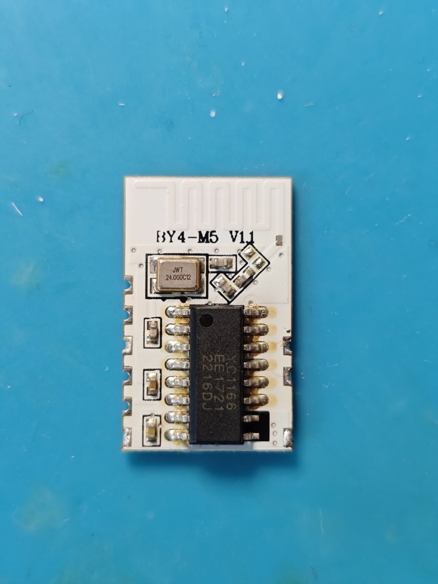

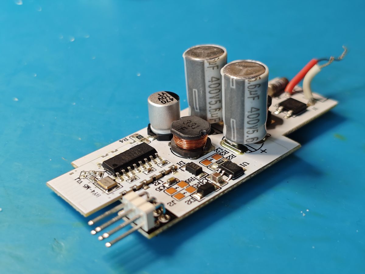

    I started with the generic RGBWW BLE+2.4G
    £1 Re-Use smart bulb finds: IKEA Tradfri LED2003G1, Ener-J SHA5262, unbranded PIR, Yichip YC1166 BT£1 Re-Use smart bulb finds: IKEA Tradfri LED2003G1, Ener-J SHA5262, unbranded PIR, Yichip YC1166 BT£1 Re-Use smart bulb finds: IKEA Tradfri LED2003G1, Ener-J SHA5262, unbranded PIR, Yichip YC1166 BT£1 Re-Use smart bulb finds: IKEA Tradfri LED2003G1, Ener-J SHA5262, unbranded PIR, Yichip YC1166 BT£1 Re-Use smart bulb finds: IKEA Tradfri LED2003G1, Ener-J SHA5262, unbranded PIR, Yichip YC1166 BT£1 Re-Use smart bulb finds: IKEA Tradfri LED2003G1, Ener-J SHA5262, unbranded PIR, Yichip YC1166 BT£1 Re-Use smart bulb finds: IKEA Tradfri LED2003G1, Ener-J SHA5262, unbranded PIR, Yichip YC1166 BT£1 Re-Use smart bulb finds: IKEA Tradfri LED2003G1, Ener-J SHA5262, unbranded PIR, Yichip YC1166 BT£1 Re-Use smart bulb finds: IKEA Tradfri LED2003G1, Ener-J SHA5262, unbranded PIR, Yichip YC1166 BT£1 Re-Use smart bulb finds: IKEA Tradfri LED2003G1, Ener-J SHA5262, unbranded PIR, Yichip YC1166 BT£1 Re-Use smart bulb finds: IKEA Tradfri LED2003G1, Ener-J SHA5262, unbranded PIR, Yichip YC1166 BT£1 Re-Use smart bulb finds: IKEA Tradfri LED2003G1, Ener-J SHA5262, unbranded PIR, Yichip YC1166 BT£1 Re-Use smart bulb finds: IKEA Tradfri LED2003G1, Ener-J SHA5262, unbranded PIR, Yichip YC1166 BT£1 Re-Use smart bulb finds: IKEA Tradfri LED2003G1, Ener-J SHA5262, unbranded PIR, Yichip YC1166 BT

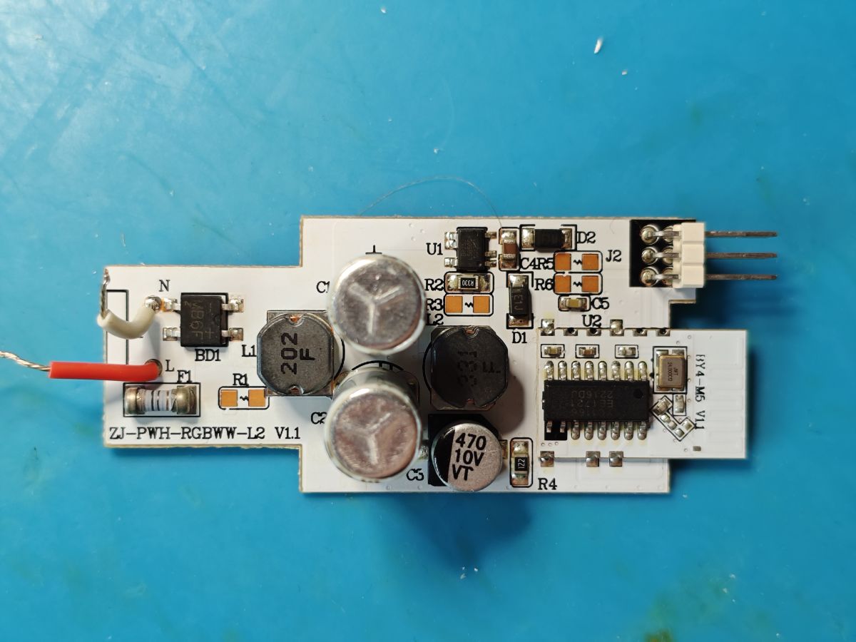

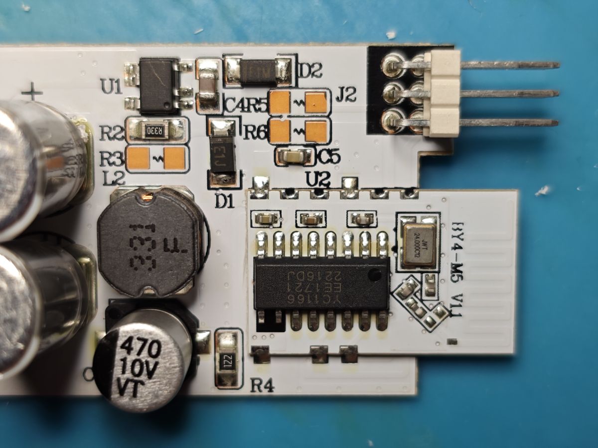

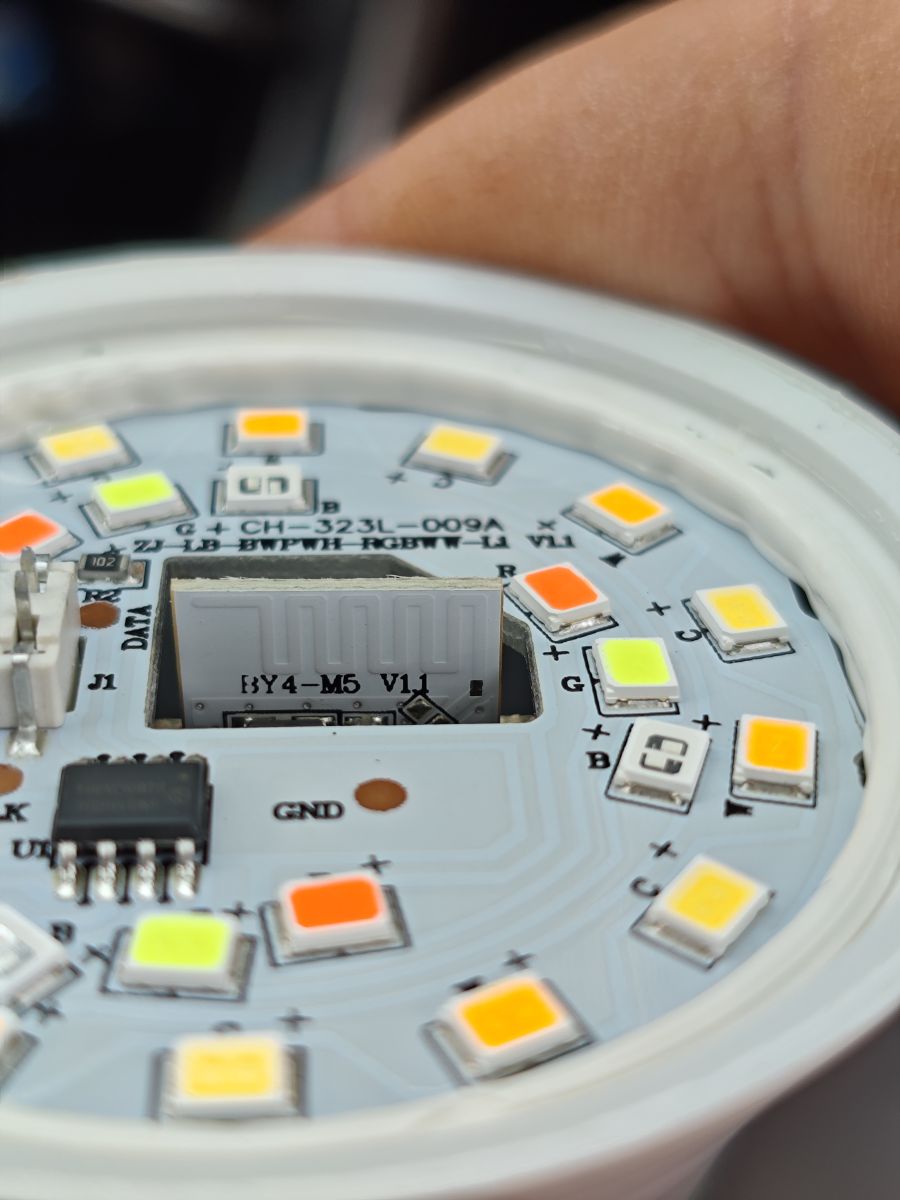

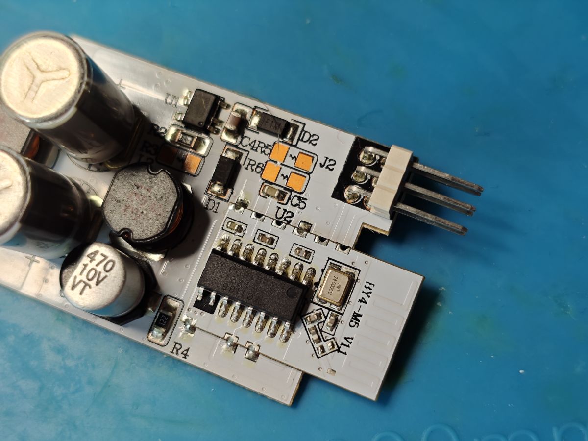

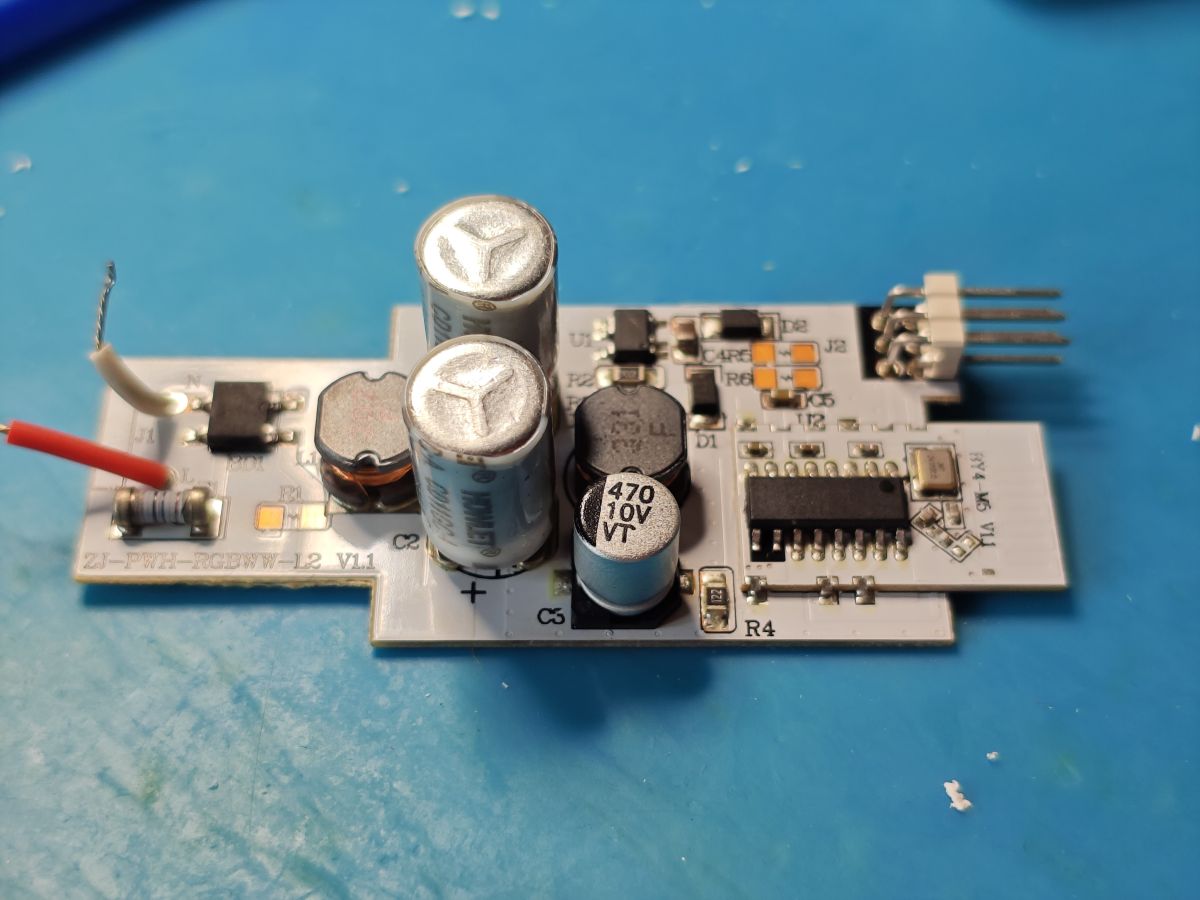

    This is Zengge device with YiChip YC1166 MCU at its heart on a module marked
    BY4-M5 V1.1
    YC1166 Yichip Microelectronics (Hangzhou) Co., Ltd.
    Radio:
    Bluetooth 5.0 BR/EDR/BLE
    Also described as supporting proprietary 2.4 GHz operation
    2.4 GHz ISM band, single-ended RFIO
    Advertised data rates: 250 kbps, 1 Mbps, 2 Mbps, 3 Mbps
    BLE sensitivity quoted around -95 dBm
    TX power quoted up to +9 dBm
    CPU / architecture:
    Dual-core digital architecture
    Application core: ARM Cortex-M0, up to 48 MHz
    Link-management core: 32-bit custom/RISC core
    M0 memory listed as 16 KB Data RAM + 16 KB cache / code RAM
    Link core memory listed as 80 KB ROM, 64 Kbit OTP, 8 KB patch RAM and 8 KB data RAM
    Flash / storage:
    Internal QSPI-connected 4 Mbit/512 KB internal flash

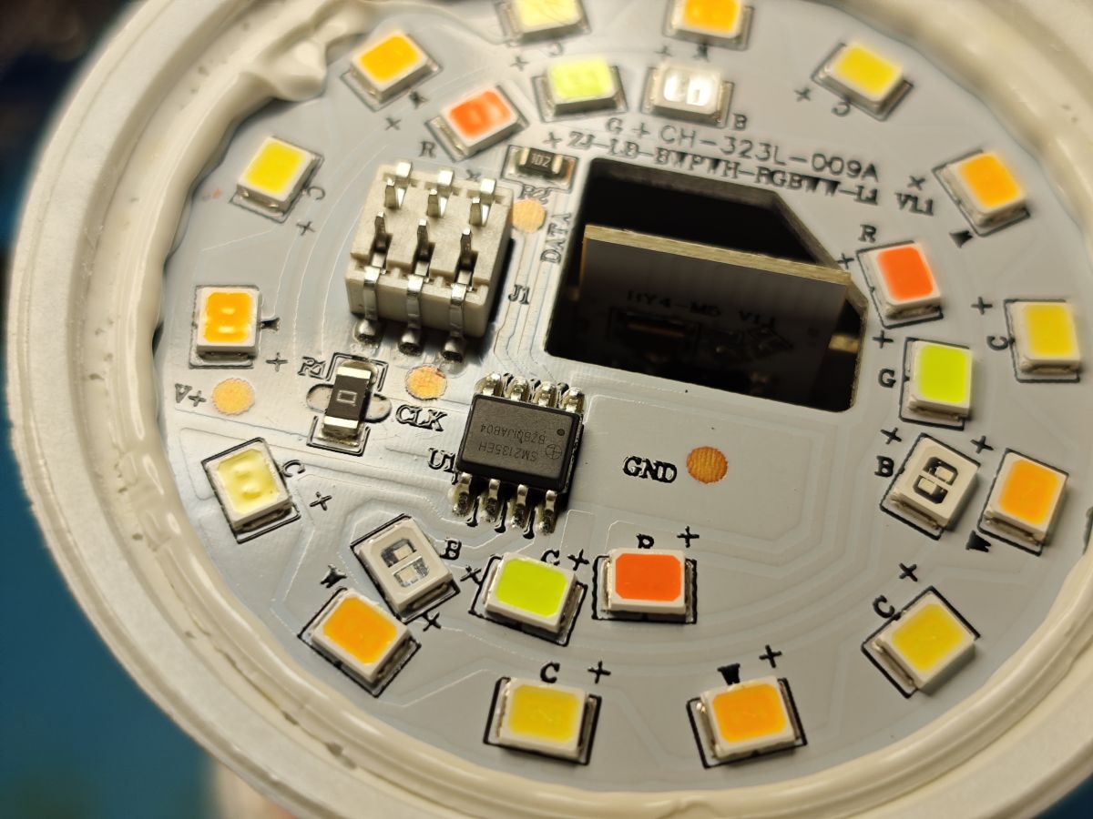

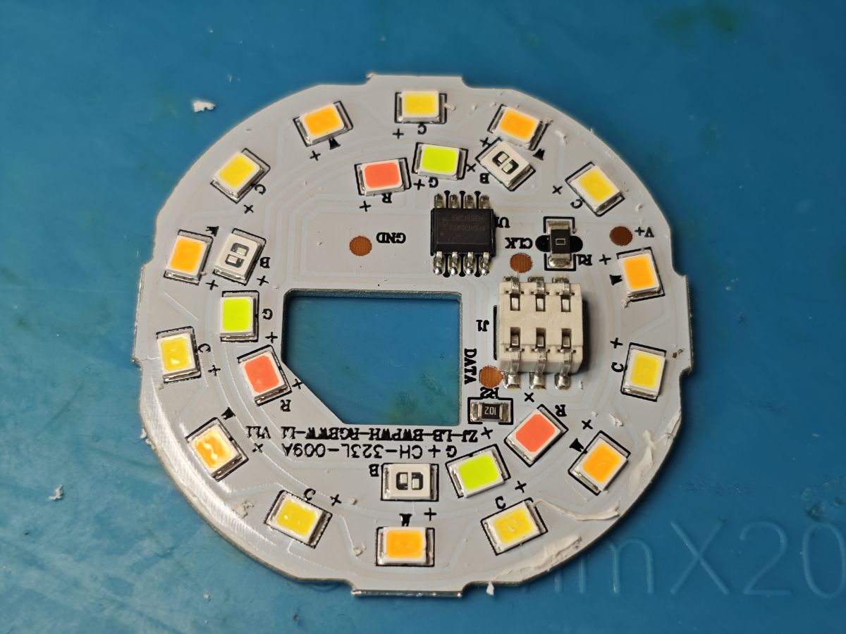

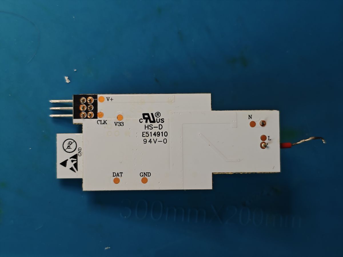

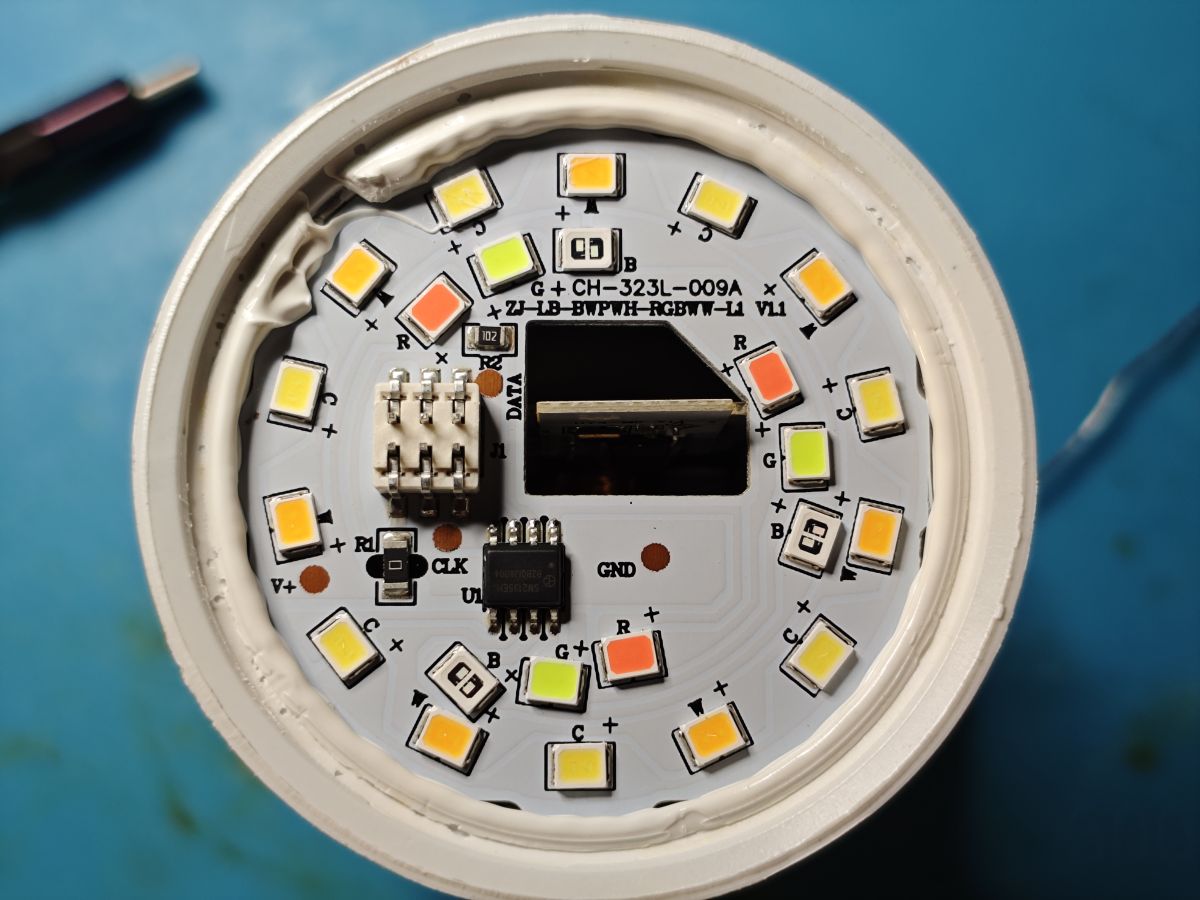

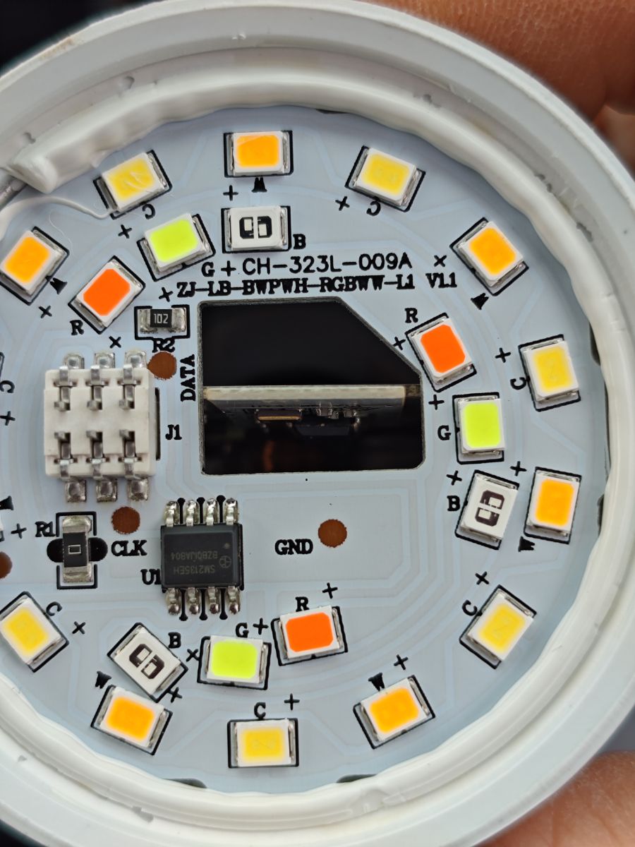

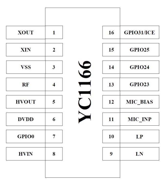

    On the LED disc we have an SM2135EH - a 5-channel intelligent dimming LED constant current driver for low power LEDs. The DAT/CLK pads on the rear of the bulb's main PCB unfortunately go to the SM2135H and don't appear to be for use in programming the YC1166, which seems to use some proprietry single-wire protocol. Yichip bluetooth MCUs are programmed through the dedicated ICE/IO31 pin.

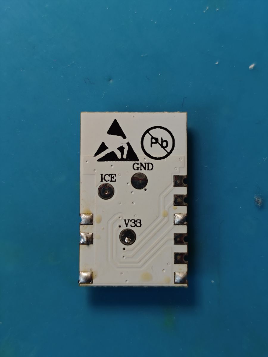

    I've not found much about this ICE pin apart from that a Yichip programmer has appeared on Ali Express before https://www.digitalworldz.co.uk/threads/yichip-programming.477322/post-2786057
    To my surprise IO31 had a debug log out at 921600 baud:
    interesting, "PPlus_SUCCESS" is seen in PHY code.

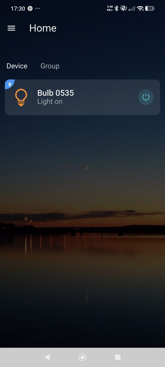

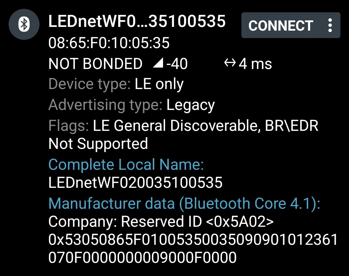

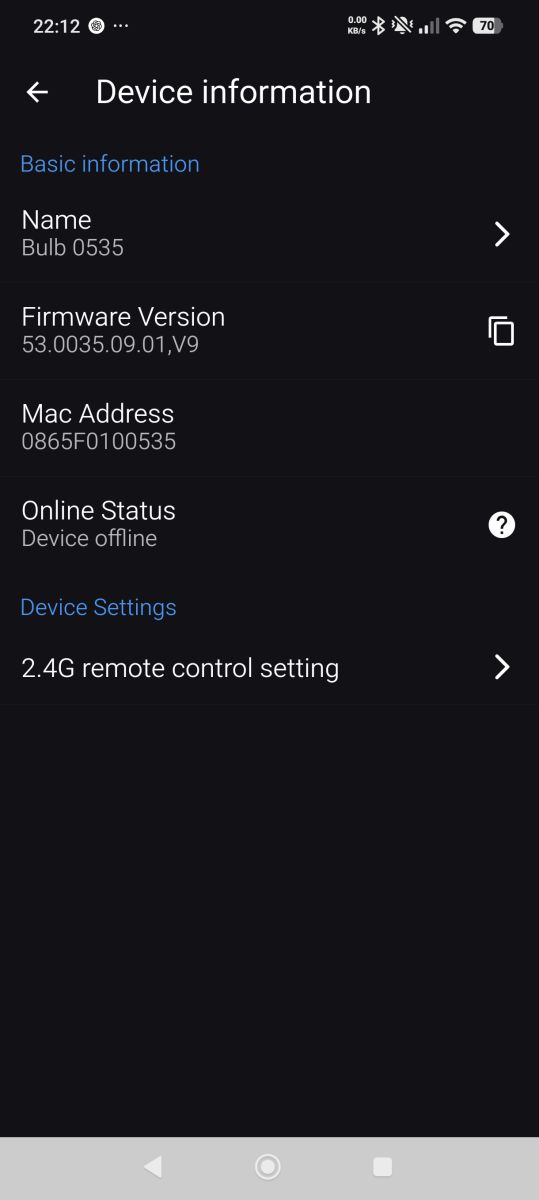

    For the bulb's operation, pairing mode seem to be achievable with rapid on-off-on-off-on-off action, but even then it was pretty hit-and-miss.
    Only the "Zengge" named app of all the Zengge-made apps seemed to pick it up. It would stop responding after a couple of on/offs.
    nRF Connect

    other markings:
    ZJ-PWH-RGBWW-L2 V1.1
    CH-323L-009A
    ZJ-LB-BWPWH-RGBWW-L1
    I'll work through the others next and post further updates as and when I can

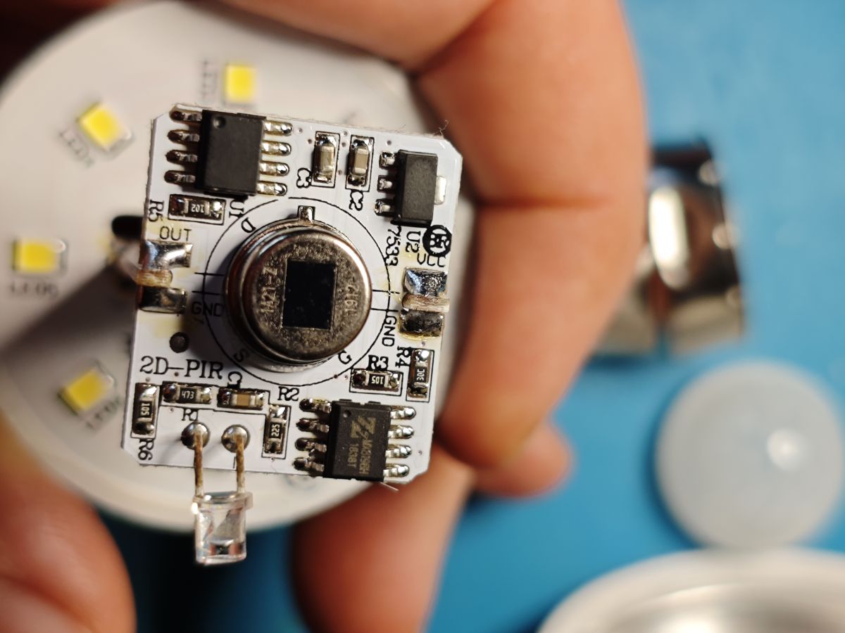

    Basic PIR bulb identified with MX8198H sensor
    #2 21897152
    Posts: 5220
    Help: 449
    Rate: 918

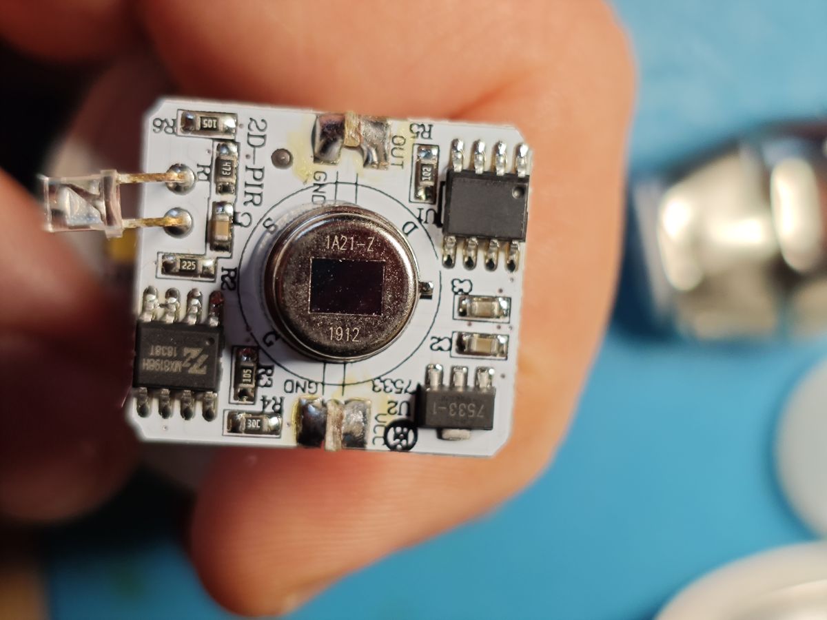

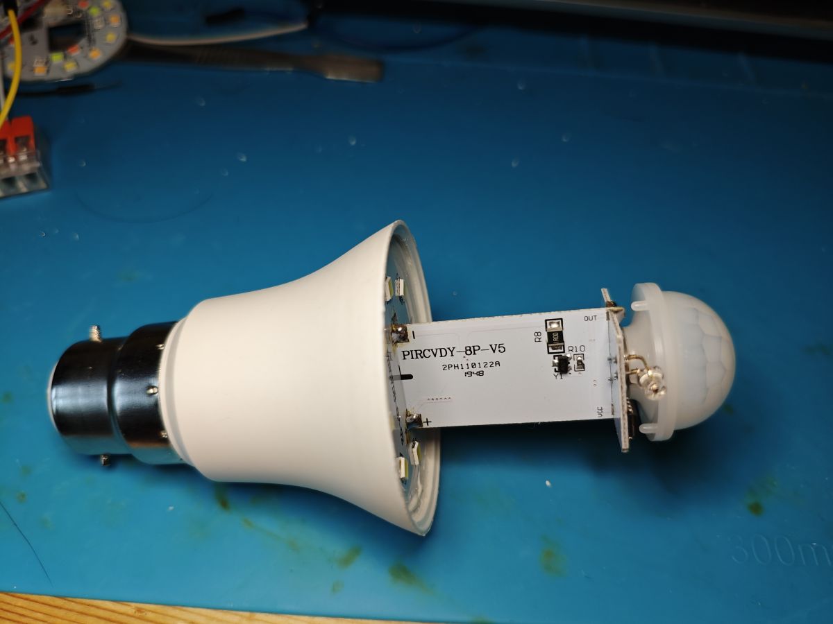

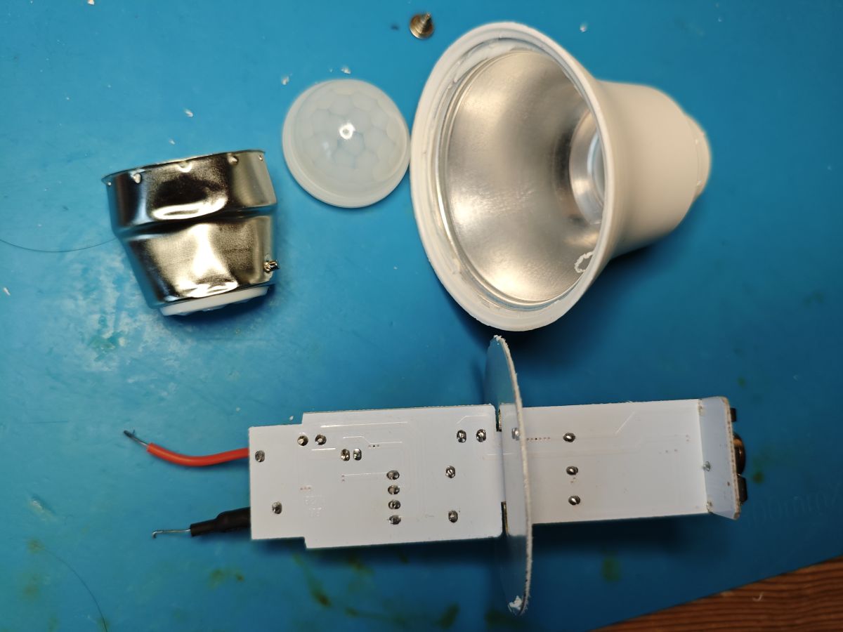

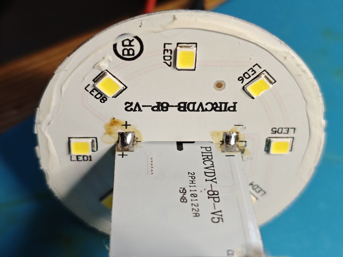

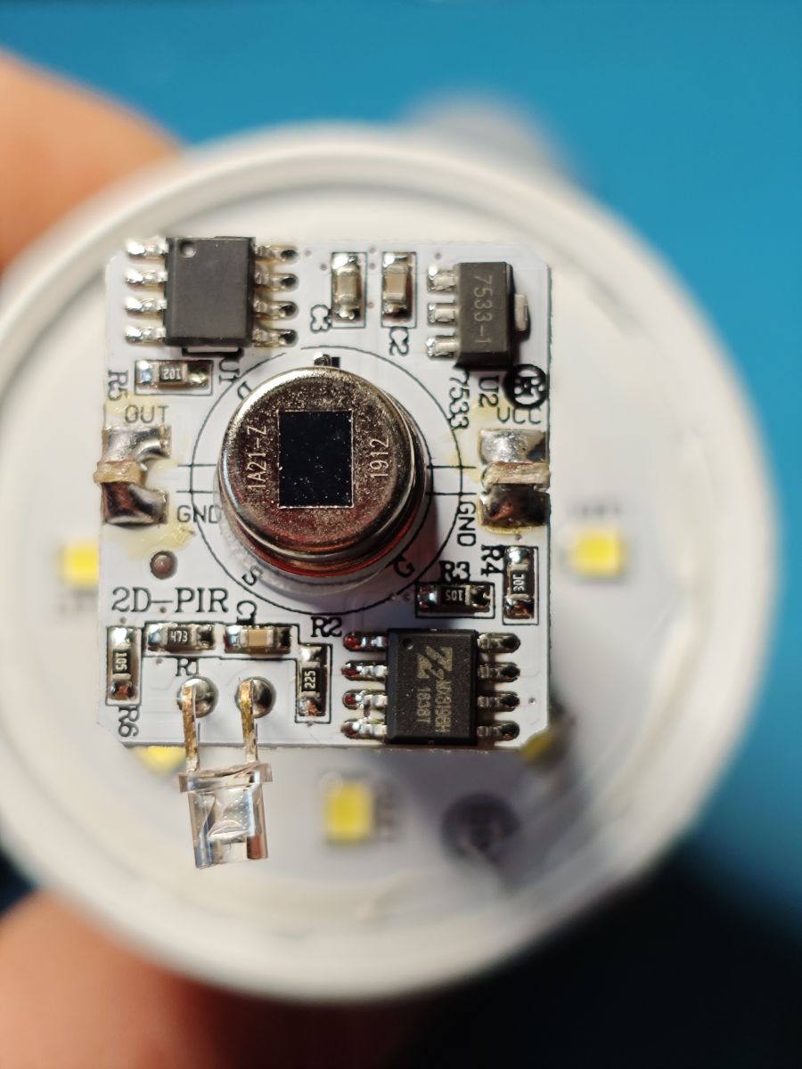

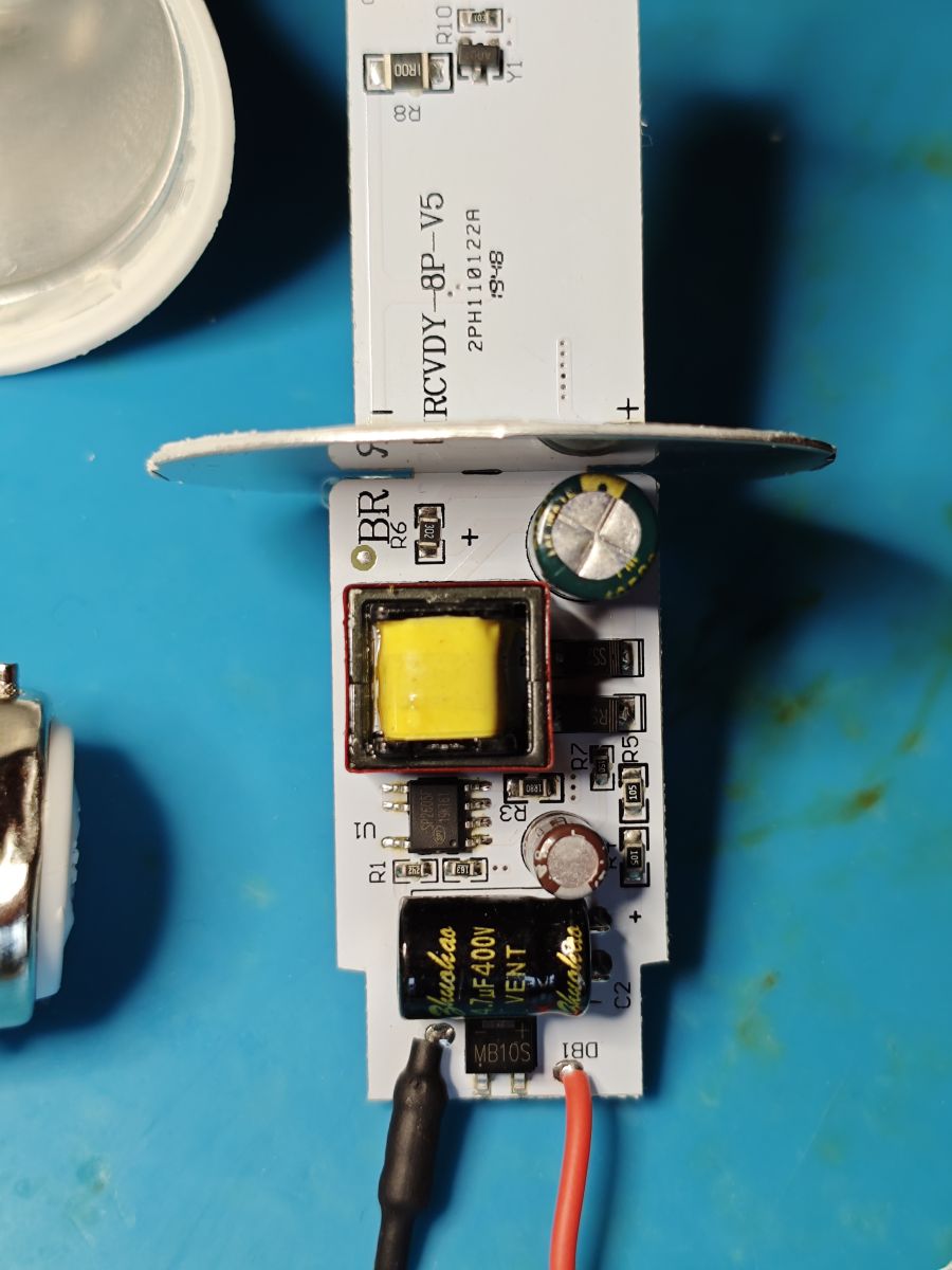

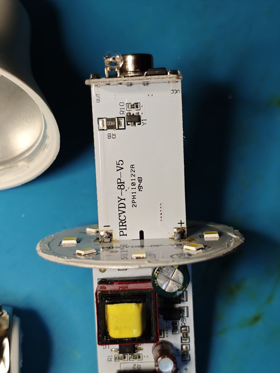

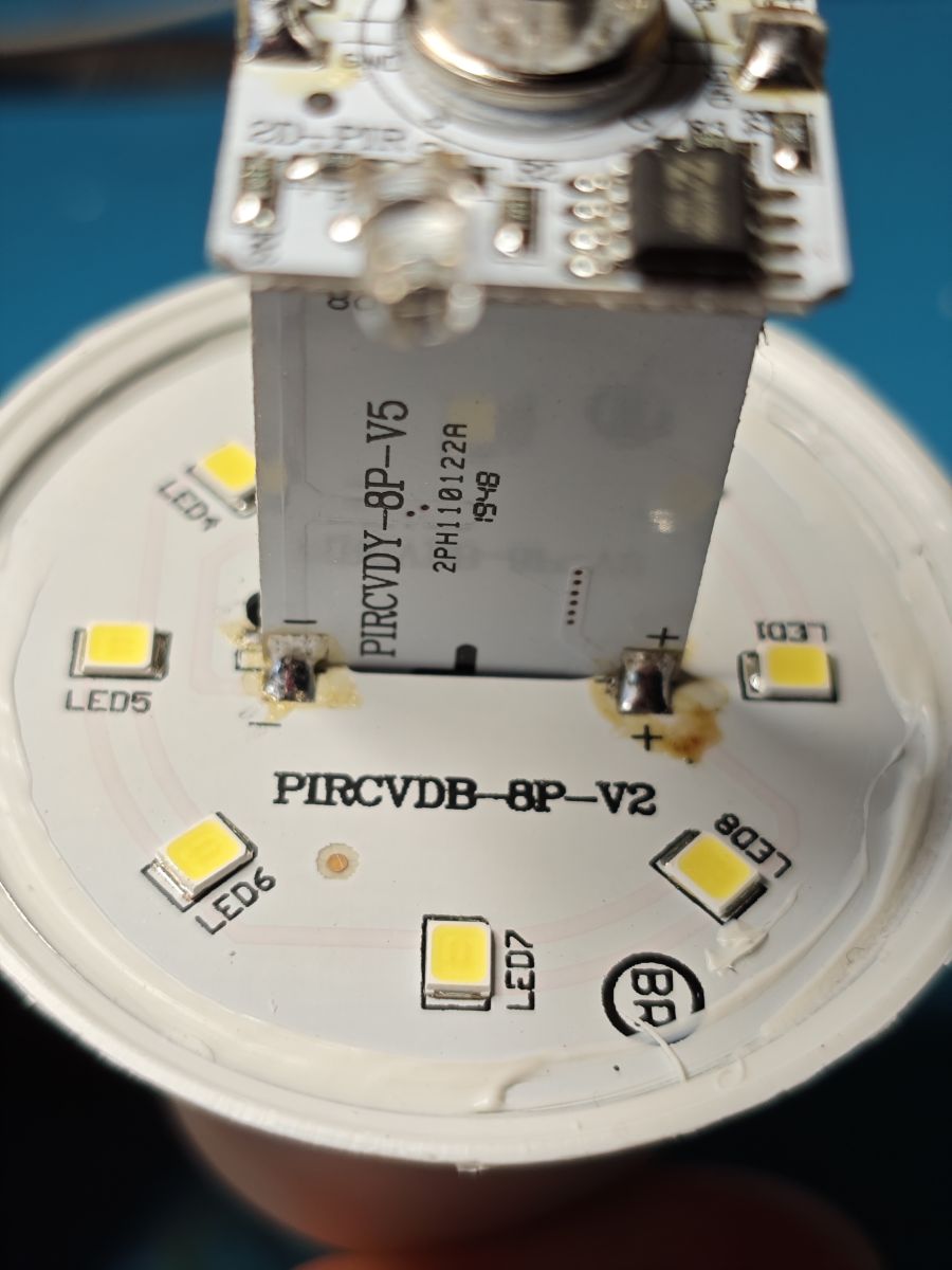

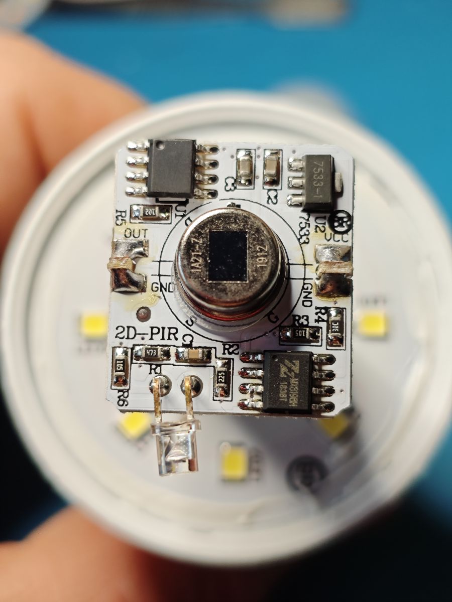

    second bulb. let's get this potentially non-smart one out of the way.
    and .. it's a basic PIR LED bulb :(
    Disassembled LED bulb with PIR motion sensor and an exposed circuit board moduleClose-up of an LED PCB with a PIR module and markings “PIRCVDY-8P-V5” and “PIRCVDB-8P-V2”Close-up of a PIR sensor PCB with a TO-5 metal can and SMD ICs, mounted over an LED bulbClose-up of a PIR sensor PCB in front of a disassembled LED bulbDisassembled PIR LED bulb parts: reflector housing, Fresnel lens, and PCB with red and black wires on blue matClose-up of a PCB with transformer, capacitors, and an IC on a blue backgroundClose-up of an LED driver PCB with transformer, capacitors, and marking PIRCVDY-8P-V5Close-up of LED bulb electronics: PIRCVDY-8P-V5 board on a round SMD LED module with transformer belowClose-up of LED PCB with four SMD LEDs and “PIRCVDY-8P-V5” marking plus +/− solder padsPCB module with 1A21-Z PIR sensor and SMD chips, held between fingersClose-up of a PIR sensor PCB with a metal can sensor and SMD chips, held in a hand
    markings:
    PIRCVDY-8P-V5
    PIRCVDB-8P-V2
    2PH110122A
    MX8198H (Sinotech Mixic) (related to MX8098 - a SOP8 pyroelectric infrared/PIR control IC for passive infrared motion detection?)
    1A21-Z (Tranesen Optoelectronics Co., Ltd)
    https://roboparts.ru/upload/iblock/493/493fc13e4e254a79251e138edb414ac2.pdf

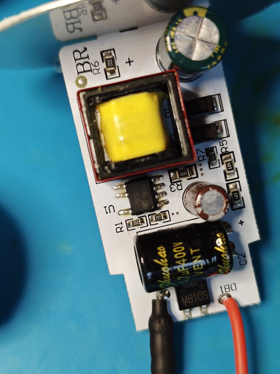

    this one is.

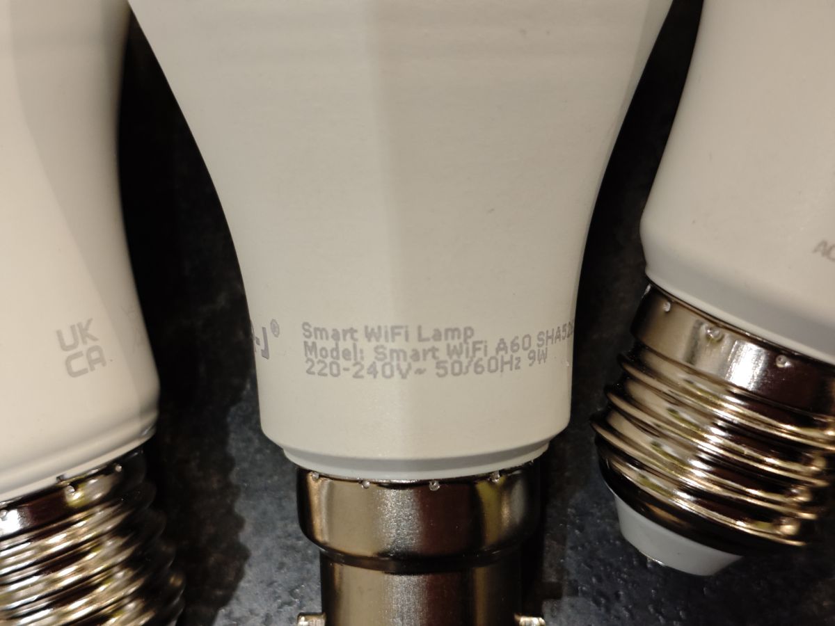

    Ener-J SHA5262 - https://enerjsmart.co.uk/products/smart-colou...light-bulb-single-pack?variant=42590800347381
    £1 Re-Use smart bulb finds: IKEA Tradfri LED2003G1, Ener-J SHA5262, unbranded PIR, Yichip YC1166 BT£1 Re-Use smart bulb finds: IKEA Tradfri LED2003G1, Ener-J SHA5262, unbranded PIR, Yichip YC1166 BT£1 Re-Use smart bulb finds: IKEA Tradfri LED2003G1, Ener-J SHA5262, unbranded PIR, Yichip YC1166 BTRound LED PCB with SMD LEDs in a ring and a small IC on a blue work matInside an LED bulb showing a PCB with a capacitor and a white labeled moduleGreen PCB with WB3L wireless module, capacitors, and a pin header on a blue work matGreen PCB with SMD components on a blue surface, with two wires exiting at the bottomClose-up of a PCB with SMD components and an SOIC integrated circuit on a blue backgroundCircuit board with capacitors, a wire lead, and a shielded RF module on a blue work matClose-up of a PCB with capacitors, a small transformer, and a shielded radio module on a blue work matSmall PCB with Wi‑Fi module, capacitors, transformer, and colored wires on a blue work matTwo electronic boards connected by wires on a blue work mat
    My first WB3L - a nice older Beken BK7231T module
    Pinout diagram of WB3L module with labels for GPIO, UART, I2C, SPI, PWM, ADC, and power pins
    from TX2:
    Pairs with Tuya
    “Add Device” screen showing ENERJ Smart Bulb A60 added successfully and a “Done” button.
    schema: 00000149dc
    keytg5kq8gvkv9dh
    pfyewd04anarmjjy
    and Tuya KV:
    OBK template
    markings:
    BP5778
    EL-A60-10X2 V7.7
    EL-DY-245 V7.1
    BP2513D

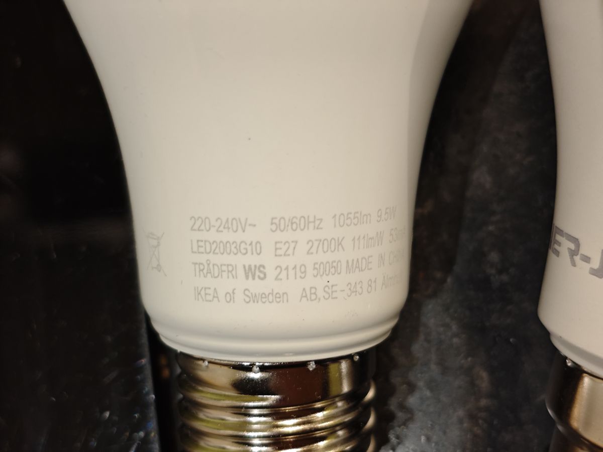

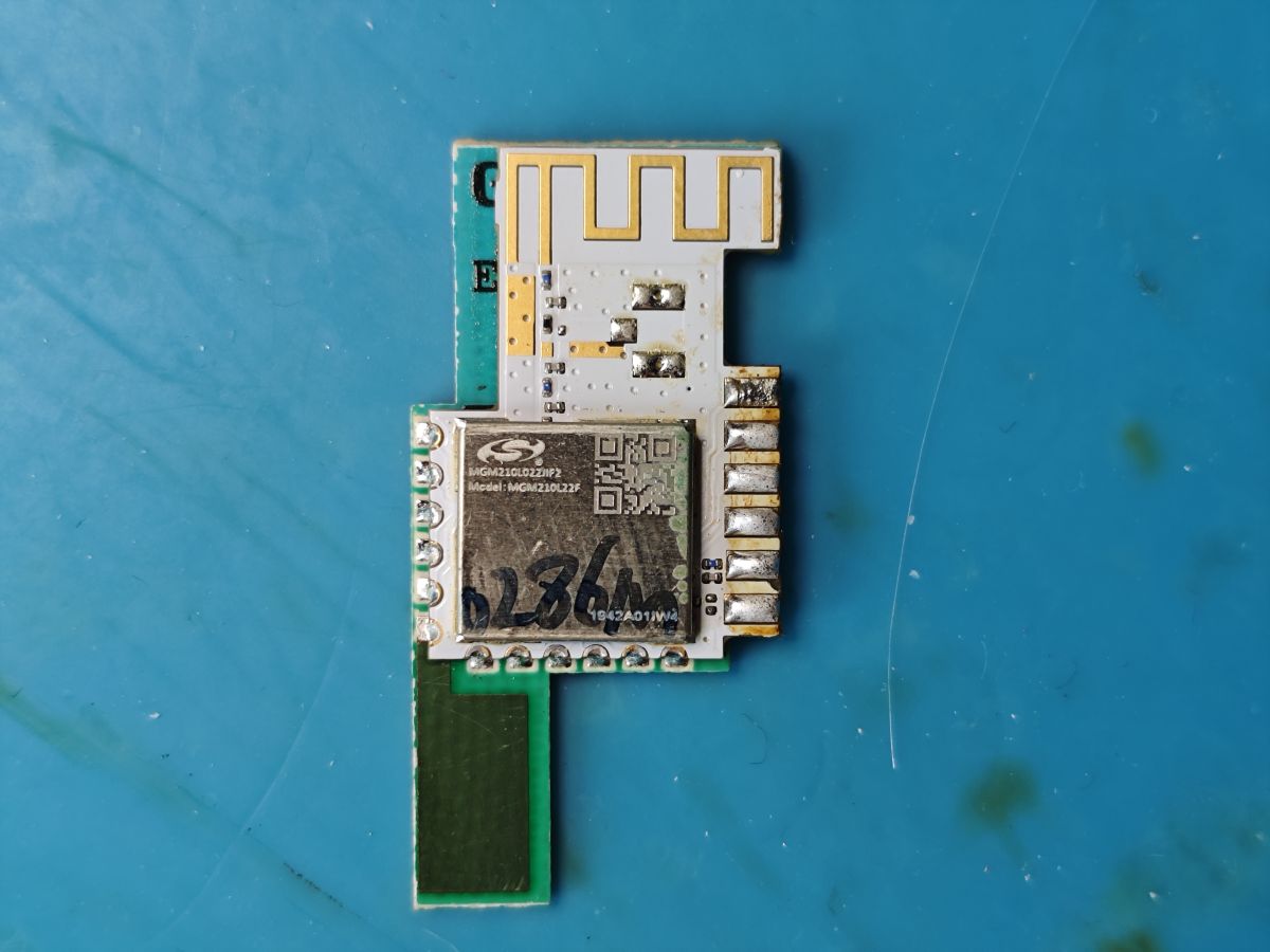

    The TRÅDFRI LED2003G10 (Zigbee, E27 globe, 1055lm, 9.5W, white spectrum) was a pain to get into. I had to get brutal and the externals of the device suffered for it.
    Of greatest interest to me is the Silicon Labs MGM210L02ZJIP2 (?), Model: MGM210L22F module.
    https://www.silabs.com/documents/public/data-sheets/mgm210l-datasheet.pdf
    1mb flash memory.

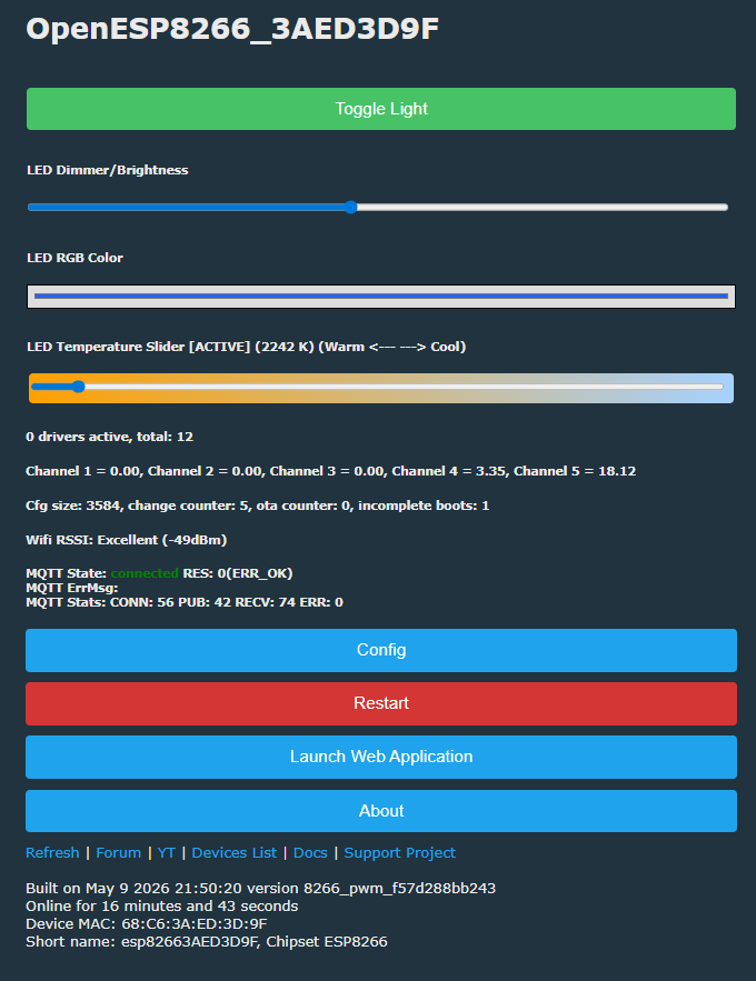

    It's running OpenESP8266 right now but it doesn't seem to like something with all the PWMs configured. It'll reboot into safe mode, flashing red LED several times as it does. Exit safe mode and it'll do that again and back into safe mode. I'll try to replicate on NodeMCU
    Added after 42 [minutes]:
    on reboot after saving same config on NodeMCU

    Regarding crash - can you narrow down which pin PWM is crashing? There are currently 5 pins in settings.
  • Grouped ESP8266 PWM init fixes boot crash
    #12 21899937
    Posts: 5220
    Help: 449
    Rate: 918
    I think it's because they're initialised one by one and not in a group at once
    testing
    https://github.com/openshwprojects/OpenBK7231...e3af3756ac03e60a57480fd07d81efeab410c3d2eR453
    Added after 39 [minutes]:
    OK that works, but it flashes very quickly on boot, I think because it's still doing:
    this next commit apparently:
    https://github.com/openshwprojects/OpenBK7231...mmit/20e765d33c6eb0149ad409c6194a19424ceee3e8

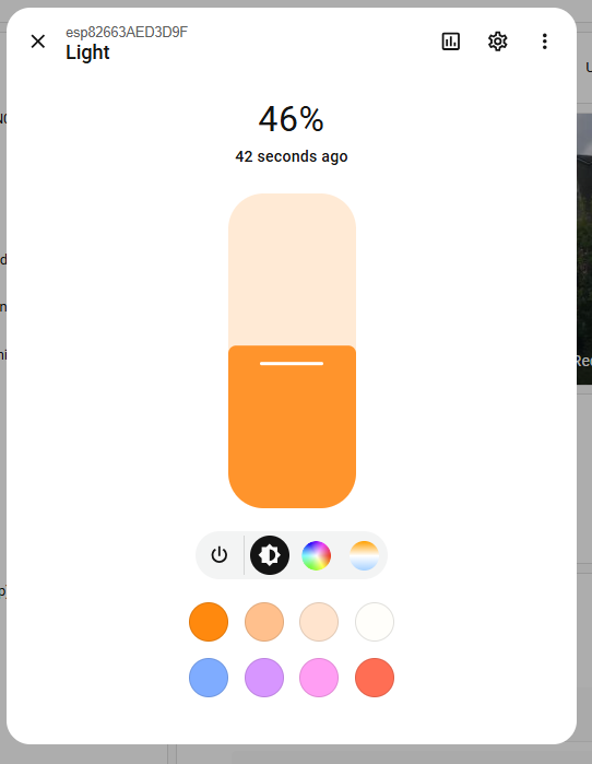

    Added after 8 [hours] 36 [minutes]:
    seems OK now. no LED-burst on boot, no burst of all LEDs when changing colours, colour picker in web gui and web app tools works without invoking other channels as it's used. dimmer, temperature works.
    Before:
    - ESP8266 LEDC compatibility layer was initialised/reinitialised per PWM pin.
    - Reboot with 5 PWM pins configured would crash with IllegalInstruction after first PWM setup.
    After:
    - ESP8266 PWM pins are queued during pin setup.
    - Native ESP8266 grouped PWM is initialised once after all pin roles are configured.
    - 5-channel PWM setup boots successfully.
    The changes in summary:
    The fix changes the ESP8266 HAL path. ESP32 and the other OpenBeken platforms are left alone. On OpenESP8266, PWM pins are now queued as OpenBeken processes the pin roles, then the native ESP8266 PWM driver is initialised once with the complete channel group. Duty updates then use the grouped PWM channels rather than repeatedly rebuilding the backend.
    OpenESP8266 PWM is now treated as a grouped software-PWM peripheral, not as per-pin ESP32-type LEDC.
    HA colour stuff is correct and works

    boot log showing PWM init shape:

  • Zengge app contains Yichip OTA firmware blobs
    #20 21904915
    Posts: 5220
    Help: 449
    Rate: 918
    >>21897048
    no break-throughs with the ICE protocol, but pulling apart the Zengge app XAPK reveals 4 OTA firmware blobs for Yichip bluetooth devices
    53_0035_08_01 being 1 build below the version in my bulb - 53_0035_09_01
    evidences
    | 53_0035_08_01.hex |
    ..\..\..\sdk\yzw_sdk\Librarier\drivers\uart\yc11xx_uart.c
    AK001-ZJ2158
    SM2135EH
    LEDnetWF...
    ZJ_BLE_ADAPTER_VER
    ZJ_BLE_OS_VER
    PPlus_SUCCESS
    | 53_0033_20_00.hex |
    ..\..\..\sdk\yzw_sdk\Librarier\drivers\pwm\yc11xx_pwm.c
    AK001-ZJ2158
    LEDnetWF...
    PPlus_SUCCESS
    | 5A_0052_2A_00.hex |
    AK001-ZJ2158
    LEDnetWF...
    enc ota
    PPlus_SUCCESS
    | 56_00AD_41_00.hex |
    AK001-ZJ21511
    IOTBT
    • Zengge_Yichip_bluetooth_ota_blobs.zip (202.56 KB) You must be logged in to download this attachment.

    The HAL-only version booted correctly and started ESP8266 PWM once with the full 5-channel group, and it seemed fine initially for a few basic colour selections, but it regressed on something I thought I'd fixed - the web GUI power button no longer behaved as a plain enable/disable toggle- it was cycling colours as well as on/off.
    I think the issue is that the HAL-only version tried to infer “PWM setup is complete” from normal
    HAL_PIN_PWM_Start/Update
    traffic. Those same update calls are also used by normal LED runtime commands, so startup/group-finalisation logic leaked into the ordinary LED control path.
    I’ve changed it back to an explicit ESP8266-only setup boundary: full pin setup queues the PWM group, finalises once, and after that normal LED commands only update duty on existing channels. ESP8266 PWM internals still stay in the HAL, but the full-setup boundary apparently needs to be explicit.
    new commit. not tested yet: https://github.com/openshwprojects/OpenBK7231...mmit/27a7b40eb2a706bfa96d09cdbc8ae4a01f44815d

A discussion about bargain smart-bulb finds from a Re-Use centre, where £1-for-4 mixed bulbs yielded several interesting devices: an IKEA TRÅDFRI LED2003G10 Zigbee E27 globe, an Ener-J Smart WiFi A60 SHA5262, an unmarked PIR LED bulb, and a Teckin SB50 RGBW bulb with ESP8266EX. The PIR bulb was identified as a basic passive-infrared LED lamp using MX8198H-related PIR control parts, not a smart device. The TRÅDFRI bulb was dismantled for inspection, and the Teckin bulb led to firmware and hardware work on OpenBK7231T/OpenBeken, including ESP8266 PWM handling fixes, grouped PWM startup/finalization in the HAL, and later regression fixes for LED color control and web GUI power-button behavior. Separately, the Yichip YC1166 Bluetooth bulb prompted discussion of BT proxy support and OTA firmware blobs extracted from the Zengge app XAPK.
TL;DR: At £1 for 4 bulbs, "there's potential" to find hackable smart lighting in a Re-Use bin. This FAQ helps buyers and tinkerers separate real smart bulbs from lookalikes, identify YC1166, WB3L/BK7231T, and PIR-only designs, and spot pairing or previous-owner lock-in issues before spending time on a teardown. [#21897048]

Unmarked E27 with dome Basic PIR LED bulb MX8198H + 1A21-Z PIR sensor Not a smart bulb
Unbranded RGBWW BLE+2.4G Zengge smart bulb YiChip YC1166 + SM2135EH Pairs inconsistently and stops responding after power cycles

  • The haul cost £1 for 4 bulbs, or £0.25 each, from a Re-Use centre bulb drawer. [#21897048]
  • The unbranded RGBWW bulb uses a YiChip YC1166 radio SoC and an SM2135EH 5-channel constant-current LED driver on a module marked BY4-M5 V1.1. [#21897048]
  • The YC1166 debug console appeared on IO31 at 921600 baud and reported firmware 53_0035_09_01 with build time 20211116. [#21897048]

  • The PIR bulb identifies a 1A21-Z analog pyroelectric sensor with 135° horizontal and 123° vertical field of view, plus 2–15 V operation and 12 µA typical current. [#21897152]
How do you identify worthwhile smart bulbs in a Re-Use shop bulb bin before buying them?
Check for brand labels, smart-light wording, radio clues, and unusual domes before buying. In this haul, plain visual sorting separated four interesting candidates from ordinary fluorescent or incandescent bulbs, but one "interesting" dome lamp still proved to be only a PIR bulb. Prioritize bulbs marked IKEA, Tuya-style brands, RGBWW, BLE, Wi‑Fi, or with model numbers you can later trace on the PCB. [#21897048]

It contains a Zengge module marked BY4-M5 V1.1 with a YiChip YC1166 MCU and an SM2135EH LED driver on the LED board. Other board markings include ZJ-PWH-RGBWW-L2 V1.1, CH-323L-009A, and ZJ-LB-BWPWH-RGBWW-L1. That combination points to a Bluetooth plus proprietary 2.4 GHz RGBWW smart bulb rather than a Tuya Wi‑Fi design. [#21897048]
How do you put the Zengge YC1166 Bluetooth bulb into pairing mode, and why is the process so hit-and-miss?
Use rapid power toggling, but expect unreliable entry into pairing mode. The thread describes this exact sequence:

What is the YiChip YC1166, and what are its Bluetooth, CPU, memory, and flash capabilities?
"YiChip YC1166 is a Bluetooth microcontroller that drives connected lighting, combining a dual-core design with integrated 2.4 GHz radio support." In this bulb, it is described with Bluetooth 5.0 BR/EDR/BLE, proprietary 2.4 GHz support, an ARM Cortex‑M0 up to 48 MHz, 16 KB Data RAM, 16 KB cache/code RAM, and 4 Mbit / 512 KB internal flash. The quoted RF figures include about -95 dBm BLE sensitivity and up to +9 dBm TX power. [#21897048]
What is the SM2135EH LED driver, and what role does it play in RGBWW smart bulbs?
"SM2135EH is a 5-channel intelligent dimming LED constant-current driver that controls low-power LED channels, including RGB and white outputs." In this bulb, it sits on the LED disc and handles the RGBWW emitters, while the YC1166 handles radio, logic, and effects. The rear DAT/CLK pads lead to the SM2135H family driver, not to the YC1166 programming interface. [#21897048]
How is the YC1166 programmed through the ICE or IO31 pin, and what does the 921600 baud debug log reveal about the firmware?
The thread indicates the YC1166 uses a proprietary single-wire method on ICE/IO31, not the nearby DAT/CLK pads. IO31 also exposed a live UART-style debug log at 921600 baud. That log reported PPlus_SUCCESS, firmware version 53_0035_09_01, build time 20211116, ZJ_BLE_ADAPTER_VER 2.0.1_build0, LIGHT_VERSION 0.0.3_build0, and LED-driver initialization lines tied to SM2135EH. [#21897048]

What did the teardown of the unmarked E27 bulb with a PIR dome reveal, and which PIR parts were identified inside it?
It revealed a basic PIR LED bulb, not a networked smart bulb. The teardown identified board markings PIRCVDY-8P-V5, PIRCVDB-8P-V2, and 2PH110122A, plus an MX8198H control IC and a 1A21-Z analog pyroelectric PIR sensor. That parts list matches a motion-activated lamp architecture rather than Bluetooth, Zigbee, or Wi‑Fi smart lighting. [#21897152]
What is the 1A21-Z pyroelectric PIR sensor, and what do its field-of-view and electrical specs mean in practice?
"1A21-Z is an analog pyroelectric PIR sensor that detects motion by sensing infrared changes, using a TO-5 metal-can package and very low current draw." The thread lists 135° horizontal and 123° vertical field of view, 2–15 V operating voltage, 12 µA typical current, and 28 µVpp typical noise. In practice, those numbers fit a wide-angle, low-power motion lamp front end. [#21897152]
