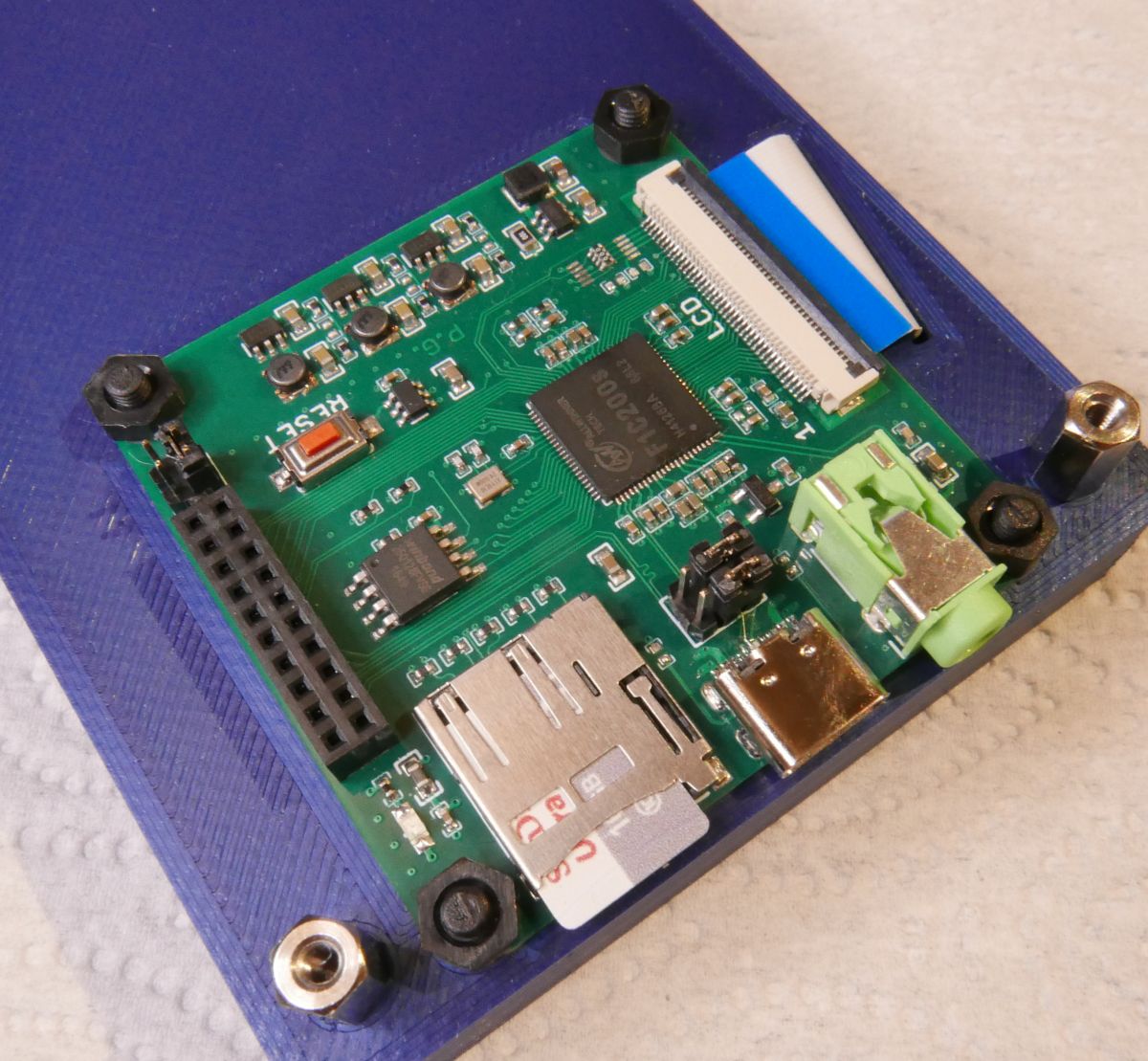

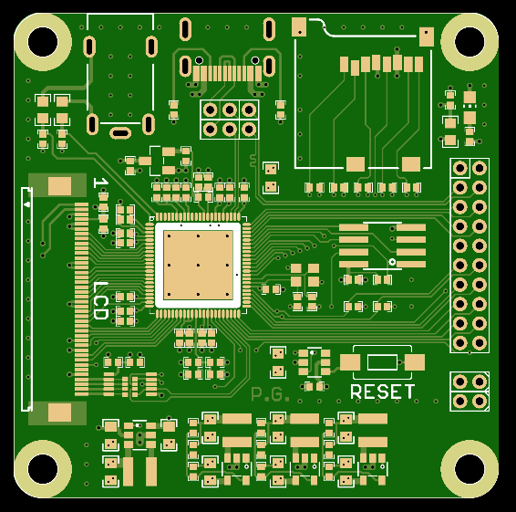

    Something on F1C100s by piotr_go
    PCB ordered, I hope it does not sleep ........ :)
    F1C200s (64MB) + LCD + AV + USB-C + uSD + SPI + I2C + I2S + UART ...
    Dimensions: 50x50mm
    Tested, it works. Now it just stayed soft.
    Some simple OS would be handy to be able to load programs from the card.
    I'll take care of it tomorrow.

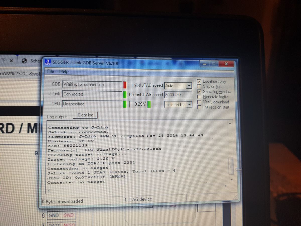

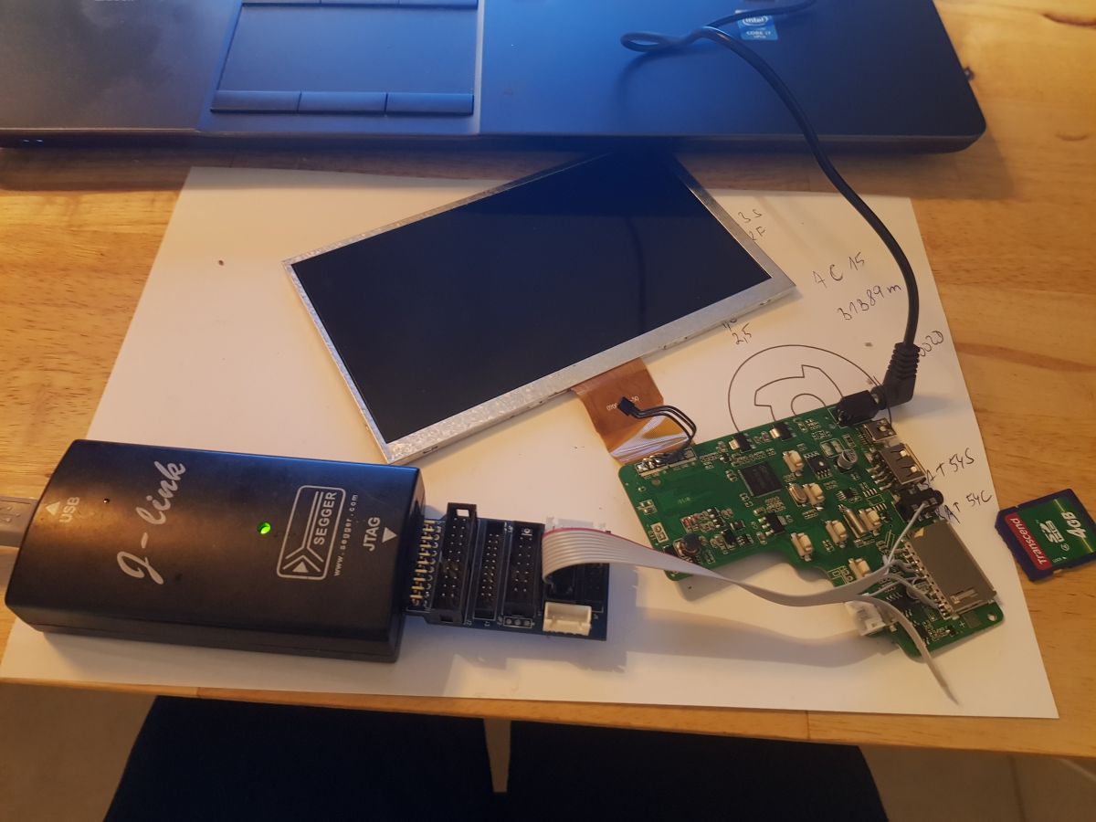

    bronek999
    I'm interested in this ARM SOC.
    I have digital photo frame and I want to make display connected to PC.
    In this time there is original firmware stored in SPI flash. Type I don't know, mark from package is removed.
    Connection to JTAG pins TCK,TMS,TDI,TDO was succesfull, j-link GDB server found 0x07926F0F (ARM9) device.
    How can I continue?
    I have no idea. I need only LCD display interface and serial interface (USB or UART).
    Today I bought Lichee Nano with linux firmware and 40pin LCD for testing.
    My display is 50pin, there is 2more power sources enabled by GPIO of F1C100s.
    Where to start if I want to develope standalone application? (no linux)
    I'm working with STM32, gcc+eclipse, but there is no support for Allwinner devices....
    Something on F1C100s by piotr_go Something on F1C100s by piotr_go

    Firmware can be uploaded via USB. No jtag required.
    Software for uploading is called "sunxi-fel".
    In the makefile from first post there is a command "make boot" or "make flash".
    To make this work flash need to be empty or disconnected.
    You can lift dataflash HOLD pin and connect to goround when needed.
  • #23 19039132

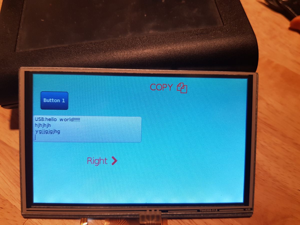

  • #25 19116432
    bronek999
    My project is pure hardware C application with no OS,no XBOOT, no RTT.
    Only hardware drived by f1c100s driver library.
    USB (CDC or HID) added. Graphics widgets by lgvl_io
    result is

    bronek999 wrote:
    Thumb up.
