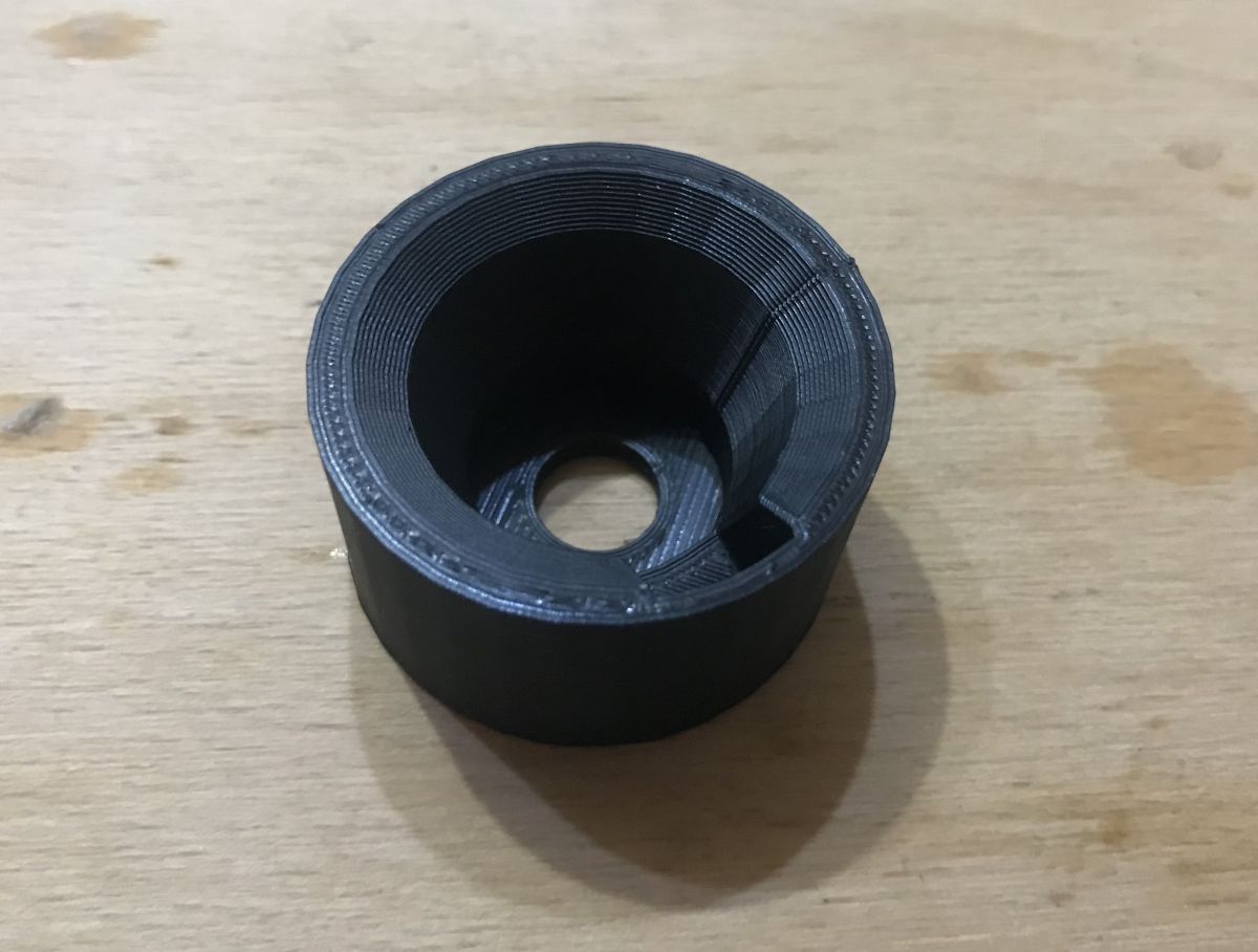

    Power supply holder/organiser
    I started the design of the power supply organiser by sizing the power supply plugs and determining whether they were fairly standardised:
    Dedicated power supply and tool wall organisers for the workshop Dedicated power supply and tool wall organisers for the workshop
    It turned out that they were all roughly the same size, but not to the millimetre. However, the differences were very small, so I made a 3D sketch of the mount framing:

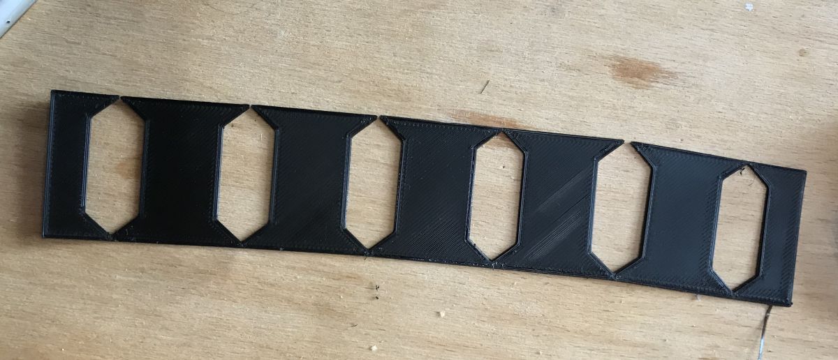

    I then printed it out for testing and preliminary fitting:
    The first version was a bit too loose, but I quickly corrected that.

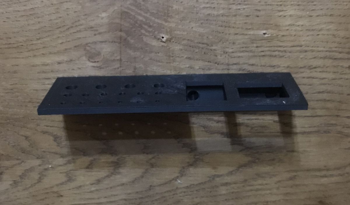

    I then measured the thickness of the largest power supply I have:
    And based on its value I prepared a slightly larger prototype, already on six power supplies:

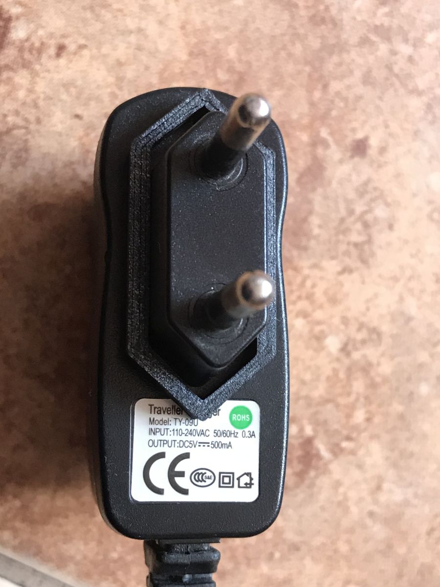

    Fitting:
    The fitting came out reasonably well, so I designed the final version. I tried to make the whole thing quite solid. I put as many as 6 screw holes for the attachment, but obviously not all are needed to make it stick.

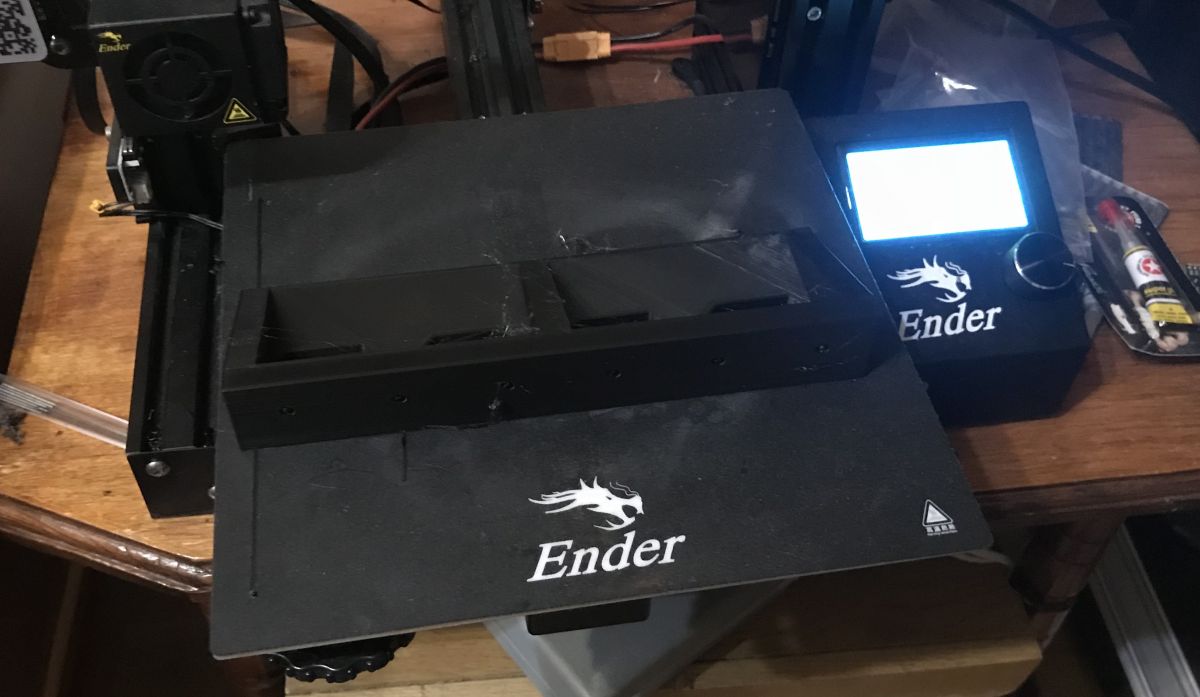

    I printed the whole thing in 'Low Quality' mode, the print took just under 7 hours:
    This part can be printed without turning on the supports, I turned them on at first because I thought they would be useful for the mounting holes. But the printer creates them fine even without supports.

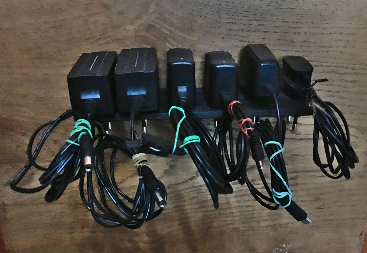

    And the final result - with power supplies.
    The organiser has come out very well - the power supplies hold solidly in it, it is convenient to put them in and take them out, and most importantly they are in view and from a distance you can see which is where.

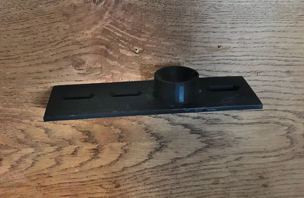

    Version for screwdrivers
    Another version of the organiser is designed for the two cordless screwdrivers I own; one Chinese, lighter, and the other the company's but slightly heavier.
    This version too consists of a separate base and separate screwdriver caps:
    The whole kit (including glue) after printing:
    I used a squeeze to glue again, and left the parts like this for some time:
    Result:
    The tools stay firmly in their slots, they do not fall out, but there is also no problem removing them when needed.
    I would advise attaching this item to the wall particularly solidly, as it takes on a little more weight than the organisers shown earlier.

    Unfortunately with power supplies there still seems to be a problem with the cables? Unless the cables are hanging loosely and you've only strung them up for work.
    I also make various racks for specific items and don't find it a waste of time. Order and convenient access is important but not everyone will understand that.
  • #9 18733536
    Posts: 14799
    Rate: 12960
    Tomek515 wrote:
    Unfortunately with power supplies still probably a problem with the cables? Unless the cables are hanging loose and you only coiled them for work.
    I coil the cables from the power supplies as much as I can. Anyway, you can see from the photos. Basically, I have three ways of keeping them in place when coiled:
    - hooking them up with a simple rubber band to prevent them from escaping
    - hooking them with a special cord-rubber puller, which I got some from TME when I ordered the extensions from them (very cool thing)
    - attaching them with a metal/hard wire, which is often included in the set when you buy HDMI or other cables
    And smaller cables like microUSB, miniUSB (already the loose ones of course, without power supplies) I have in Patrol drawers, signed

    How about making something like this instead of rubber bands? Such a bobbin with cutouts for the beginning and end of the cable.
