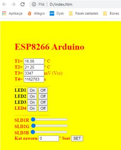

    It is best to use websockets to transfer information from the HTML page to the ESP. This works fast enough to transfer the lighting effects calculated by the PC program in real time (someone posted a cool video on YOUTUBE). I usually upload the html code to the ESP, either in code or on SPIFFS. But the site can be fired from anywhere by stripping the example code of the html server altogether, there may be an html server used for something completely different, you just swap the lines:
    Code: HTML, XML
    Example .
    I see the same thing when I paste 192.168.1.30 into my browser, because there I have the same idex.htm with the first line active.
    The first one is for the websockets server inside the ESP, the second one I just fire up from a PC drive, tell it to connect to the websockets server on the ESP on the local network with IP 31 and port 81. You can of course redirect the port in the router to that IP with that port and access that ESP from anywhere in the world. Any server can then do the job for the PC, of course.
    What it looks like:
    How to read data from an HTML page in the ESP32 via HTTP? .
    From the esp, information stored in text fields arrives in the HTML page, possibly actions called on a page opened in another browser (the websockets server in the ESP supports 5 connections at the same time), the result of buttons, sliders, possibly whatever you can come up with using html and JS can be sent to the ESP.
