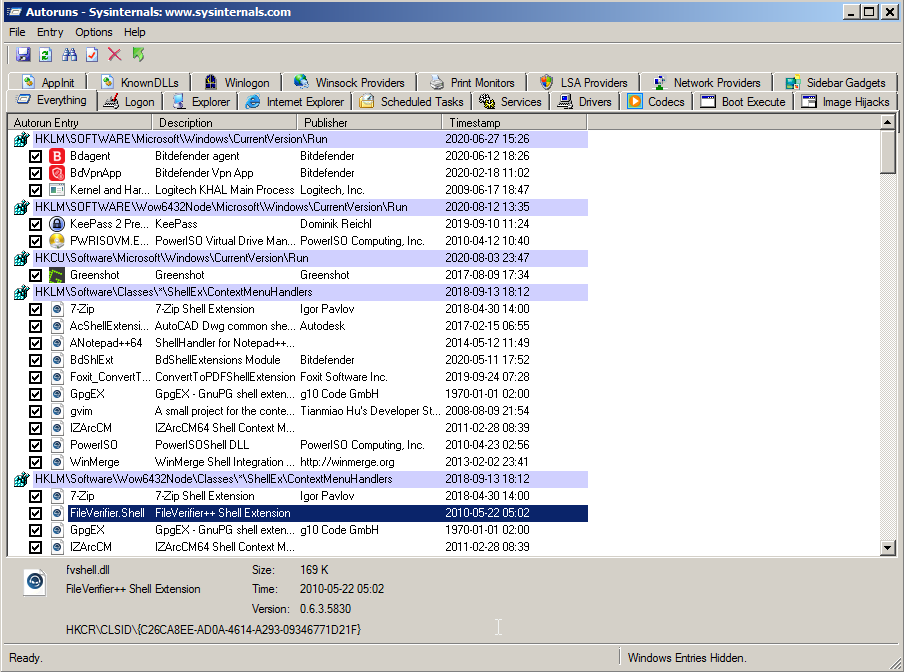

    I wrote about 3 programs and here is the third:
    3) Autoruns
    Exploring Search History and Current Connections on Same WiFi: Router Access Queries
    This tool, in turn, presents virtually everything that is run automatically during system START. And not only from the appropriate folders / keys such as autostart, but in general with all mechanisms available in windows (mainly based on the system registry, but not only)
    It is really a very powerful "and helpful" tool, in tracking how some programs do themselves and without the knowledge of the user installing them - they can install various unnecessary services, 'auto-starters', mechanisms that make sure that the user does not disable something, etc. etc.
    With its help, you can sometimes catch some attempts to defend the program against deletion / deactivation - attempts that no such normal utility program should do ...
    Once I found in one of the soft software over 20 equal processes (subprocesses) that only ensure that none of them was turned off. And if it was left immediately under a new, random process name - they would run it. After all - they had some common features - such as the size of the executable code and some common references.
    Clever - but not much :)
    Another time, I noticed a system brushing like this - strange processes resembling the deceptively known and respected symanteca toolkit at the time - but having nothing to do with it. these were also malware files / processes as I came later.
