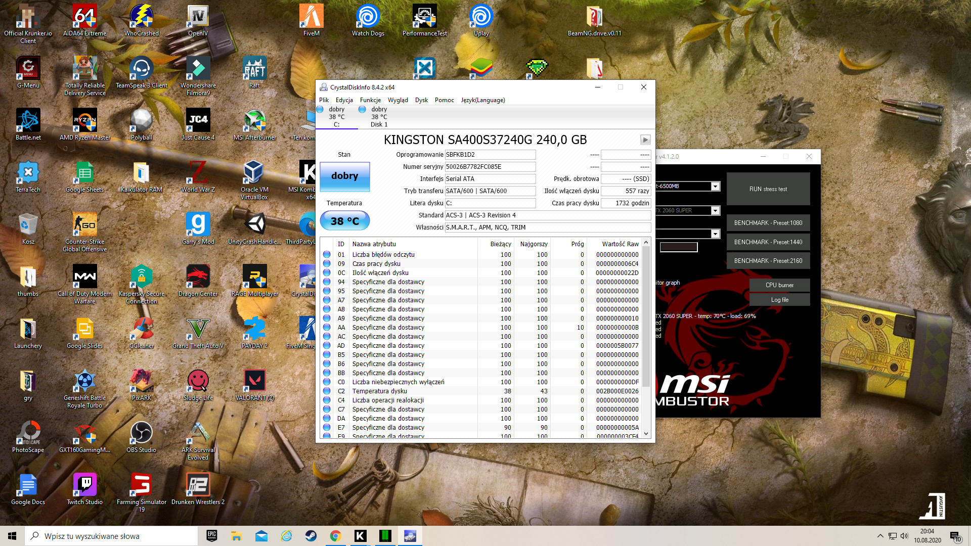

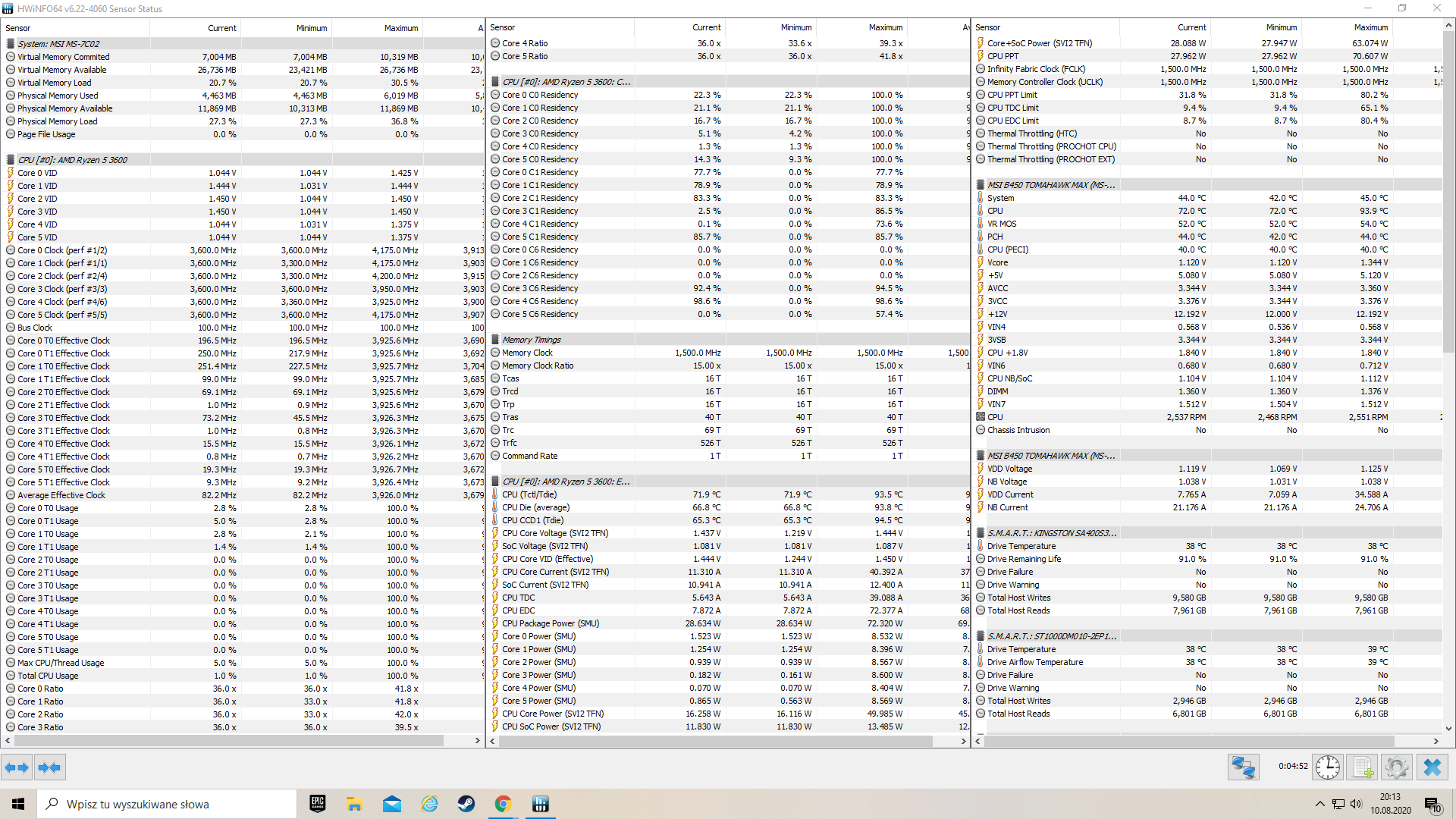

    Hello, recently I was on vacation, before the holidays everything was fine, but I came back after a month from vacation and started the computer. Everything was ok, I launched the raft game, played a few hours. Then I turned off the game, and the game didn't even close properly, and I already started to update the new drivers for the graphics card, then a bluescreen appeared, but I thought that the card simply did not finish its processes well there and a sudden driver update could crash it. however, later i started playing gta 5, after a while suddenly a very fast bluescreen popped up, then after about 2 hours another, also a fast bluescreen popped up. As it's warm everywhere, I think the culprit is the CPU overheating. When these bluescreens popped up, the computer window was removed, but it did not help. How can I be sure that the CPU is overheating? Aida64 extreme has already expired, so I can't insert these charts. Discs also get high temperature, but not so high as to be harmful.
    Specification: AMD Ryzen 5 3600, RTX 2060 super dual palit, HyperX 2666Mhz cl13, Corsair VS550W, Kingston A400 240GB, Sea Barracuda 1TB, MSI B450 Tomahawk, CPU cooler is boxed, and has boxed thermal paste.
    BSOD "System Service Exception" win32kbase.sys how to fix? BSOD "System Service Exception" win32kbase.sys how to fix? BSOD "System Service Exception" win32kbase.sys how to fix? BSOD "System Service Exception" win32kbase.sys how to fix? BSOD "System Service Exception" win32kbase.sys how to fix? BSOD "System Service Exception" win32kbase.sys how to fix? BSOD "System Service Exception" win32kbase.sys how to fix? BSOD "System Service Exception" win32kbase.sys how to fix?
    If it's because of the heat of the processor, tell me what can I do to cool it down.

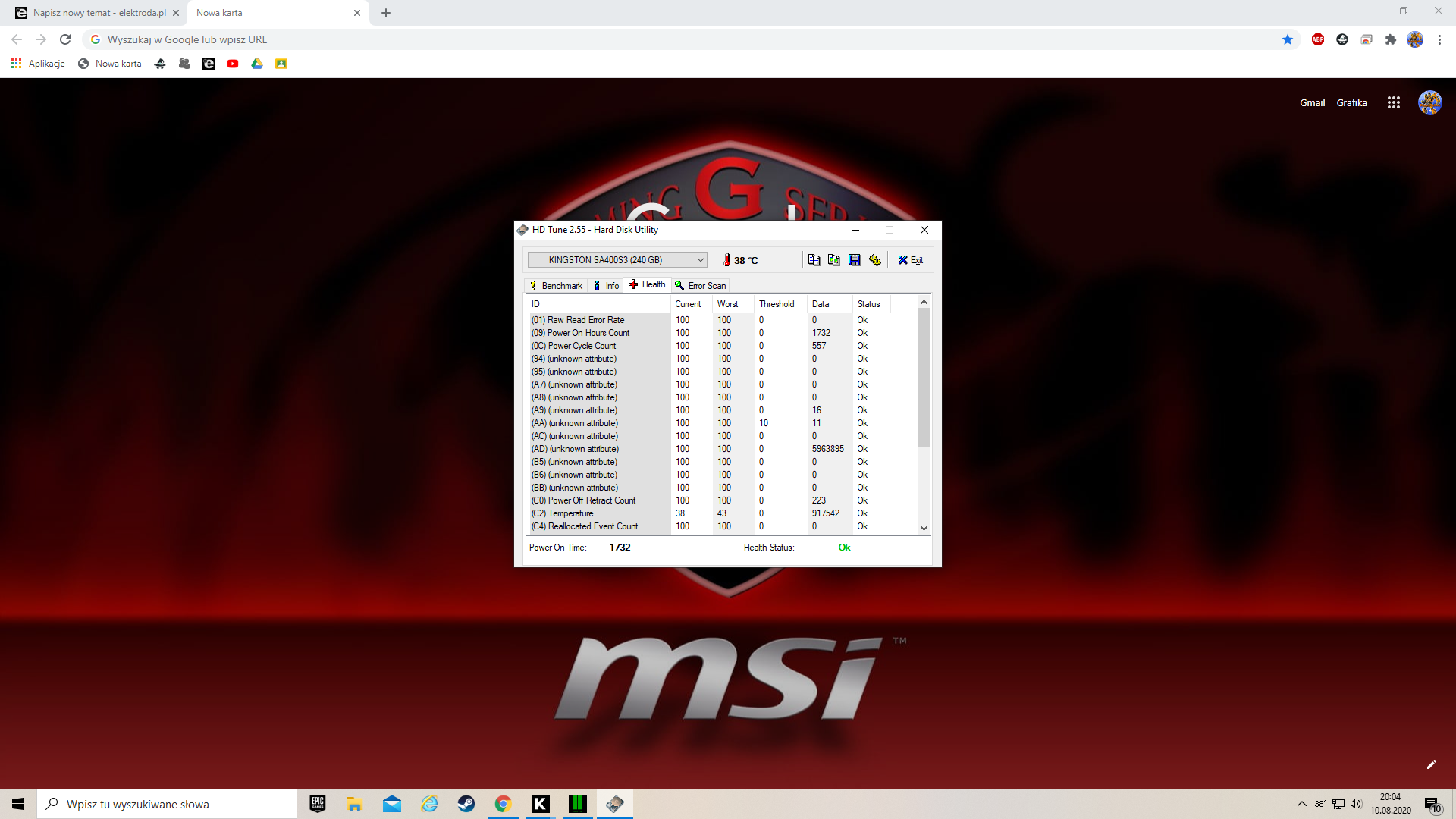

    Set the fan curve in the bios depending on the temperature, you will have more RPM on the fan.
  • #5 18863923
    swag_pinguin
    Posts: 497
    Help: 30
    Rate: 65
    when he enters 100% at 70 degrees, so there is not much to set.

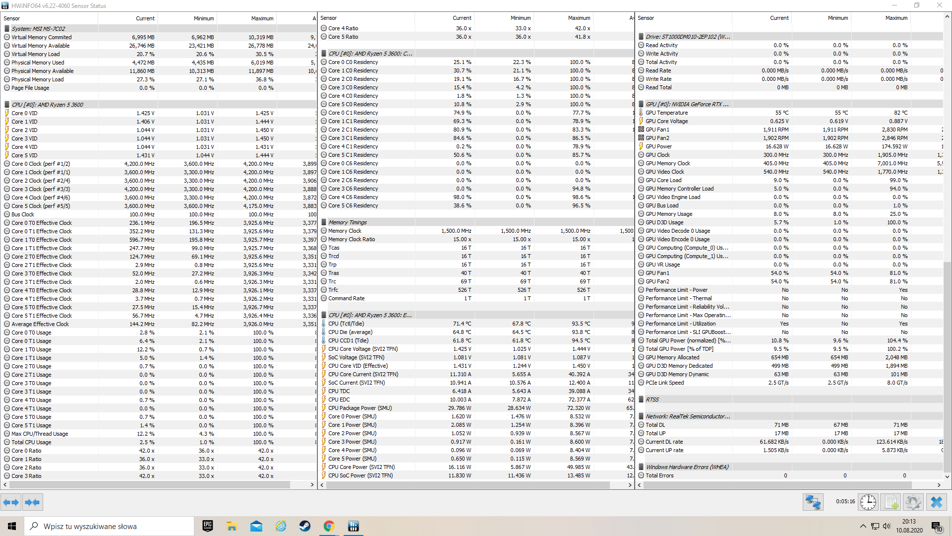

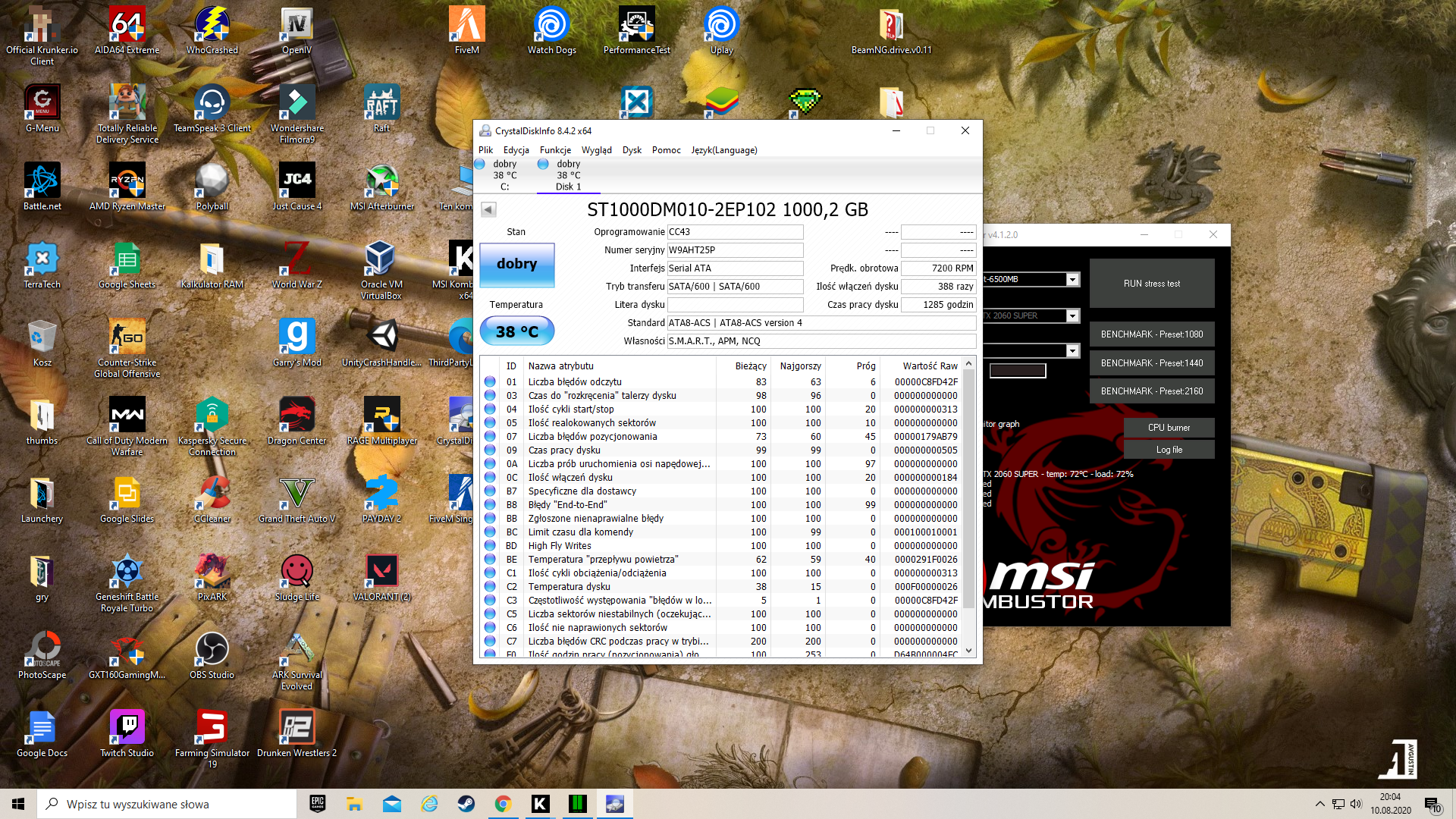

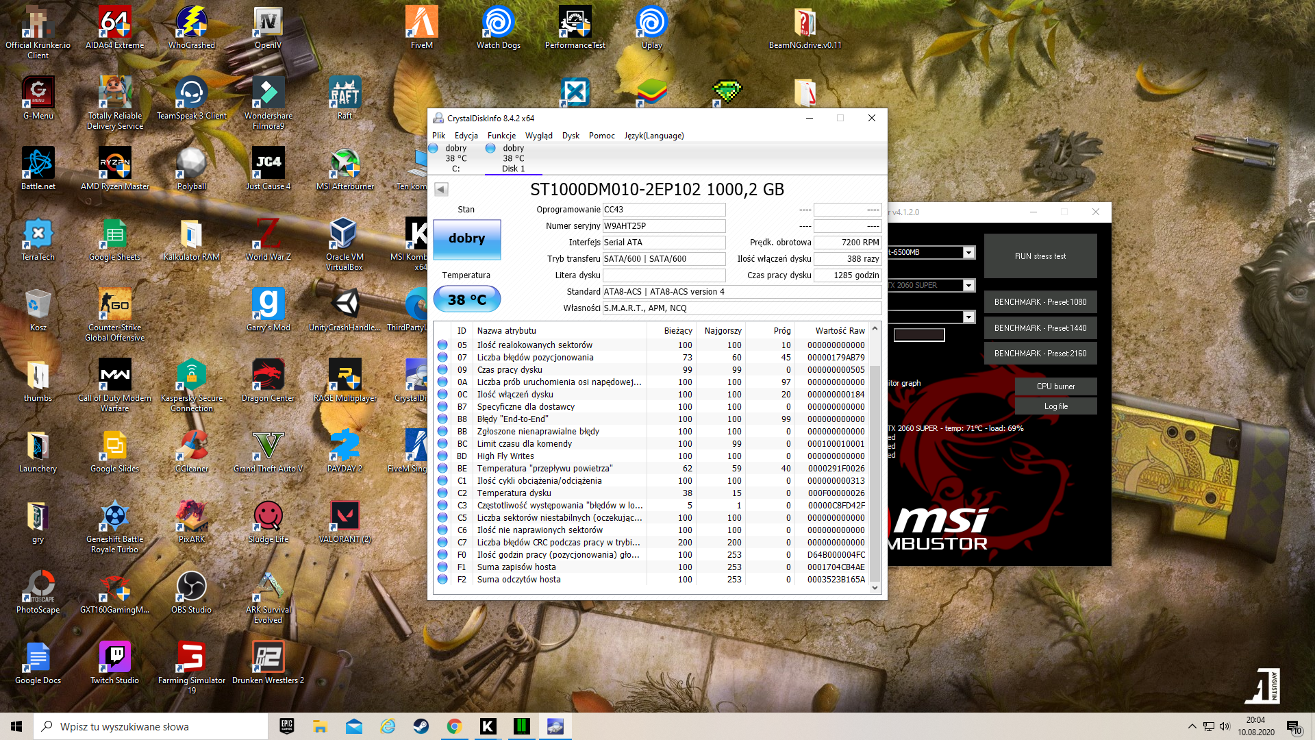

    You can test with occt if you don't have an AIDA64 license. If you blame the card for blue screens, you can always remove the drivers by using DDU.
  • #7 18863945
    swag_pinguin
    Posts: 497
    Help: 30
    Rate: 65
    I don't really blame the card, because she had the right to get confused. But when I was playing raft, the processor was max 85 degrees, and nothing was screaming, and since gta 5 on FiveM servers, msi afterburner does not work, I have no way to monitor it, although I have HWiNFO running in the background then, but how I can't even see how many degrees it has reached. But I will check again with occt.

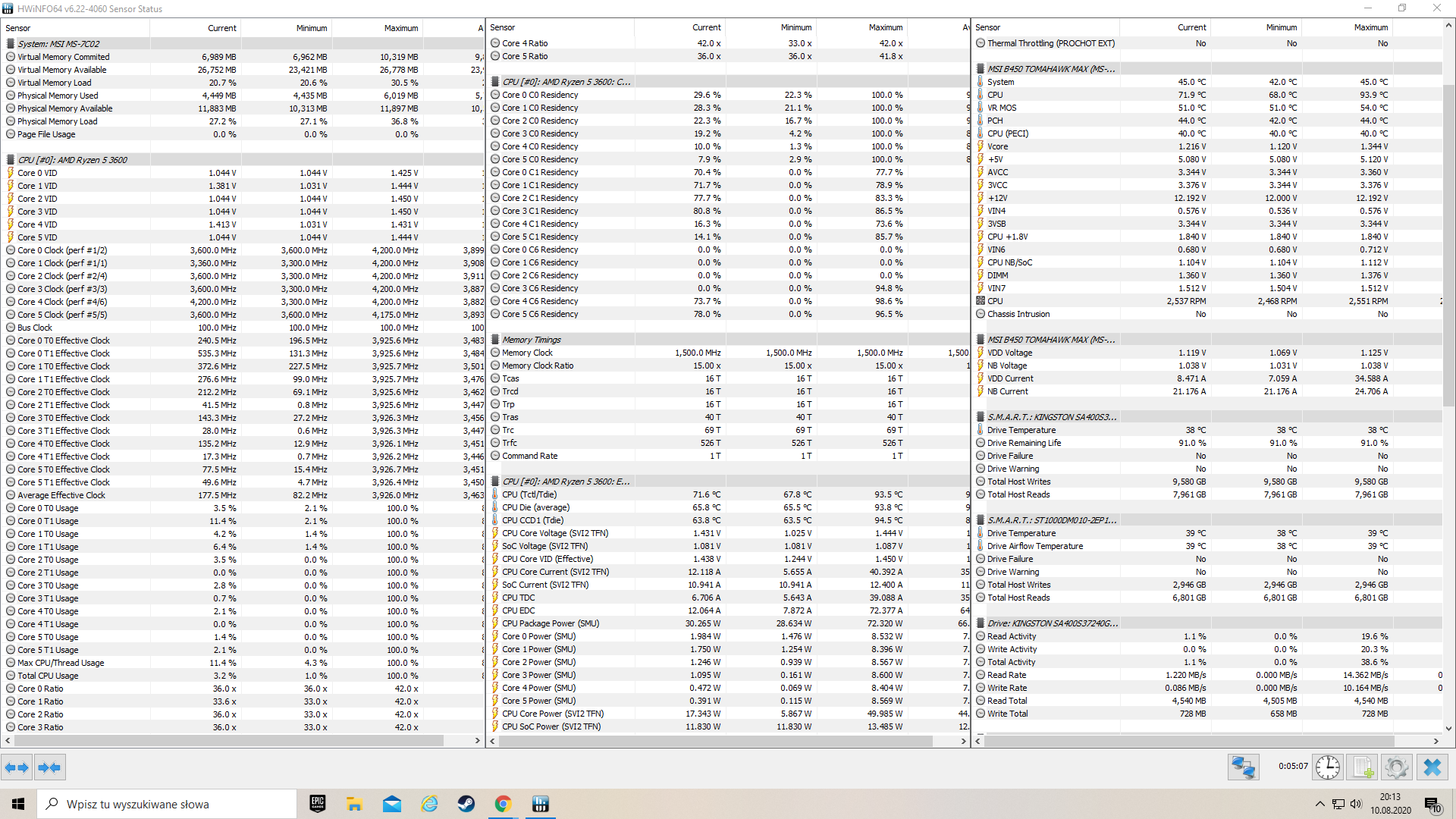

    94 degrees on an unoverclocked CPU, how come? Enable AMD cool&quiet in BIOS. All MSI B450 boost voltages a lot, 1.45V, a lot.
    Install the cooler correctly, change the paste.
    https://www.instalki.pl/programy/download/Win.../testowanie_i_diagnostyka/BlueScreenView.html
    Show errors.
    Sprawny Komputer Tomasz Kokoszewski
    Patriotów 50, Warszawa, 04-912 | Company Website: https://sprawnykomputer.com.pl
    My apartment is 32 degrees, so it boils a bit, but in my opinion, even despite the high ambient temperature, the computer should not crash in this way. It is without glass, but it does practically nothing.
    It's always new, all the time.
    ITSpec. wrote:
    there's nothing there unless I need to do something else there.
    What voltage should i set in the bios?
    I intend to, the Arctic cooling MX-4 paste will be good for a long time? Or will the Thermal Grizzly kryonaut last long? And as for cooling, I also want to change the only problem is that I've been looking at the dimensions of SilentiumPC fortis 3 all the time and I still don't know if it will fit into my kennel (SilentiumPC Regnum RG4T). And if it did, you'd have to disassemble the motherboard to install it, right? I'm asking because I'm a little afraid of disassembling the computer, because I have a custom-made computer and I didn't assemble it myself, because I can't. Will replacing the cooler void the warranty? (the computer was made to order by a computer specialist). If you have better cooling than fortis 3 for up to PLN 150, you can offer.

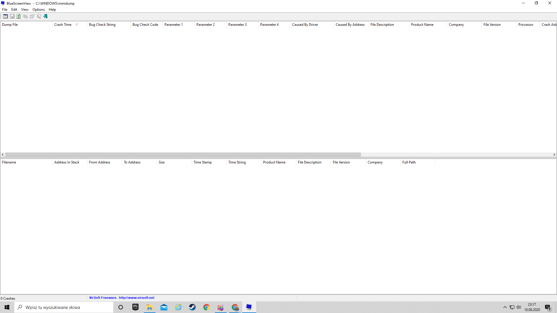

    If it crashed a BSOD with an error code, this program should show it.
    Set it lower, Offset Mode, put it on "minus" and set it to 0.1 for example.
    MX2, MX4.
    Arctic Freezer 34.
    Ask a computer engineer, I don't know how it is with them.

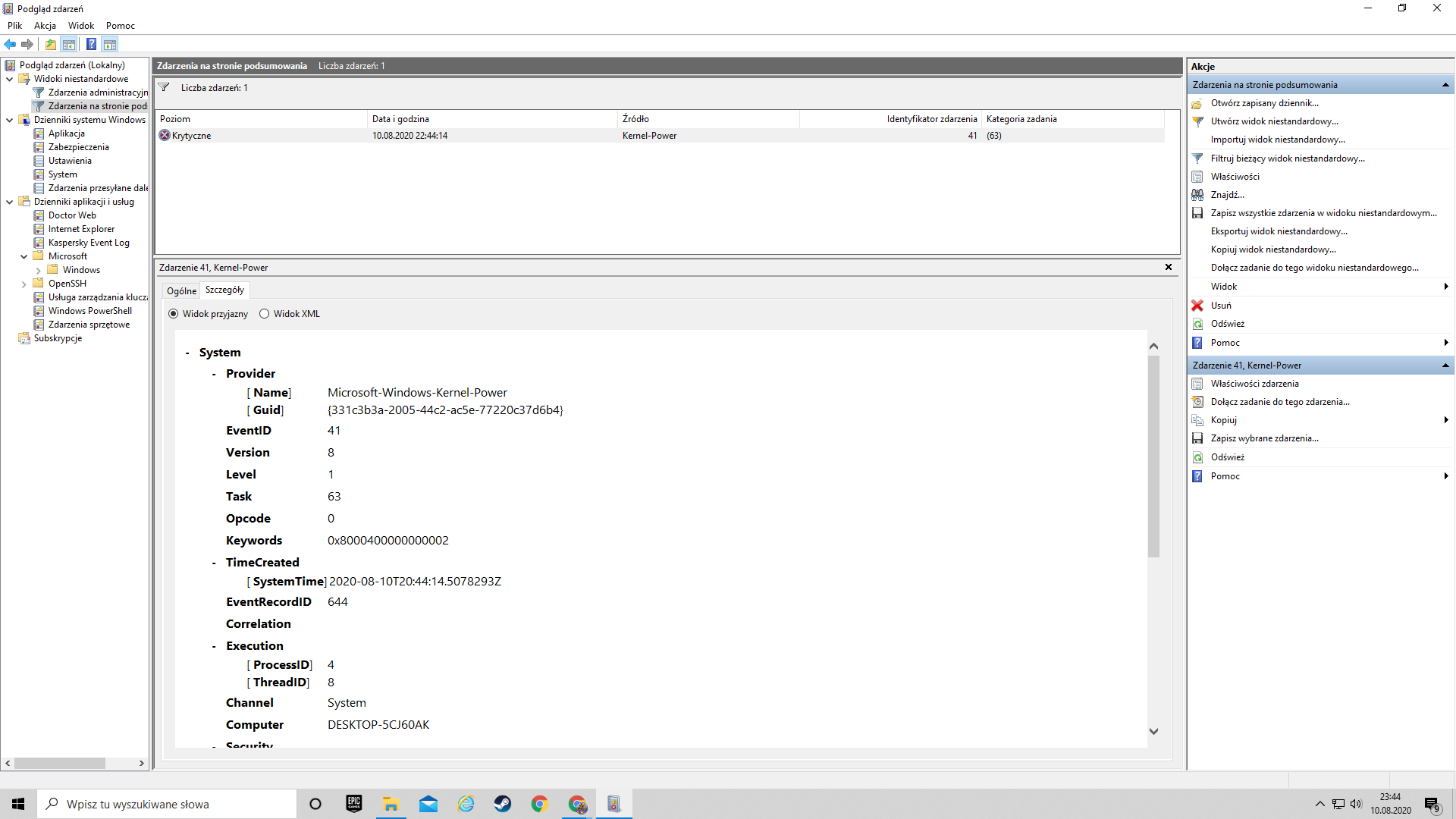

    And how should that help? Will this eliminate the jumping temperature? i.e., for example, I play a game, the processor sticks to 80 degrees, in a few seconds it drops to 70/65 and again sticks to 80 and so on. Or at least lower the temperature? Is there any performance loss on this?
    Added after 29 [minutes]:

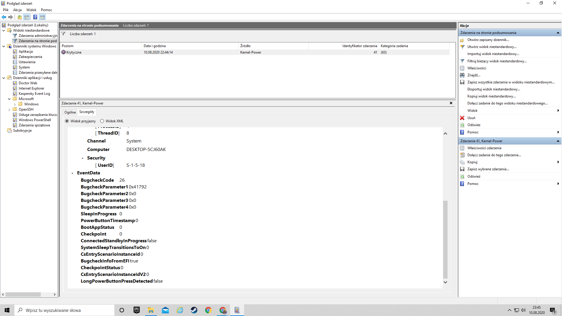

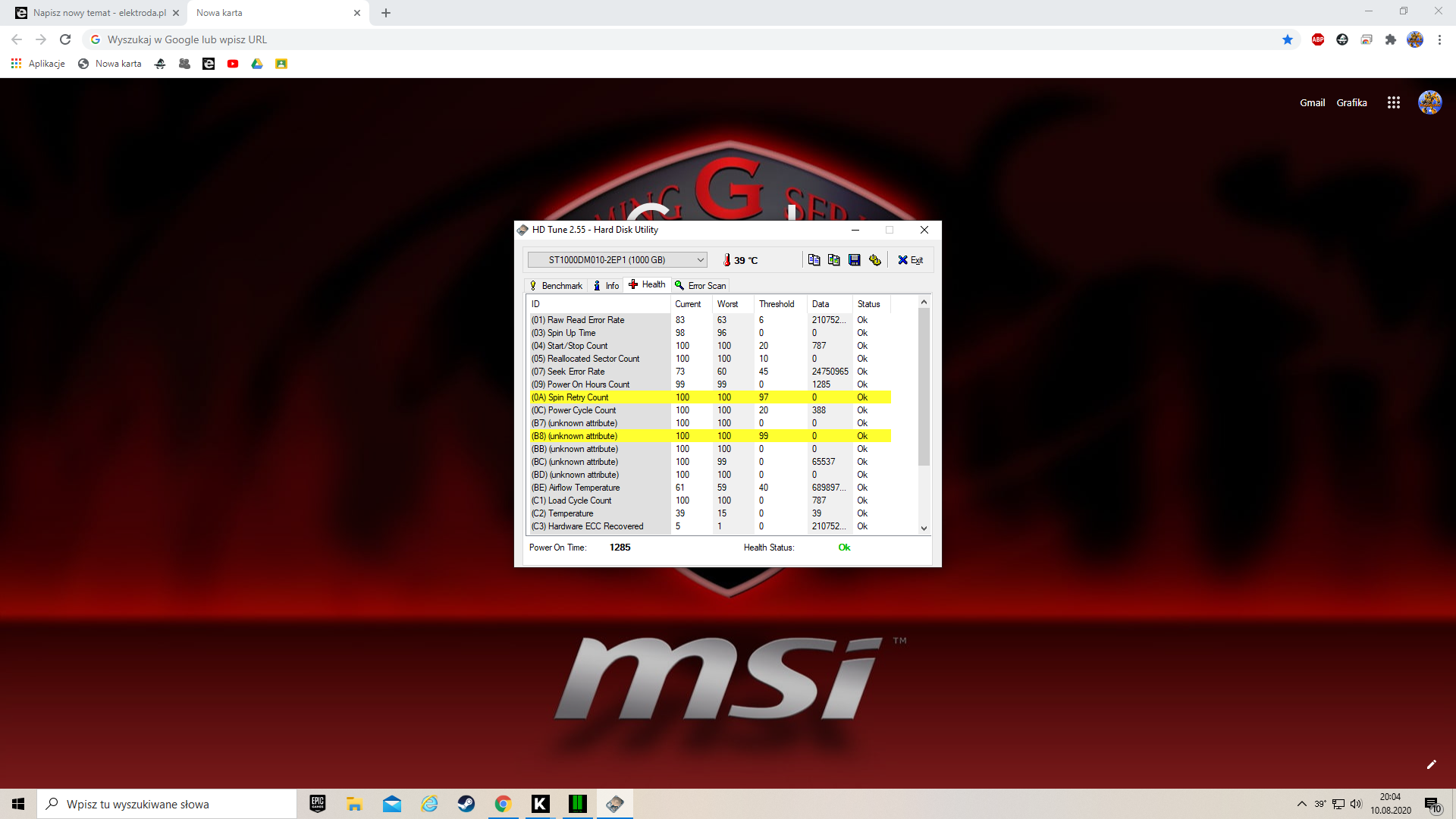

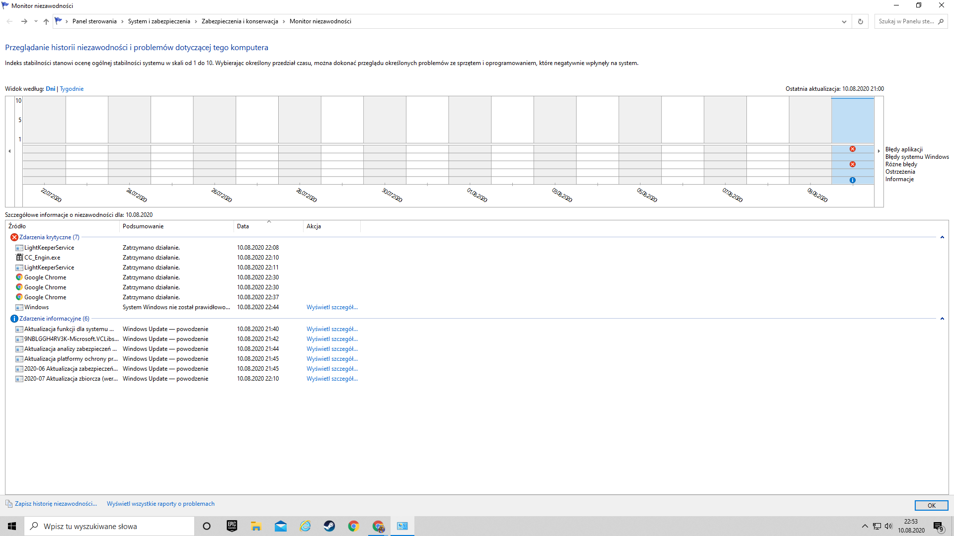

    Okay, now I'm really worried because I don't know what's wrong. I close chrome and beep, BSOD. What is going on?
    The only thing I was able to find in the system is:
    Along the way, I also broke chrome, it crashed at startup, but it's fixed.

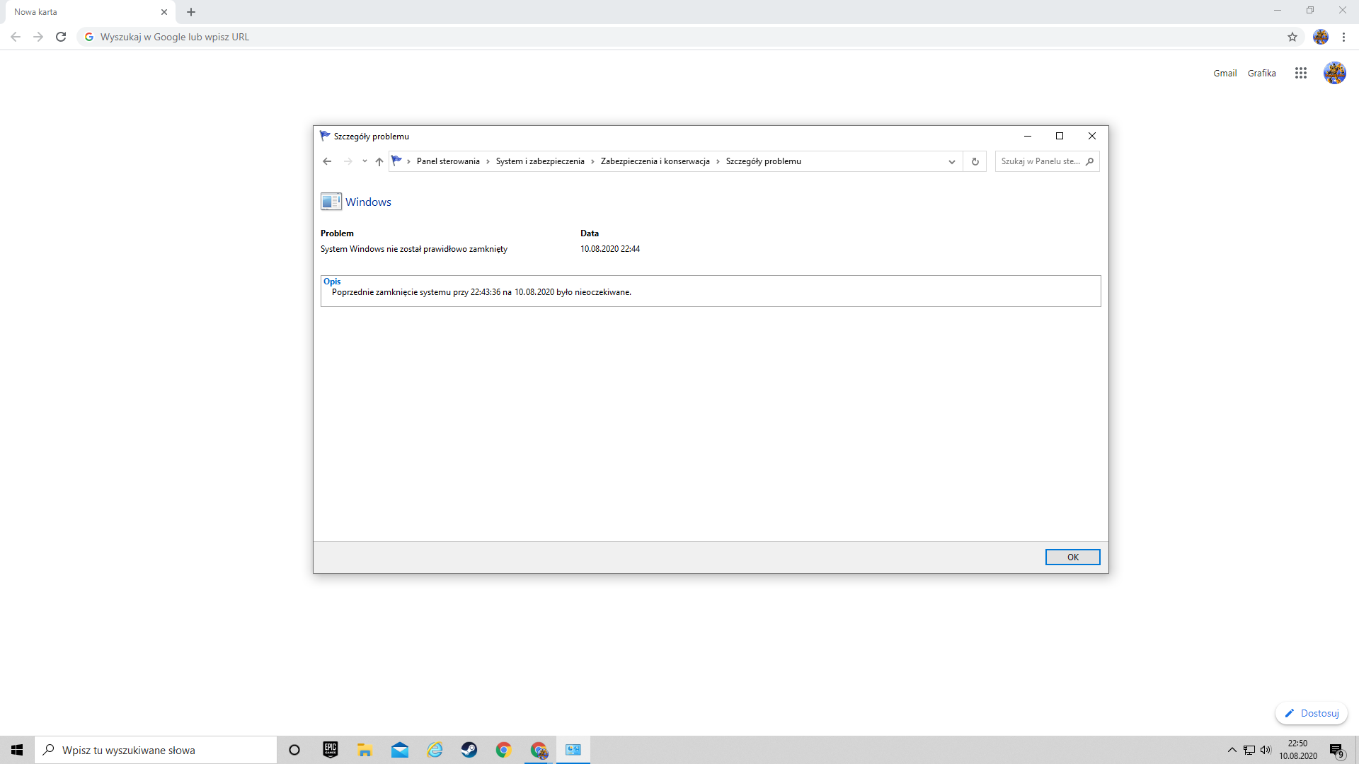

  • #13 18864146
    swag_pinguin
    Posts: 497
    Help: 30
    Rate: 65
    But I don't show up there, same in "WhoCrashed"

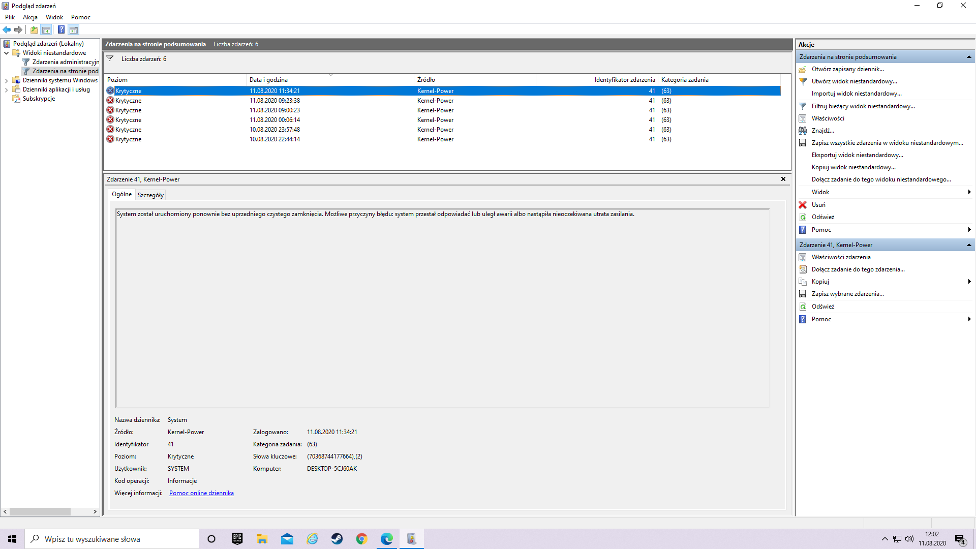

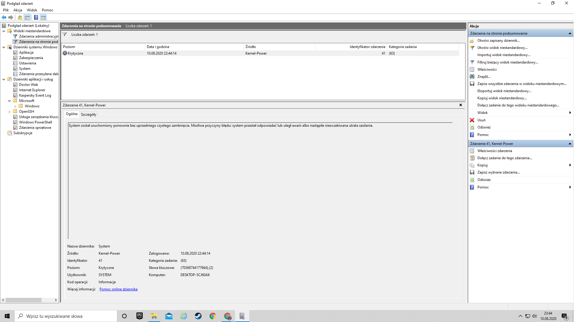

    ITSpec. wrote:
    And the event log?
    Post the FRST logs as attachments.
    Please.

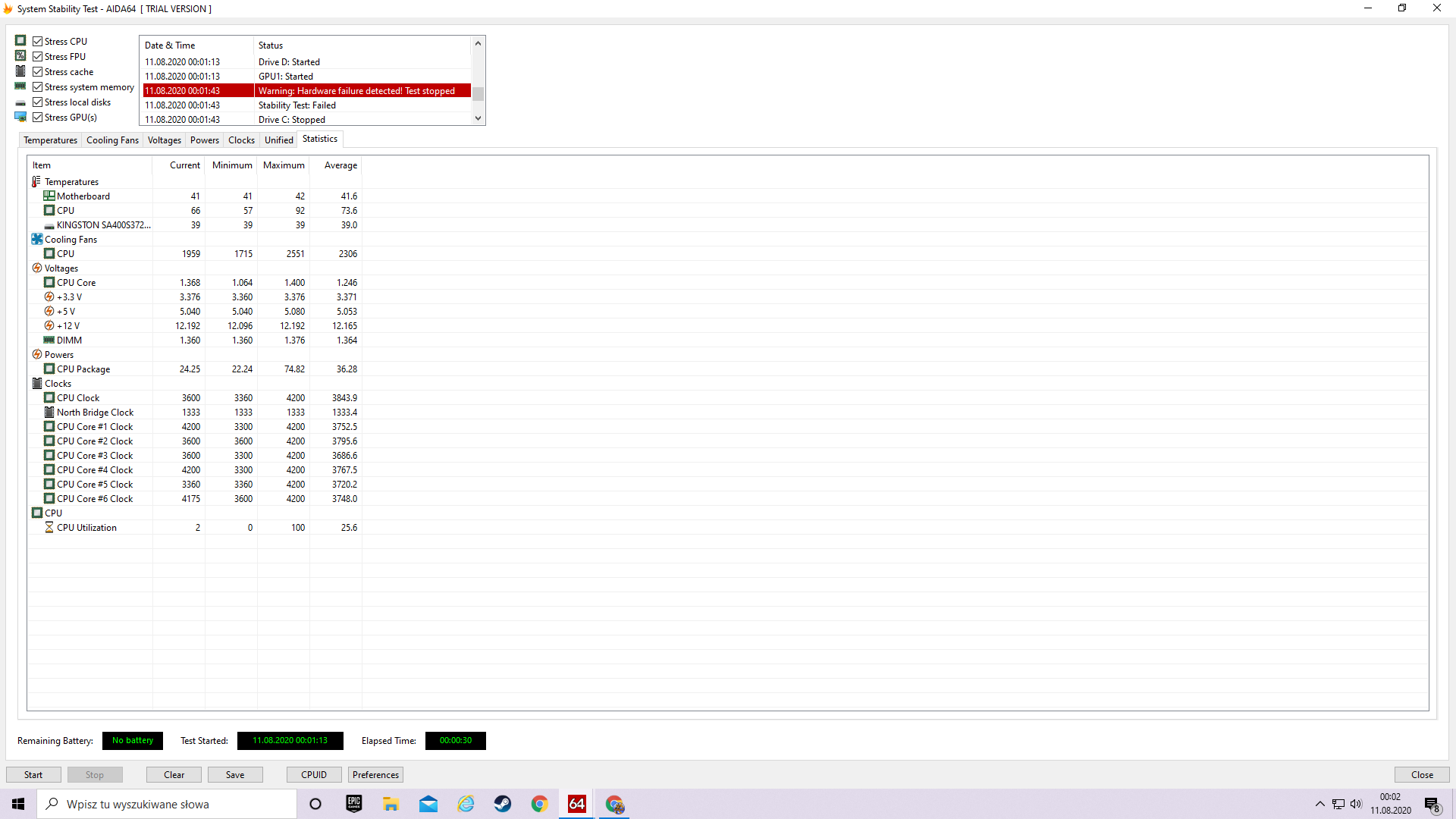

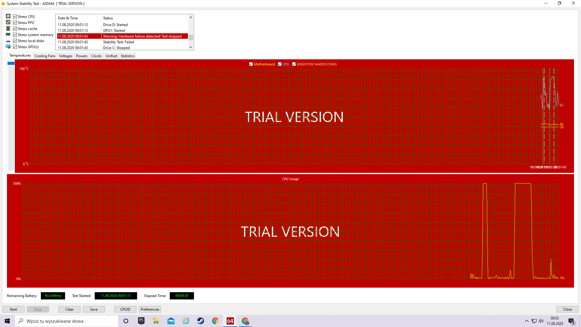

    This probably won't do much, and those other bsods are nowhere to be found, this is the only one after I disabled chrome.
    Added after 16 [minutes]:
    Okay, tests in AIDA64 fail, it detects system instability.
    Added after 10 [minutes]:
    I recorded a load test, it crashed, and the error is "System Service Exception" What to do?
    Added after 7 [hours] 32 [minutes]:
    I have already tried solutions from the internet, but the problem persists.

    I made a bios restart (I made a jumper) and the first results are that aida does not crash after 10 seconds, only now it has 5 minutes, it promises to be good. I haven't changed anything in the bios yet, and the rams are 2400 Mhz. I'll test it for 30 minutes and if it doesn't scream, I hope that will be the end of my problem :D
    Added after 7 [hours] 11 [minutes]:
    After 20 minutes of stress with Aida, the system was stable. Then, during the game, which lasted about 5/6 hours, the computer was also stable. I am very happy about it, and I hope that this problem will not appear again, but to be sure, I will leave the topic open for a few days, if something happens.
