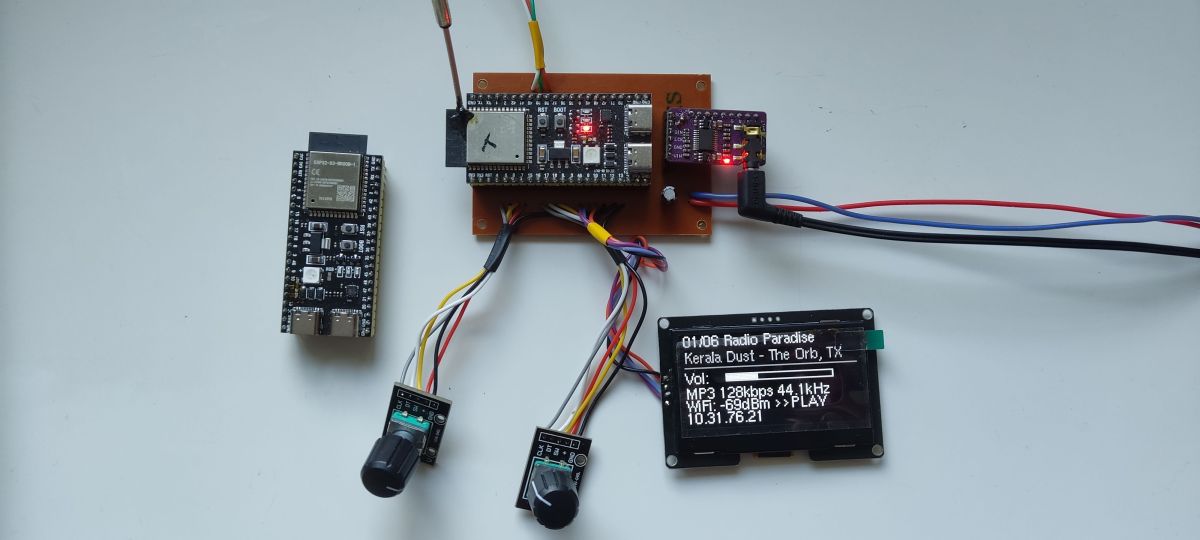

  • Checking PCM5102 wiring after silent output
    #18 21923365
    miroskop
    Posts: 482
    Help: 65
    Rate: 66
    I don’t know why, but there’s silence at the PCM5102 output. I’ve checked two boards with soldered jumpers as shown in the photo; I also took one board from another radio (ESP32-MiniWebRadio), where it worked without any problems. The red power LED is lit, so power is getting through. The other pins are also connected: BCK to 21, LCK to 15 and DIN to 47. SCK is connected to ground. The display and encoders are working. Where could the problem lie? Help!

  • Need ESP32-S3 and terminal output check
    #21 21923460
    Seba_smd
    Posts: 323
    Help: 8
    Rate: 115
    miroskop wrote:
    efi222 wrote:
    You’ll probably need an ESP32S3 here
    That’s exactly the one I used: ESP32-S3 N16R8, but I’ll try swapping it for another unit tomorrow. Perhaps this one has a manufacturing fault; it was taken straight out of the packaging.
    Connect it to the terminal Link and show me what it displays, It should work if you’ve connected it properly and soldered the jumpers on both sides – five jumpers in total. Can you access it via the web interface? Read the ESP32-S3 via the terminal – let’s see what it’s sending you?
  • #22 21923469
    miroskop
    Posts: 482
    Help: 65
    Rate: 66
    I’ve replaced the ESP and the radio’s working!!! So the PCM5102 wasn’t to blame after all. Thanks for your reply.
    I’m posting a photo of my setup so you don’t think I’m just messing about.
    Prototype device with an ESP module, wiring, and a display showing internet radio playback information.

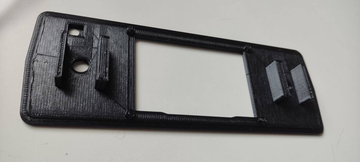

  • 3D-printed front panel for ESP32-S3 radio enclosure

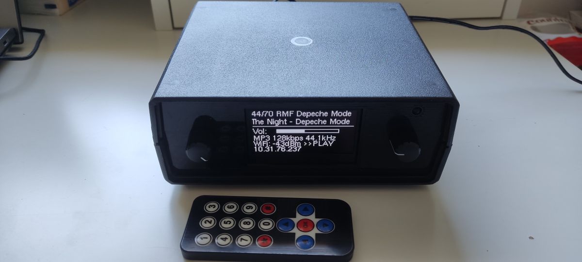

    All done! Encased in a Z4A (Kradex) housing but with a modified front panel. As my encoders don’t have a threaded shaft and need to be mounted on spacers, it was easier for me to 3D-print a dedicated panel. Here’s a photo of the plate and the finished radio. The IR receiver has a specially recessed socket so that its ‘eye’ isn’t hidden. Thanks to my friend Sebastian for creating and sharing this project. The radio works flawlessly; stations switch without any glitches, and configuration via the web interface is convenient and straightforward.
    The simplest Internet radio on the ESP32-S3? No installation required – just upload it and it works!
    Black radio enclosure with OLED display and IR remote on a tabletop

    Congratulations – I’m waiting for the components to arrive so I can get started too. I don’t have a printer, but I’ll manage somehow.
    Do the speakers have an audio output? It’ll work better for me with an output – either for my home cinema system or for external active speakers.
    I’ve got a few similar remotes, but I’ve no idea what encoding they use – is there any way to check this by sending a signal to the IR receiver?

    I have a mini-jack audio output, without an amplifier. The whole thing is powered by a 5V plug-in power supply, which is why I didn’t bridge the IN-OUT pins on the ESP-32. You can test the remote controls on the finished radio paired with the web panel. There’s a tab for remote control configuration where everything is plain to see.
  • Mini-jack output and Bluetooth receiver plans
