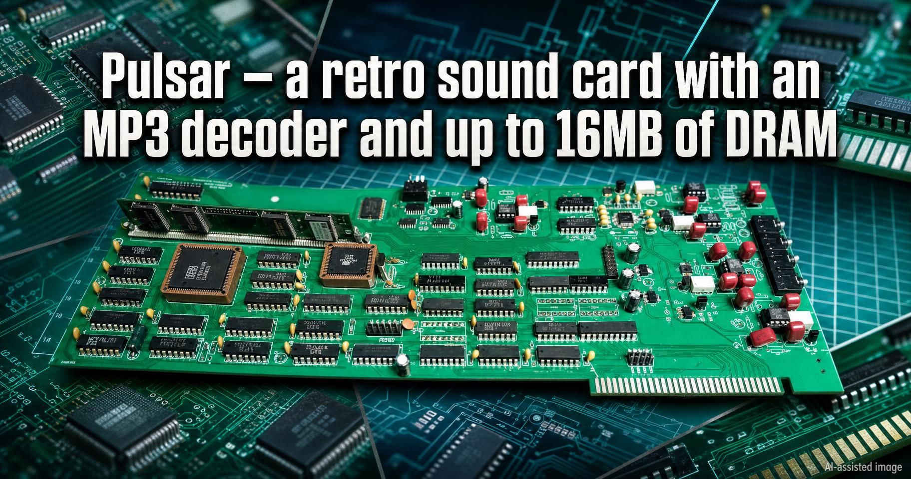

    I think it’s high time to present the design for the Pulsar sound card – a Sound Blaster clone enhanced with:
    - The replacement of the 8051 with the AT89S8253; in terms of instructions, it is still an 8051, but it features an added hardware SPI controller, which is crucial for communication with the VS1063. The microcontroller converts parallel data to serial data, reads and sets flags for the ISA bus control logic, reads states from the DREQ line, and sets states on the SS and DSS lines – in short, it handles full SPI communication with the VS1063.
    -Hardware MP3 decoder based on the VS1063 chip – this is a 32-bit chip communicating via SPI. The chip also provides balance control, bass and treble adjustment, a 6-band graphic equaliser, EQ presets (including Country, Rock, Disco, electronic music, etc.) and a master volume control. This chip was also used in the Prisma MP3 card for the Amiga – hence the inspiration.
    - A hardware DRAM memory controller based on the 673104ANL chip – the 673104 is capable of addressing up to 16 MB of memory – addresses are generated from a 4-bit BCD code via three 74LS138 decoders. The controller works in conjunction with the Arbitrator and anti-hazard circuits, which prevent situations where, for example, the ISA bus is simultaneously writing data to the card and reading data from it. This is where the DRAM buffer comes into play: if the ISA is busy at any given moment and the uC wishes, for example, to write data to the ISA, it will be able to write the data to DRAM. Once the ISA is freed up, the data can be read from DRAM.
    - SRAM for the 89S8253 on the 2111 chip – used to store constants and variables utilised by the uC. It acts as an extension of the uC’s internal memory.
    - Digital potentiometers – these allow the volume of individual inputs to be adjusted and the signals to be mixed.
    - An OPL 3 YMF262 FM synthesiser has been added, along with two YAC512 DACs with a resolution of 20 bits per channel – 2x10 bits for the left channel and 2x10 bits for the right channel
    - Support for dynamic, electret and condenser microphones.
    - Input switching and muting via relays.
    - Option to connect a MIDI interface by disconnecting the OPL3 synthesiser.
    - Mixer based on an operational amplifier.
    There are therefore quite a few changes compared to the original SB 1.0.
    The assumption was that, since computers with 386 and 486 processors, and even more so those with 286, 186 and 8086/8088 processors, could not cope with software-based MP3 decoding due to their low processing power, an ISA sound card with a hardware decoder/encoder was required.
    The choice of Sound Blaster 1.0 and 1.5 was no accident – the topology of the SB 1.0 and SB 1.5 had been thoroughly documented online, including a dump of the DSP1321 (8051) contents. An 8-bit ISA card was deliberately chosen to ensure the card was also compatible with the PC XT. I deliberately opted out of Game Blaster support – firstly, because few games supported Game Blaster, and secondly, because the prices of Philips SAA1099 chips ran into the hundreds, or even thousands, of zlotys per unit. I omitted the Game Port due to a lack of space – all the control signals for the Game Port electronics and the power supply are routed to connector J6. This allows for the addition of a Game Port daughterboard.
    The project is still in progress. However, it’s already making quite an impression.

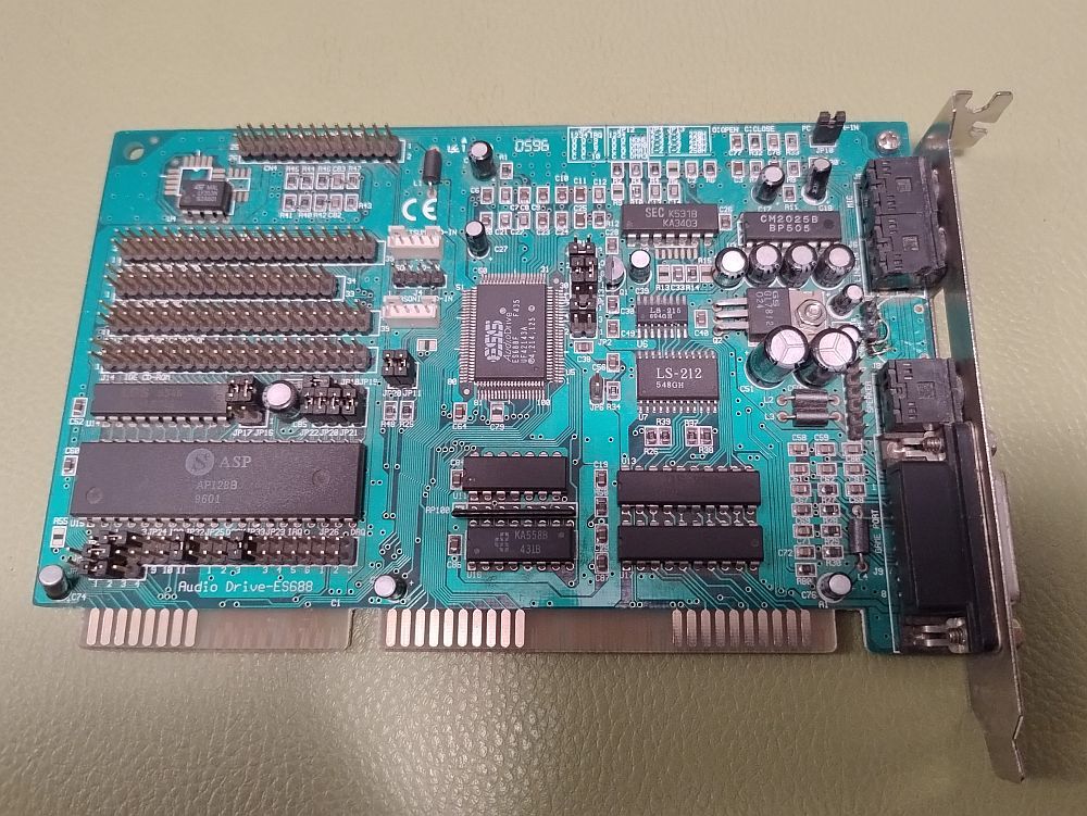

  • Found an old sound card with IDE slot
    #12 21917254
    robig
    Posts: 463
    Help: 62
    Rate: 145
    Beautiful retro electronics – it’s enough to make you blush just looking at it 😁
    A couple of weeks ago, I was having a clear-out in my junk room and found some similar treasures – perhaps not quite as impressive, but old all the same. This one’s from one of my very first PCs. Of course, I kept it; I’m thinking of trying to get it up and running when I have a spare moment – maybe it’ll work.
    The card has an IDE slot, though I also remember that the hard drives didn’t really want to work; the CD drives, on the other hand, were flying.
    Top-down close-up of a green Creative PC expansion card with many chips, capacitors, and bracket connectors. Close-up of a green PCB labeled “IDE INTERFACE” with 74LS245 chips and an OAK Technology IC. Close-up of an AMD Am5x86-P75 CPU on a motherboard, showing a Windows 95 marking Old PC motherboard with an AMD CPU and multiple ISA and PCI expansion slots plus memory sockets Old PC motherboard with RAM sockets and vertical expansion cards on a light textured surface

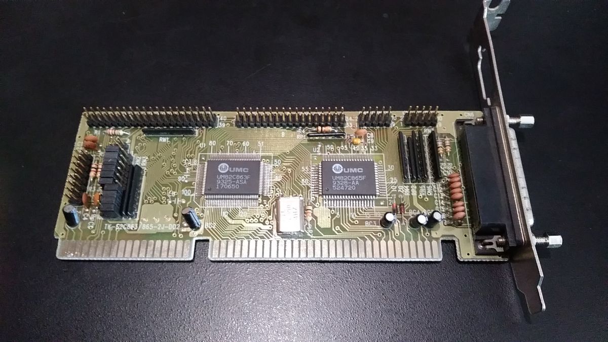

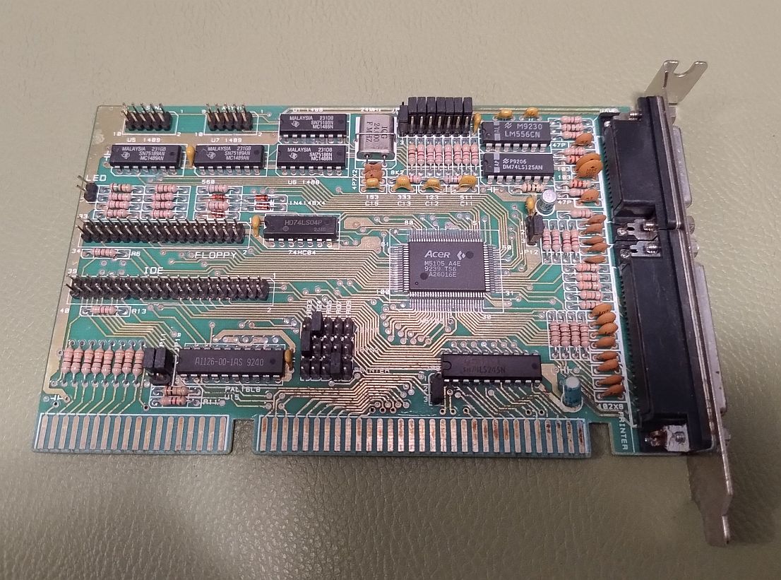

    On 486 motherboards, disk controllers were usually already built-in. In older computers, the motherboard only had a keyboard socket (large DIN). All other interfaces were on expansion cards. A standard disk controller had two slots: a long ISA slot for the hard disk and a short one for the floppy drive, plus a parallel port and a 9-pin serial port on the first bus, and a second 25-pin port on the second bus. The 9-pin port was usually occupied by a mouse; the parallel port could be used with the aforementioned Covox, whilst the 25-pin port supported a null modem cable – for gaming between two computers :-)
    As for the IDE ports on sound cards, their use was a bit more serious – a CD-ROM drive was connected to them. The disk controller didn’t support drives larger than 512 MB – which wasn’t a problem, as drives back then had standard capacities of 40/80/105 or, incredibly, 170 MB. However, a CD-ROM disc had as much as 640 MB – which the standard controller could not address. Hence – quite logically, in fact – the idea that the CD-ROM should be handled by a sound card. At the start, there was another issue – many CD-ROM drives had their own interface, which was physically incompatible with IDE. I have a sound card in my collection that had as many as four different CD-ROM interfaces – apart from IDE, there were also SONY, PANASONIC and MITSUMI...
