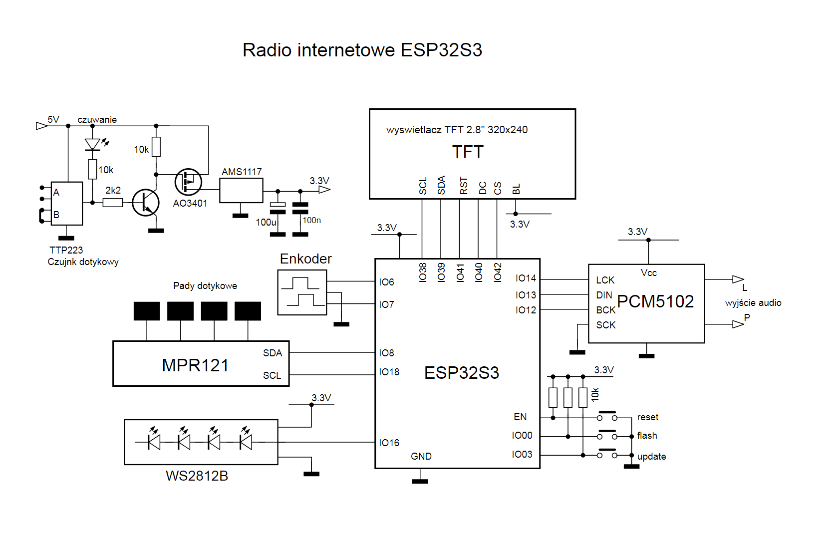

    Radio: The chip is based on ESP32S3 and a 2.8 inch IPS display. MPR121 touch support. Four touch buttons for mode selection and an encoder for scrolling through the radio station list. As the software stands today, the stations are stored rigidly in it (5 banks of 20 radio stations each). For me this is still a huge amount.... It might be worth adding SD card support and putting them there. There are no bytes here. I select a station and "play".
    I downloaded the station list from the @robgold account on github. The ESP32-audioI2S library patches and core ESP32 version 3.2.0 patches were also downloaded from this account. thanks for sharing.

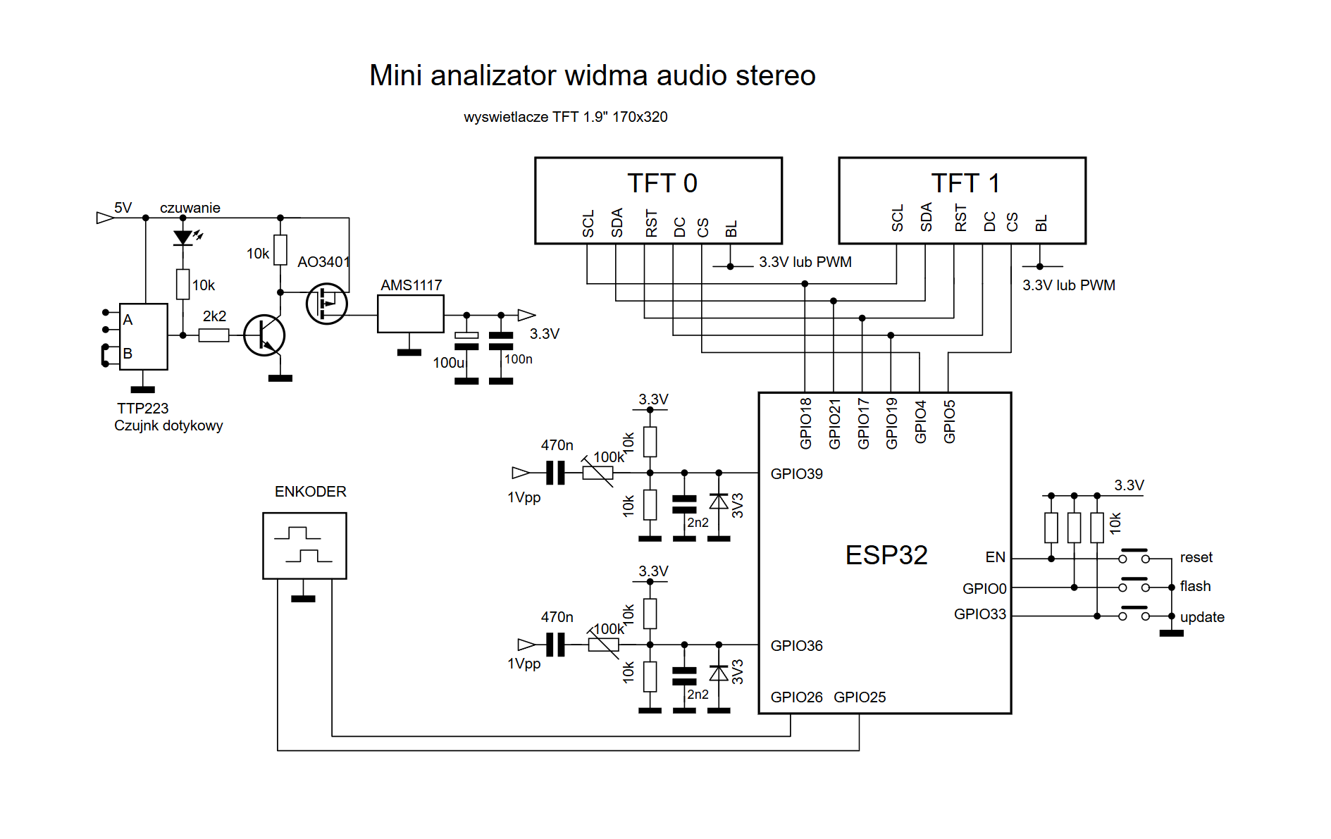

    Widmo: ESP32 and two 1.9 inch IPS displays. Here both cores are used for maximum processing power. Sampling the two ADC channels and FFT processing requires considerable computing power. The refresh rate of each display is 37 to 41 Hz (FPS), depending on the motif being displayed. Themes are selected with an encoder. The device remembers the last selected theme.

    Diagrams:
    DIY micro tower (desktop version)

    The radio's schematic incorrectly described the ESP pins connected to the PCM5102. I have changed the schematic to the correct one.
    I have corrected the spectrum diagram.

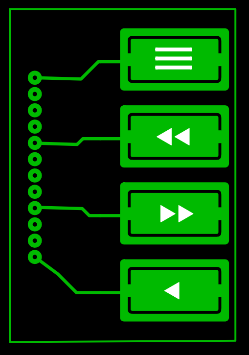

  • Modified MPR121 sensitivity enables touch through glass
    #13 21899490
    efi222
    Level 22  
    Posts: 773
    Help: 12
    Rate: 1212
    Jawi_P wrote:
    I am surprised that the touch switches work through the glass layer. Could you write something more?
    I didn't go without modifying the Adafruit_MPR121 library to increase sensitivity. The modified library is available in the package with the radio source - (src/Adafruit_MPR121). There is a description of the changes there.
    The auto-calibration of the touch pad sensitivity is also started at program start (setup()).
    The pads are 17x9 mm in size, with a gap of 2 mm between them. Care must also be taken to ensure that they fit snugly against the glass.
    Green PCB diagram with four button icons and traces leading to a left-side connector
    Unfortunately, this patent does not work with the PLA "button" even though it is much thinner. This is why other touch sensors are used there.
