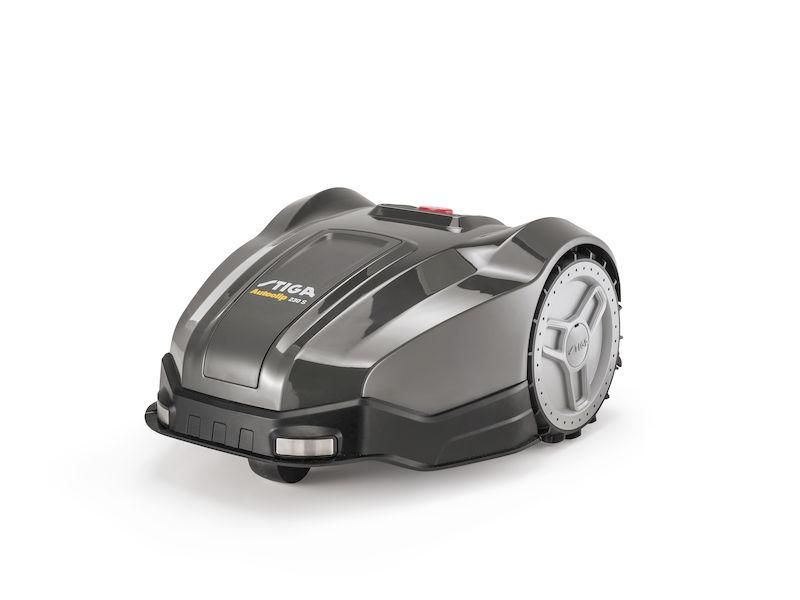

    I have recently invested in an alarm system and a robotic mower (about 10 kg, 537 X 420 X 252 mm). Despite reducing the 'sensitivity' of the alarm it still goes off when the mower is running. I live abroad for a few months of the year, so manual control during this time is out, and turning the alarm off for 6h a day also misses the point a bit.

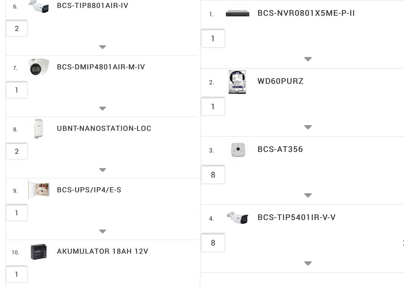

    You write about an alarm system and upload a picture of a surveillance system. Describe what components make up this alarm system because without this it is difficult to advise anything.

    I am a complete layman - forgive me. This is the information I received from the installation company:
    (if this is not enough then please let me know what questions I can still ask them).

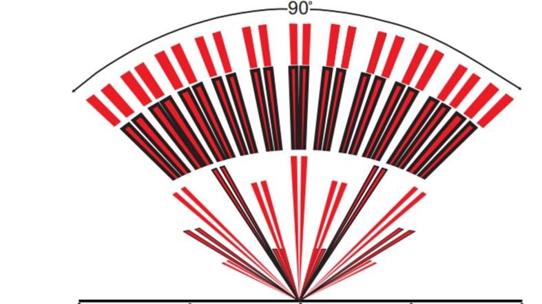

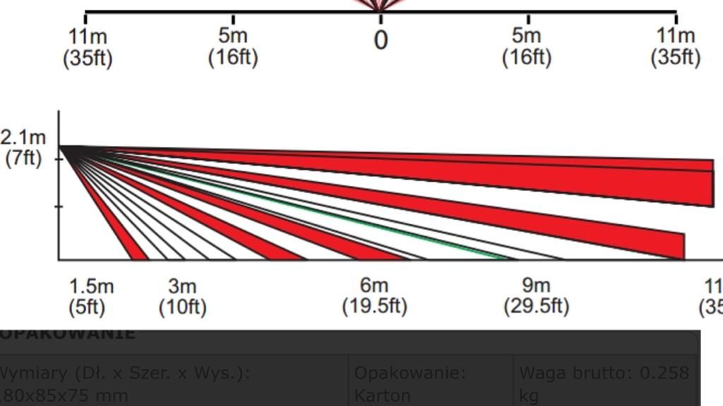

    Paradox DG85 alarm detector
    How do you avoid false alarms with your mowing robot? How do you avoid false alarms with your mowing robot?

    You just bought a weak one of these mowing robots that doesn't have Stealth technology. :) .
    You require the motion detector to not detect movement from an object that is driving and emitting heat.
    Set the robot to drive at 0.1m/s then maybe it won't detect it. After all, the specification says detection from 0.2 to 3.5 m/s :) Sometimes things go wrong.
