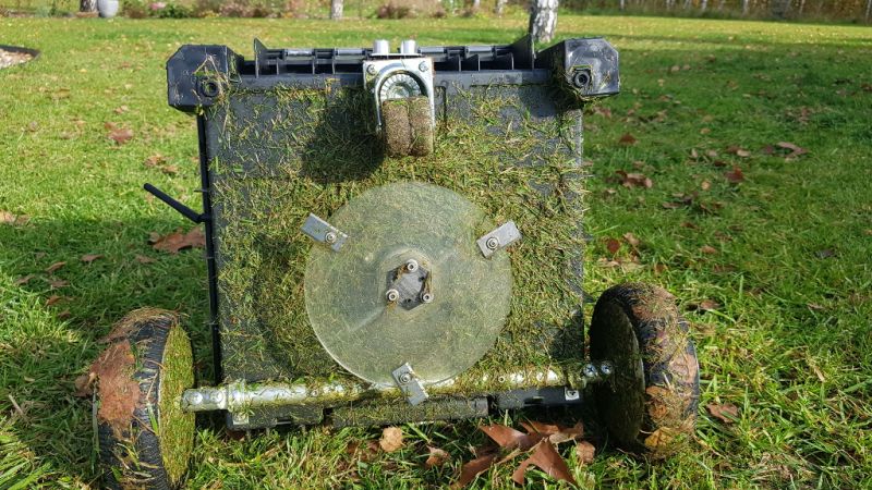

    The running gear is built on 3 wheels, two drive wheels from a scooter once bought for a penny, they have a built-in drive system (bldc motor with Hall sensors), their advantages are high torque, simple adaptation to any structure and resistance by design to dirt. The third wheel is a furniture free-turning 360° wheel. The cutting system is the original motor from the Worx stand-alone mower, a custom cutting disc together with 3 knives from the Landroid mower (enlarged slightly than the original to increase the cutting diameter). Macalister brand housing or toolbox ;) .

    The original cutting disc for this engine is a little small and I'm keen to mow wider, at least 20cm (the original is 14cm, I think). The engine has plenty of power, so I can easily handle a larger one. The disc is CNC-cut from polycarbonate, with 3 cutting blades bolted to it every 120stp. Cutting height adjustment is achieved by selecting a suitable extension between the disc and the mounting bracket on the motor axis (3D printed component). Cutting height is adjusted very rarely, in fact only once, so unscrewing the 3 screws holding the extension piece and the disc is not a problem..

    Phantom wire detections where there is none. It turns out that the spinning knives generate Manchester decoder-detectable pulses that every now and then randomly match the 16-bit pattern (we only have 65tys of combinations) i.e. its mirror image. This is not a significant problem (the mower just changes direction). I plan to change the transmit frequency to not coincide with the rotation of the disc and possibly change the code to 32bit which will definitely reduce the likelihood of random generation by interference of this type.
    A free steering wheel with an exposed steering bearing is not a good idea, I'm worried about it seizing up quickly with cuttings. This is where adding a planned cutting disc guard or replacing it with a wheel with a shielded bearing might help.

    I will provocatively comment that the shield is for proper mulching, not finger protection ;-) .
    As for the emergency stop button and the tilt sensor, it is implemented.
    Attempting to lift the mower, for example if it is stuck on a bump, may result in nail damage :-)
    Similarly, when outsiders start watching it, for example, guests at a barbecue, when someone says: "what a cool gadget you made, hold my beer, I'll watch it".
    Not only a cover would be useful, but also an independent blockade of the knife drive when the mower is lifted and not with all wheels firmly on the ground.
    I'm also considering a polycarbonate dial. Knife mounting can develop over time, better bearings would be useful there. For example, some rigidly embedded sleeve that is the bearing of the knife. Do you have something like this?
    There is bushing. The knives do not touch the disc at all during the swing. This shield is rather temporary, although the polycarbonate here was chosen on purpose because it does not break as easily as "plexiglass".
    Perhaps I will replace with a genuine Worx dial.

    Polycarbonate is not "plexiglass", that's why it was used because it does not chip. It is virtually indestructible.

    I see that you need to realize what function these types of mowers are supposed to perform. All autonomous/robot mowers (those commonly available, not some for special applications) are not used to mow weeds and lawns that have been neglected for weeks. Because they drive every day only with breaks for charging and possible rain, their task is only to trim the daily growth, i.e. a maximum of 1-3mm per day. And that's just what they're for. Due to their regularity in operation, they do not need a 10 cm wide and 20 cm long scythe.
    For the same reason, they do not need a large number of revolutions of the blade disc, which they make up for in being closer to a razor than to the scythe blade of a classic mower. The blade of such a mower can be cut like a razor, I have experienced it many times.
    Such a mower, of course, will not cope with a neglected lawn like a petrol mower with a 3kW engine and a 10x30 scythe because it is not designed for this purpose. If for some reason (mower failure, lack of power) such a mower does not go to work for several days, you have to pull out the classic mower and prepare the lawn for the autonomous mower again (at least in most cases).
    My mower's cutting disc and blades are no different from any other on the market.

    The project was created at the end of autumn, so there was not much opportunity to thoroughly test it. This season, the mower has been running for a month and I can share a few observations. The mower serves two separate areas (approximately 600m2 and 150m2, cutting width 36cm) separated by a boundary wire. The separation is intentional, more on that later.
    Current insights:
    1. Fears that random mowing (without a special algorithm that selects the area to be mowed) may be problematic (so that in a reasonable amount of time the surface will be equally even after mowing) did not come true. The mower drives all day every day and after a few days from the start (after initial mowing with a regular mower) the grass looks evenly mowed.
    2. One-day breaks in mowing due to rain do not cause visible "stubble". We'll see how it goes with longer breaks.
    3. 2 batteries, 4s each, 10Ah connected in parallel, are sufficient for at least 14 hours of continuous operation. For the time being, I do not see the need to build a charging station and add such a function. I take the mower to charge at night and start in the morning. And so, every day before the start, I sharpen the knives, so I don't mind this daily manual start.
    4. The mower serves two separate areas. Larger from the morning until 6 pm and smaller after 6 pm. At this time I translate it manually or direct it via remote control supported by video monitoring if I am not on site. The division into two areas is due to the fact that there is a rather narrow isthmus connecting them, hence the fear that there would rarely be a chance for it to freely pass between them. The mower would get stuck in one area for quite some time before it would scramble to an adjacent area. And by separating them, I can be sure of "staying" for a certain period of time in a given area.
    5. When constructing/adapting a lawn to such a mower, it is necessary to take good care of the edge with the boundary wire, especially the surface behind the edge, so that there is a margin of even surface of at least 15 cm for possible driving of the front wheels so that they can turn freely. It is also good to pay attention that the border wire is properly retracted so that the mower can mow the edge of the lawn.
    6. The front wheels that turn freely are sometimes problematic. Currently, there are two (typical for trolleys), but they have the feature that they sometimes set sideways in the unevenness of the ground and block the movement of the mower when turning. I will try to replace these wheels with original ones from Landroid where they are wide and their vertical alignment is at a certain angle that prevents such blocking.
    7. The automatic change of knife rotation has a positive effect on battery saving. If there is greater cutting resistance (thicker grass), the mower increases the revolutions, if less - it decreases.
    8. So far, 3 edge wire sensors are sufficient, two at the front on the gauges and one at the rear to detect backwards out of bounds. The location of the front ones must be carefully thought out. I extended them a little too far to the cable for fear that the front wheel would not go too far into the edge, which is not perfect everywhere. As a result, I have in some places unmowed at the edge. I intend to eliminate this problem in the future by properly reconstructing the edge of the lawn.
