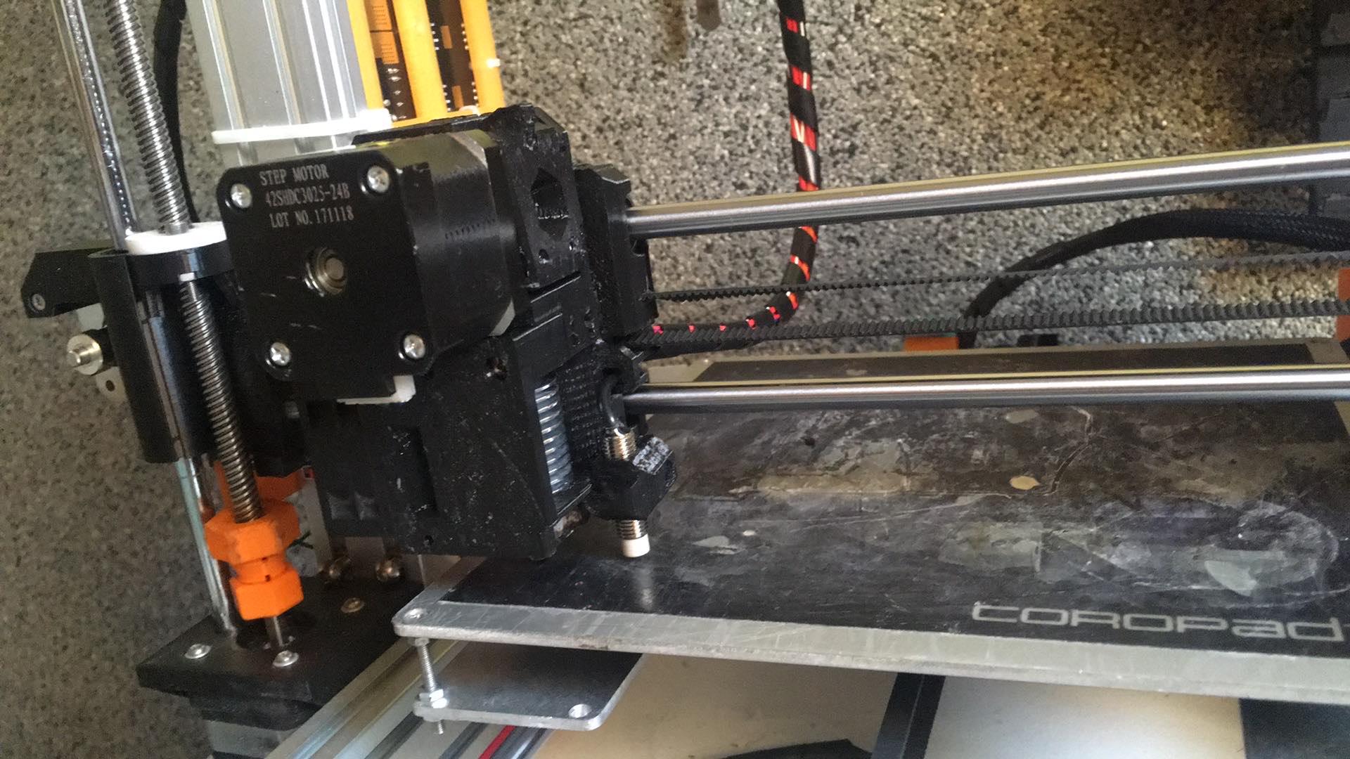

  • Anet A8 was rebuilt into a stiffer 3D printer with a 2040-profile AM8-style frame after the original polycarbonate structure cracked repeatedly.

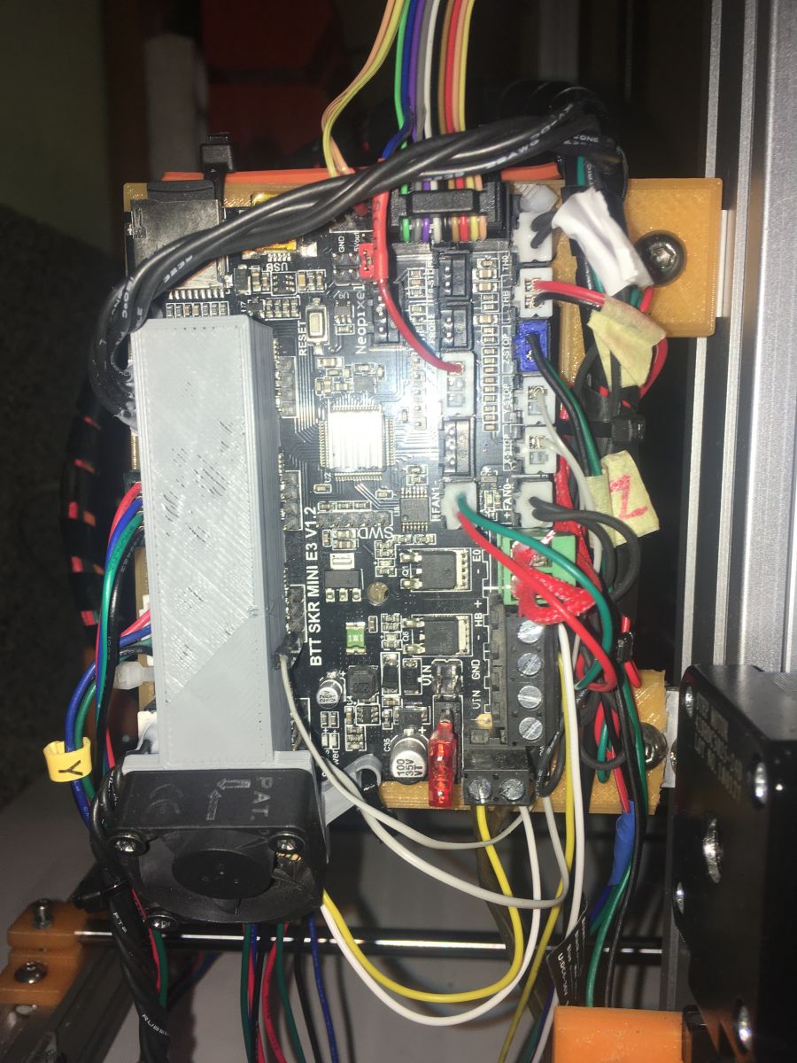

  • The electronics moved to a BTT SKR Mini E3 v1.2 with STM32F103RCT6 and four TMC2209 drivers, while classic limit switches stayed in use.
  • The build reuses the original 42shdc3025-24b motors and trapezoidal screws, but upgrades to Misumi fi8 linear shafts, iglidur L150 backlash-free nuts, and Prusa i3 MK3 X/Z parts.
  • Firmware runs Marlin 2.0.5.4, the hotend reaches 300 degrees, and the Y bed uses an external NMOS heater module with a Coropad 202x202 mm surface.

    With such a frame, it doesn't print accurately.
    How many steps does the extruder have? If it has no gear ratio it's also a tragedy, it gives 25mm per revolution. You didn't write anything about the belts I guess you didn't leave the nylons.

What’s the best budget control board upgrade for an A8?
The SKR Mini E3 V1.2 is a proven drop‑in‑style upgrade. It brings a 32‑bit 72 MHz STM32F103RCT6 MCU and four TMC2209 drivers in UART. Benefits include quieter motion, sensorless features potential, and better firmware support via Marlin 2.x. [Elektroda, Anonymous, post #18877376]
What is TMC2209 in plain terms?
TMC2209 is a stepper motor driver known for quiet operation, UART configuration, and features like collision/sensorless detection. In this build, all four axes use TMC2209 over UART for fine control and future sensorless homing experiments. [Elektroda, Anonymous, post #18877376]

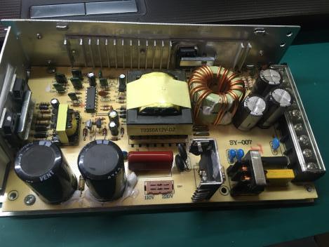

How do I control the heated bed safely on 12 V?
Use an external NMOS/MOSFET module to offload bed current from the mainboard. Upgrade bed wiring to silicone leads and strain‑relieve them in a braid. This reduces connector heat and board damage risk. [Elektroda, Anonymous, post #18877376]

Yes. Plan a small board to detect mains loss via an optocoupler, notify the MCU, then raise Z or park the head while capacitors hold up power. Increase PSU capacitance if needed for time margin. [Elektroda, Anonymous, post #18877376]
3‑step: How to set up basic power‑loss recovery on Marlin?
  1. Add a transformerless detection board with an optocoupler output to a spare MCU pin.
  2. Configure firmware to save head position on trigger and lift Z or move off‑part.
  3. Increase PSU capacitance to ensure enough hold‑up time for the move. [Elektroda, Anonymous, post #18877376]
What build plate and mounting worked best here?
A 0.5 mm H17 stainless flex plate over the MK3 bed held with N38H 10×5×2 magnets worked well. Grooves for magnet seating and optional dowels or corners prevent plate shift; underside insulation reduces heat loss. [Elektroda, Anonymous, post #18923845]
