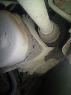

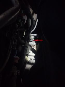

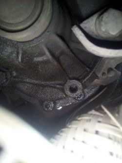

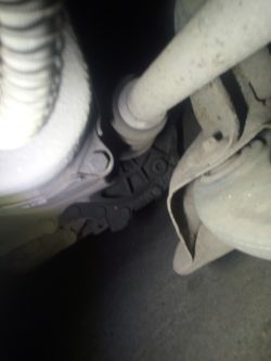

    I wanted to change the oil in the gearbox, but I don't know where the oil level cap is. According to the instructions I have, it looks like this:
    Locating the Oil Level Cap for Gearbox Oil Change in Peugeot 206 1.4 75km Locating the Oil Level Cap for Gearbox Oil Change in Peugeot 206 1.4 75km

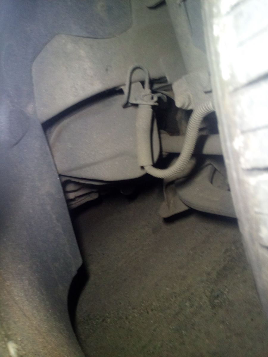

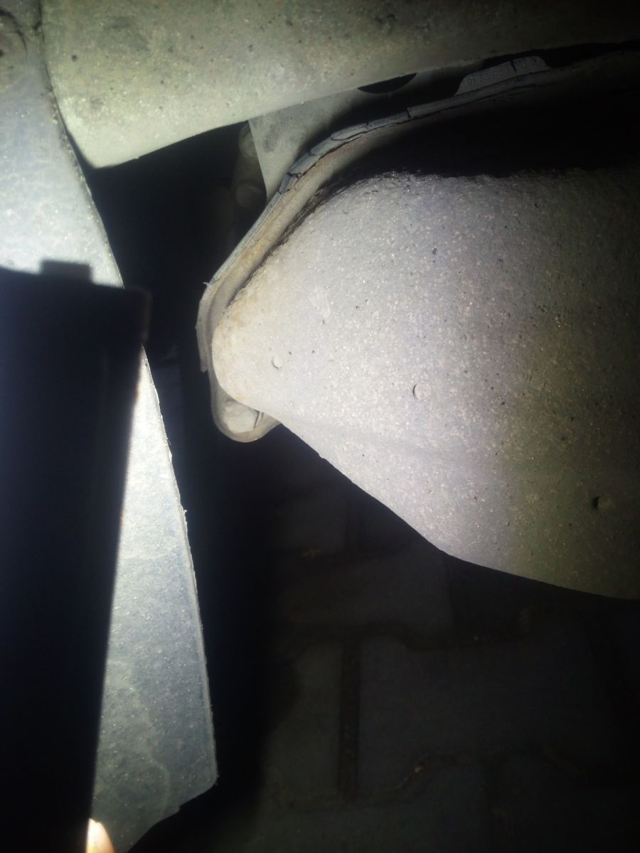

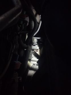

    And in my car:
    Locating the Oil Level Cap for Gearbox Oil Change in Peugeot 206 1.4 75km Locating the Oil Level Cap for Gearbox Oil Change in Peugeot 206 1.4 75km Locating the Oil Level Cap for Gearbox Oil Change in Peugeot 206 1.4 75km Locating the Oil Level Cap for Gearbox Oil Change in Peugeot 206 1.4 75km Locating the Oil Level Cap for Gearbox Oil Change in Peugeot 206 1.4 75km Locating the Oil Level Cap for Gearbox Oil Change in Peugeot 206 1.4 75km Locating the Oil Level Cap for Gearbox Oil Change in Peugeot 206 1.4 75km Locating the Oil Level Cap for Gearbox Oil Change in Peugeot 206 1.4 75km
    I'm guessing it's the oil filler cap:
    This is the drain plug:

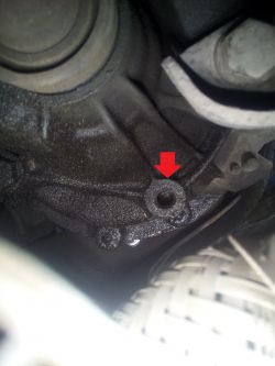

    But I don't know where the status plug is and someone can tell me what this hole is in the box on the engine side (it is threaded):
    Or maybe there is no fill cap and only the appropriate amount needs to be poured? Thank you in advance for the information.

    You marked the transmission vent with a small red arrow
    The recommended oil is 75W-80, quantity 2 liters
    You pour it in by unscrewing the sensor next to the breather
    Regards

    So I drain what's inside, pour in 2 liters and it's OK and I don't check the condition? Do you know what's going on with that threaded hole at the bottom of the box?

    Yes, you pour the right amount.
    The MA type mechanical box was installed in various models, hence the threaded hole.
    Regards

    So this is a mounting hole for other cars, right? Should I leave it like that or cover it/screw in some screw?

    Yes, it applies to other cars, it remains free.
