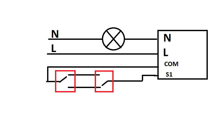

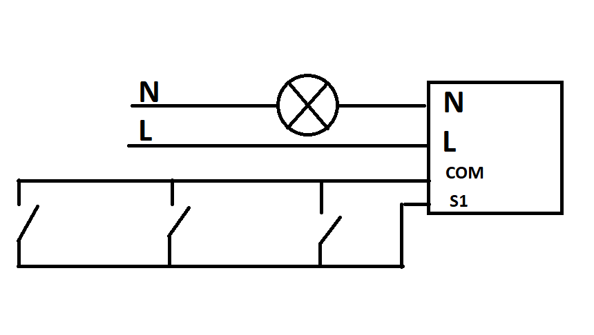

    If you can configure the bell switches as pressing changes the state:
    Zigbee Lighting Control with Tuya Relays: Stair Switch & Wall Remote Setup .
    If you keep the existing connections and you will be able to make the connections (that's by specification):
    To check what the configuration options are and how the relay will behave when controlled from the app and switches for example.
    If COM and L or N are connected it can still simplify the diagram.
