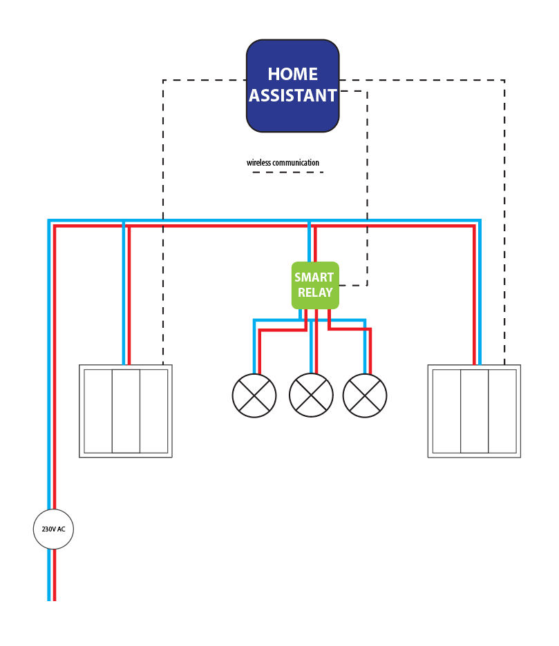

    I would like to make a stair switch in the living room according to a diagram like this
    Installation diagram of a stair switch with three circuits and a smart relay. .
    At the moment I have a stair switch operating one circuit in the same place. I would like to extend it to 3 circuits as shown in the image above.
    Can you recommend:
    - An on/off switch, zigbee or wifi for three buttons, mains powered
    - A compatible relay controlling 3 circuits
    Thank you in advance.
    Aha -
    1. there is no possibility of adding cables.
    2. I would like 230V powered switches to avoid batteries

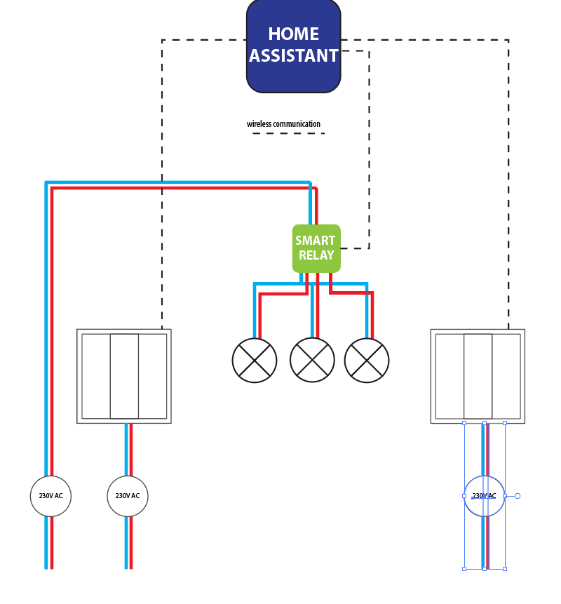

    What wires do you have in your contact boxes, how many?
  • #3 21355004
    azmurowski
    Posts: 13
    >>21354998 .
    I supposedly have five, but I can actually rely on having two - one circuit because the electricians messed something up and one of the switches can only turn the circuit off, but then the other one won't turn it on.
    The best way to think of the whole circuit is like this
