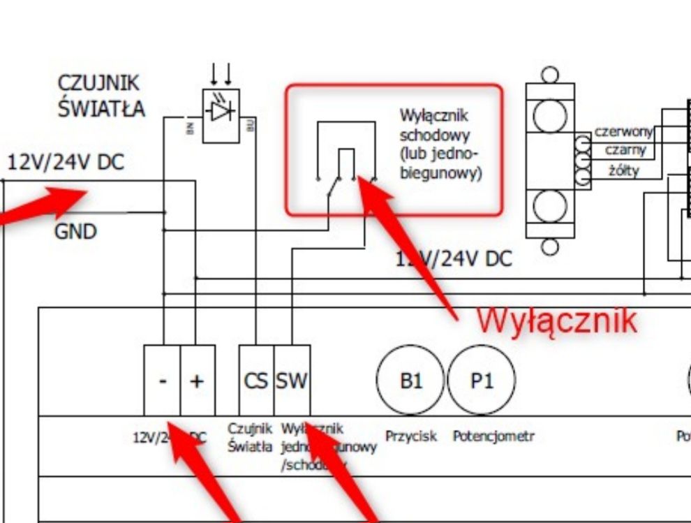

    I will be setting up a controller to illuminate stair treads, the controller has a constant light function via a stair switch.
    The controller is on 24 volts.
    To this I want to connect some kind of Wi-Fi/Zigbee relay so that I can switch on the permanent lighting from Home Assistant.
    Only 1 - there is only 24 V current flowing there, 2 - from one socket goes one cable to the controller, the other to the minus from the power supply and that's it.... And of course between the sockets 2 signal cables.
    How do I figure this out?

    The relay does not apply voltage, it just closes the circuit like a switch.
    What do you mean by a Wi-Fi relay? Can you provide a reference for this device?

    If it is as shown in the diagram, i.e. shorting the SW input to GND switches the light, then at its simplest a 'voltage free relay' will suffice, i.e. one that connects/disconnects the contacts and does not feed the phase to the output. There are loads of these, but they will all have one problem. You won't know from the HA whether the light is on or off. Because just because your relay will be disconnected doesn't mean someone hasn't switched the light on with a stair switch.
    So if you also want to monitor the on status of the lights, you will need to control the stair switches with a Zigbee/Wi-Fi relay, which will be the actuator for feeding ground to the SW input.

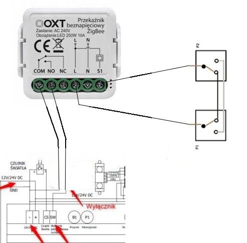

    It is exactly as shown in the diagram, and how do I control the relay with the stair switch?
    Will you send some schematic and device?

    Well, only then my stair switches won't work, unless I'm thinking wrong....
    Where would I mount such a relay?
    On the 1 wire from the switch to the controller?
    If I mount it in front of the switch, then if I have the relay off, I won't be able to switch on the switches, and vice versa.

    As far as I can see from the description, it should be possible to operate the relay in several modes, either bistable and then switch on impulse (bell switch) or monostable and then a traditional staircase circuit should work. It's just a shame that it requires 230v. I think Shelly used to make relays for 24vdc

    Wiring diagram for an OXT relay with stair switches. .
    In my opinion it should look like this . Of course connect N and L under the module

    So should I connect 230 V to this ?
    And if I switch on on the staircase, I can switch off on the relay and vice versa ?

    Yes, but you will find details in the manufacturer's manual for this module. I personally haven't dealt with them and haven't integrated them into HA either.
    This particular module is not in the compatibility database but it is similar and is supported by ZHA so it should work "out of the box" ;) https://zigbee.blakadder.com/OXT_SWTZ22.html

    kmarkot solution works, thanks ! 😁
