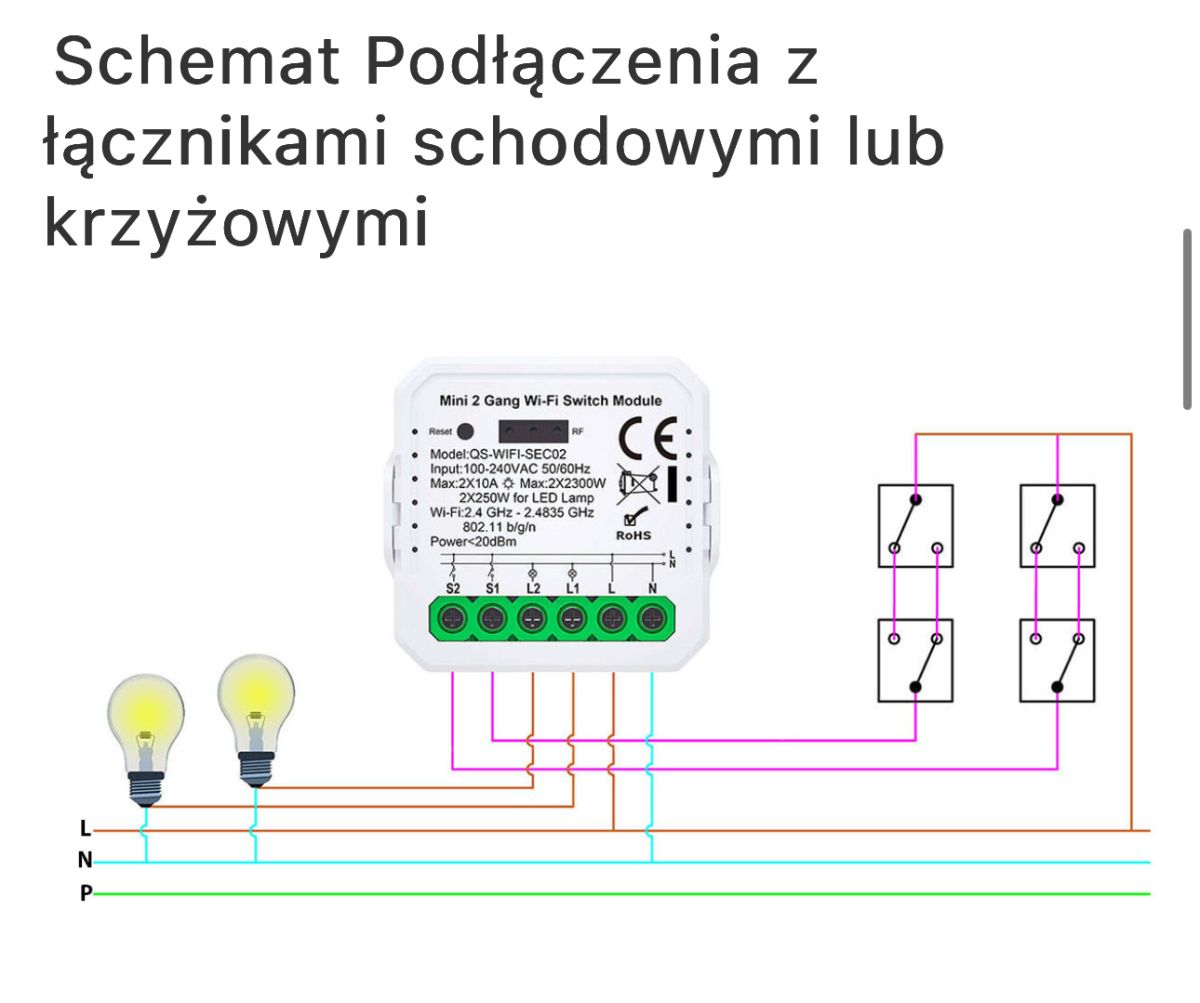

    I'm in the process of planning an electrical installation at home and have encountered a conundrum as to how to connect a smart home device from Tuya to an installation with lighting.

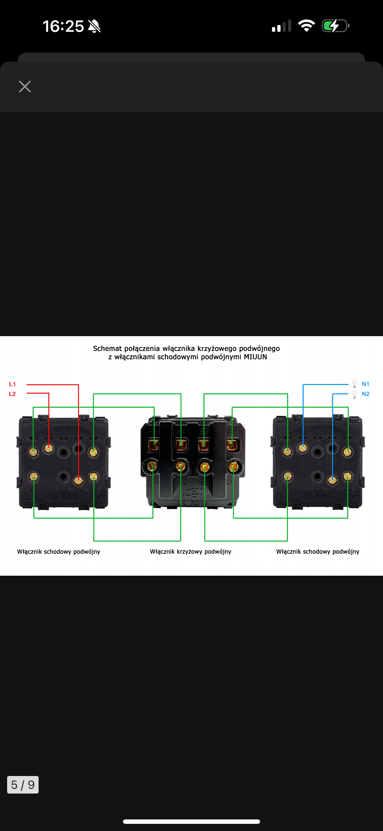

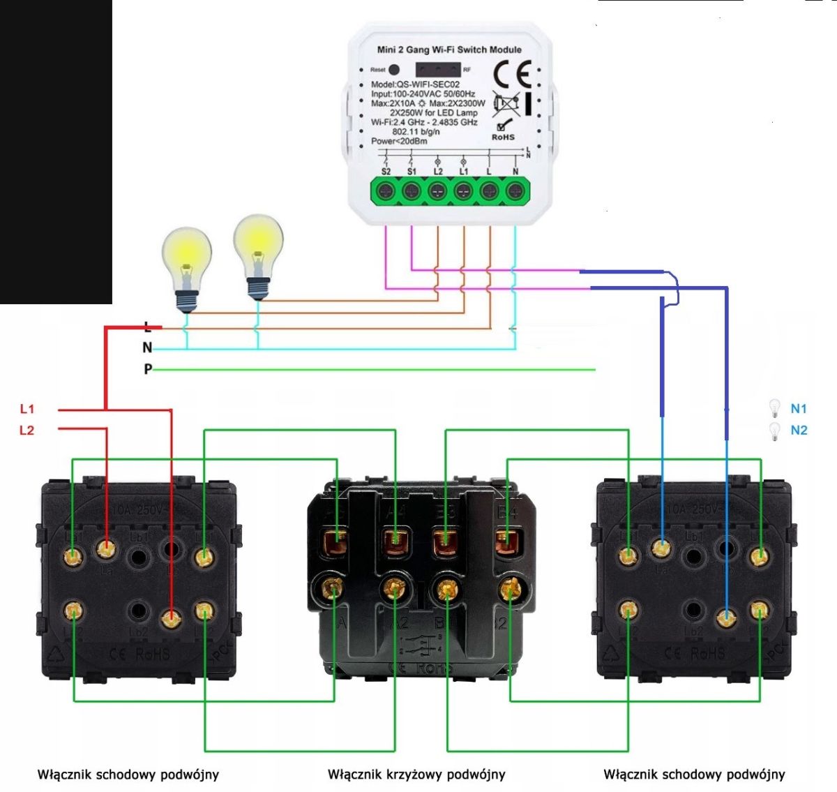

    The diagram would look as follows: 2 light circuits, 3 double switches (2 staircase, one cross) and I don't know how to connect this to the module from Tuya. The cables haven't been laid yet, so maybe someone can help how to do it right. Below are 2 diagrams that I would like to connect together.
    Wiring diagram for connecting three switches (two double stair switches and one double cross switch) in a lighting circuit. .
    Diagram of Tuya Wi-Fi module connection with two lighting circuits and staircase or crossover switches. .

    You connect according to the diagram as for a cross connection.
    Wiring diagram for a Wi-Fi switch module with double staircase and double cross switches and light bulbs. .

    Is anyone able to diagram this for me yet along with connecting to the network? I'm trying this way but something must be going wrong. The tuya works, but the switches don't.

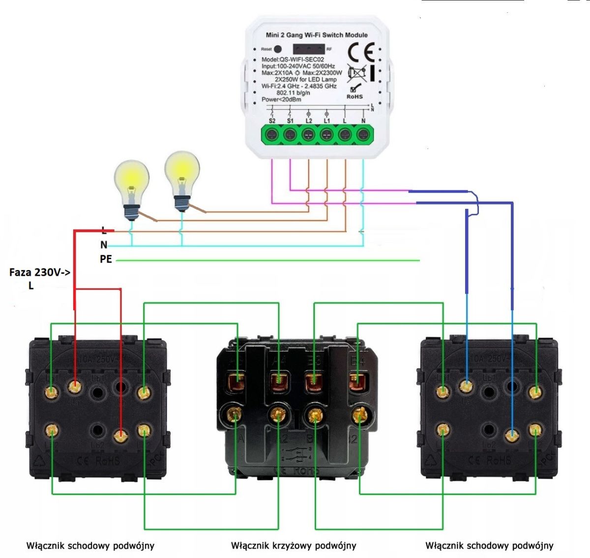

    You have drawn.
    L1 and L2 are the power line (Phase)-the wire colour 230V brown or black
    N-neutral - cable colour blue
    PE-ground - wire colour green/yellow
    You connect the N wire directly to the lighting point (bulb), and to the power supply of the SMART module
    L wire is connected through the switches and the SMART module as shown in the diagram.
    Connect these switches on the table for a test, it appears that you are connecting the switches incorrectly.
    Diagram of Wi-Fi switch module wiring with double stair and crossover switches to control two light bulbs. .

    After further tests it appears that the problem is with the cross-over, most likely I have a faulty switch, on the two stair switches alone everything works.

    #7 21531892
    pajutoja2
    A solution was found! Final cross switch working, as a colleague wrote, but I didn't mess up the wiring, and the diagram from the manufacturer for connecting the switches was wrong. To make it work, it's a diagram as above, but with the difference of plugging in the cross switch. Looking at the diagram above, the wires going from the left hand staircase should be plugged into the top wires on the cross-over (not 2 top and 2 bottom from the left as in the diagram), and down plug the wires going to the right hand staircase, plugging in the wires, keeping the analogy of plugging in from the top wire on the left hand staircase.
    And then everything works: both staircase, cross and Tuya :) .
