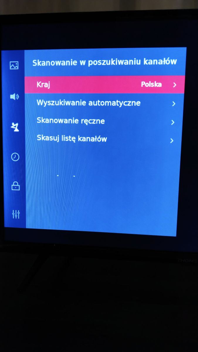

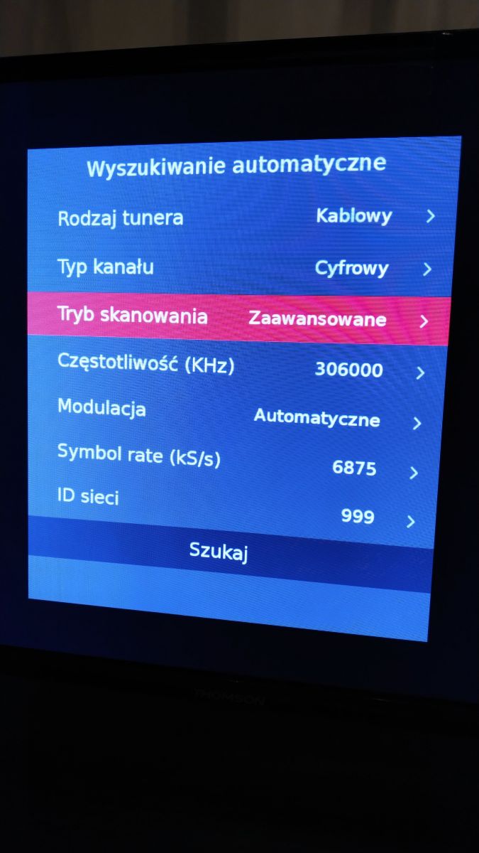

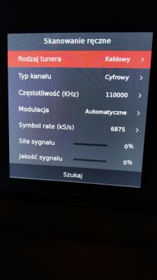

    Please provide the model of this TV.
    Connect the antenna cable and put the other end out of the window.
    Go to TV settings - Tuning / installation of channels - Digital - show what you have there, because it's definitely not what you wrote.

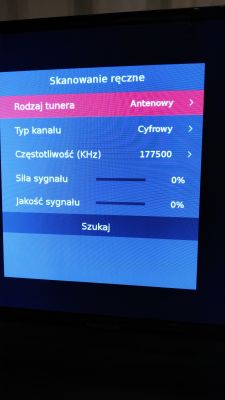

    Thomson 32HD3301
    Attached are screenshots from the TV - when choosing the automatic option -> digital antenna tuner, I have nothing else to set. Terrestrial TV in Winogrady, Poznań: How to Improve Reception on 1st Floor of a Block? Terrestrial TV in Winogrady, Poznań: How to Improve Reception on 1st Floor of a Block? Terrestrial TV in Winogrady, Poznań: How to Improve Reception on 1st Floor of a Block? Terrestrial TV in Winogrady, Poznań: How to Improve Reception on 1st Floor of a Block?

    Frequency 522000 and 205 500 check if it shows Signal Strength and Quality.
    I put an electric cable on both sides of the antenna cable and started the search (my woman means, because I was standing on the balcony like a moron :D ). What was my surprise when it found channels on both frequencies, and in quite decent quality - from TVP, through TVN, Polsat, to TVP Sport (twenty-some channels in total). So in the cheapest version I have to twist a wire antenna, unless someone knows a better solution :) . Thank you very much for your help. I think the topic to be closed.
