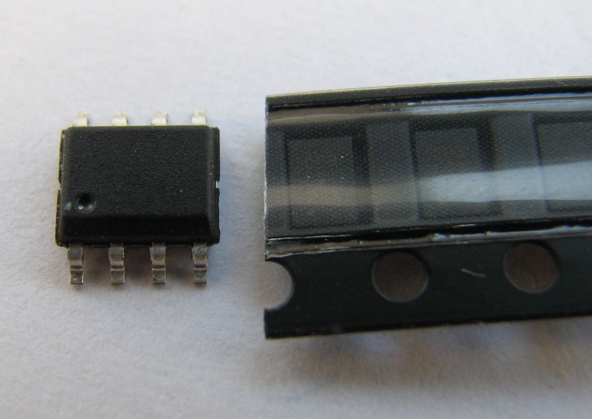

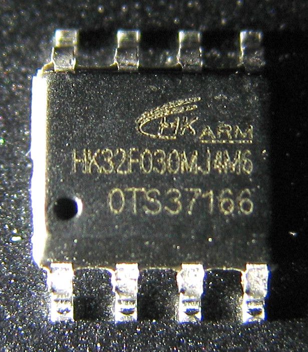

    #34 19084487
    piotr_go
    DIY electronics designer
    Posts: 2913
    Help: 94
    Rate: 3353
    HK32F030M - Chinese ARM for 15 cents
    SO8 version. They finally arrived. The local post office was in quarantine.
    By the way, I found something like this:
    Probably 30 cents :D
    Update regarding HK32F030MJ4M6-SO8N.
    There is an error in the PDF (the latest one is currently 1.0.12 and a few older ones), pins 6 and 7 are swapped.
    NRST... is pin 6.
    • DS_MM32P021_Ver1.8.1.pdf (496.53 KB) You must be logged in to download this attachment.

  • PD4 remap fixes MJ reset pin behavior
    #43 19168967
    BlueDraco
    MCUs specialist
    Posts: 6479
    Help: 939
    Rate: 421
    In MJ Reset/PA0 is on leg 7, which is the same as in the current datasheet. The code I posted above, after a slight modification - remapping PD4 to leg 1, works exactly as on MF - PD7 and PA0 change state.
    EEPROM works with common sense. As in Flash - the value deleted is 0. An attempt to erase page 0xC000000 (ie EEPROM) erases page 0x8000000 (Flash), but there is no mention of erasing the EEPROM page in the documentation.
    By the way - for the first time I have encountered a situation where the manufacturer changes the essential features of the system after the start of production, without changing the name of the system by a single character.
  • Reset pin moved from 6 to 7 on new SO8 package
    #44 19171083
    piotr_go
    Posts: 2913
    Help: 94
    Rate: 3353
    I haven't tested the newer SO8 yet, but they all have the same: DEV_ID: 0x0003, REV_ID: 0x1000
    =========== update 01/21/2021 ===========
    I tested the new SO8.
    Reset on pin 7. In the old one on pin 6.
