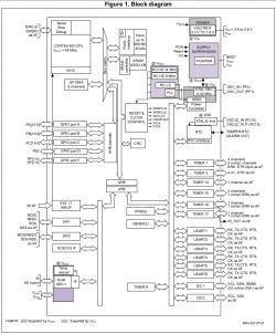

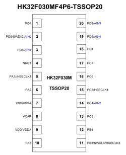

    No, this is not another STM32F030 clone as the designation would suggest.
    It is a Cortex M0 with a pinout similar to the 8-bit STM8S microcontrollers.
    STM8S/HK32F030M/STM32F030:
    HK32F030M - Chinese ARM for 15 cents HK32F030M - Chinese ARM for 15 cents HK32F030M - Chinese ARM for 15 cents
    The HK32F030M has 16kB Flash, 2kB RAM and 448B EEPROM. SPI/I2C/USART/ADC present.
    There is no DMA, PLL, or external quartz support, which is present in the STM32F030. The Chinese manufacturer added BEEPER appearing in STM8S.
    We only have 3 timers. Two with PWM and one only internal. All 16 bit.
    The internal HSI generator runs at 32MHz.
    For 15 cents in detail? There is no competition.
