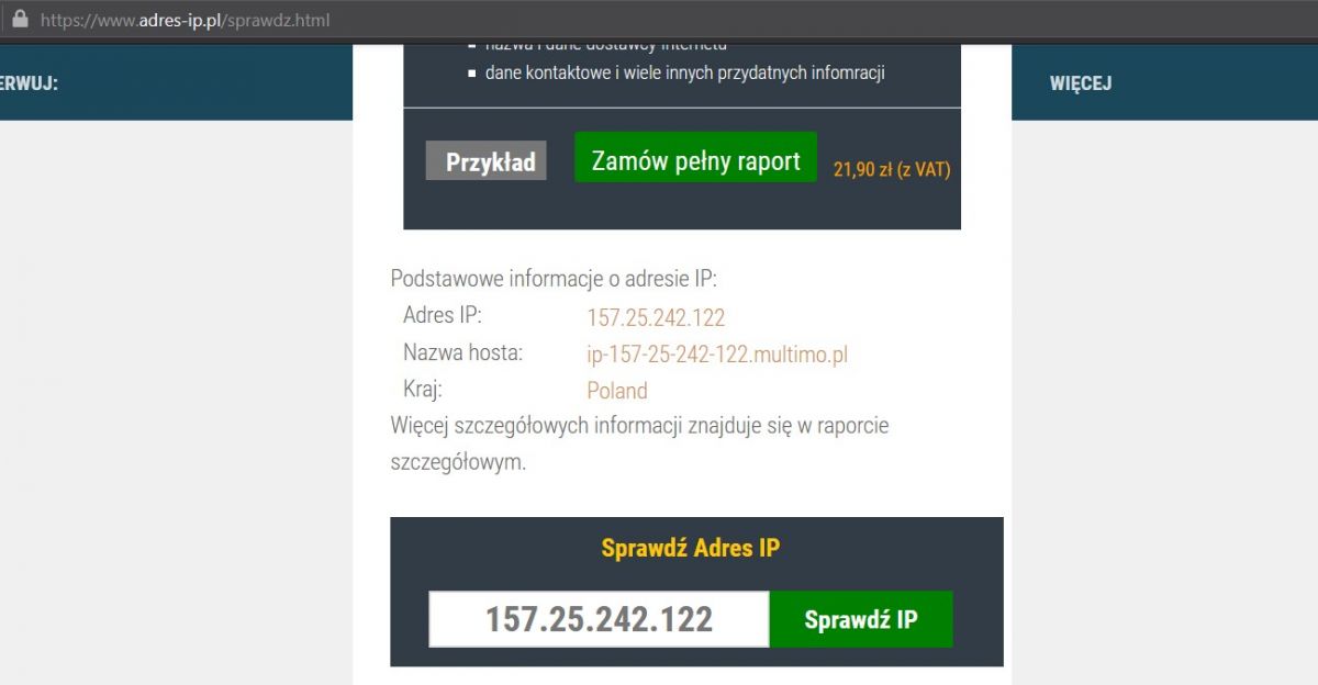

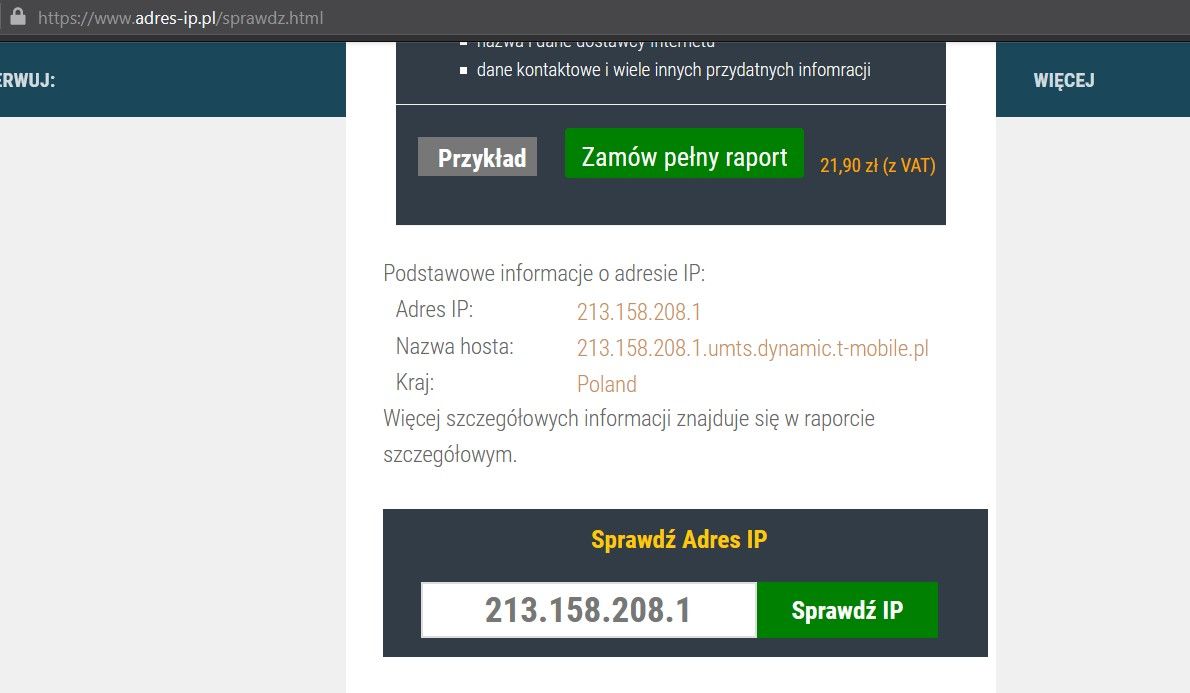

    Here: https://www.t-mobile.pl/r/repo1/tm/documents/doc_00008/Instrukcja_portalu_mojeWiFi.pdf
    There is an instruction to operate the router that T-Mobile also gives remotely.
    On page 6 of PDF see the service connection is shown and the IP is shown. If there is a private IP such as in LTE, then the IP seen in the router starts with 100, and the IP portals that show the external IP start with 188. Considering that the services for T-Mobile optical fiber as T-Mobile itself claims an INEA hotline, and INEA on the hotline claims that they give a static IP, and a static IP is probably not private, then who is right?
    Rewrite the IP from this PDF: 157.25.242.122
    I do not know if there are websites that, after entering the IP, show whether it is external or internal IP.
    The IP from the PDF points to multimo and not a PDF

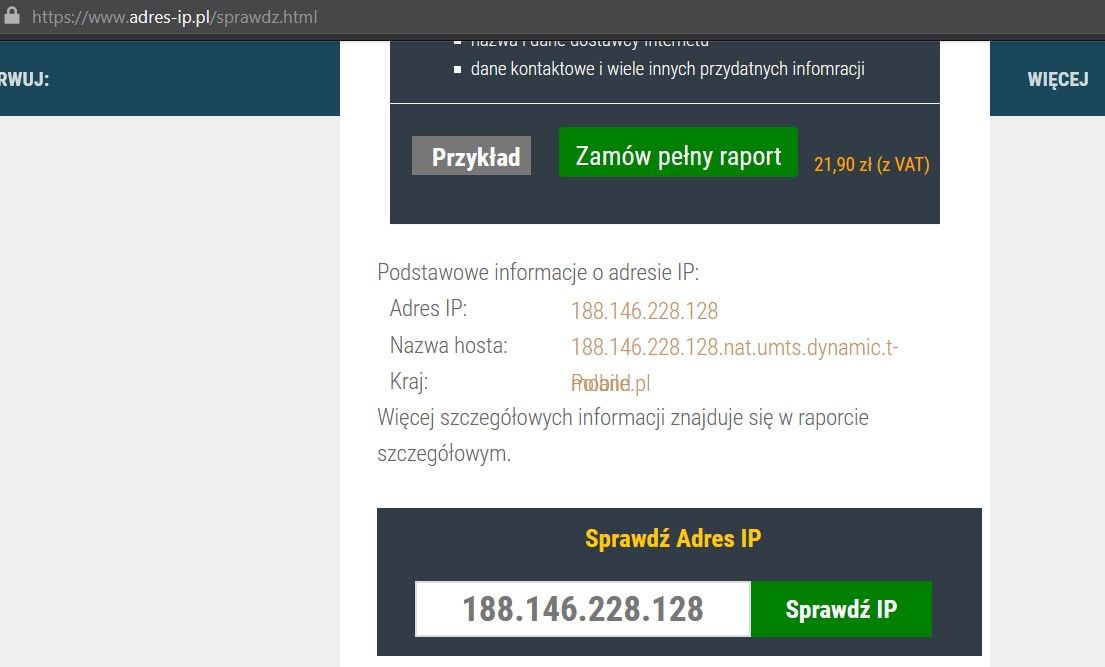

    This is the case with T-Mobile LTE being behind NAT. Host says NAT before umts:
    Configuring Razer Sila Router with T-Mobile Optical Fiber: GPON, Bridge Mode, and Equipment
    This is the case in LTE (I have a company) when buying an external, dynamic IP for PLN 12.30 gross. There is no NAT postmark in front of umts in Host:
    So it all depends on what operator for T-Mobile puts the fiber and what IP it gives, but I repeat on the regular T-Mobile hotline I say that STATIC, i.e. external, because I have not seen the constants behind NAT.

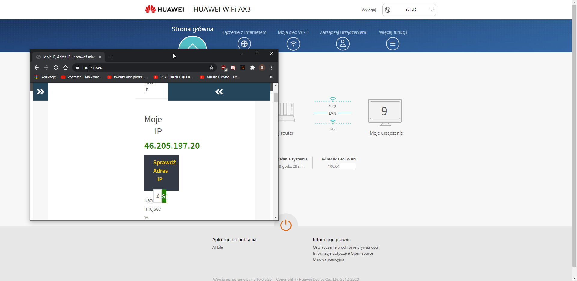

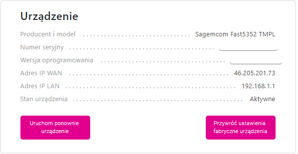

    The IP is private at T-Mobile, I wrote about it on the media forum. I have my own router Huawei AX3 Pro, I had their router maybe 5 minutes as soon as the installer set it up. I have no problem in games. I will not set up my server via private IP to be hit by someone.
    The router gets the WAN IP 100.64. *. * And on the page I have 46.205.197.20 and the last two octets change with the router reset.
    Routing is from T-Mobile, because after the packets leave your apartment, they already follow the path of T-Mobile, not Orange, they only use their cables, not routes, compared to Orange, it's like comparing the toddler (Orange) to Porsche (T-Mobile).

    On the T-Mobile router, I also had a private IP, because on the website it was public behind NAT.

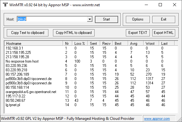

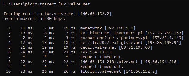

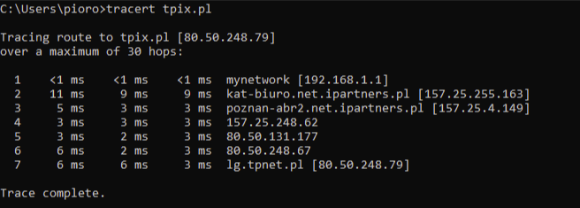

    In general, you can find two routings in T-Mobile. My friend has a completely different routing from me, just like one user on the Orange forum has a different routing from me, the same as my friend, and my friend lives 40km away from me.

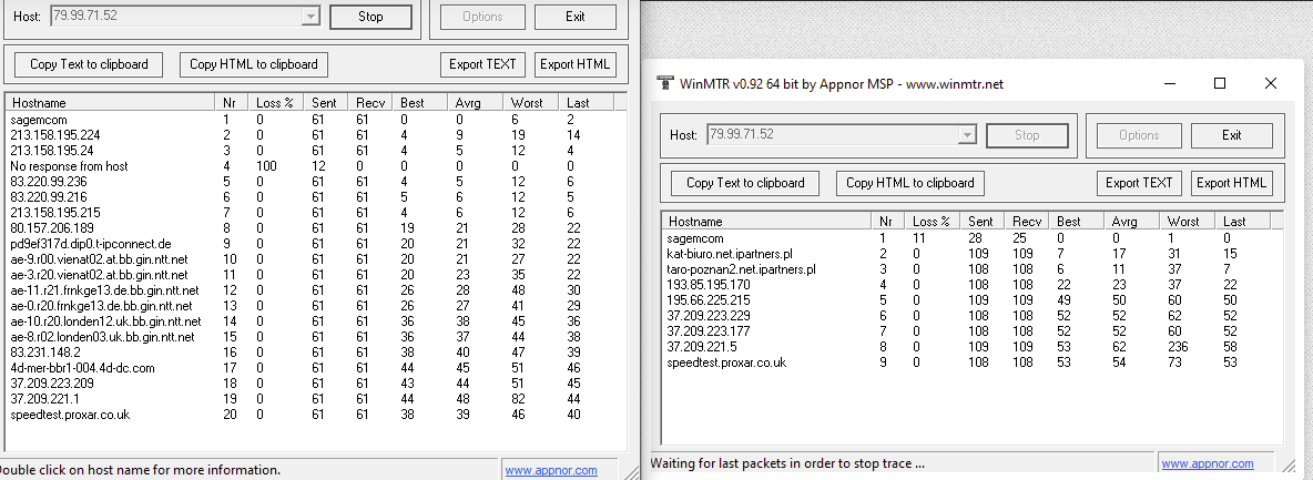

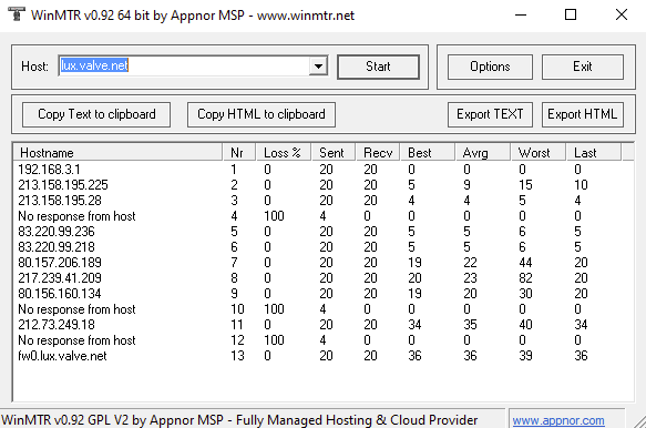

    Sample difference, my routing on the left and theirs on the right:
    My to lux.valve.net:
    Their to lux.valve.net:
    My tpix.pl:
    Their tpix.pl:
    There are many differences, mostly a plus in my case, because I have smaller and more stable pings to most hosts abroad.

    bbartek93 wrote:
    IT specialist from the bank and unknowing? OK.
    There are no private IPs from the new pool because private pools are immutable. You can have the same private IP in company X as in company Y. Public broadcasting IP
    :P is behind NAT. These IPs are then from T-Mobile, not from Orange.
