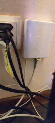

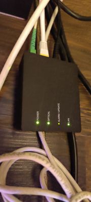

    Could someone show a picture of what this "Optical Termination of a Fiber Optic Network" looks like
    ONT "from T-Mobile from those that T-Mobile has already connected to them? I would like to know what it is about and what it looks like.

    A bit poor photos because it's dark under the desk and a bit of shit with the cables .. But you know what's going on :D
    1. Nest
    Configuring Razer Sila Router with T-Mobile Optical Fiber: GPON, Bridge Mode, and Equipment
    2.Terminal ONT

    A mess indeed :D At least I would pinch them with titles because it would piss me off :D
    Thanks for the photo, and the ONT white does not fit nicely ?? :D :D Mine likes everything white :D
