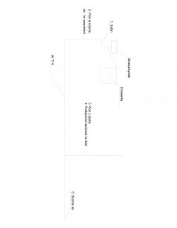

    A problem with a clogged sink.
    From the beginning.
    Single-family house, everything worked for 6 years of living in the house – until now.
    The dishwasher pumped water into the sink.

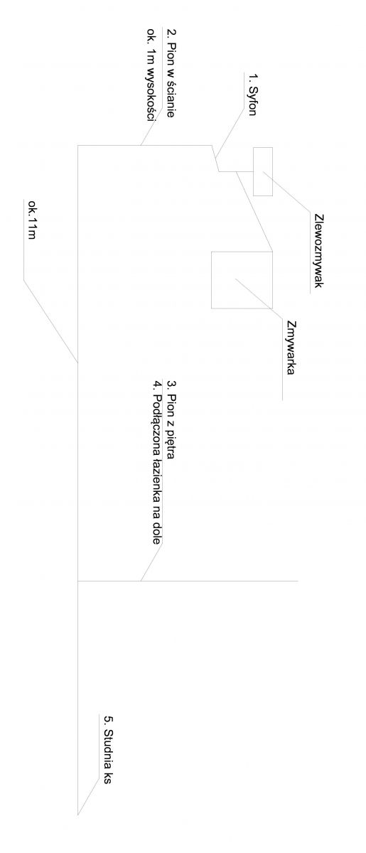

    I dismantled the trap (No. 1 according to the drawing) of the sink and into the riser pipe in the wall 1m long (No. 2 according to the drawing) I inserted a 12-meter spiral.
    I inserted several times some siphon came out. I poured water from the hose and in the ks well (No. 4 according to the drawing) I see that the water is coming down and quite quickly.
    So I disassembled everything, unscrewed the water in the sink and suddenly I see that in the strainer appears water , which does not drain down into the well (No. 5 according to the figure) as it should but pours into the sink again.
    I disassembled again, poured water into the riser of this 1m (No. 2 according to the drawing) and the water drains. I disassembled the siphon I let the water go, and it comes up to the sink again.
    Another time I disassembled, cleaned the previously cleaned pipes of the siphon, overflow sink – unfortunately, the water continues to come up.
    After about 11 m there is still a riser from the floor – water drained from the toilet, washing machine on the first floor perfectly flows into the sump.
    In the same place the downstairs bathroom is connected (No. 4 according to the drawing). After draining the loo, the water flows perfectly.
    My hands are already falling off.
    Where to look for the cause

    If we assume that all the pipes from the sink - that is, siphon No. 1 up to sump No., 5 are clean, then the only possibility is that the riser to the sink is not vented. Probably such is not made at all. Are you sure it is unobstructed (not clogged ) such a small grating in the sink? It is an overflow, if too much water poured into the sink compartment, but at the same time acts as a "breathing" sewer.

    Unfortunately, it rather indicates clogged pipes. Did the adder show up in manhole #5?

    Insert a sewer water hose into the wall under the sink. Seal it with rags. Keep an eye on it, and have someone else turn the water off and see if it flows in the sump.

    I think the pipe is actually clogged. I removed the siphon and poured water directly into the pipe noi.... The pipe filled up :) Water came out where I poured it in :( No I will try to buy a longer spiral. If it doesn't help I will come back to you with the problem :)
