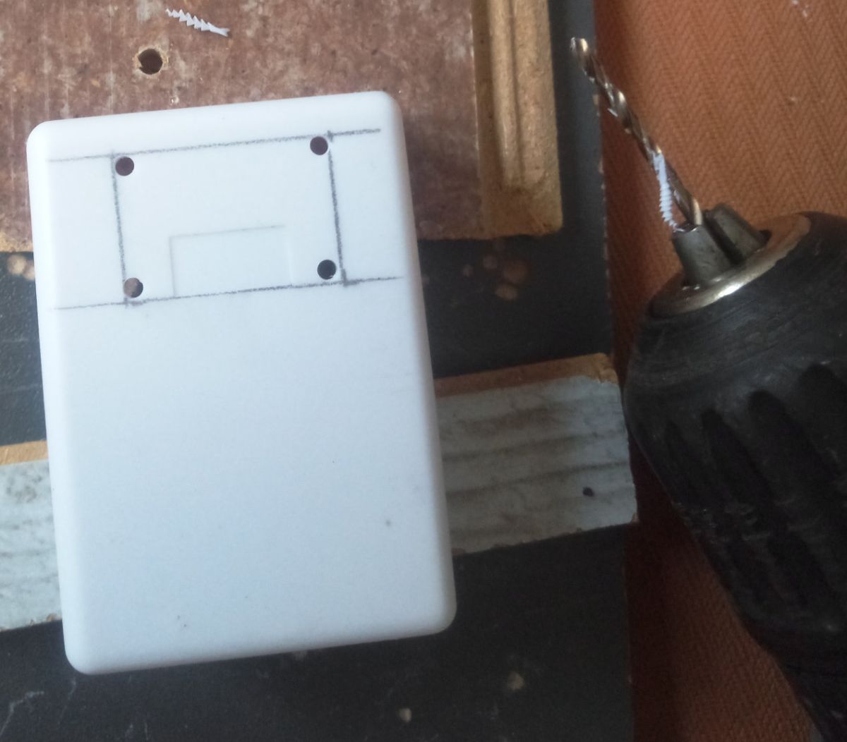

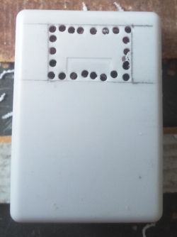

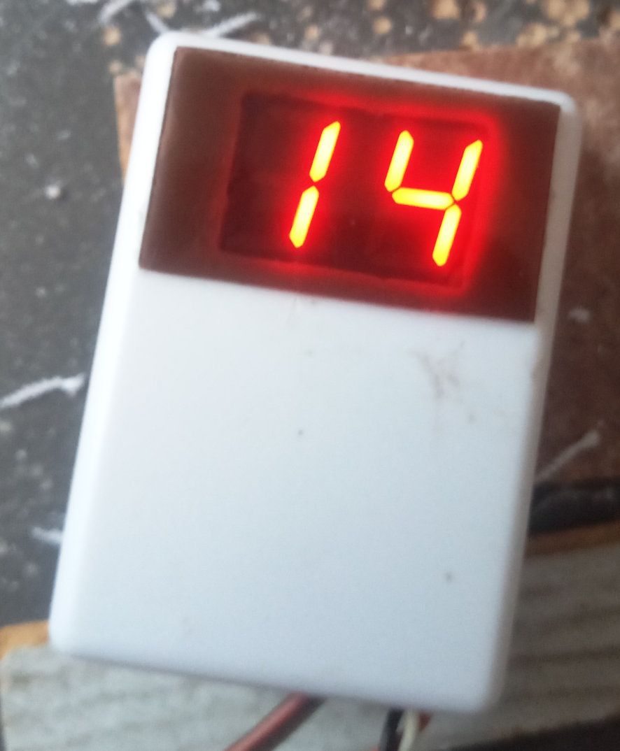

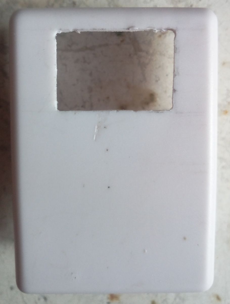

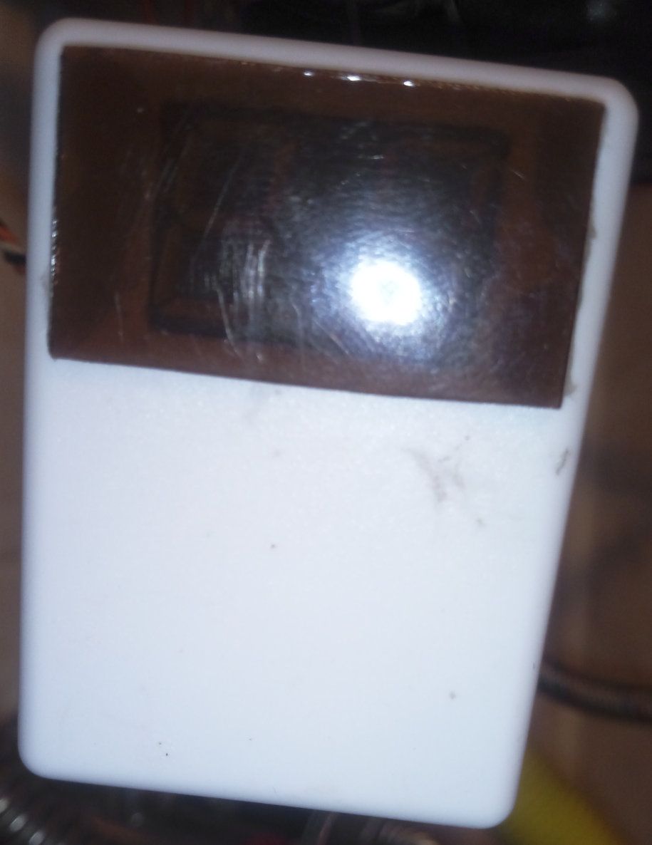

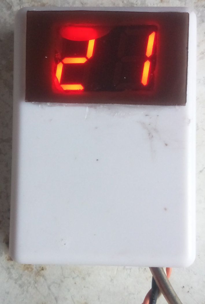

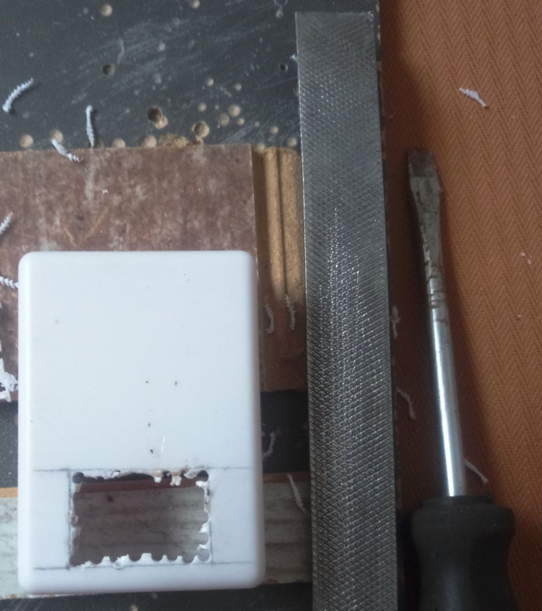

    I made myself a two-digit thermometer with a red ELD-515SURWA seven-segment display (soldered out of a Euroster 1100E thermostat) and a DS18B20 sensor.
    The electronics fit on a 2x8 cm cutout of a 6x17 mesh universal board.
    The housing is a white 2xRJ11 6P4C surface-mounted telephone socket.
    White plastic casing marked for drilling with holes and electric drill nearby White surface-mount box with hand-drilled holes for a seven-segment display White plastic case with a rectangular cutout, file and screwdriver nearby White enclosure with rectangular cutout for seven-segment display Thermometer with red LED display showing 21°C Thermometer with red LED display showing 21°C DIY thermometer with LED display showing 28°C in a white plastic casing. Thermometer with red LED display showing a temperature of 14 degrees Two-digit red LED display showing value 29 on a white casing White enclosure with dark translucent panel for an LED display. Homemade thermometer with red LED display showing 28°C
    Power supply from a 5 V / 120 mA switching power supply.

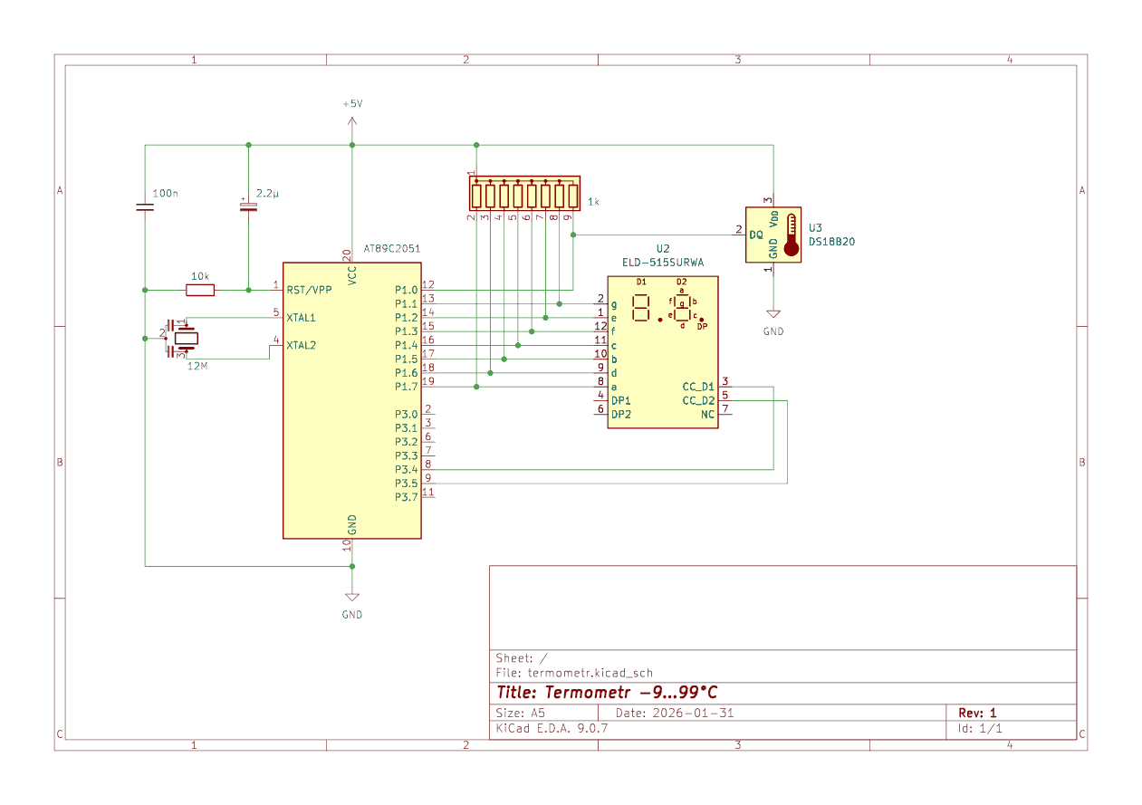

    Thermometer schematic with AT89C2051 microcontroller and ELD-5155URWA display
    Firmware
    The brain of the chip is the AT89C2051. The program in assembler takes 410 bytes. I attach the source and hex.

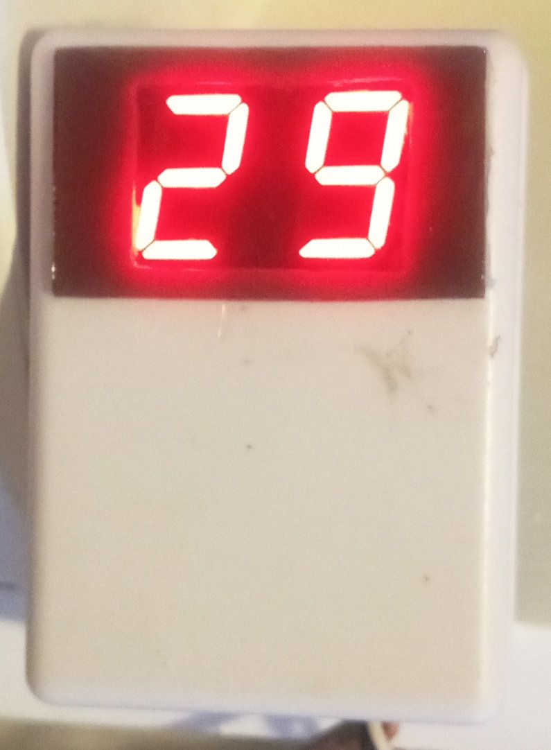

    The thermometer can show a temperature from -9 to +99 °C.
    I use the smallest resolution of the measurement i.e. 9 bits and show only the integer part of the result.
    By using three wires (i.e. supplying power via a separate wire rather than parasitically), you can ask the sensor if it has finished measuring. When this happens, the program reads scratchpad , checks the CRC and updates the value on the display.
    Multiplexing takes place in a timer interrupt at 1302 Hz. During the time-critical operations of receiving and sending a bit on the 1-wire bus, the interrupts are blocked (up to half a millisecond during 1-wire resets); I did not notice with the naked eye the effect of such multiplexing hang-up on the brightness of the display.

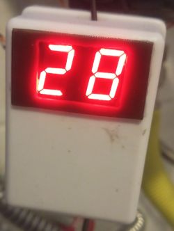

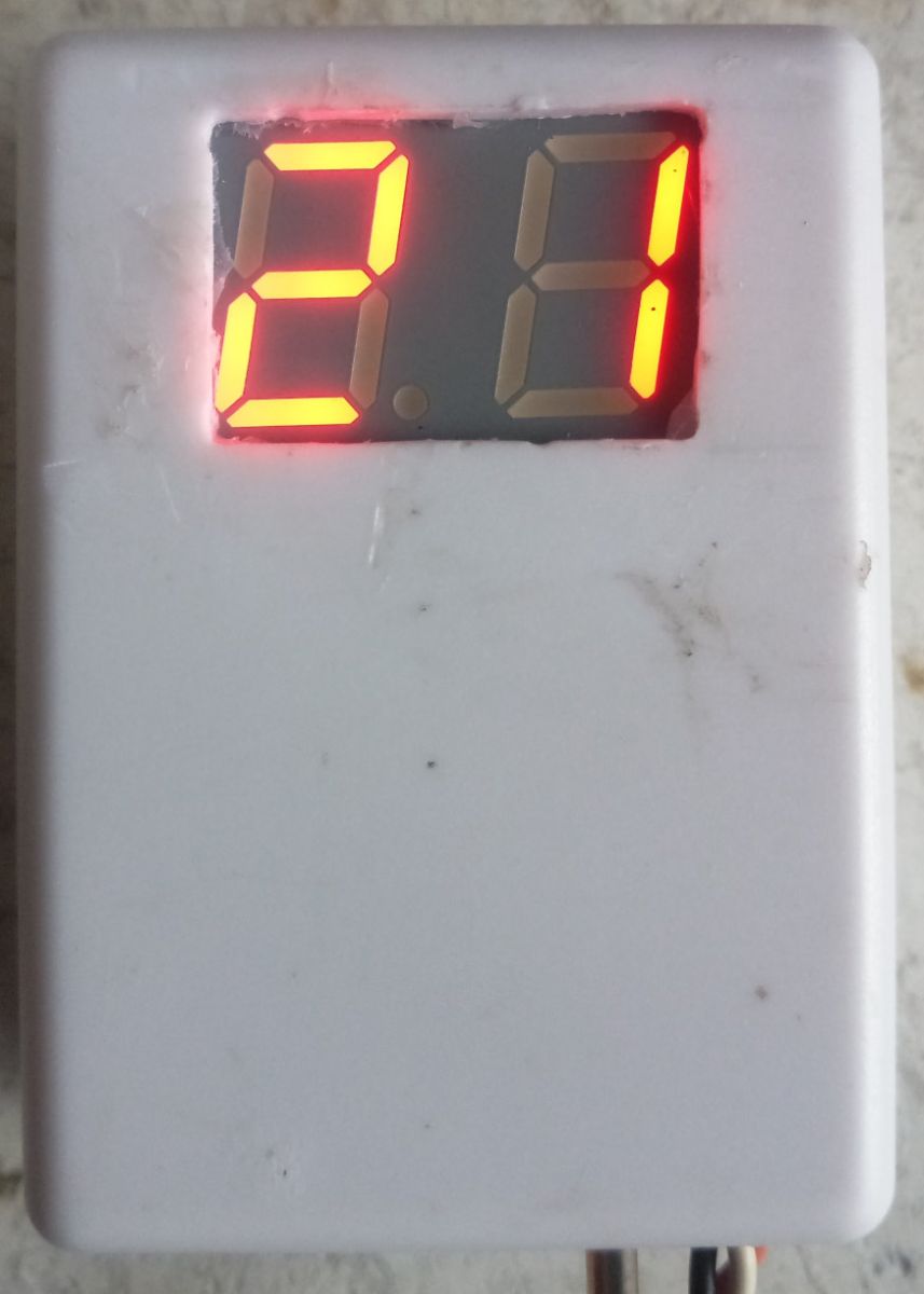

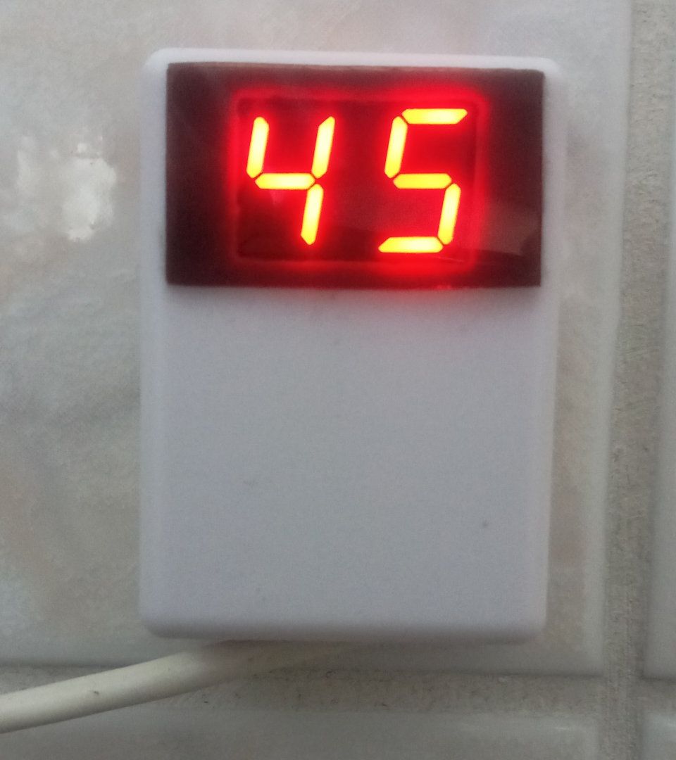

    The sensor here measures the temperature of the hot water at the outlet of the cooker. I cleaned a piece of tubing with sandpaper and on a drop of thermally conductive paste applied the sensor with the inscription side to the tubing, stuck it on with silver repair tape and then wrapped it with a couple of layers of sponge.
    It seems that despite these treatments the thermometer nevertheless underestimates the water temperature by about 2-3 degrees....

    Andrzej_Tomaszewski wrote:
    The procedure for handling 1Wire and communicating with the DS18B20 you wrote yourself?
    Yes, these are my battle-tested procedures, here used in the trivial case of a single sensor on a ~20cm wire. I converted their delays to a 12 MHz clock. So far the smallest pull-up I've had was 1.5k, here it happily runs at 1k, so the ladder from the display takes care of the 1-wire too.
    How do you limit the diode current in the display because I didn't notice any limiting resistors?
    The 1 kΩ resistor ladder limits the diode current in the display. This is a display with a common cathode. The current flows from plus through the 1k resistor to the anode of the segment, from the cathode it flows into either port P3.4 or P3.5 and through the CPU to ground. If I want to extinguish a segment connected to P1.X, I put a zero there and then the current flows immediately through the processor to GND instead of to the LED. That is, the current consumption is slightly higher when the segments are not lit than when they are lit. I took this clever way of simplifying the circuit from the kit https://www.elektroda.pl/rtvforum/topic3494198.html
  • Higher current when segments are off

    Well yes, if the WK display is ok but the control method is a bit unusual, not very energy efficient. Regards
    Sam Sung wrote:
    That is, the current consumption is slightly higher when the segments are not lit than when they are lit. I took this clever way of simplifying the circuit from the putty https://www.elektroda.pl/rtvforum/topic3494198.html
    And haven't you thought about a resistor ladder with individual leads or just individual resistors?

  • AT89C2051 likely lacks drive for 8 segments
    #7 21826625
    saly
    Level 32  
    Posts: 3270
    Help: 89
    Rate: 1003
    Years ago I used assembler, then fell in love with C++, I remember from assembler that it was like ploughing acres of field with a hand plough.
    Respect and admiration, especially for your original solution and perseverance.
    If it wasn't for that trick with the display control, you wouldn't be without a few transistors or some ULN28.... for classic control.

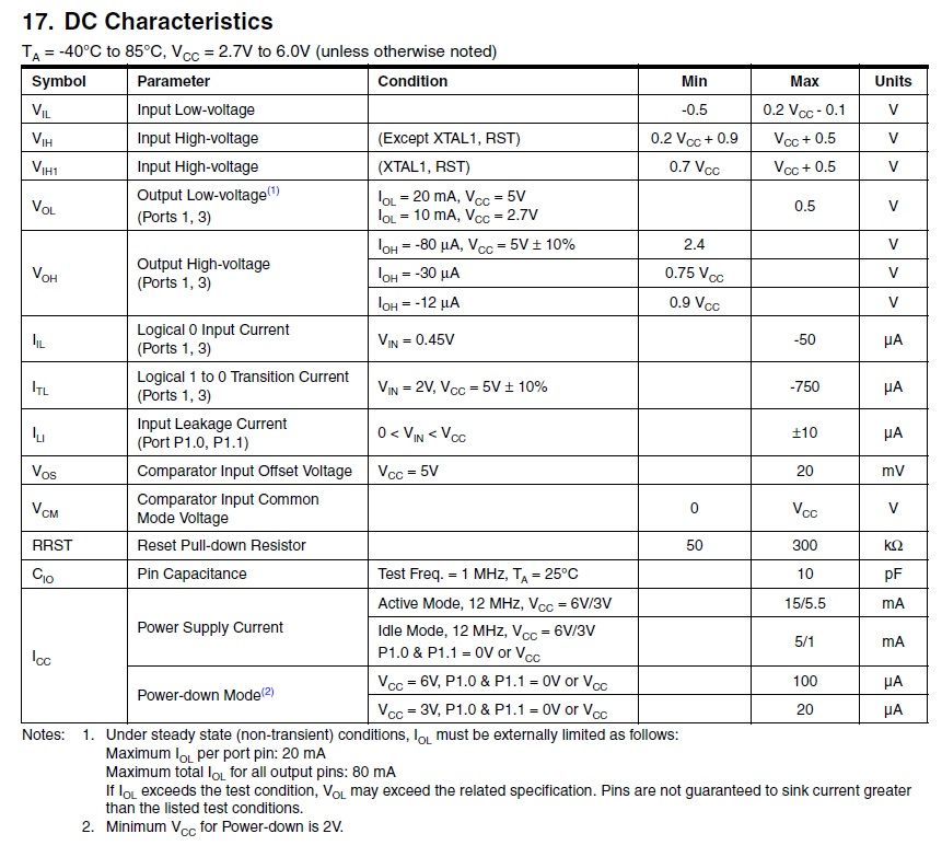

    The AT89C2051 itself has probably not a lot of capacity, surely it can't light up 8 segments and power it from the proc ports.

    The following shows that the output in the low state can accept 20mA while in the high state the current flowing out is negligible. I wonder what was dictated by the choice of this and not another uC.

  • AT89C2051 chosen for strong port drive and no crystal
    #10 21827191
    Sam Sung
    Posts: 2018
    Help: 227
    Rate: 598
    Wondering what was dictated by the choice of this and not another uC.
    The choice of board and prock was mainly dictated by the fact that I had one, but I also wanted to see if I could do such a small chip with such an old proc. The port load is high, the ports have a strong zero, so newer procs have no advantage here. Well, unless the 1-wire could work stably without a quartz - then the AT89C2051 would lose out with the lack of an internal RC oscillator.

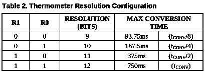

    Such a curiosity: in the DS18B20 note there is a table with temp measurement times at different resolutions:
    DS18B20 temperature conversion timing table for different resolutions
    And a long time ago the sensors worked like this. Instead, the ones I bought recently on AliExpress seem to measure just as fast, no matter how many bits of resolution you set. They don't even try to pretend to be original? Well, but in parasitic power mode you can't tell.

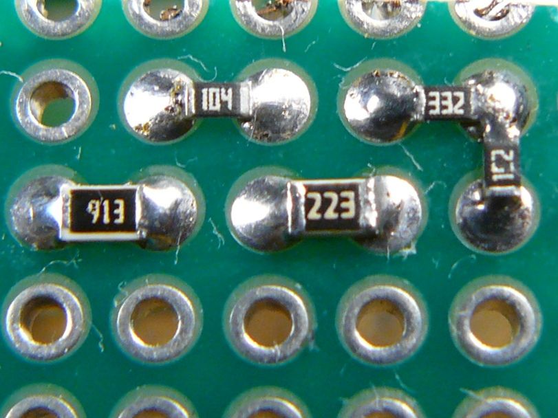

    #20 21834446
    rb401
    Posts: 3002
    Help: 750
    Rate: 984
    or just about single resistors?
    That kind of circuit wouldn't fit on such a small board.
    Your board would fit another twenty resistors without any problem.
    Using SMD resistors instead of chip resistors. SMD resistors of size 0805 and 0603 fit best on such universal boards. The use of SMD allows, among other things, the use of areas covered on the other side, e.g. the base or the display. If the boards have metallized holes, wire connections can be made both on the component side and on the other side. And just using these resistors in such a context, in my opinion, is quite a lot more convenient than the through-hole ones.
    Here, for example, is a typical universal board with a 2.54mm grid and some resistors of both the 0805 and 0603 dimensions, where you can see how much space is left on the eyelet for the wire:
    Close-up of a prototyping board with through-holes and several soldered SMD resistors
