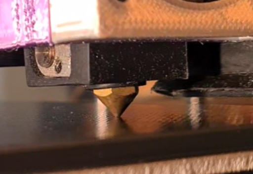

    Apart from the disadvantages, piezo samplers have one big advantage.
    We are always almost 100 per cent sure of the distance between the nozzle tip and the table, and this translates directly into the quality of the first layer.
    The accuracy and repeatability of the measurement is an order of magnitude better than with other types of samplers, whether mechanical or inductive/capacitive.

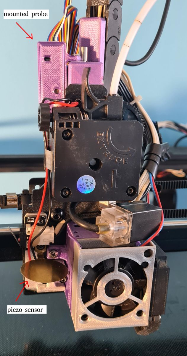

    I am using a very average CoreXY type printer under Klipper and Octoprint.
    Despite the 'lousiness' of the equipment, thanks to the piezo sampler, I get surprisingly good measurements of the table geometry and, consequently, better first layers of my "works".

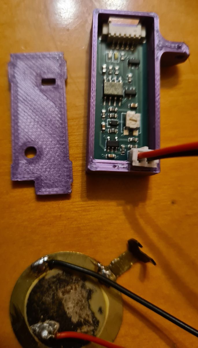

    As I mentioned, the available piezo samplers require quite a bit of dexterity for installation, which is in contrast to my solution,
    which only requires the tightening of a single screw securing the piezo sensor.
    There are no other requirements for mechanical installation, so anyone who can handle a screwdriver can undertake such an installation.
    The issue of configuration under Klipper is also trivial and comes down to making a few entries in the printer.cfg file.
    The sampler has a single potentiometer for adjusting the sensitivity depending on the 'noisiness' of our printer.

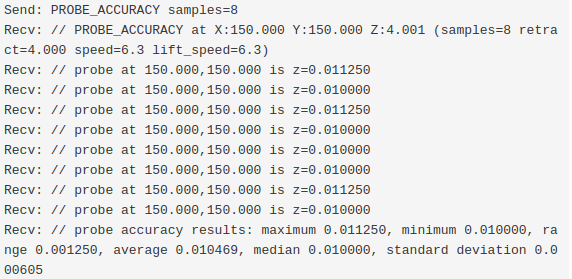

    3. Repeatability test.
    Repeatability test
    4. What you see on the terminal during the test.
    5. G29.
    6. What can be seen at the terminal during G29.

    Let's look at the typical measurement results made with my sensor:
    Screenshot of PROBE_ACCURACY log with multiple Z readings and a probe accuracy summary.
    You can see here exactly how microstepping affects the results of individual measurements.
    My printer has 8mm pitch trapezoidal screws and is set to 32 microsteps, which you can immediately see from the photo above that the measurement results vary by an exact multiple of the microstep size i.e. N x 1.25 micrometres.
    The conclusion to be drawn from this is that:
    1. The accuracy of the sensor is better than the precision of the printer itself,
    2. Measurement inaccuracies tell us how imperfect a printer we have.

    If interested, please visit the repository for this sampler at Github : Link
    Open purple enclosure with a PCB and wires on a wooden surface
    Close-up of a 3D printer toolhead with mounted probe and piezo sensor, labeled with arrows
    Side macro close-up of a 3D printer nozzle near the build plate
