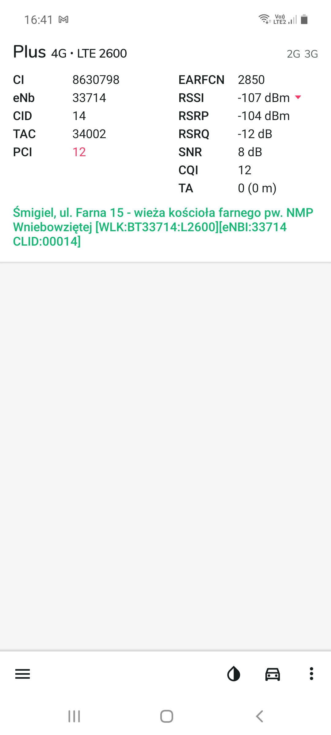

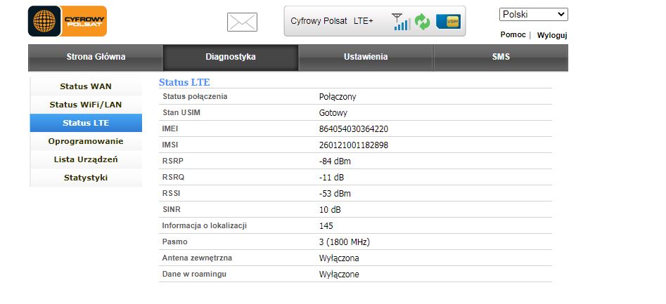

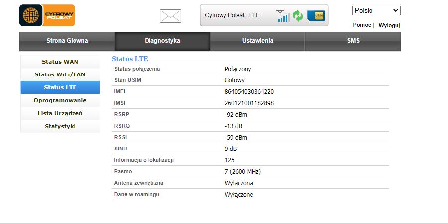

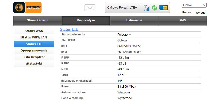

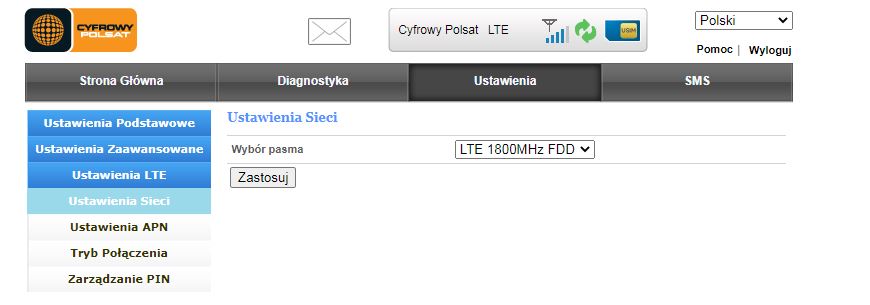

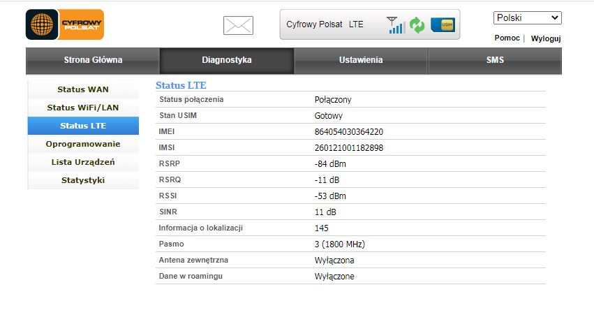

    Below is the data I somehow managed. Maybe they can help solve the problem
    • ODU-IDU 300 Error: No Internet on ASUS PR-N12 Repeater - Troubleshooting Tips Needed Screenshot_20201114-164815_WiFi Analyzer.jpg (653.03 KB) You must be logged in to download this attachment.
    • ODU-IDU 300 Error: No Internet on ASUS PR-N12 Repeater - Troubleshooting Tips Needed Status wifi Lan.JPG (63.89 KB) You must be logged in to download this attachment.
    • ODU-IDU 300 Error: No Internet on ASUS PR-N12 Repeater - Troubleshooting Tips Needed Status LTE antena wyłaczona.JPG (55.58 KB) You must be logged in to download this attachment.
    • ODU-IDU 300 Error: No Internet on ASUS PR-N12 Repeater - Troubleshooting Tips Needed Status LTE -antena włączona.JPG (54.89 KB) You must be logged in to download this attachment.
    • ODU-IDU 300 Error: No Internet on ASUS PR-N12 Repeater - Troubleshooting Tips Needed Status LTE 2600.JPG (53.28 KB) You must be logged in to download this attachment.
    • ODU-IDU 300 Error: No Internet on ASUS PR-N12 Repeater - Troubleshooting Tips Needed Screenshot_20201114-164145_NetMonster.jpg (218.58 KB) You must be logged in to download this attachment.
    • ODU-IDU 300 Error: No Internet on ASUS PR-N12 Repeater - Troubleshooting Tips Needed Status LTE 1800.JPG (54.95 KB) You must be logged in to download this attachment.
    • ODU-IDU 300 Error: No Internet on ASUS PR-N12 Repeater - Troubleshooting Tips Needed LTE 1800.JPG (39.16 KB) You must be logged in to download this attachment.

    The LTE status with the antenna on and off is on the machine

    I did two speed tests and they varied: PING 29ms, Download 62.66 - 61.30 Mb/sec, Upload 15.38 - 14.46 Mb/sec

    LTE signal parameters are ok. Speed test is also a plus and such a router. You can also try to switch the band to another (depending on what is on the transmitter) than 1800MHz and do the test. However, it will not be much better, 60Mbps is a decent result.
    Now you need to clean up your internal network. Place the AP, connect it with a makeshift cable to the router and measure the signal level in the rooms. Choose the best location for the primary router and secondary AP.
