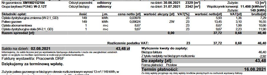

    In December 2020, I installed a gas boiler with a DHW tank.
    I was bothered by the fees because in May (because I have a contract until April) they will transfer me to W3.
    I called PGNiG to find out how much it would cost me - heating, hot water and cooking in each of the tariffs.
    I made such a table
    Understanding PGNiG W-2.12T to W3.12T Tariff Change and its Impact on Gas Bills
    It turns out that the W3.6 is the cheapest.
    And the difference between each of them is insignificant.
    I choose W3.6 because it is the cheapest.
    I don't know how you counted it.
    But with a comprehensive contract in the Tarnów region, you have net rates:
    W-2.12T
    - gas fuel PLN 0.08543 / kWh
    - distribution variable PLN 0.03552 / kWh
    which gives a total of PLN 0.12095 / kWh
    - subscription PLN 8.67 / month
    - distribution constant PLN 8.21 / month
    which gives a total of PLN 16.88 / month
    Counting 200 m3 and the conversion factor 10.972 it gives 2194 kWh
    2194 * 0.12095 = PLN 265.36 + PLN 16.88 = PLN 282.24

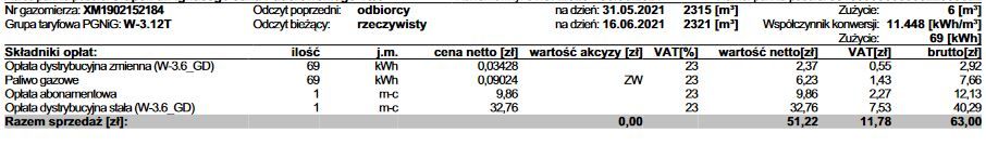

    W-3.12T in the Tarnów region is:
    - distribution variable PLN 0.02663 / kWh
    which gives a total of 0.11206 PLN / kWh
    - subscription PLN 9.86 / month
    - distribution constant PLN 31.70 / month
    which gives a total of PLN 41.56 / month
    For 2194 kWh it comes out:
    2194 * 0.11206 = PLN 245.86 + PLN 41.56 = PLN 287.42
    As for me, it is PLN 5 net per month cheaper in the W-2.12T instead of the W-3.12T.

    The W-3.12T will be:
    12 * 41.56 = PLN 498.72 for billed monthly fees
    13177 * 0.11206 = PLN 1476.62 for the energy consumed.
    TOTAL PLN 1,975.34 net per year
    In other words, in W-3 you will overpay PLN 179 net per year.
    I did not count W-3.6, because I prefer to pay monthly for the actual consumption, and not for forecasts divided arithmetically on average per month.
    But anyway, the W-3 is not cheaper than the W-2, not with so little consumption.

    Exactly as you write, counters are written down the streets at the end of the contractual period. The entire street has the same contract year dates.
    I got into the w2 tariff and it is as you predicted. Bills a little lower.
    I even met a woman by accident who wrote down the counters on the cage. Actual read date doesn’t match (a couple of days), but that’s not my problem. Unless these readings stretch later, because she wrote 2 meters more for me.
    Thank you for the discussion, I close the topic.
