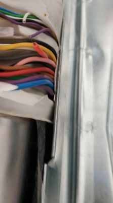

    Today I started repairing. I described the symptoms earlier.
    On YT (it is a pity that it is not on the electrode) there is a video about a similar fault - broken cables were to blame in the place marked in the photo. I attach a photo of the display with the error code (the display has some damaged segments - another Beko pain, but I did not replace it)
    • Dishwasher Beko DIN28221 - error E02, it fills with water and does not start displerr.jpg (44.3 KB) You must be logged in to download this attachment.
    • Dishwasher Beko DIN28221 - error E02, it fills with water and does not start przod.jpg (145.63 KB) You must be logged in to download this attachment.
  • Broken harness repaired to clear E02 error

    The diagnosis was correct with three broken cables. I connected by soldering short sections of the cable. Connection cover made of heat-shrinkable sleeves, I adjusted the slightly worn cable cover and the dishwasher works :)
    Dishwasher Beko DIN28221 - error E02, it fills with water and does not start Dishwasher Beko DIN28221 - error E02, it fills with water and does not start Dishwasher Beko DIN28221 - error E02, it fills with water and does not start
    Conclusions:
    Error E02 is not always a damaged hose or other element of the water supply system (especially since the dishwasher was taking water). Before we pull the dishwasher out of the building, which can be troublesome (even with a different error code), it is worth checking the harness first.

    The awl came out of the bag. 6 broken wires. But already fixed. Thanks for the help
