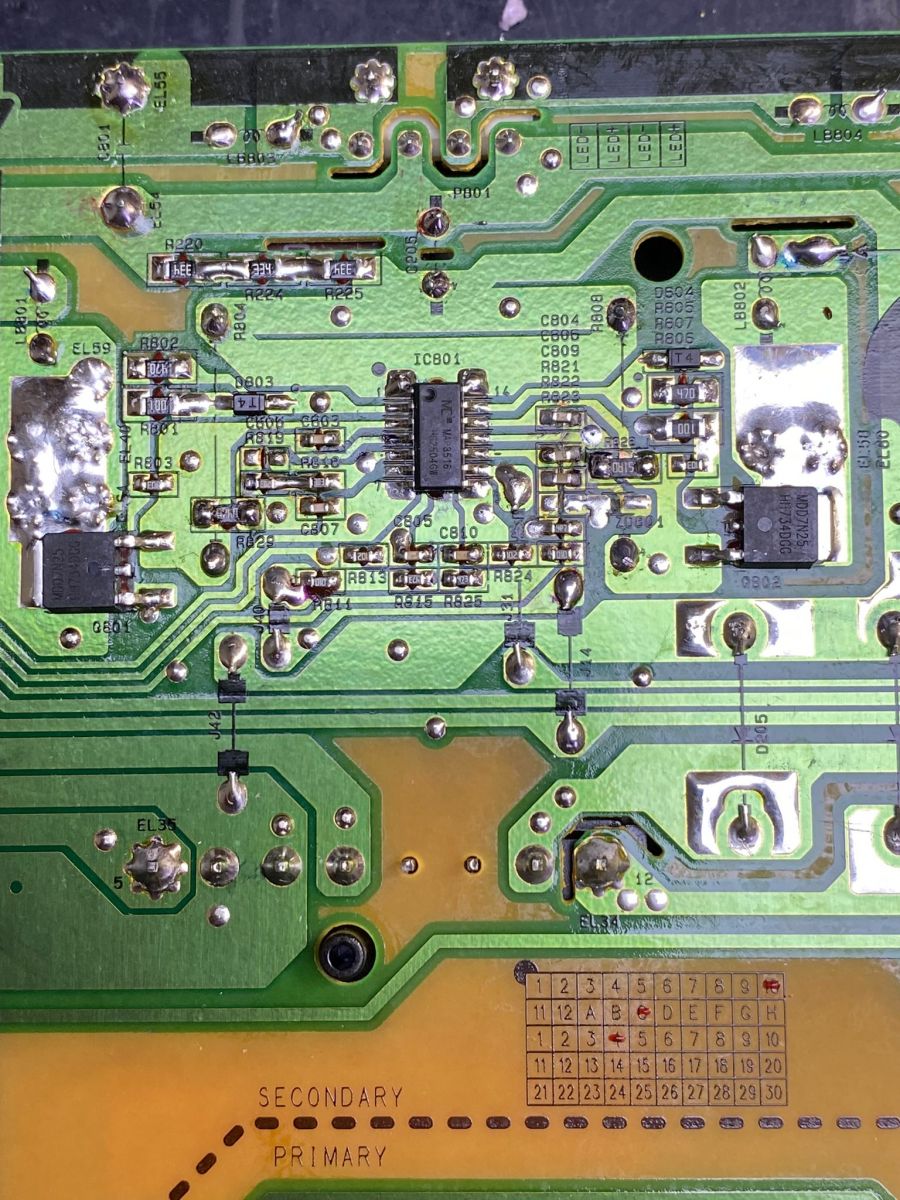

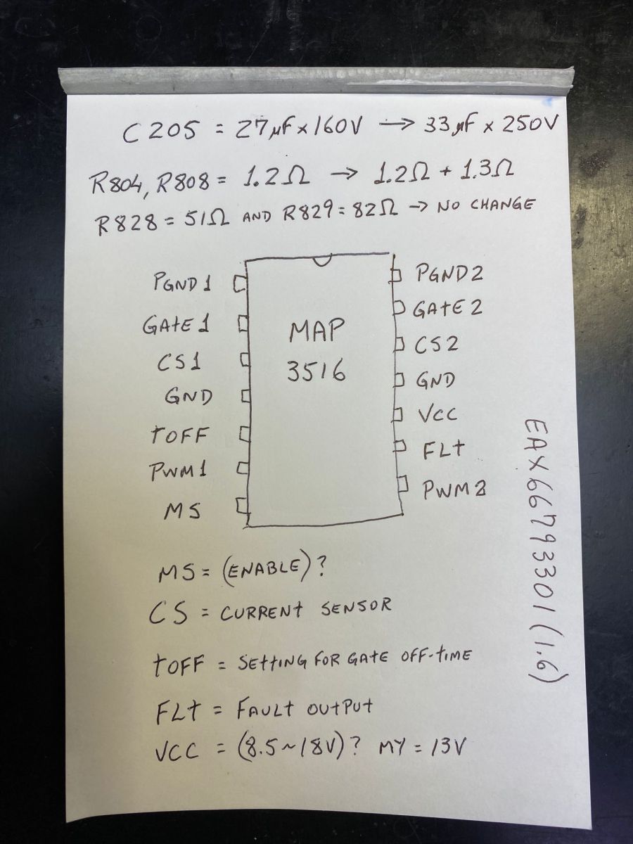

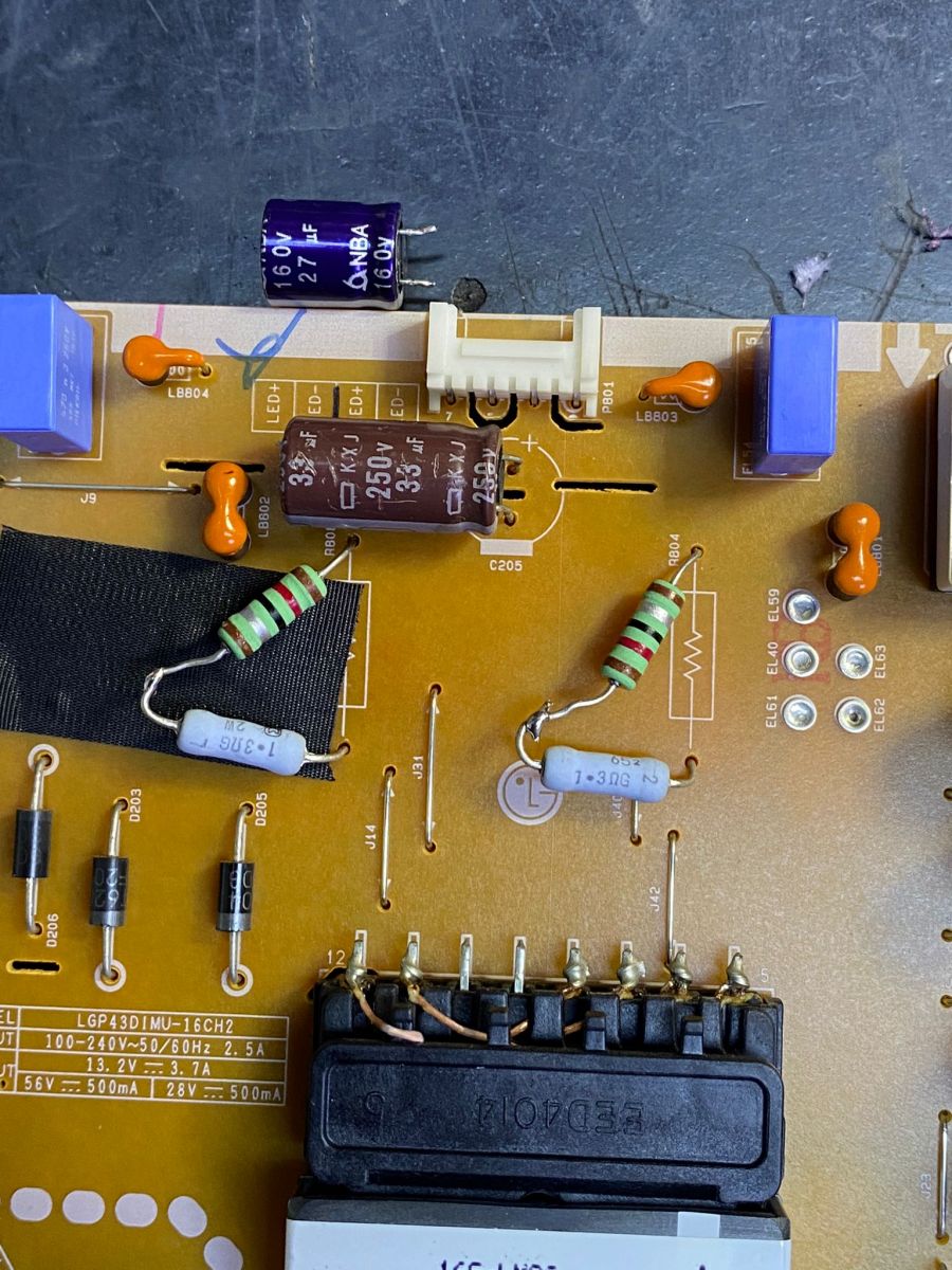

    gusgao
    Hello! I replaced the LED bars and they kept blinking and turning off. Replace the capacitor C205 from 27uF to 33uF with the same voltage or higher. (In my case I replaced 27uF x 160V with 33uF x 250V, a little bigger but it fit without any major problems). My resistors R804 and R808 are 1.2 ohms, I increased them both to 2.5 ohms x 2W. Resistors R828 and R829 are parallel to R804 and R808, I saw no need to change them. Now everything works perfectly. I hope this helps anyone who is interested. EAX66793301(1.6).
