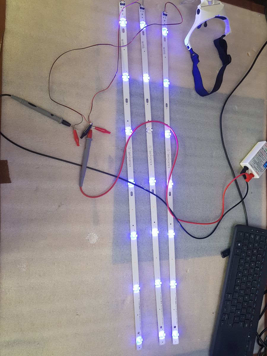

    Colleagues, I have an LG 43UJ6517 at the workshop, a relatively new 2018 model, in which the image is far from perfect, it looks as if someone applied a blue filter, I checked the settings, it is impossible to set it, there is always a shade with a predominance of blue.
    It is more visible on the left side, the right side is still quite.
    But looking at the backlight from the side of the chassis where the modules are, you can see that the diodes glow in a blue shade, the left side is more in this shade.
    Probably LED strips to be replaced? I'm guessing right?
    Should they shine more in white?
    The backlight was set to 100%.

  • #2 19068066
    kazikszach
    Posts: 3990
    Help: 511
    Rate: 1092
    You have slats to replace, these new LG TVs probably have it, I had several cases.

    Remove the matrix and see how the slats shine. 90% of them are replaceable.

    Thank you for the quick response, tomorrow I will dismantle the matrix and turn it on.
    I guessed so.

    Thank you for your help, replacing the LED strips helped, I'm just wondering if I should change the current control resistors in the power supply.

    I answer the strip, I installed the original M920672 AGF79078002, the power supply is LGP43D-17U2, outputs 44V 660mA and 22V 660mA - pwm driver MAP3516

    I also measured and I do not know if the meter does not work with pwm, but I got these measurements:
    Connector P801 pins 1.3 adjustment range 0-100% voltage 17-21V current 0.138-0.078A
    I do not know why, but in the middle of the adjustment range, the current increased to 0.320A and then decreased?
    Connector P801 pins 5.7 adjustment range 0-100% voltage 34-43V current 0.138-0.079A
    And here also the same reaction with the current as in the previous measurements.
    You do not need to cut the wires, just unplug the connector from the connector housing.
    I took the measurements with a Fluke 87V measuring device
    There are two 1ohm resistors on each side of the transistor sources.

    I know I have a few on the site, but I just measured with this device and in fact the backlight switches to 100% depending on the signal source, you always have to go in and check what is happening with this parameter.
    I keep wondering if there was a factory defect in these factory strips or because of this setting they went 100% blue???
    I wonder how long the ones I installed will last.

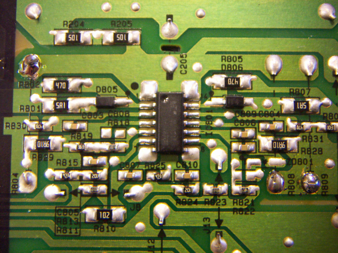

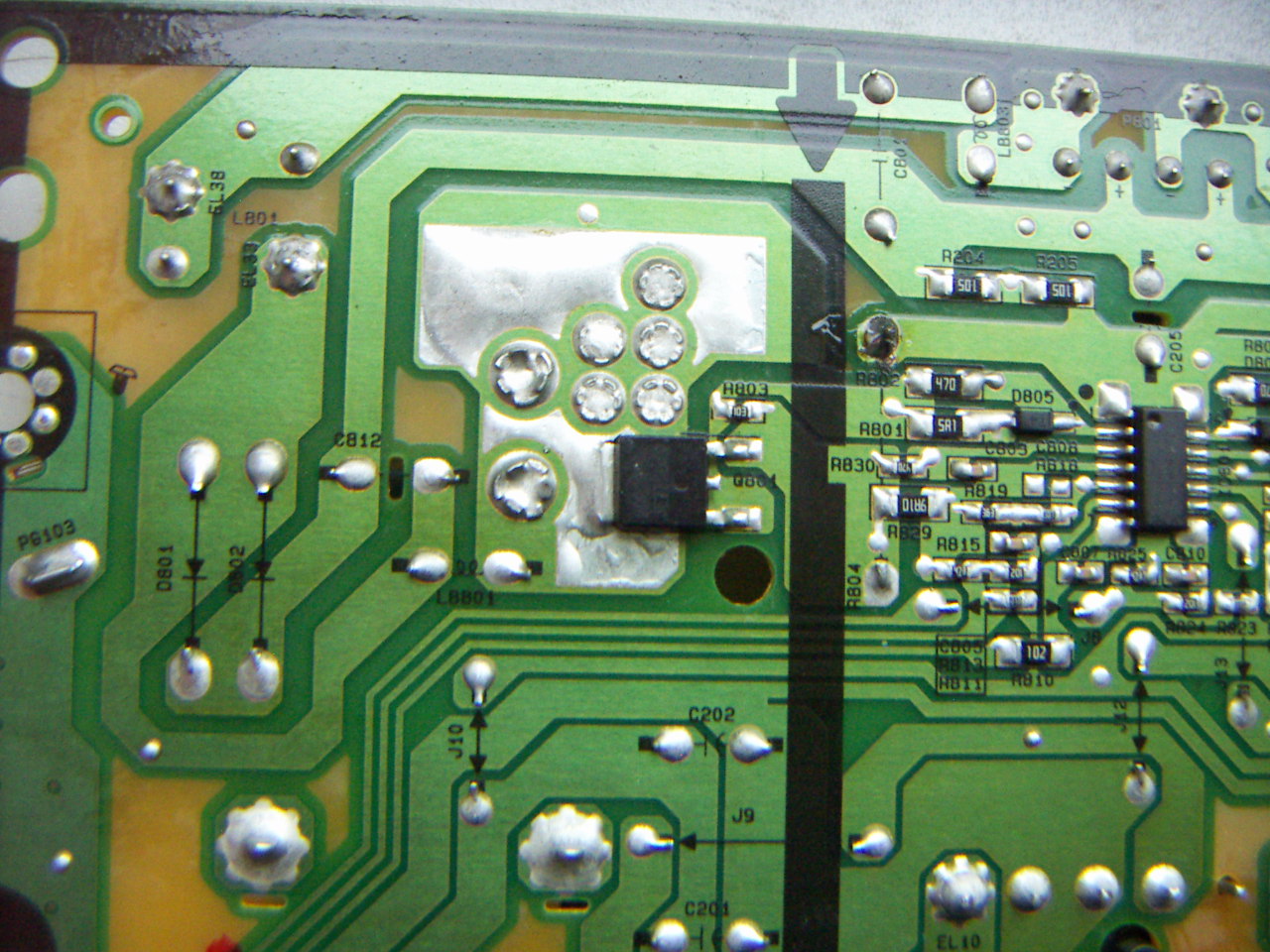

    If you correct the current, it will take longer :D . Post pictures of the leddriver on both sides.
    If you correct the current, it will take longer. Post photos of the leddriver on both sides.

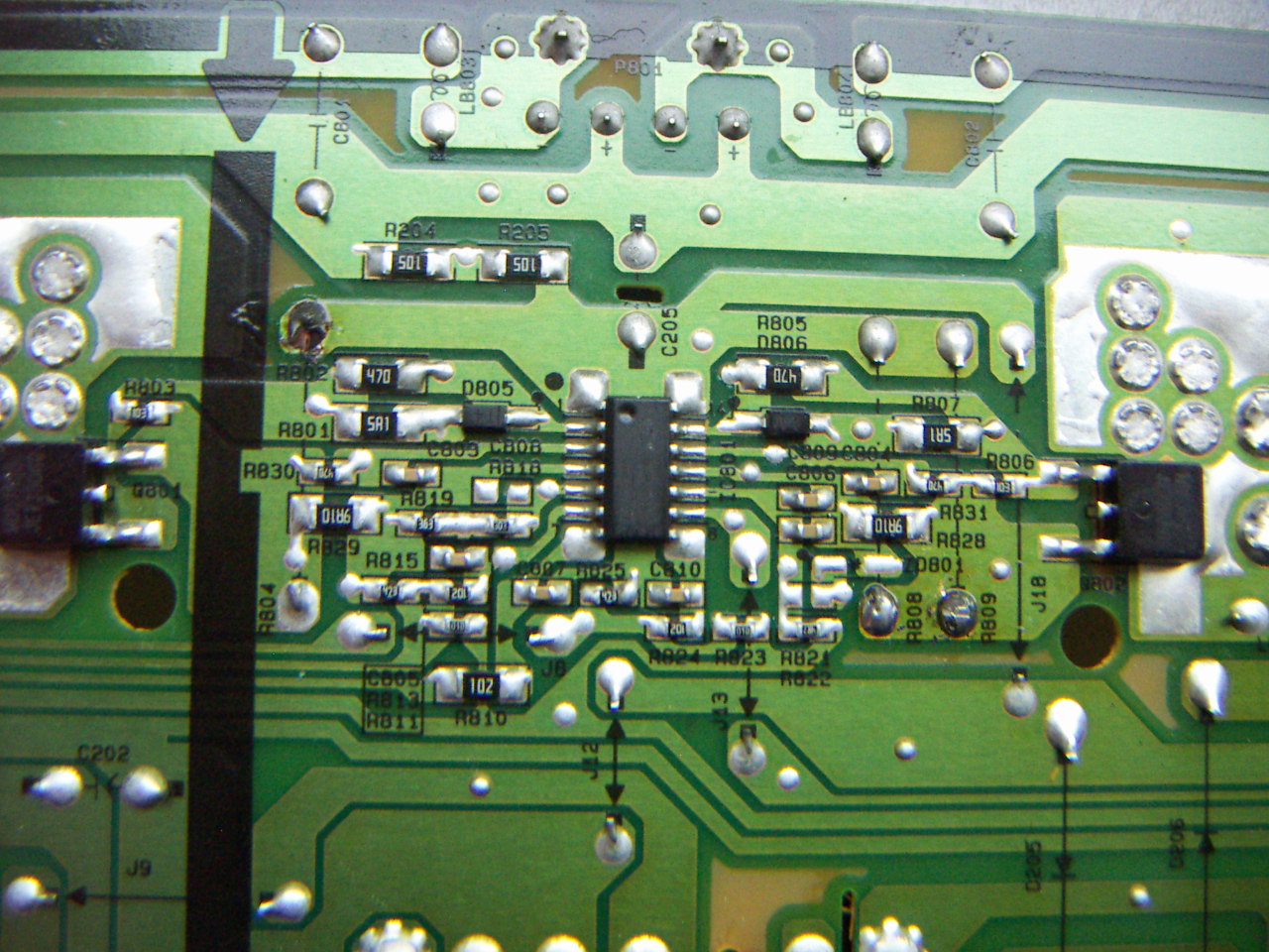

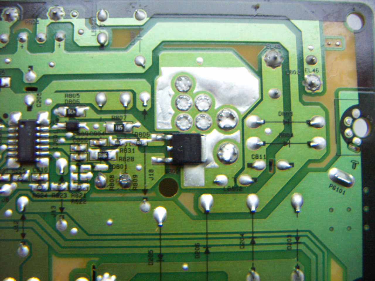

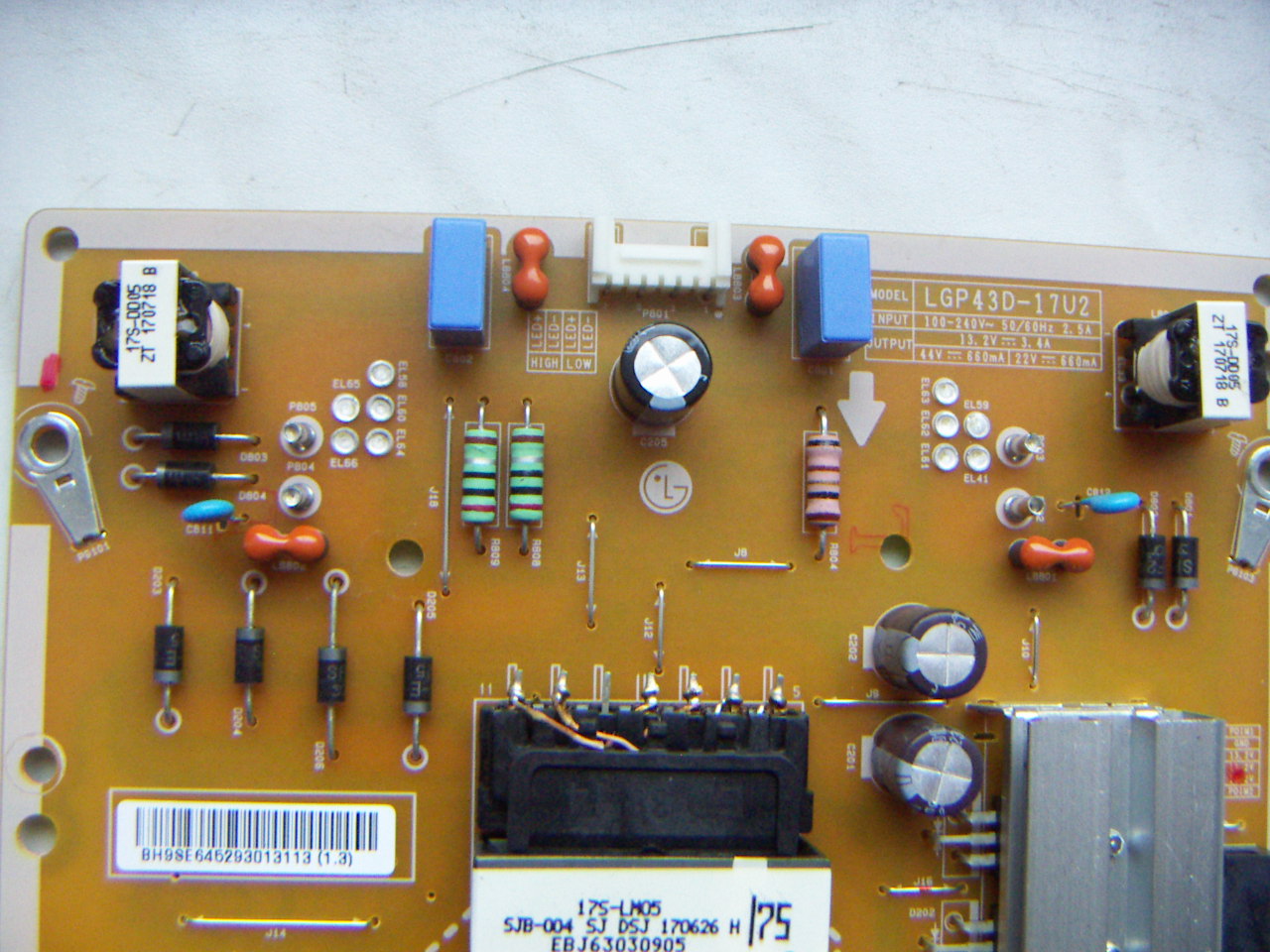

    As suggested by my colleague badael, I am posting photos of the led driver.
    Is it enough to change the value of resistors R804 -1ohm and R808-2ohm, R809-2ohm (connected in parallel 1ohm)? MAP3516 driver. There are three LED strips. and on the P801 connector, the pluses for the leds are shorted and the minuses are connected to the drains of the MDD7N25 transistors. There is a description on the power supply board HIGH LED+LED- and LOW LED+LED- what does it mean?

  • #28 19197619
    badael
    Posts: 548
    Help: 135
    Rate: 203
    Yes.
    Yes.

Quick 3-step: How do I test strips before ordering parts?
  1. Remove panel and diffuser sheets.
  2. Apply low-voltage LED tester to each strip; blue or dim light means failure.
  3. Note part code printed on bar for exact replacement [Elektroda, Dorian Olech, post #19068068]
Which components control LED current on LGP43D-17U2?
Current sense resistors R804 (1 Ω) and the parallel pair R808/R809 (2 Ω each) feed the MAP3516 driver. Increasing total resistance lowers current [Elektroda, badael, post #19197619]
Edge case: New strips flicker or shut off—what then?
Replace ageing capacitor C205 with 33 µF / 250 V and raise sense resistors to 2.5 Ω; this stopped blinking on one unit [Elektroda, gusgao, post #21312075]
