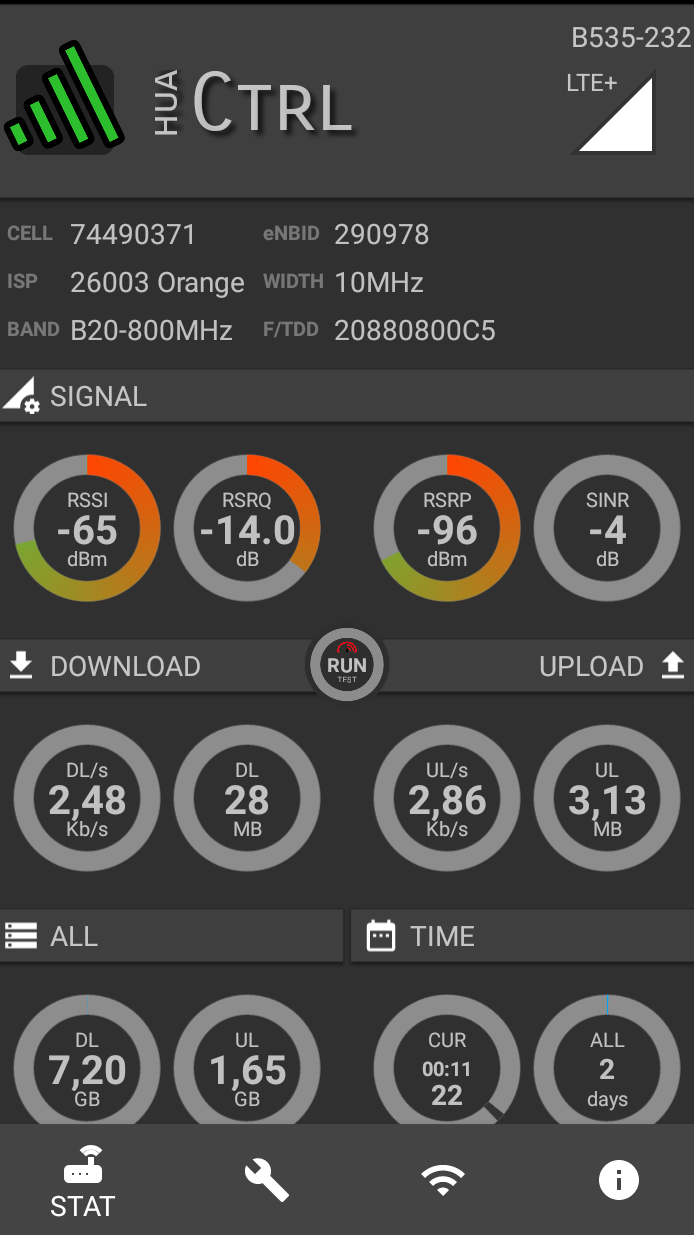

    Enter the city, I live in ŁÓDŹ but on the border with Dobra so we are further neighbors, show the screen from HuaCTRL but with CID and eNB, you connect in the aggregation of 2 LTE800 bands as the baseband, sufficient signal and aggregated second LTE band to it. What were you guided by when choosing Orange

    My town is Józefów / Janów near Skotnik. I am attaching the screen. We tested all networks and Orange is the only one in the area that somehow works at all. We live in a place with a hole in the LTE range.

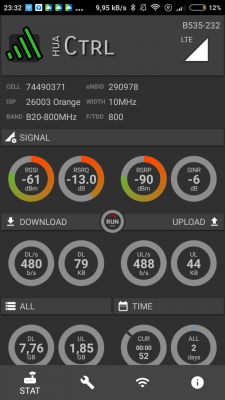

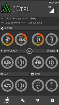

    Weak signal from BTS NetWorks on LTE800 in Skotniki, it is a nedza with a bare LTE800 to which LTE2600 added, only force LTE2600 and show a screen from this band and speedtest, the same on LTE800 itself, put the router out the window. Well, what did your operator tests look like?

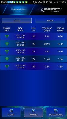

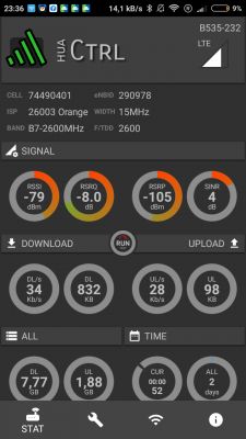

    This is what the screenshots look like:
    800:
    Where to download Hmanager? What's the other Huawei router management app? Where to download Hmanager? What's the other Huawei router management app?

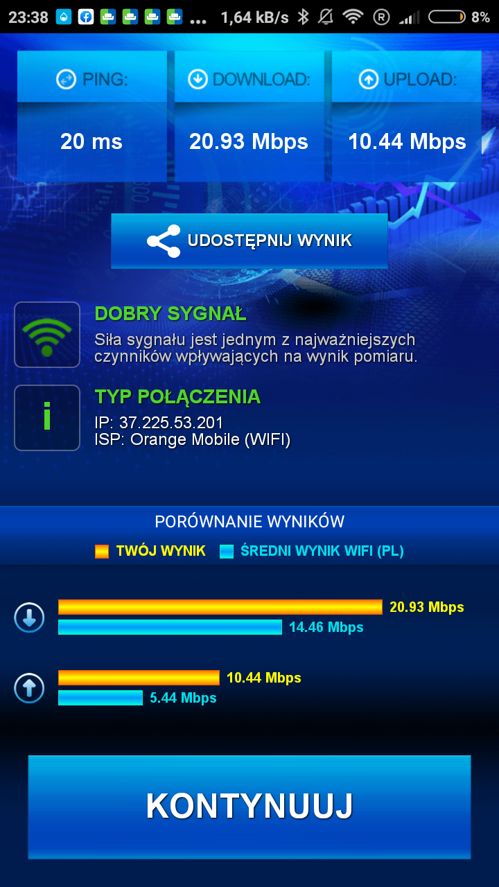

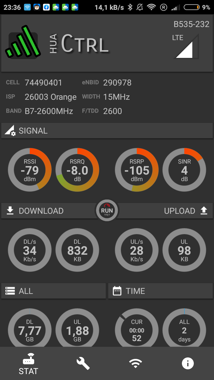

    2600

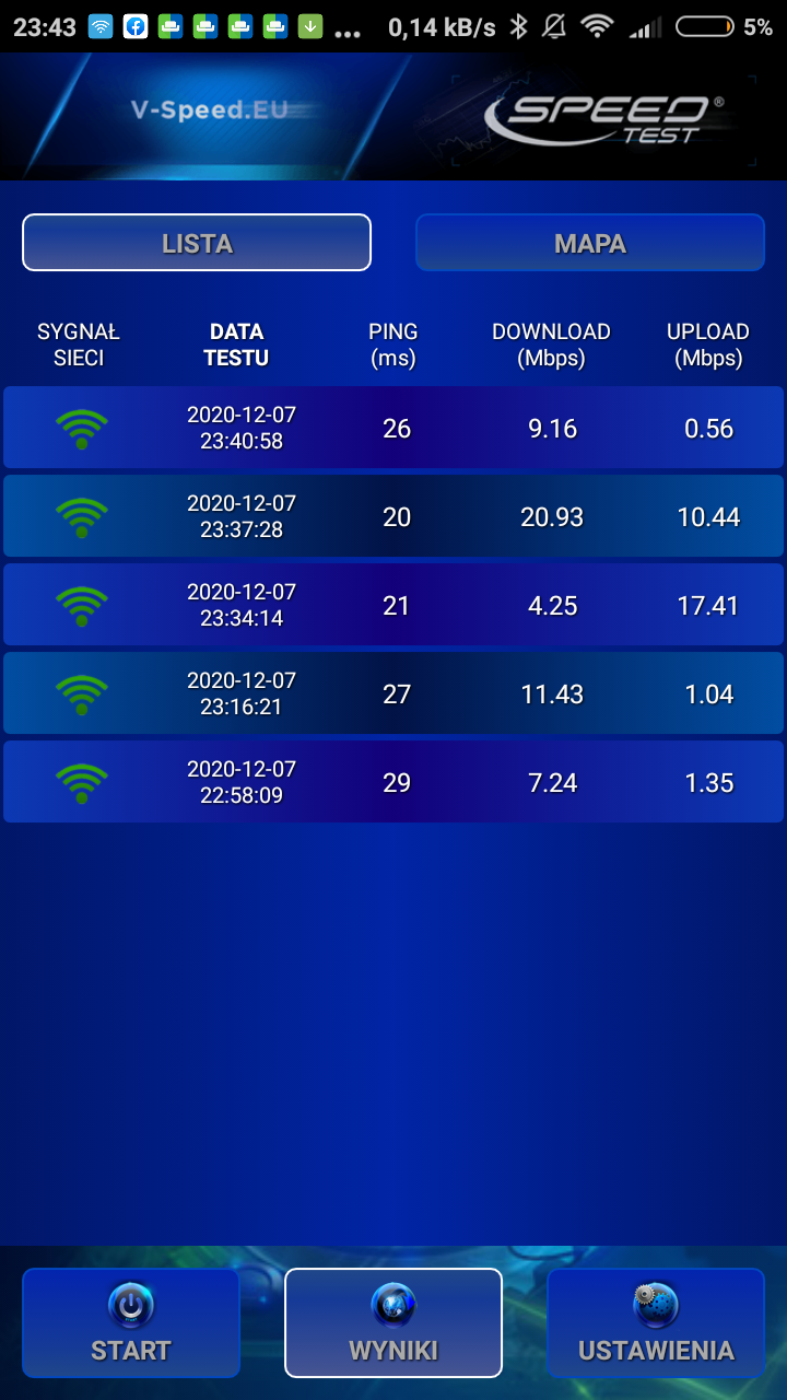

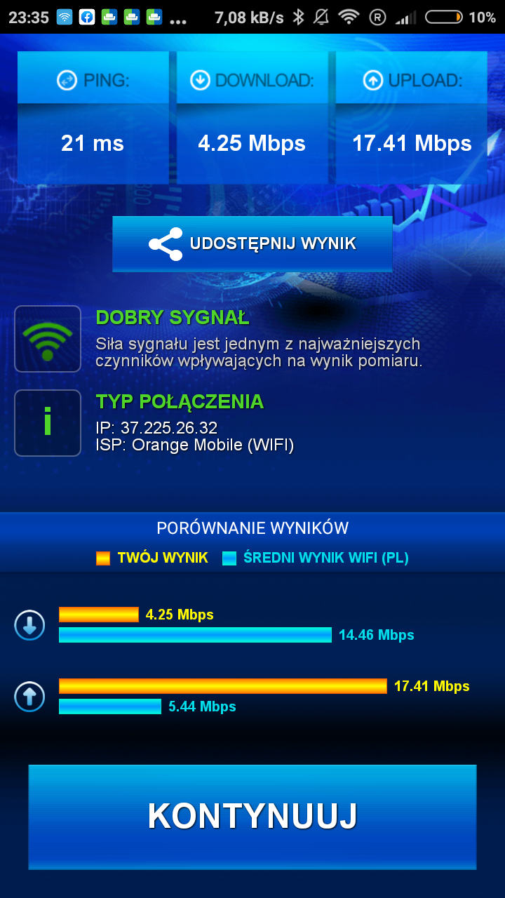

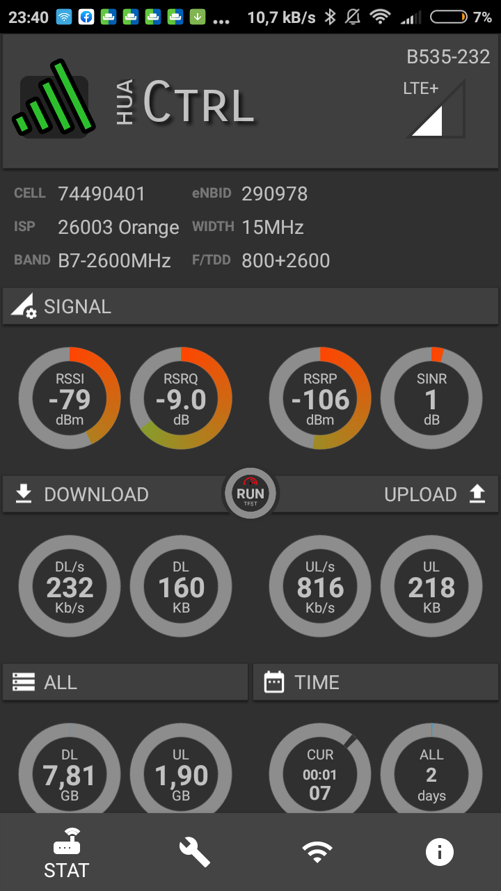

    and I did 2600 + 800 - test from 23:40
    With the router at home, the 2600 does not catch at all.

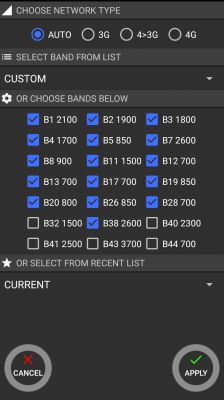

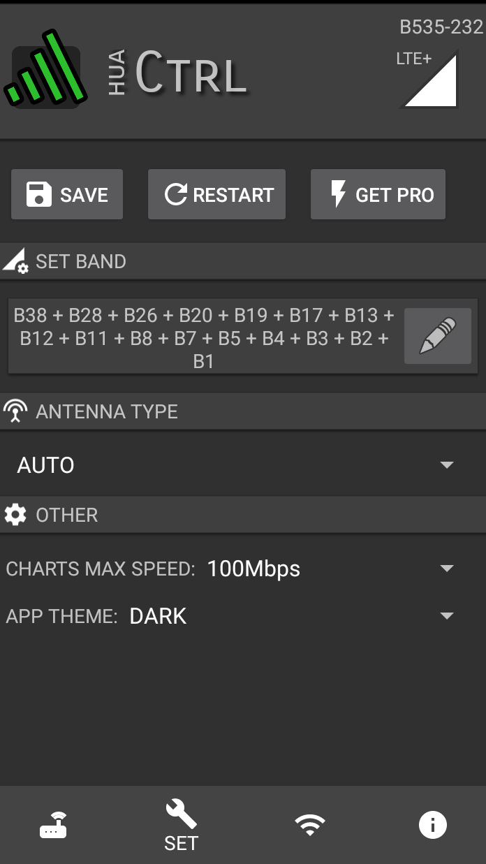

    The antenna is weak, it has a small gain at 2600MHz, the base is LTE2600 because it provides normal speeds, so the antenna must work on this band. Aggregation LTE2600 + 800 or LTE2600 only, not for auto.
