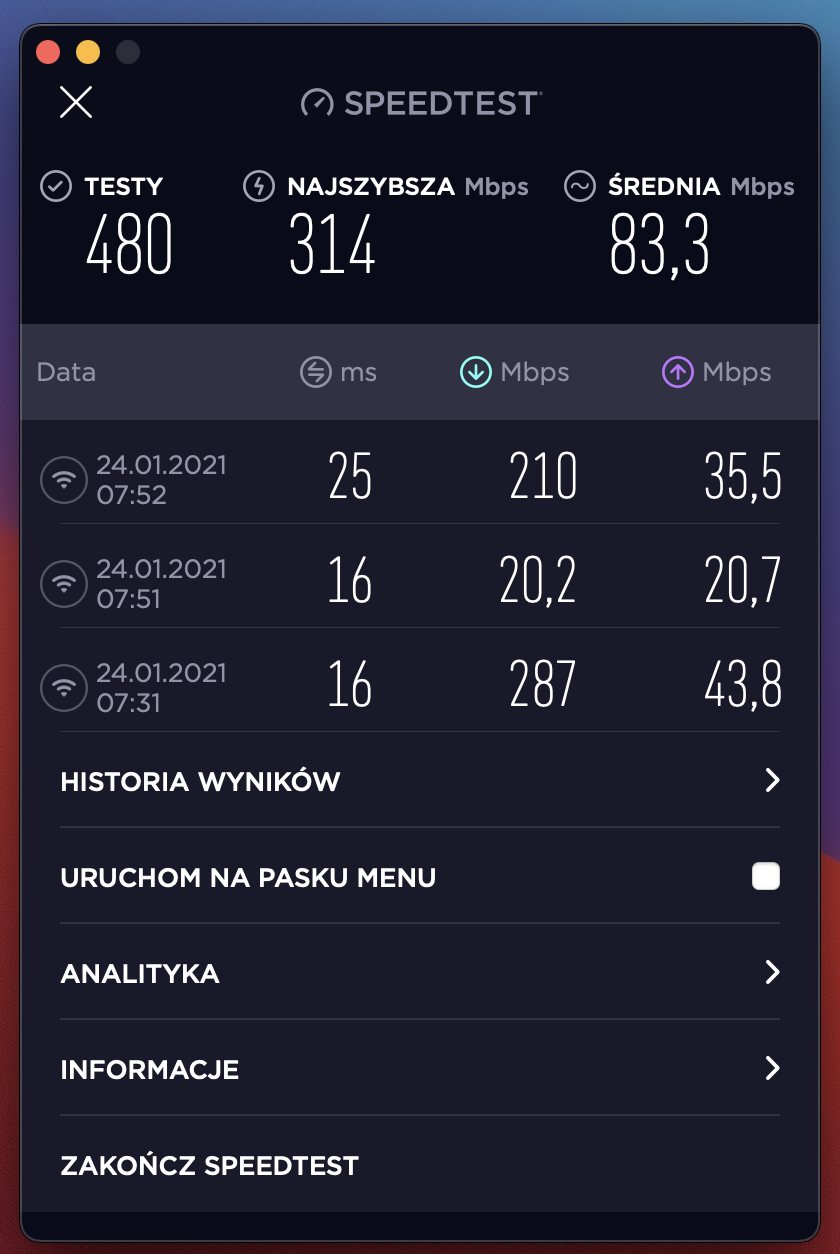

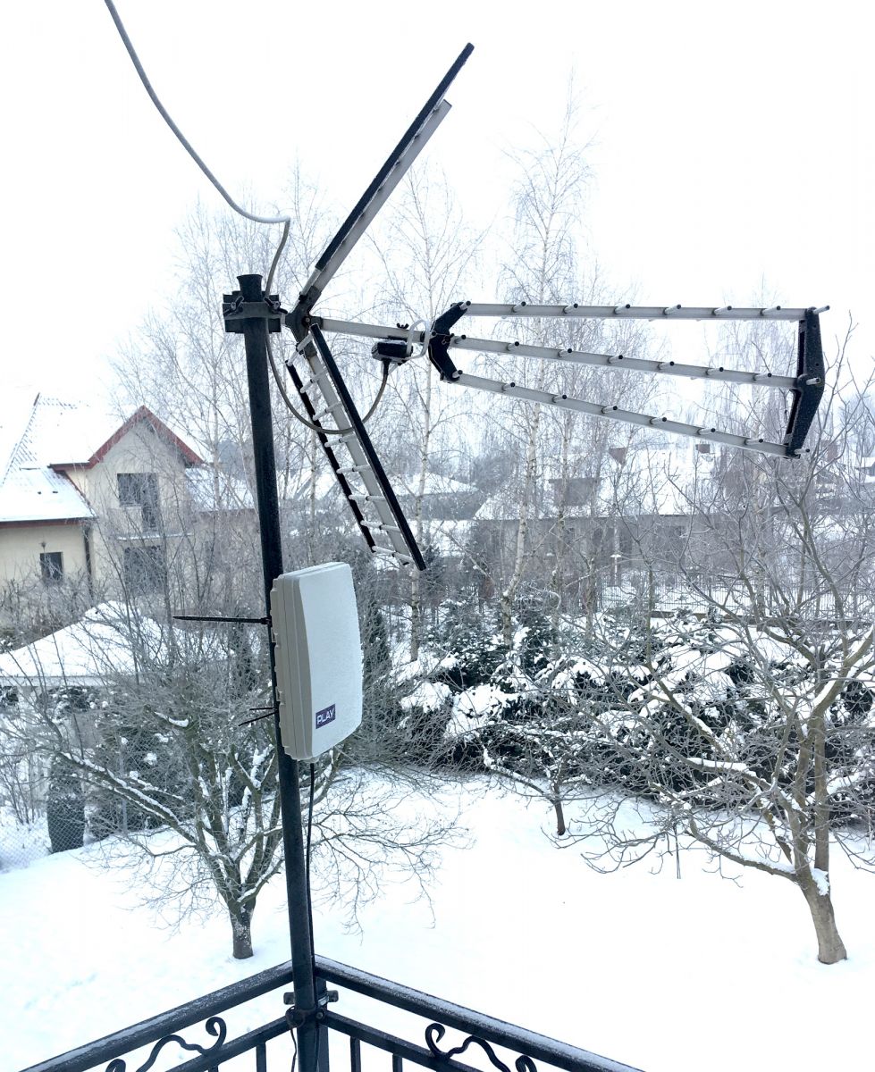

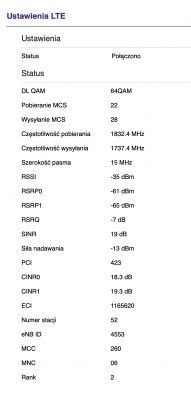

    Hello. Recently, I have a ZTE MF258K set from the PLAY network. I have about 0.5 km to the nearest transmitter and I directed the antenna at it. Unfortunately, I am worried that the internet can freeze for several minutes from time to time. The signal interruption usually lasts 2-3 minutes and then everything returns to normal until the next time.
    I am also wondering about the jumps in speed. Once the download is at 90 Mbps and 20 Mbps in a moment. At times, it can drop to 1 Mbps for a moment, and in a moment it is, say, 40 Mbps. There was one day when a record measurement showed me for several nice hours after measuring 200 - 260 Mbps.

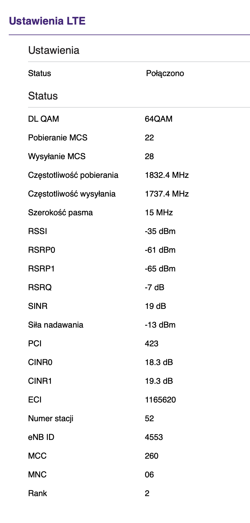

    BTS Gulczewo with aggregation of 4 LTE bands, but you connect to LTE1800 on the screenshots, see if aggregation was activated during the speedtest.

    How can I tell if aggregation has turned on during SpeedTest?

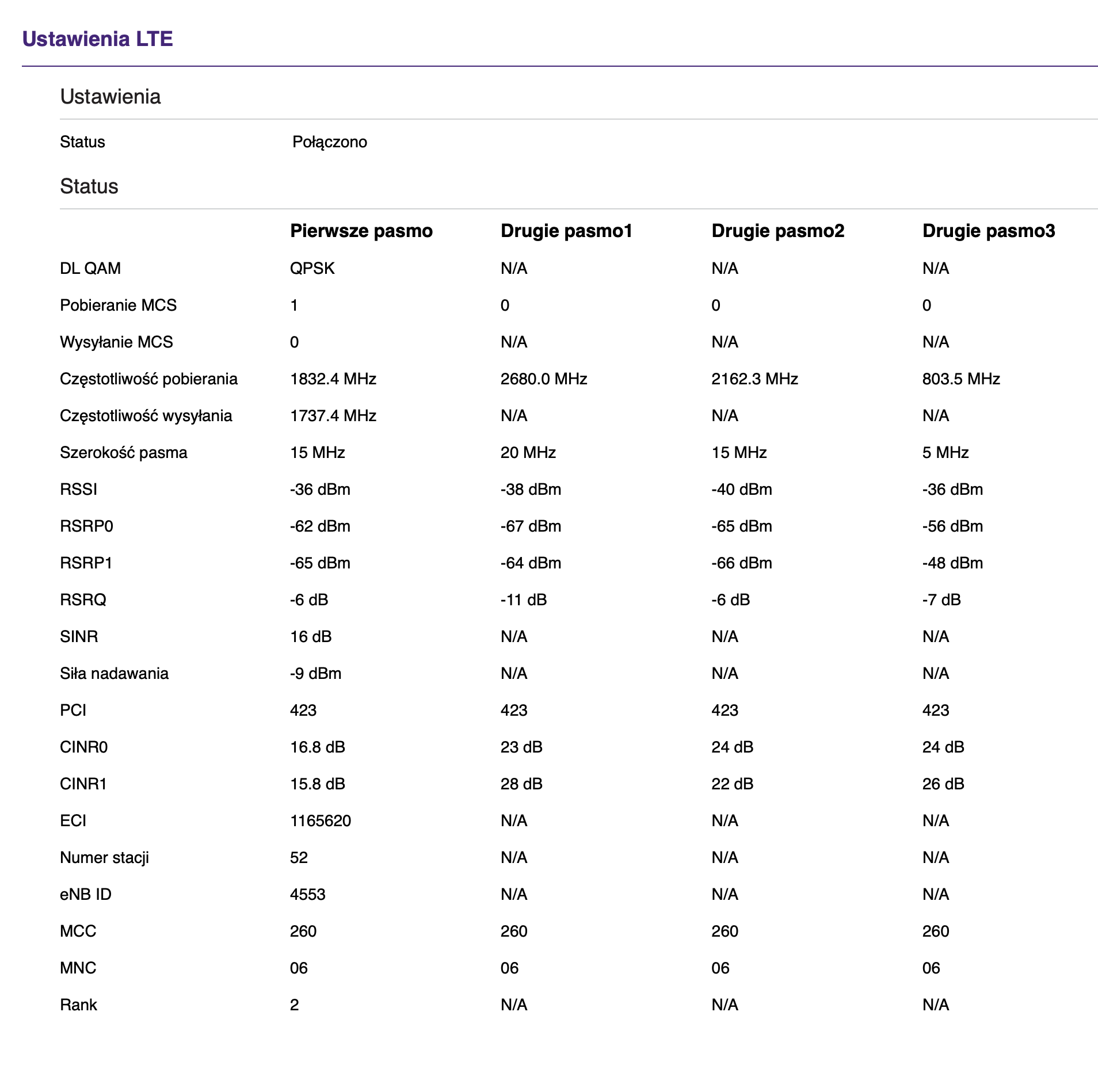

    No, they didn't show up and I took the test several times. Only when I restored the router to the factory settings (although I did not change anything in it), additional bands immediately appeared. But the speed is weak, in the range of 15 - 50 Mbps ZTE MF258K PLAY Freezes, Signal Interruption & Speed Fluctuations - Antenna Direction Issues?
    edit. now it was rocking - 180 Mbps. Where do these jumps and differences come from?
    edit2 no And it breaks, two minutes. no internet
    Or is it a problem that the antenna is right next to the Dvb-t antenna?

    07:31 - 287Mbps
    After 10 min. only 20Mbps
    And back 210Mbps in another minute
    Such drastic jumps are probably not normal. I am constantly looking for the cause of the problem: /

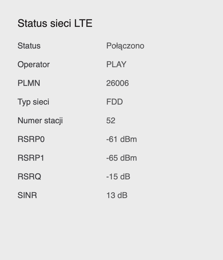

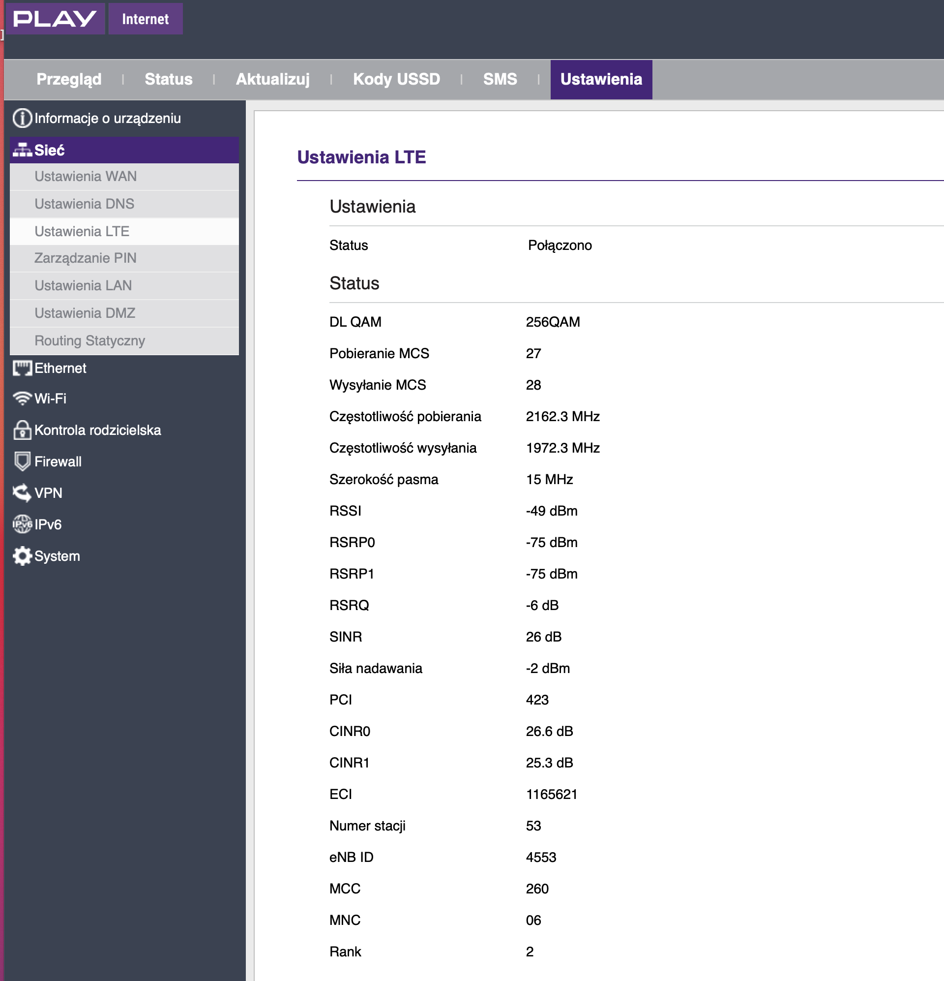

    The SINR at the moment ranges between 21 and 27dB
    I'm just wondering why the rest of the bands disappeared again? I suspect that I will restore the factory settings and they will show up again.

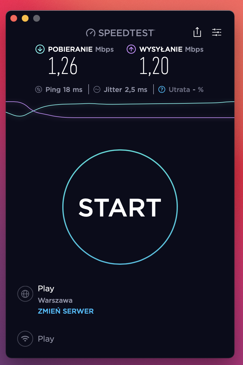

    I was just doing the measurement, it was over 100Mbps
    and after ten minutes: :(
    The SINR value during a speed decrease does not change

    Gentlemen, I replaced the SIM card in the Play lounge, it didn't help. Then I replaced the complete set with a second one and no changes either. Once there is a speed of 3Mb, in a few minutes even 270Mb, and in the next moment it can completely silt up. I don't know where else could I look for the cause?
