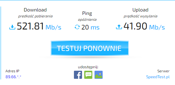

    nothing; c
    UPC Giga Connect Box: Internet Issues - Increased Ping & Decreased Speeds (DL/UL 40-50Mb/s) UPC Giga Connect Box: Internet Issues - Increased Ping & Decreased Speeds (DL/UL 40-50Mb/s)
    in this picture with a little more it is just after this change
    but ping nothing

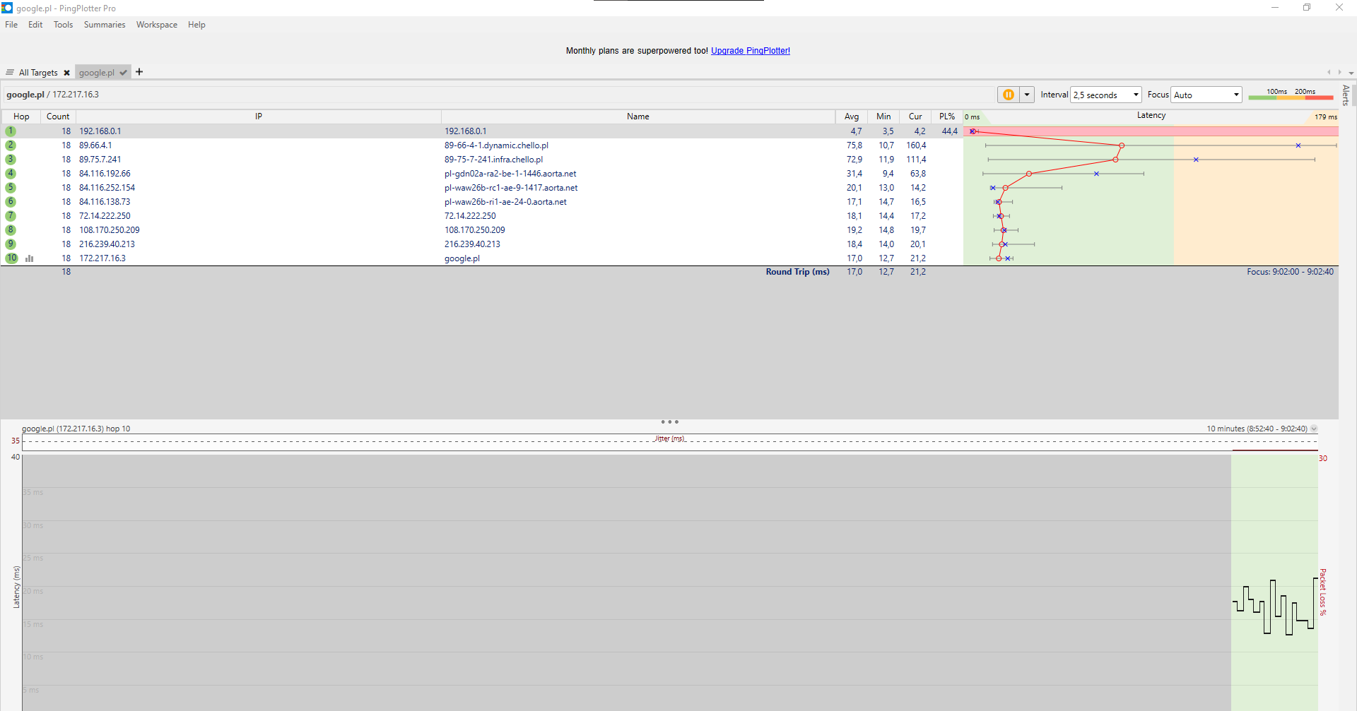

    Well, we won't help you more in this matter, I guess. Run speedtest on speedtest.net to the nearest server and tracert to google.pl and put the result.
  • #38 19234905

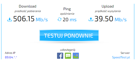

  • #39 19234910
    bbartek93
    Posts: 110
    Help: 19
    Rate: 29

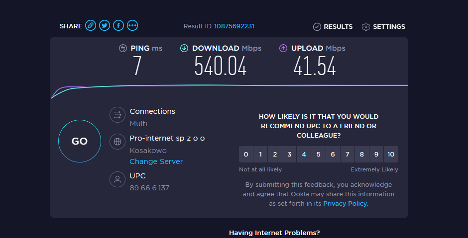

    Well, you have a 7ms ping to the nearest server. At speedtest.pl, it connects you to some further one. You can't do anything else :)
  • Nearest server shows 7 ms ping only
    #40 19234911
    RussianDoggi
    Posts: 34
    Rate: 12
    RussianDoggi wrote:
    Added after 10 [minutes]:
    Maybe because I'm from the mast 5g 9.2 km hmm ...
    Added after 16 [minutes]:
    Okay thanks for your dedication and overall thanks for your help have a nice day :D
