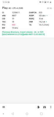

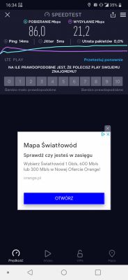

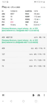

    Test done at the highest point at home. Which PLAY Internet router (with LTE 800 MHz band aggregation?)
    And here are screenshots when I go up the hill from myself
    Which PLAY Internet router (with LTE 800 MHz band aggregation?) Which PLAY Internet router (with LTE 800 MHz band aggregation?)
  • B535 supports forced LTE2100 plus 1800 aggregation
    #32 19807791
    matek451
    Posts: 31263
    Help: 4352
    Rate: 5810
    This time aggregation of LTE1800 plus additional bands, weak signal on LTE1800, similar to LTE2100 and sufficient on LTE800, but it does not matter. After the tests, the choice of the router is B535, on it you will force the aggregation of LTE2100 + 1800 bands. Outdoor antenna, directional at 1800-2100MHz, e.g. https://www.cybertech.com.pl/p188,antena-dualna-lte-4g-15dbi-mimo-do-huawei-b535.html, cable maximum 10 ma and preferably on dimension.

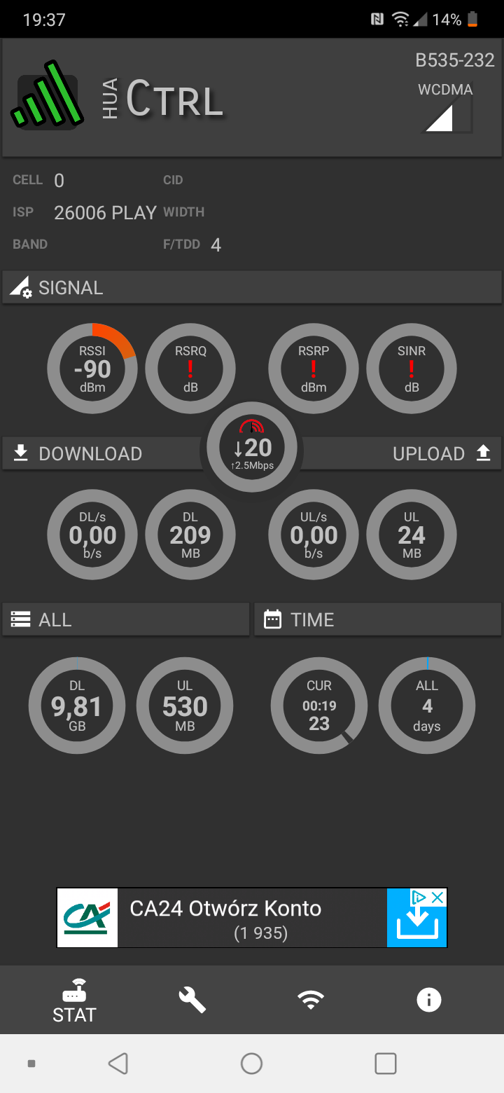

    #39 19818397
    eto07eto
    Posts: 43

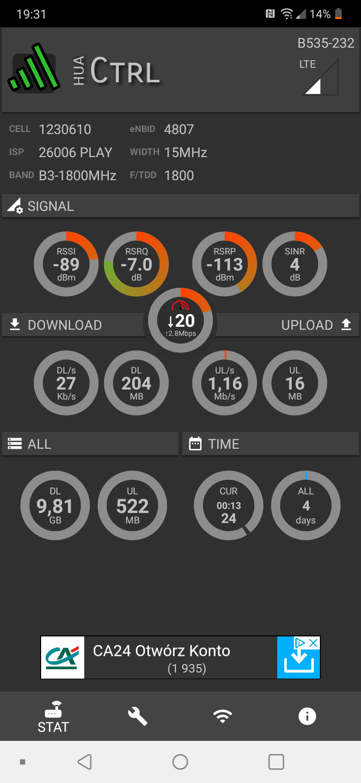

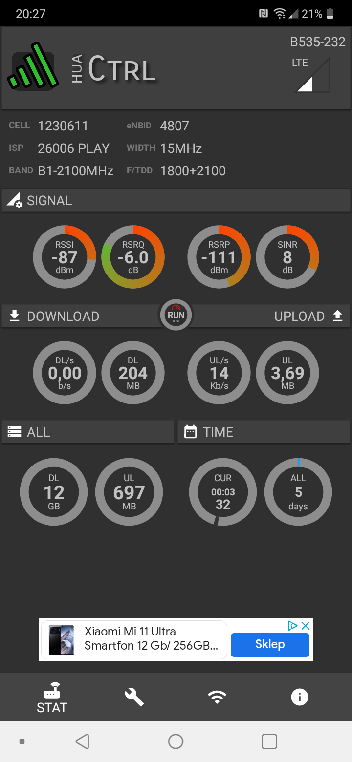

    Today I got an antenna and I have a strange problem. After connecting both sockets to the antenna, the signal drops to 3G. If I unplug one wire, then I get a LTE 1800 .. Replacing the wires does not help, maybe the antenna may be damaged?
    I put screenshots
    A little update. I changed the antenna selection to internal in the huactrl application and everything started to work, but I don't know if everything is ok. Which PLAY Internet router (with LTE 800 MHz band aggregation?)
