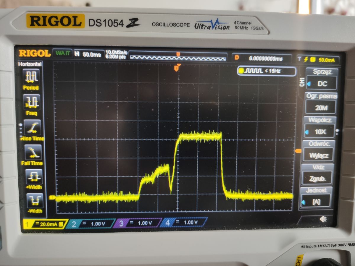

    Hi. Looking to get my module working on batteries, I decided to use the espNow functionality and deepSleep. And now I'm experimenting with different ways of putting the microcontroller to sleep, it turns out that probably the least current-consuming mode is
    Code: C / C++
    It allows the maximum reduction of time and current consumption during restarting as you can see on the attached oscillogram
    ESP8266 connecting to the network after ESP.deepSleepInstant() command The problem is that I don't know how I can connect to the network after such a sleep. At the moment, part of the setup(); function looks like this
    Code: C / C++
    Putting the esp to sleep in
    Code: C / C++
    mode causes the module to connect to the slave esp_now however this time is already ~300ms

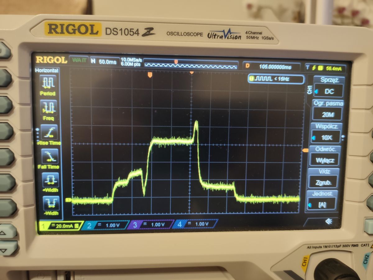

    khoam wrote:
    Does this mean that esp_now_init() returns a code different from zero?
    I haven't actually checked this.
    khoam wrote:
    Try calling WiFi.mode(WIFI_SHUTDOWN) before calling deepSleepInstant().
    You are a master :) regardless of whether I call ESP.deepSleepInstant() or ESP.deepSleep(); ESP resumes transmitting after sleep. Another mAh saved. The last bottleneck in my application is the BME280 which initialises in about 100ms. Anyway, now from waking up by reading the BME and sending it via esp_now (great stuff by the way, and I've seen practically no examples with this protocol on the Polish web) it takes 300ms with the biggest current draw of 60mA taking only 100ms. HUGE thanks!

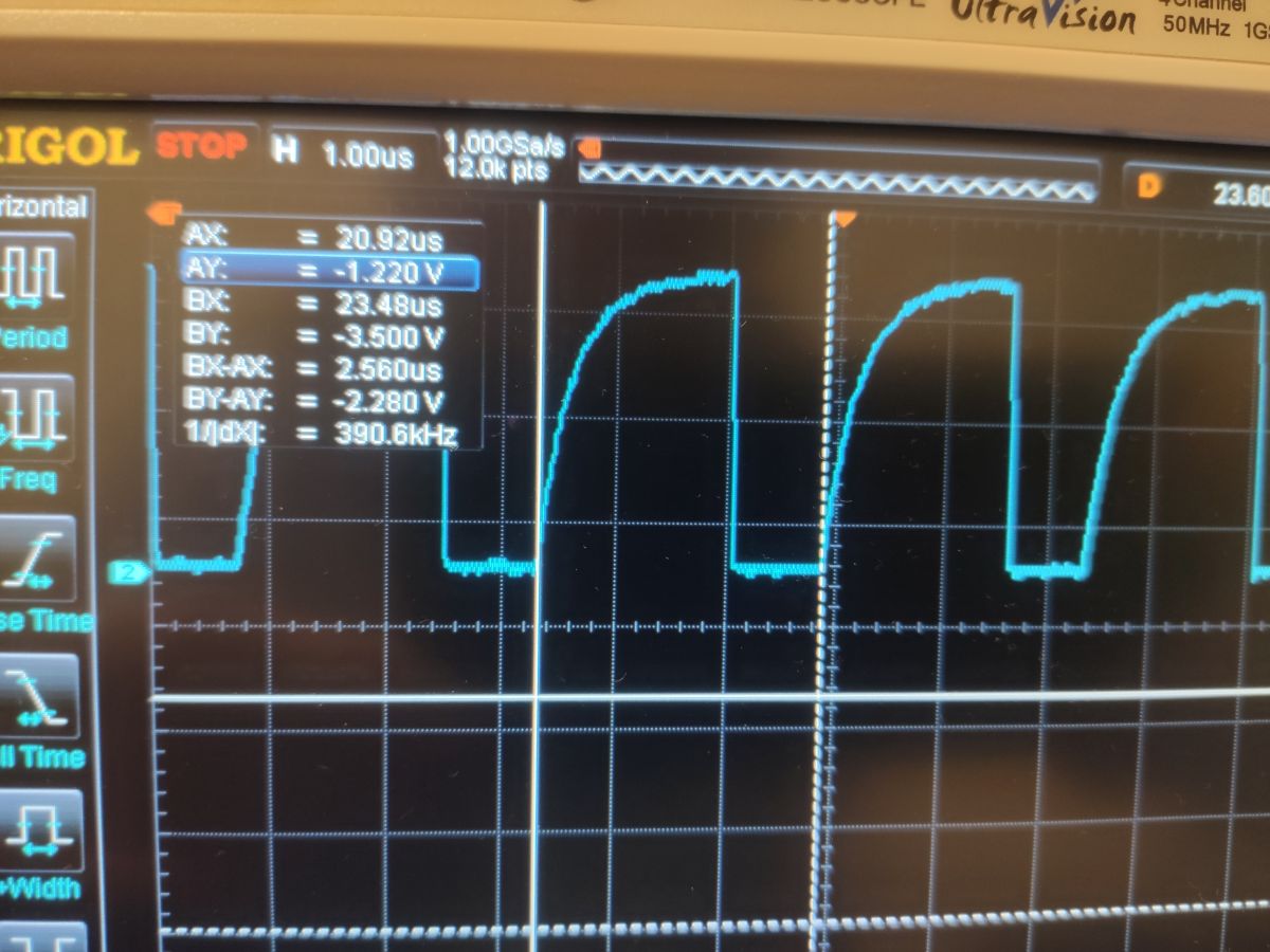

    khoam wrote:
    There is no I2C hardware controller on the ESP8266, so that 400 kHz is a pipe dream
    I just combined as much as possible to make the esp work as short as possible. I don't want to make excuses ...
    ESP8266 connecting to the network after ESP.deepSleepInstant() command .
    This is the SCL line ;) although probably if the esp was loaded more then the sampling would probably drop below 100kHz

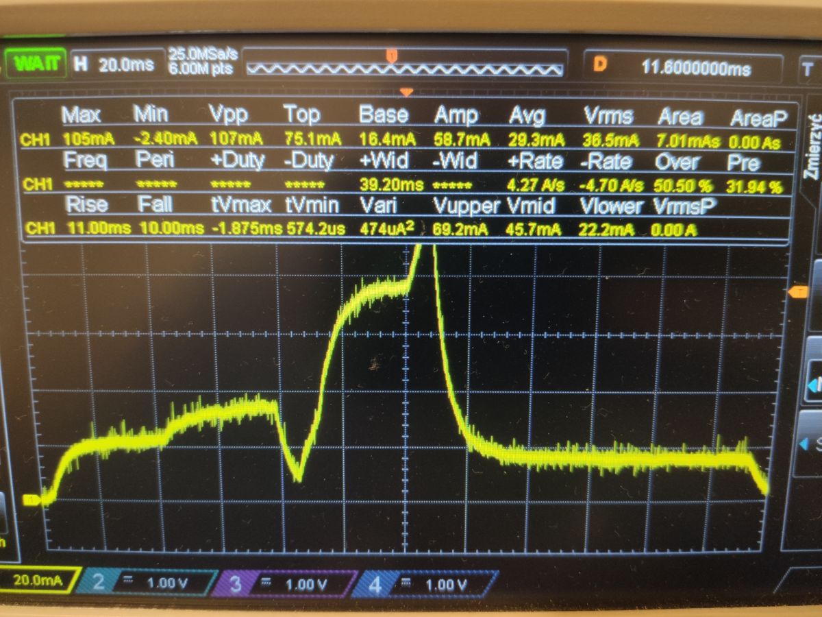

    OK I took this library from sparkfun, and now about 233ms elapses from reset to ESP sleep. This includes 100ms for start up and 40ms for measuring and sending data, where the current peak is 93mA in 10ms. Unfortunately I am not able to determine if the data is being sent correctly because as I wrote before, yesterday I fried myself an ESP that was working as a slave, tomorrow it will be new. I think that these results are very good, I intend to take measurements once every 10...15 minutes so the battery must last for a year (although I haven't counted it exactly yet), especially that the data will be sent only if the values of the new measurement are different from the values of the previous measurement,for this I will use the RTC memory.
  • Measured 7 mAs with ESPNow sleep cycle
    #12 19353095
    Zubiik
    Posts: 168
    Rate: 52
    So it works. No problem connecting to the slave, nor does the slave make problems when connecting to the network when you need to send data. I am impressed how low the power consumption of these esps can go. I think they can compete with NRF chips. Oddly enough, I could only find one topic about espNow on the internet, hmm why not post something about it in the future? To conclude this offtopic, I would like to share my results. As far as the oscilloscope measured it correctly, with all the measuring and sending it came out 7mAs, sometimes it is a bit less sometimes more.
