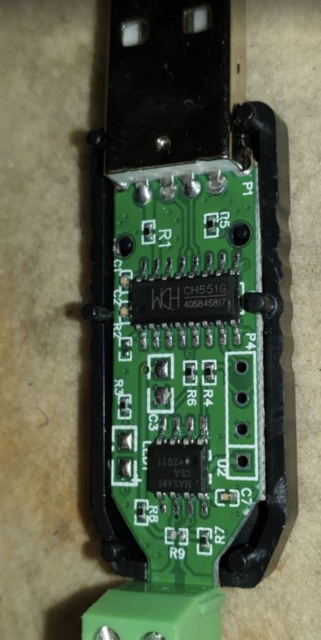

    I am embracing the topic of connecting the ORNO 516 to the Raspberry Pi and there is a problem. There is no communication. On the A/B terminals I have a voltage of 3.5V when the interface is not connected. After connecting the interface the voltage is only 0,036V. When I measure the resistance between terminals A B on the interface it is only 120Ω.
    The interface is a USB Serial CH341A. A friend who has a twin sysem and programmed my tiny has a slightly different interface, probably CH340. Maybe this is the problem?

    However, at a colleague's interface I had an AB voltage of about 5V and a resistance of 47k
    After removing this resistor, 3.3V appeared on mine but I still had "Time out" in the logs
    starob wrote:
    What do you mean when you write "HL-340"?
    Different chipset. The facts are that both mine and my colleague's have exactly the same driver but his works and mine does not. I quote his reply:
    "Yours is 1a86:5523 QinHeng Electronics CH341 in serial mode, usb to serial port converter
    My 1a86:7523 QinHeng Electronics HL-340 USB-Serial adapter"
    This is what mine looks like
    Connecting ORNO OR-WE-516 Three-phase Meter to Home Assistant via WiFi .
    Both myself and a colleague bought from the same shop and they are sold as RS 485 to USB converters. Nowhere is it stated that they can be on different chipsets. The colleague stated that he must have been lucky to come across one that worked. He tried to run mine on a different driver, but without success.
    The problem seems to be on the parity check side.
    When writing the script for RaspberryPi a colleague was helped a lot by this thread Link .
    It shows that communication over RS-485 with Orno is badly screwed up.
    And the HL-340 chipset somehow manages it and my CH-341 no longer does.

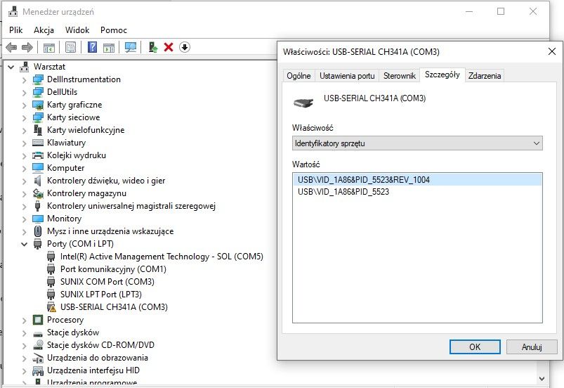

    In the system it is seen correctly as COM3 and physically this chip converts from USB to SerialTTL.
    There is a second SerialTTL to RS485 converter inside (e.g. MAX485 or other) and it is rather the one you have a problem with.
    Whatever you would do with the drivers you have no influence on it (it is unprogrammable) - as I wrote: it works or not.
    It could be faulty or something wrong with the connections.
    Darek.S wrote:
    This is my
    I forgot , that in the computer under Windows10. and there it will not work only in RasperryPi2. A colleague has an identical system ( admittedly Rasperrypi3 but it should not matter ) and my converter in him did not work. "
    Darek.S wrote:
    This is my
    I forgot , that in the computer under Windows10. And there it will not work only in RasperryPi2. A colleague has an identical system ( admittedly Rasperrypi3 but it should not matter) and my converter in him did not work.
    I.e. from the RasperryPi side it is visible but it does not communicate with Orno. The message "Timeout"

  • HL-340 adapter fixed the RS485 link
    #22 20586456
    Darek.S
    Posts: 6740
    Help: 216
    Rate: 979
    starob wrote:
    There is a second SerialTTL to RS485 converter sitting inside (e.g. MAX485 or other) and it is more likely to be the one you have a problem with.
    This is exactly the case
    It is difficult to say whether the Max485 or the CH551G is underperforming in this CH-341. The fact is that as a whole it does not work. Yesterday the HL-340 arrived and with it there is no longer a problem.
