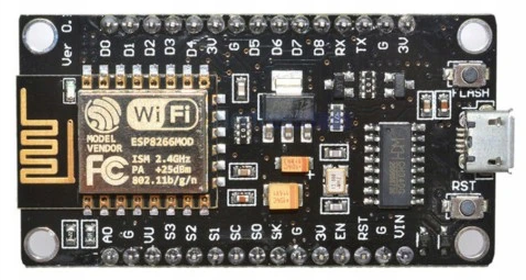

How can I stop an ESP8266MOD from constantly resetting when I enable WiFi support?
Erase the whole flash and re-upload the sketch with the Arduino IDE option set to "Erase Flash: All Flash Contents"; the resets were caused by garbage left in the flash area used for WiFi settings, which `WiFi.begin()` does not clear [#19425469] [#19425505] After that, you can switch back to "Only Sketch" for faster uploads [#19425505]

    Welcome.
    The topic is about this version of the mod
    ESP8266MOD: No WiFi connection - program code issues .
    Code: C / C++
    There is practically nothing in the program and it constantly resets itself.
    As I do not attach the WiFi support the module itself when blinking the diode works.
    Is the module defective or am I doing something wrong?

    Power supply all correct? I.e. you're probably powering from USB anyway, but you could check that the voltages are correct after the stabiliser etc.
    Exception indicates a problem with program execution, if it is caused by WiFi code then maybe try clearing memory and uploading new firmware.
    rst cause 2 it looks like the reset button was pressed.
    Don't do so many delays because if you start to complicate the code, it will start to watchdog reset the board (rst cause 4).
    You can give yield() in the main program loop.

    I fed 3.3V from the power supply behind the stabiliser and still the same.
    The button is working, when I hold it down the ESP does not start.
    I added a delay so that ESP resets more slowly.

    @khoam Many thanks works.
    Two words of explanation.

    Okay I actually got something mixed up, although I try to avoid delays anyway, maybe that's what got me worked up. Although I'll admit honestly that I haven't figured out the basics like delay in the source files.
    Stack trace decoder would indeed help to track down the problem, although with this simple program it probably helps just to tick "erase all flash contents". Sometimes things can go wrong in the configuration and circuses happen.
