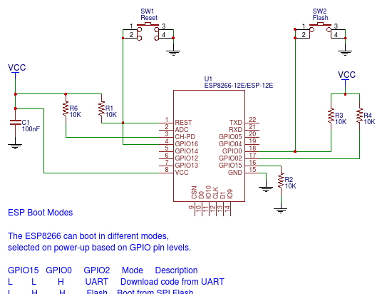

    I have a problem connecting to the ESP-8266.
    Everything connected according to this diagram (step 3).

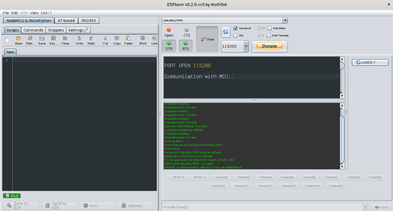

    I then started ESPlorer, unfortunately I can't connect to the chip (I have the same in minicom - I can't type anything in the console)
    Failed connection to ESP-8266 after uploading new firmware Failed connection to ESP-8266 after uploading new firmware .
    Anyone have any idea what the problem could be ?

    I have no such network.

    I uploaded the file again - the result is the same ( no network, RX/TX does not work).
    I bought the module some time ago, on the casing it says ESP8266MOD.
    Module itself looks like yes , it is soldered to yes board.
    I would add that after uploading the software, no LEDs light up on it (not sure if they should).
    Maybe there's something wrong with this connection - I've seen different variations on the internet.

    I have uploaded the firmware.
    I only left the VCC, GND, and VCC to CH_PD connections and nothing.

The discussion revolves around a user's inability to connect to an ESP-8266 module after uploading new firmware (esp8266-20190529-v1.11.bin) using esptool. The user reports that the expected WiFi network "MicroPython-xxxxxx" is not visible post-upload, and no LEDs light up on the module. Other participants suggest checking the wiring, ensuring GPIO 0 is disconnected from ground during the upload, and pulling up GPIO pins with resistors. The user confirms the module is labeled ESP8266MOD and has attempted re-uploading the firmware without success.
