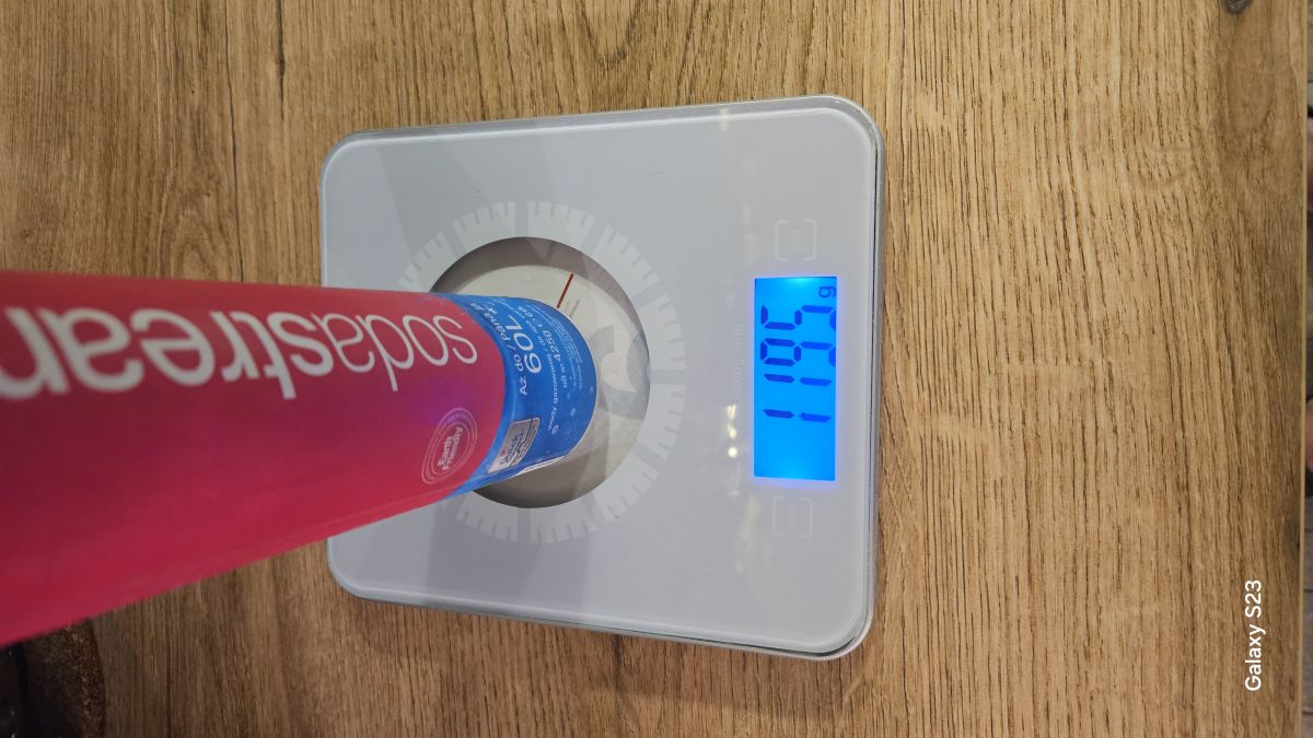

  • Repeated freeze-and-refill method boosts CO2 fill to 450–520 g
    #50 21625187
    karylodz1
    >>21611336 .
    Gentlemen,
    You're wondering how quantum physicists and I managed to do it on peasant sense and scooped up a 450g.
    1200-g whole cylinder, shunted from Allegro.
    Maybe it will work for you too, try it.
    You have to do it 3 or sometimes 4 times. Nab an empty one without refrigeration and into the freezer for 15-20 minutes and re-tap. The cooled gas will reduce the pressure in the cylinder and a lot of gas can be added again. And so on until the right weight is reached.
    Once I managed to pump 520 grams :) .
    Good luck

    >>21625187 .
    SodaStream gas cylinder on digital scale showing 1157 grams
    SodaStream cylinder weighs 1195 g on a digital kitchen scale .

    So what ? I have to chill the bottles 3-4 times before each filling ? If so, it must be a joke. Unfortunately, I have not been able to fill more than 100g without creating a vacuum in the cylinder. This is not quantum physics, it's just common sense and the same method used to fill air conditioning systems.
  • #52 21628845
    karylodz1
    Try it and then have your say, I've been scooping this way for a few months now and it always works. Vacuum of course you can do as you wish, your business.
    Since the weight of the pink cartridge after a few freezes was 1310 gr, how much do you think was crammed in there?
    I can upload some pics of each cartridge, but I don't want to prove anything anymore. So play along as you like.
    Regards

3-step method to reach 400 g+ consistently?
  1. Vent and freeze the cartridge to −20 °C.
  2. Connect; lay the cartridge horizontal, keep the 6 kg cylinder upright (siphon) or upside-down (no siphon).
  3. Crack the valve slowly, wait until scale shows 425 g, close, bleed, detach. Total time: ~30 s.
