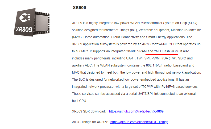

  • XR809 runs at 160MHz and provides 384KB SRAM plus 2MB Flash ROM.

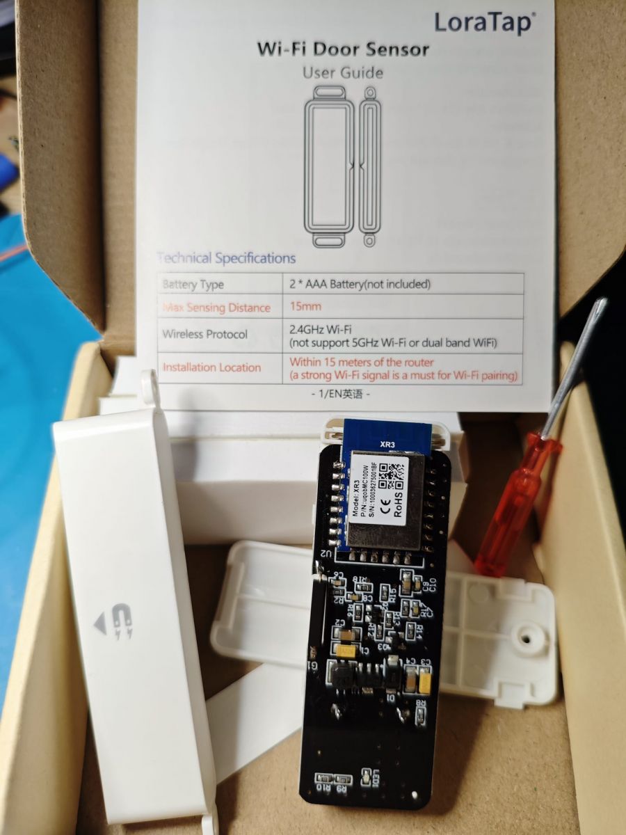

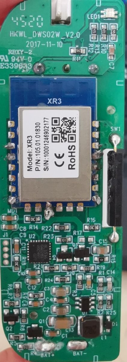

    I have an XR3 / XR809 Mirabella Genio Door/Window Sensor with (I believe) a TuyaMCU onboard: the 8L151G - see attached image.
    Close-up of the interior of the XR3 Mirabella Genio door/window sensor with markings on the circuit board.
    Has someone managed to source the outputs with this with a XR809 / tuyaMCU combination?

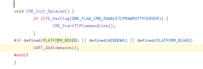

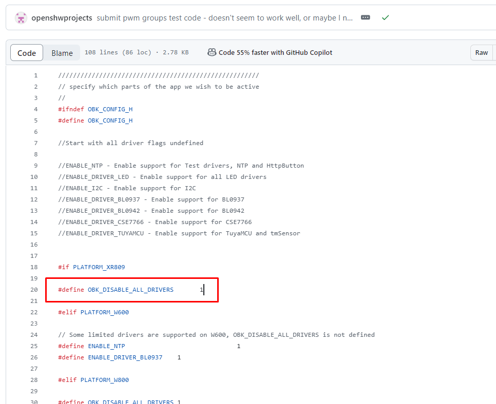

    TuyaMCU driver is not enabled on this platform. You are the first one ever to document a TuyaMCU device with XR809. I have never seen anything like that.
    To enable TuyaMCU, you would need to do two things:
    1. add a proper define here:
    https://github.com/openshwprojects/OpenBK7231T_App/blob/main/src/obk_config.h
    2. add missing UART initialization here:
    https://github.com/openshwprojects/OpenBK7231T_App/blob/main/src/driver/drv_uart.c
    Following operations may require some basic C and programming knowledge, but it does not require writing new code per se, you just need to fill the stubs with XR809 SDK examples.

    By the way, it seems that you also need to remove OBK_DISABLE_ALL_DRIVERS on XR809.

    I am thinking of starting with just enabling TuyaMCU with:
    #define ENABLE_DRIVER_TUYAMCU 1
    Then following through with the supporting code to get the comms working.
    I don't believe I would need anything else just looking at the other platforms.

    Don't forget to enable it first:
    Screenshot of a code snippet in a GitHub editor.
    The things you mentioned are development time test commands, you don't need them. You just need TuyaMCU driver to get TuyaMCU commands and fix the missing UART port open call with a baud rate setting. Ah, and also the missing UART port send call.

    Changes made so far for the XR809 with a tuyaMCU:
    edited /obk_config.h:
    #define enable_tuyamcu
    edited driver/drv_uart.c:
    #include "driver/chip/hal_uart.h"
    #elif PLATFORM_XR809
    // Transferred across from OpenXR809-master\project\example\uart\main.c, uart_init()
    #define UARTID UART1_ID
    added to:
    uart_sendbyte
    uart_uart_inituart
    edited /new_common.h:
    In xr809:
    typedef unsigned int u32;
    makefile: in oxr_sharedapp/gcc
    added:
    SRCS += ../shared/src/driver/drv_bl_shared # for DRV_GetReading
    SRCS += ../shared/src/driver/drv_tasmotaDeviceGroups # for DRV_DGR_OnLedFinalColorsChange
    SRCS += ../shared/src/devicegroups/deviceGroups_write # for DGR_Quick_FormatPowerState (and requireds u32 defined in new_common.h
    SRCS += ../shared/src/driver/drv_tuyaMCUSensor # for TuyaMCU_Sensor_Init
    SRCS += ../shared/src/bitmessage/bitmessage_write # for MSG_WriteBytes
    removed:
    SRCS += ../shared/src/httpserver/json_interface
    # Excluded json_interface to save space in the image
    Then due to removal of json_interface:
    -removed in http_fns.c at line 2297 and 2303 reference to JSON_ProcessCommandReply
    project\oxr_sharedApp\gcc/../shared/src/httpserver/http_fns.c
    -removed in new_mqtt.c at line 712 reference to JSON_ProcessCommandReply
    project\oxr_sharedApp\gcc/../shared/src/mqtt/new_mqtt.c
    -removed in rest_interface.c:1722 reference to JSON_ProcessCommandReply
    project\oxr_sharedApp\gcc/../shared/src/httpserver/rest_interface.c

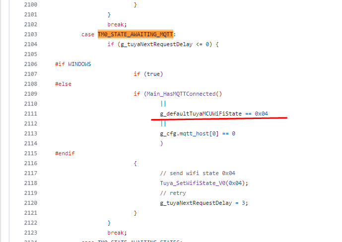

  • tmSensor waits for MQTT unless wifi state is 0x04
    #51 21025435
    Posts: 14796
    Rate: 12953
    tmSensor driver will wait for MQTT connection to appear by design:
    Screenshot of programming code related to MQTT connection logic and Wi-Fi settings.
    ... unless you set default wifi state to 0x04 , then it will proceed without MQTT.
    In order to get broader understanding about the driver, you should refer to our other guides:
    Energy-saving (?) Battery-operated door / window sensor for WiFi DS06
    Also search for battery powered devices here:

  • #55 21170855
    Posts: 14796
    Rate: 12953
    If you cannot issue uartSendHex , then check here:
    A snippet of source code in C with defined platforms.
    in cmd_main.c

  • LoraTap sensor still ships with XR3 chip
    #57 21415015
    Posts: 5236
    Help: 450
    Rate: 920
    if anyone's interested, the LoraTap wifi door and window sensor still appears to come with an XR3, mine just did anyway.
    https://www.aliexpress.com/item/1005007268034863.html
    Illustration showing LoraTap WiFi/ZigBee door and window sensors on the Aliexpress page.
    It's quite a nice package. Could do a separate topic on I suppose. Wouldn't be able to fully convert though to OBK I guess - deepsleep, ADC (?), ota, lfs
    LoraTap Wi-Fi door and window sensor in an open box with visible electronic components and a screwdriver.
