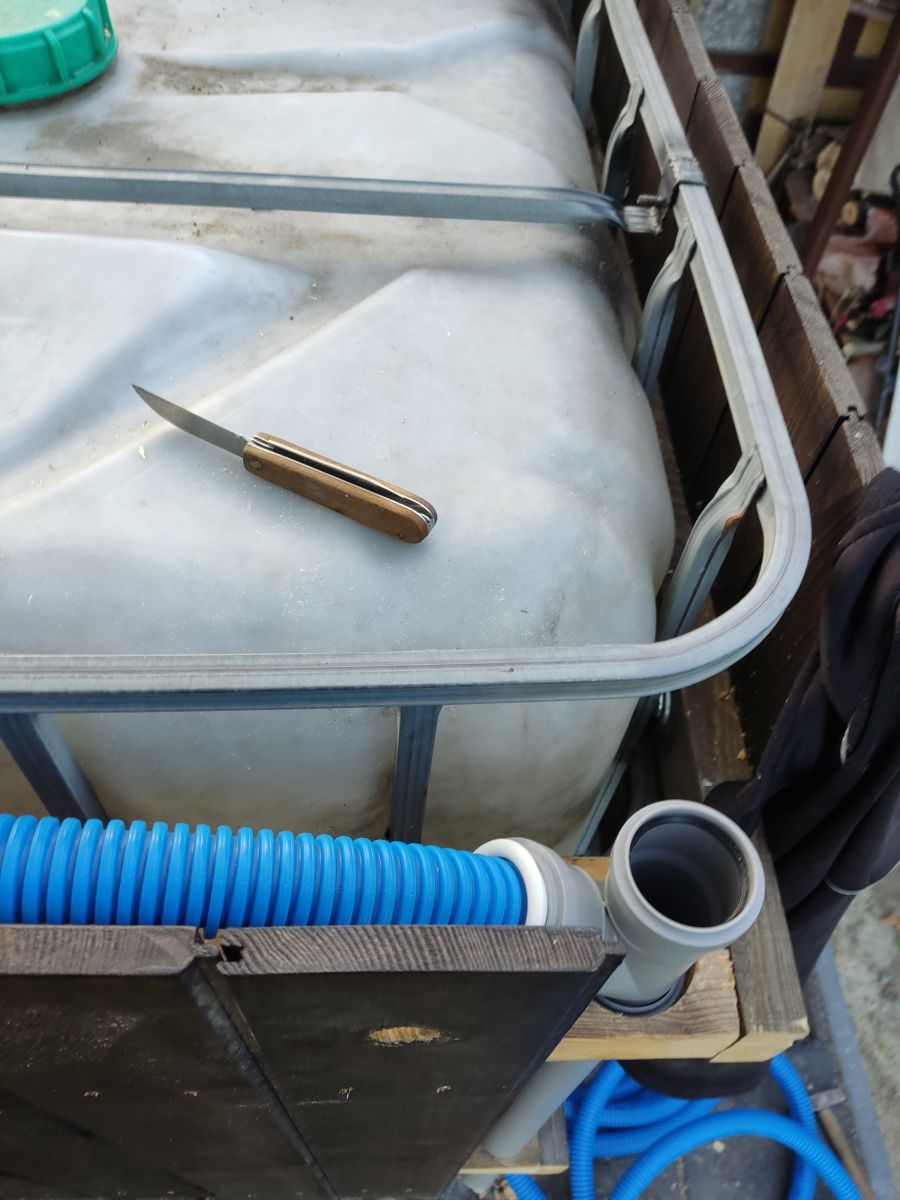

  • 32 mm pipes and roof debris still allow filling tanks
    #32 19450225
    zybex
    Helpful for users
    Posts: 15919
    Help: 2094
    Rate: 2939

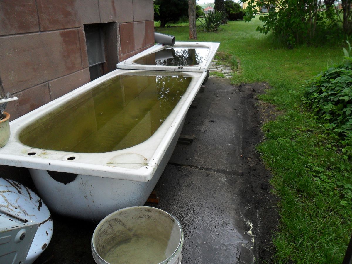

    andrzej20001 wrote:
    I don't know what you have on these roofs, to clog such a tee / siphon made of 50 mm pipes, you would probably have to live in the forest.
    For me, the pipes are 32 mm, because I decided that they would be enough for water. Regarding the roof, I have plenty of sparrows building their nests. Sometimes young sparrows fall into the water and drown. This was the case with the tubs I had previously at this location. I happened to spot a drowning sparrow in time and save it.
    I also had deciduous trees nearby, but I cut what I could and cut others significantly.
    It's rained a bit today and the water in the tanks has even arrived.

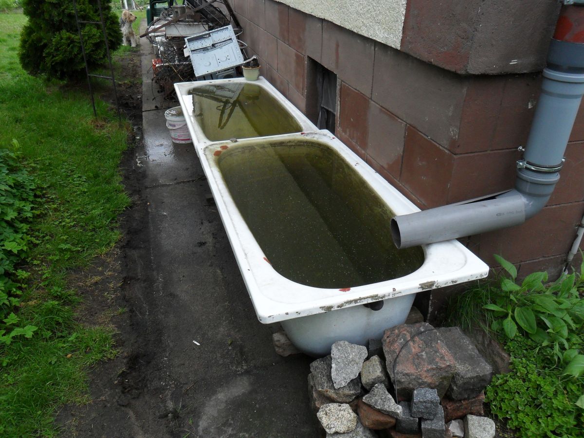

    Rainwater Tanks: Preventing Algae Formation in Mauser 1000L Tanks with Proven Preparations
    Under the second gutter I have two tubs (and a bucket :D ).

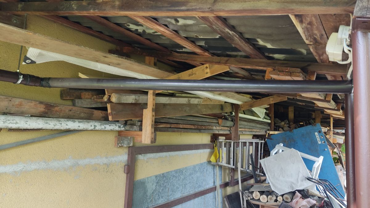

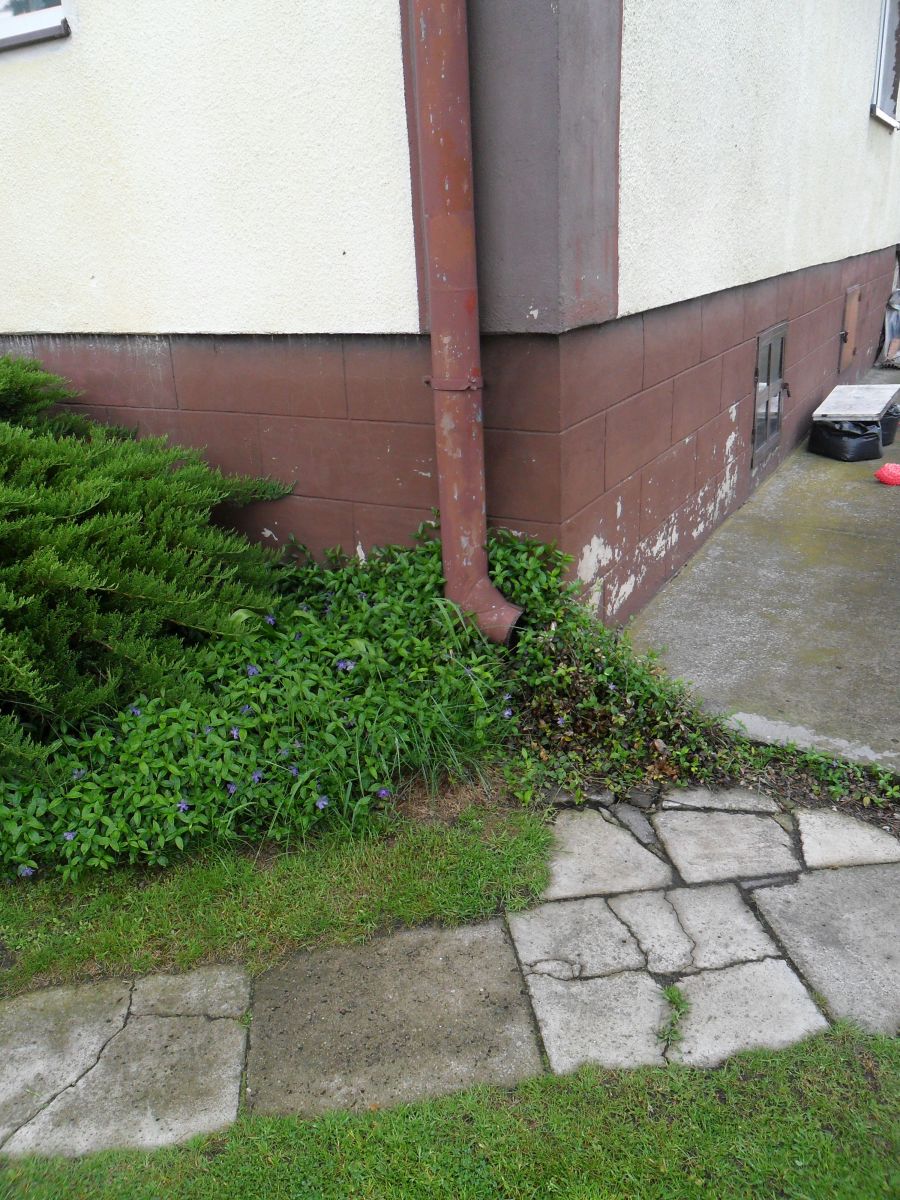

    The third gutter from which I do not collect water for aesthetic reasons.

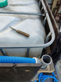

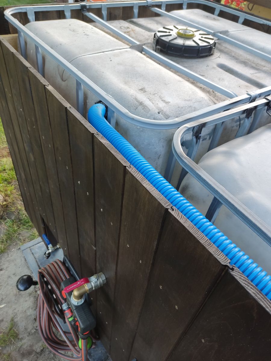

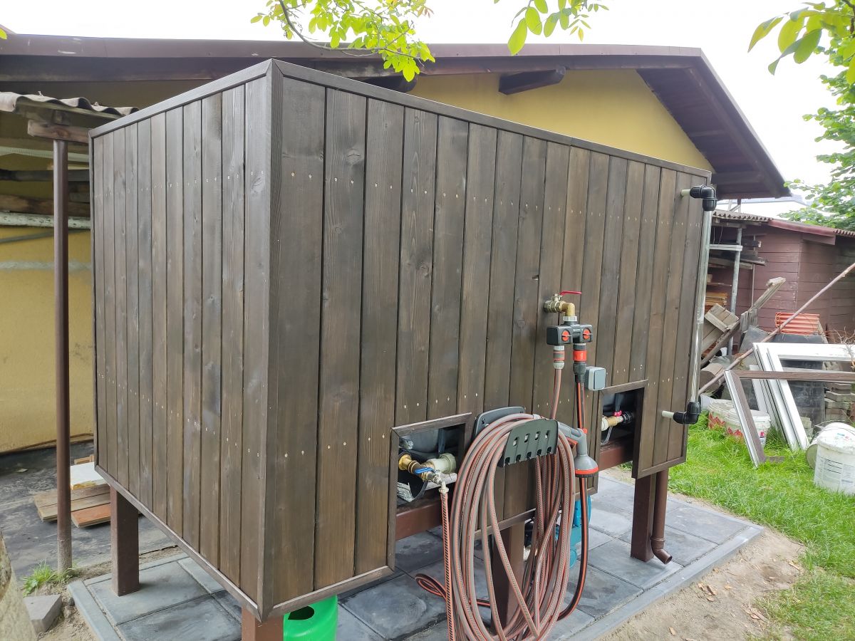

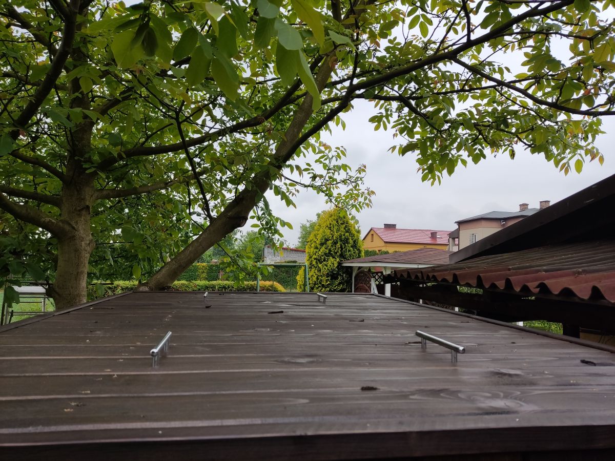

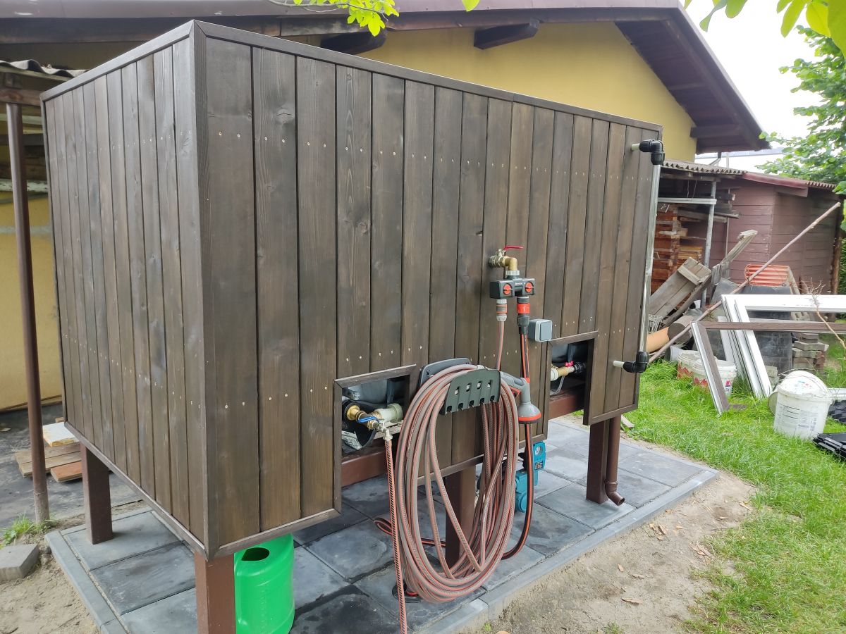

    Here is my solution to your problems. ;) .
    Drainage pipe attached to a building wall with visible elements of improvised repairs. Collection of various building materials and tools under a shelter. Wooden shed under a roof with mounted pipes. Wooden roof under a sprawling tree in a garden with visible neighboring buildings. Wooden roof under a sprawling tree in a garden with visible neighboring buildings. Wooden garden tool box with attached hose. Wooden structure in a garden with attached water hoses and valves. Wooden garden enclosure on metal legs with a rainwater barrel. Makeshift pipe and plank system on the exterior wall of a building. Wooden structure with a roof and a pipe mounted to the wall. Storage of building materials under a shelter. View of a wooden surface under a tree with dense foliage. View of a wooden surface under a tree with dense foliage. Wooden box with hoses and plumbing elements outside a building. Wooden structure in a garden with a water system and gardening tools. Large wooden box with an irrigation system in a garden. Wooden structure being installed in a garden.

    Very nice, after all, expensive. ;-) The water pipe doesn't turn green? And how did you choose it to fit? I like the idea.

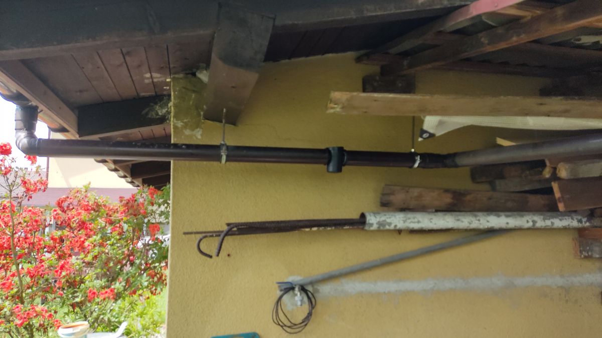

    The tube is PVC and I cut it to the size needed.
    The tube is in the sun most of the day, so it turns slightly green after about 2-3 weeks, but this is very easy to remove by unscrewing the two fittings. The valve in front of the tube also jes, so that there is no problem that there is water in the tanks. Cleaning involves pulling a cloth through the tube.
    I don't know if it's visible in the pictures, but I have fitted a filter in the downpipe from the gutters. There it catches leaves and other debris from the roof.
    There is also an overflow made in the tanks for downpours in storms, and the top tube of the water gauge is also inserted into it (I will paste pictures).
    There is a disc filter in front of the pump, so I don't worry about small dirt, I won't clog up the strainer in the spray gun or possibly the drip line that will be created one day.
    Rainwater storage tanks with a wooden cover and installed blue PVC pipe. Knife on a white plastic tank next to a blue hose and gray PVC pipe. PVC pipe installed on a wooden structure with blue hoses on the ground. .

    Is it available at any Castorama? And it fits perfectly into the fittings without additional gaskets? Where can I find one? The walls should be rather thicker?
  • #41 21143180
    Gwozdziu944
    Posts: 17
    I bought this tube on Allegro. I think the size is fi 25 mm and it fits fittings of the same diameter. The auction title said something like: "transparent tube, transparent 1M fi 25/2". Fittings also from Allegro, but there are some in the markets too.
    In the one I bought, the walls are 2 mm.
