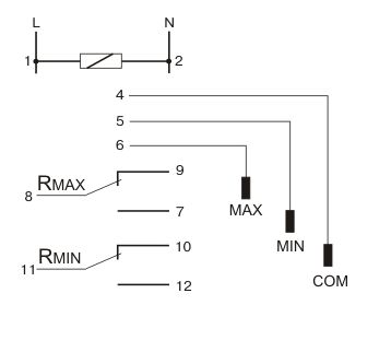

How can I wire a rainwater tank controller so the pump keeps running until the tank reaches the maximum level and the tank refills as soon as the level drops below that maximum?
Connect the PZ-829RC to the Rmax contacts; it has separate relay contacts for the max and min probes, and the max probe should be used for the refill trigger [#19880116][#19880134] The controller’s behavior in the thread was confirmed as working as intended by the manufacturer, so the issue was not a fault in the relay logic [#19880258] For the requirement to keep the pump interruption as short as possible and start topping up immediately below the max level, the poster ultimately did not keep using the original setup and solved it by mounting two C61F-GP controllers instead [#19895082]

    Hello, I own a rainwater tank for watering the garden.
    The watering is controlled by a rainbird controller.
    The controller is connected to a contactor which runs the pump.
    I need a controller that will protect the pump from running dry (minimum level). It will pump water up to the maximum level ( when the rainbird runs out, watering can run). The controller will give voltage to a 230/24 transformer and this will activate an electro-valve which will fill the tank.
    I found a PZ-829 RC controller, but unfortunately either I am doing something wrong or there is no possibility to start pumping immediately after the water drops below the maximum level.
    In theory, the solution to my problem turned out to be the PZM-20 controller, everything worked as long as there was city water in the tank, unfortunately with rainwater the sensors do not work.
    The whole control set should preferably be mounted on din rails.

    The PZ-829RC should work fine for you after all it has two relay contacts from the max and min probe.
    I understand that you want to start topping up when the water drops below the max level and turn off topping up when it reaches the max?

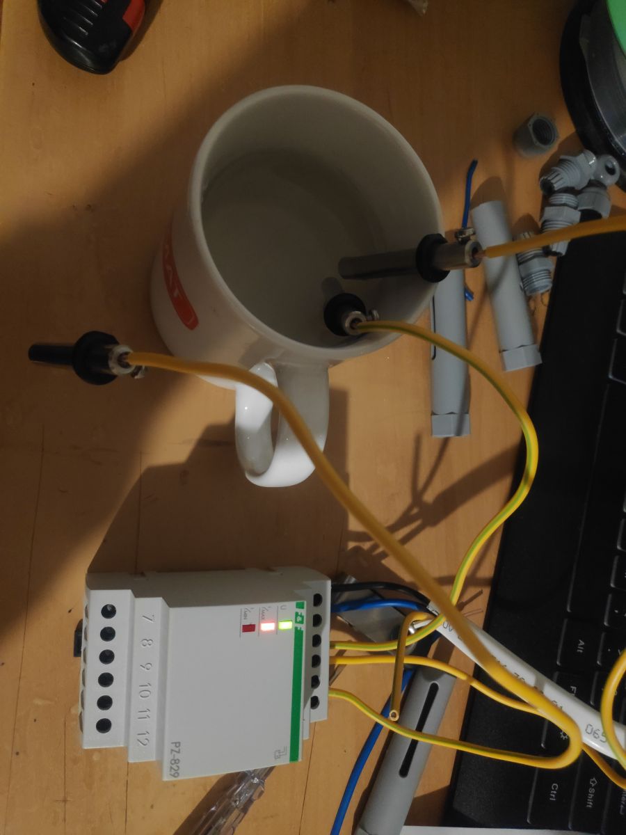

    The max and min pins work the same way, so if I have a short on max pins between 7-8 then on min I have a short on 10-11, if it changes 8-9 then on min 11-12. Unless my controller is just faulty?
    In the picture below, max probe pulled out, short on pins 7-8 and 10-11. Inserting pull out probe doesn't change anything.
    PZ-829 RC and PZM-20 rainwater tank controllers - questions and concerns .
    Only after pulling out the minimum probe does the controller switch to minimum mode. Then I insert the minimum after it max and then the controller switches to max mode.

    How does the controller behave when all the probes are removed from the water ?

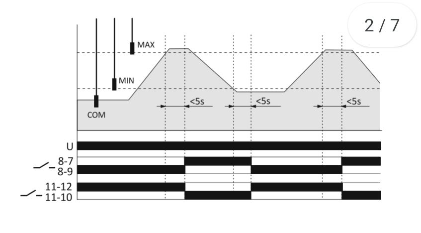

    Diode changes to minimum, short circuit on pins 8-9 and 11-12
    Added after 6 [minutes]:
    Looking at the diagram below I find that the controller works as intended by the manufacturer. Apparently I need a different solution.

    Well, just place the minimum probe at the level at which you want the topping up to be activated and the maximum at the level of the full tank, unless I still don't understand something.
