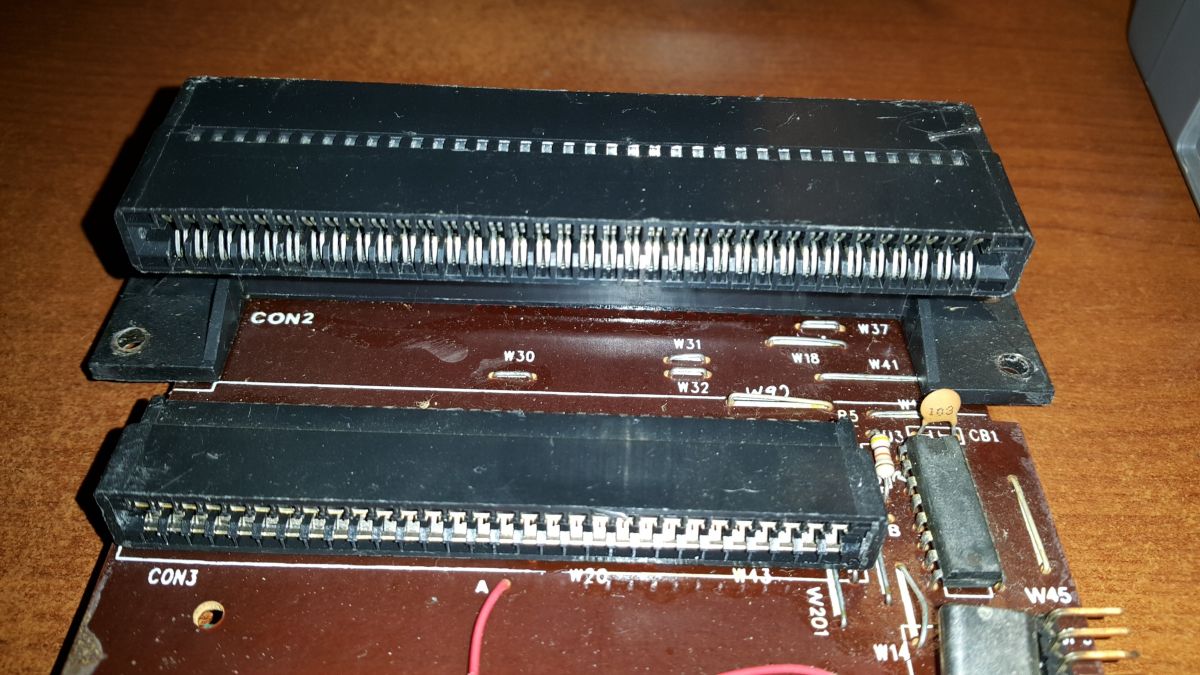

    Recently, an interesting console fell into my hands - Daryar DY-636N. I gave it the nickname "Mini NES" because at first glance it looks very similar to the original NES. Only a closer comparison reveals that it is slightly smaller and lower. Its extraordinary advantage is that it has two cartridge slots - a standard Pegasus 60 pin (on the top) and a NES 72 pin (on the front). Inside the console, there is also a third 60-pin socket to accommodate a PCB with a built-in assembly, but it was empty.
    New life of the old unique mini NES console (DY-636N) New life of the old unique mini NES console (DY-636N)
    The next difference is the construction of the 72 pin cartridge socket - in NES it is the so-called shelf (ZIF - Zero Insert Force), which requires pressing down after inserting the cartridge. Here we have a standard edge socket, but angular
    In the past, I even came across something very similar, only with a single 72 pin socket, but inside there were integrated circuits and a game component integrated with the motherboard: https://forums.nesdev.com/viewtopic.php?t=19027

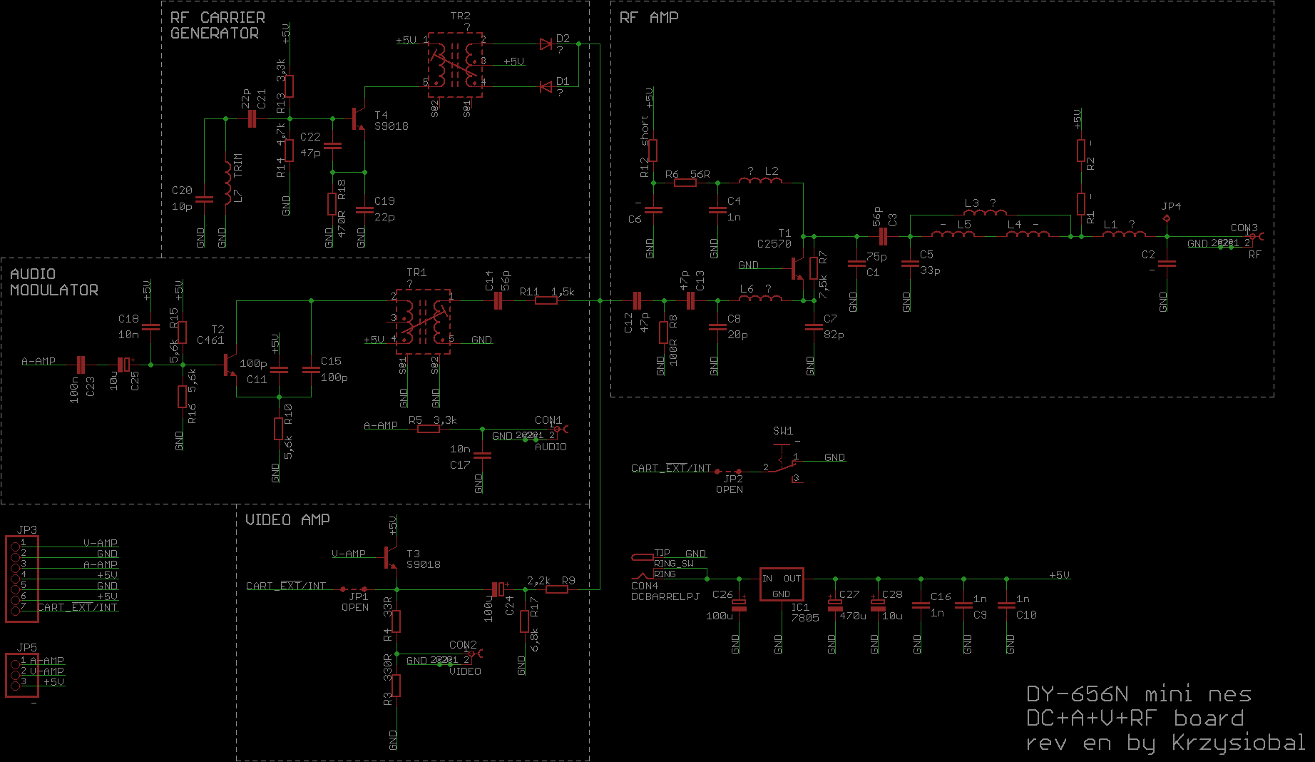

    Usually, in this type of schematic I omitted the modulator completely, but for some time I started to be interested in how they are built and I encountered several different, more and less complex designs.

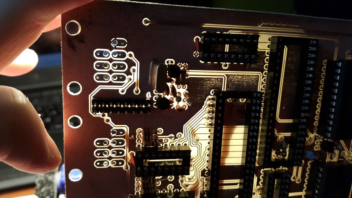

    Motherboard design
    Making motherboards from scratch to consoles is - you might say - my bread and butter.
    New life of the old unique mini NES console (DY-636N) New life of the old unique mini NES console (DY-636N) New life of the old unique mini NES console (DY-636N) New life of the old unique mini NES console (DY-636N)
    I usually use my proven scheme and mosaic of tracks and only slightly adjust it to some housing (e.g. by moving mounting holes, pad sockets, power sockets, power / reset buttons or audio and video sockets). Here, of course, we had to add a second cartridge slot (which was a minor concern, because the pinout of this slot is basically a mirror image of the 60-pin pinout). A minor macro is that the pins' raster is 2.5 mm, not 2.54 mm as for the 60 pin socket, which involved the necessity of constantly switching between millimeters and mils in the Eagl to run the track once centrally between the pins of the 60 pin connector, and then centrally between the pins of the 72 pin connector.
    The bigger worry was that behind the cartridge slots, where there are RAM memories in the above projects, there was no more space in this console. I had the idea to divide the PCB into two parts and place one under the other, but I decided not to "choke" and put everything on one. This required replacing the narrow RAM with wider ones, so I could run a small highway of paths underneath them.
    However, I was not entirely satisfied with this solution - just compare the number of vias in this and previous boards around RAM. This clearly confirms that the optimal place for these memories is behind the sockets.
    The last fitting (I had the greatest concern that the places for the ginazda pads and cartridge slots would match the appropriate holes in the housing):
    The tiles came out great:
    The only problematic place (which even Eagle warned about) was below - I had to cut the slight indigestion of the pad tracks with a knife. Well, here are two tracks of 0.01 mils between 1.5 mm pads (bigger than standard Eagle pads from scalers), which is 0.006mils of clearance.
