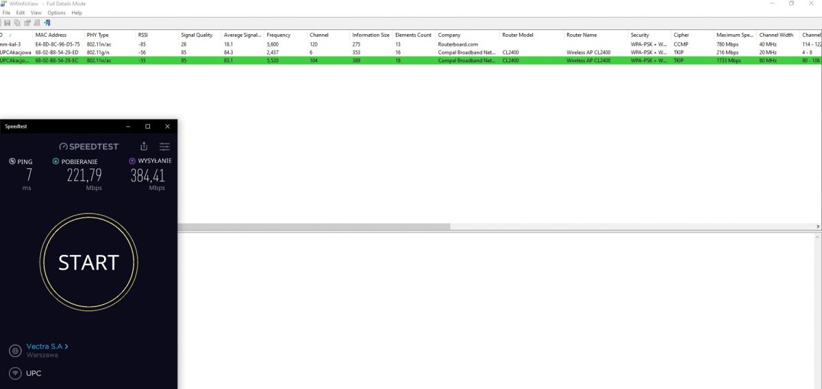

    I have 1000mb/s internet at home, via wifi I have never managed to achieve a result above 300mb/s, the question is whether this should be the case or can I boldly look for a problem somewhere, since the router has a much higher bandwidth, just like the network card (intel wireless -ac 9560)
  • Need wifi scan and hardware specs to diagnose speed issue
    #8 19517870
    KOCUREK1970
    Posts: 35667
    Help: 3861
    Rate: 5489

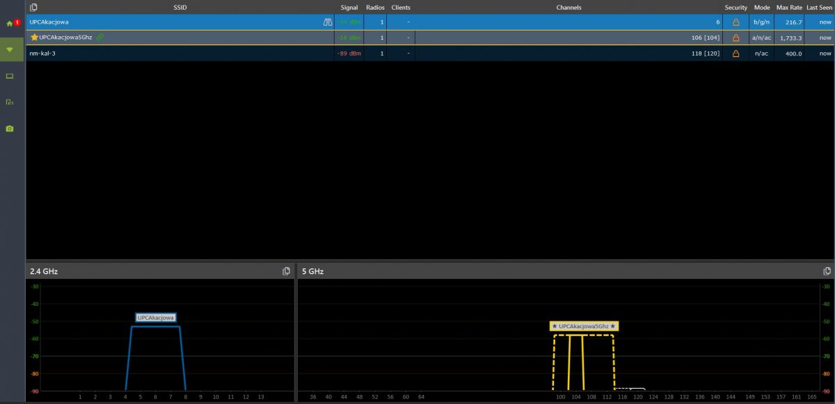

    @filipciors
    Interfere with other channels, channel width in this Compal.
    What I gave was under ideal conditions and no one has them.
    Insert a scan of the wifi network measurement from the place where the problem is:
    :arrow: https://www.elektroda.pl/rtvforum/topic3158772.html
    And present the hardware configuration of computers: what processor, how much RAM, what disk, what operating system, etc.
    Here is an example of what UPC Polska recommends for the 1Gb net:
    :arrow: https://www.upc.pl/pdf/B2B_Wymagania_sprzetowe_dla_uslugi_Biznes_Internet_1000Mbps.pdf
    UPC Polska, speeds:
    :arrow: https://www.upc.pl/pdf/upc_parametry_techniczne_uslug_internetowych.pdf

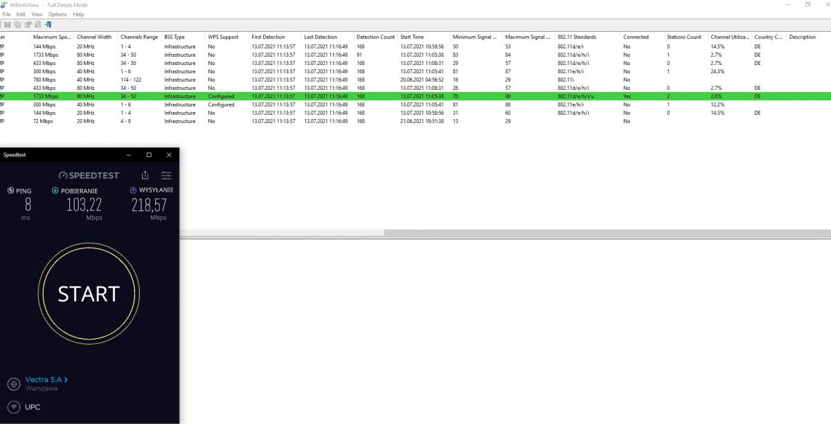

    UPC Giga Connect Box Bridge Mode Issue: Fiber Connection, TP-Link Archer AX73 & Wi-Fi Speed UPC Giga Connect Box Bridge Mode Issue: Fiber Connection, TP-Link Archer AX73 & Wi-Fi Speed UPC Giga Connect Box Bridge Mode Issue: Fiber Connection, TP-Link Archer AX73 & Wi-Fi Speed
    This is the situation from the place where I use the network, an interesting fact is that placing the measuring device next to the router (in my case, a laptop) does not change the download speed, now it is 100mb/s, the barrier of 250mb/s even on a phone that is also next to the router - unbreakable ..
    Now I have an Archer AX73 from Tp-Link connected to the Compal gw7557ce, but even without an intermediary, i.e. only on Compal, the situation with wifi is identical, on any device I have, even in the closest possible vicinity, I do not reach more than 250mb/s
    To be clear, as it was written above, I do not require over 600mb/s, I will have that much on the cable, but around 400-500 would be nice to get, especially having the fastest possible connection from UPC in the end

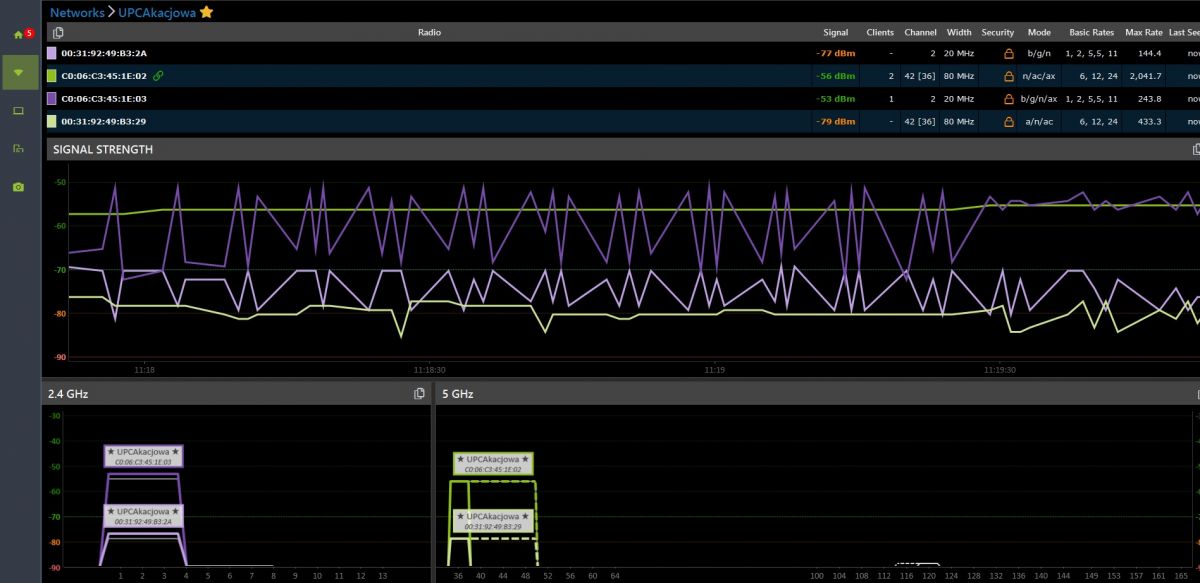

    Previously, it looked like this: compal - archer (with the smart connect option, i.e. 2.4 and 5Ghz under one name) and the AP connected wirelessly, hence the program probably got confused. I would like to point out that when performing speed tests (laptop, iOS phone), no one else was using the network, the results were similar to now. And now it is only compal with 2.4 and 5 networks under a different name. Likewise, the location of the laptop directly next to or in the place from which I attach photos - does not affect the speed.

    Also in the case of whether IPv4 or IPv6 we have the same situation.
    Compal, I understand that wifi supports greater bandwidth, my devices are the same, the router from UPC is a full-fledged router, not a modem, so there is no bridge option, in addition, the Archer AX73 connected to Compal does not get more than 250mb / s.
    So can we rule out everything else but the Compal?
    Compal likely limits speeds, not the Archer AX73
    #20 19519195
    KOCUREK1970
    Posts: 35667
    Help: 3861
    Rate: 5489
    Not:
    filipciors wrote:
    Archer AX73 connected to Compala also does not get more than 250mb / s.
    Plus, you haven't checked out a lot of the things I mentioned earlier.
    Wifi is not guaranteed by anyone, so it can be difficult to ask the operator to replace Compal with another device, citing low wifi transfers.
    Additionally, UPC does NOT have any other router under fiber, so you will get exactly the same, but possibly a different piece.
