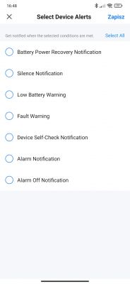

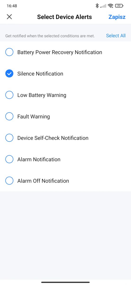

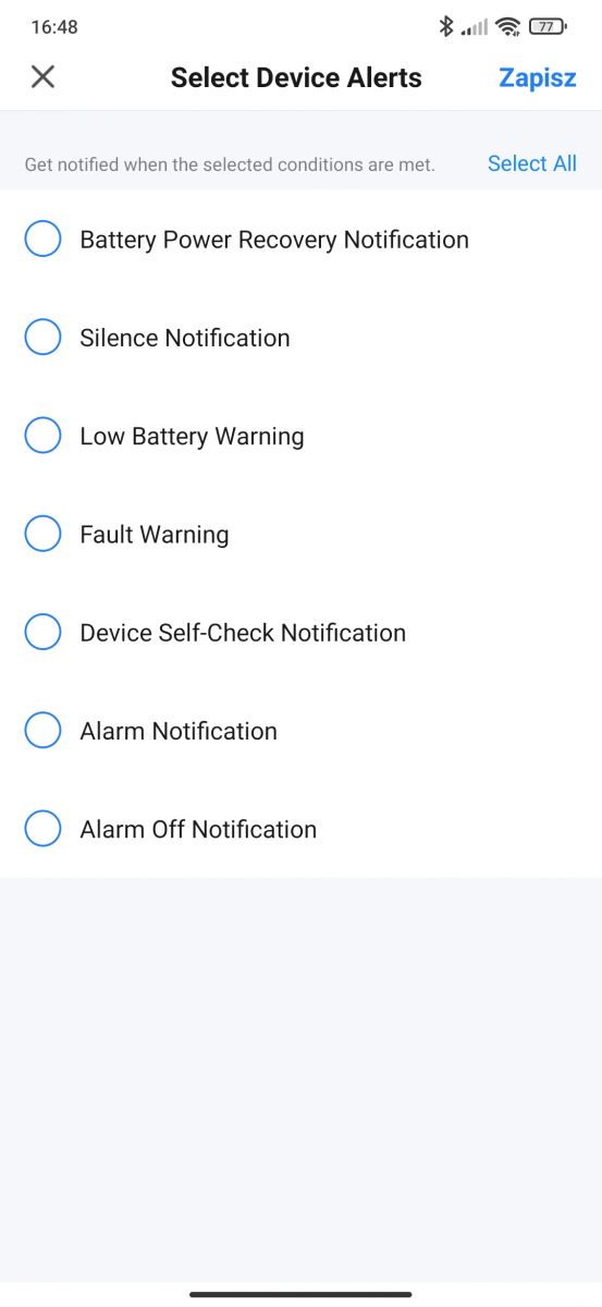

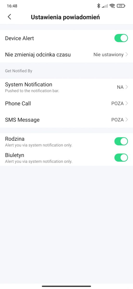

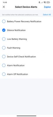

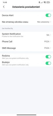

    #12 20737931
    Ricorro
    Posts: 208
    Help: 5
    Rate: 117
    Information for readers I have several smoke detectors and in the Smart life app on 18.09.2023 I see SMS and phone options as part of the notification in case of "W". There are options when such notification available to choose from the options are several . I do not know how much the subscription costs as someone something please write how much .... Screenshot of the Smart life app with smoke detector notification options. A screenshot from the Smart Life app showing device alert selection options. Screenshot of notification settings in the Smart Life app.
